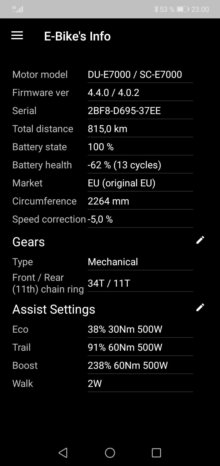

I did this yesterday and it works fantastically, but the diagnostics worried me a bit.
I haven't ridden it very much at all, but my battery health percentage is really low. Does this mean anything or am I worrying about nothing?
