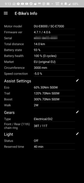

So how accurate is this software at reading the region for the bike? My bike info is attached and shows the market as EU. Does that mean my US bike is set to EU restriction? According to GPS, I'm getting power cutoff on my 2020 YT Decoy at right around 15 mph.

Set to EU
Should be US
YT contacted me today and had me fill out a warranty claim. I'm hoping tomorrow, they will give me a form so I can take it in to a local shop and get it set to US and have my rear tire circumference set to make my speedo more accurate, it is currently off by almost 30%.

It looks like you talking about first STEPS Unlocker versions and even didn't read posts above. These features have been added. Just use the latests versions

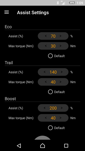

Hi guys, I have the full licence version for DU-E6100.
I've changed to US, the extra speed is handy.
Can anyone tell me the best way to increase assist? Still a bit piss weak going up hills (on road).
As it currently is, I need to put in a lot of effort for the motor to give more assist.
I would like it to use more motor, with me using less effort.
Page 9 in the manual mentions 'Assist', 'Torque', and 'Power'.
The 'Torque' slider makes sense, slides to max torque.
But 'Assist' has '300%' as the highest example in the screenshot. What is the actual maximum available which won't cause any damage?
Each example for 'Power' has '500W', but it looks like the slider could go further, is it possible to increase this without causing damage?
And just to confirm 'Speed Derestriction' is not available for mine (manual says only for DU-E8000)?
Thanks in advance.

Post up a screenshot of your current settings, E6100 is a little uncommon around here.
What mode do you ride in?

Each motor has own restriction by maximum torque/power/assist level. Moreover different FWs have different restrictions. You can't set values from E8000 to E6100. App knows common restrictions for all motors/FWs and doesn't offer to you impossible values!

The e6100 is rated at 60NM though i am unsure the maximum assist percentage available. 200% sounds a little low and could be a glitch withthe app?
I would bump boost and trail up to 60nm so you have full power/torque available. Set boost to maximum assist percentage and probably leave trail assist percentage about where it is.
