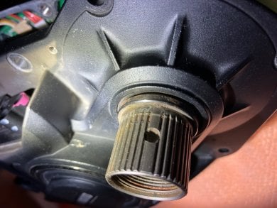

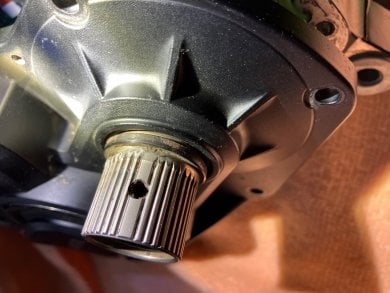

Hi all.
I purchased a bearing set for the E8000 from the Australian agent for Performance Line Bearings a while ago. And decided today was the day to do the bearing replacement.
But I struck a snag when trying to separate the cases. My through axle has a collar on the left hand side that doesn't seem to be shown or discussed by others during the process. Pics attached.
This collar doesn't allow the left hand case to be lifted clear of the axle.
Anyone else experience this?
Any suggestions?
Good advice appreciated. Thanks.
Strindberg
Sep 24, 2021
100
59
Strasbourg, France
Hej Hej @brw0513
In your case this black small collar is sticked by mud and rust.
With a small screwdriver you have to push it out step by step.
The collar allows the crank not to rub while pedaling.
You have to grease it after servicing.

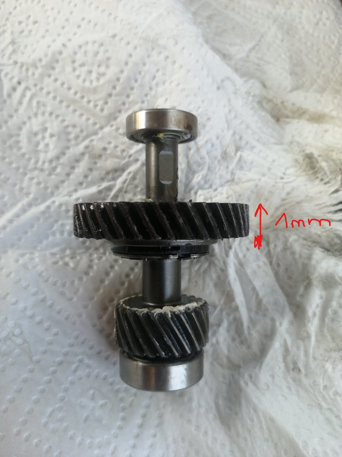

Hey guys,
I tried to dismount the e8000 and broke the magnet (yellow marked in the picture). In one describtion it's called magnet for cadence and position sensor. Is this sensor available somewhere? Is it still useful to change the bearings or is the engine fucked?
Also the gear (red marked) on the other photo, moves around 1 mm and is really instable. Is this normal?
Thanks for your help of the guys, who have done this before.

Not sure, but i think you could replace that magnet ring if you can get hold of spare parts. That would save your motor from the trash bin.
That unstable gear, yes that could be a problem. At least it was for me. I got an intermittent grinding noise because it would rub against the adjacent gears. Ive tried everything to stabilize that gear with spacers, and adding more clearance (so it wouldnt hit the other gears). Didnt help much. The true cause is that the clutch just wears out over time. Ive mentioned the problem here:
Now if you dont have any grinding noise at the moment, you might still be ok. It takes a while for the problem to develop.
Otherwise your best bet is to replace those gears with parts from a donor motor (low mileage). I did this recently and it finally fixed the issue 100%.

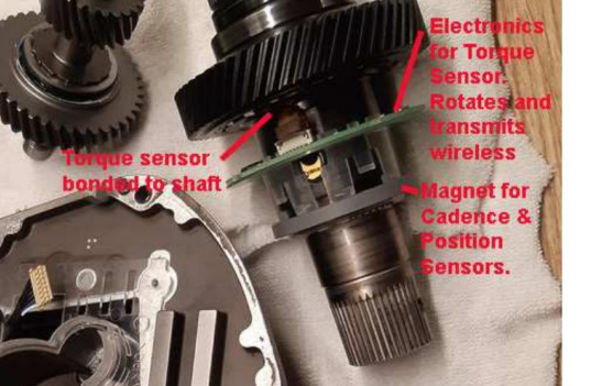

@Pansn
I wrote yesterday per PM through the german forum
very long answers about the method we have to follow to service safely and easily the motor.
In the german forum and here for example I gave several times since 6, 7, 9 months
very long and complete and comprehensive explanations
about how you can lift away from the grey magnet the ball bearing without any troubles.
Yes, of course ferrite is fragile. I wrote x-times never be in a hurry to service the E8000, never, never, never.
If somebody intend to do that on his own, he has to let for some couples of days the engine in a corner,
and he must reed a lot of times the threads onwards and backwards and vice versa,
to understand and to FEEL what we are meaning and what we describe !!!
It's sad because with these failures only due to haste, cyclists who would like to repair their e8000 will no longer dare and will have to buy a new motor, which is completely unnecessary.
For our part we have done our best for the forum in german and english.
We cannot replace only the magnet, c'est foutu,
the sensor is calibrated with his magnet and with the engine PCB.
We cannot take only a sensor from an old donnor motor.

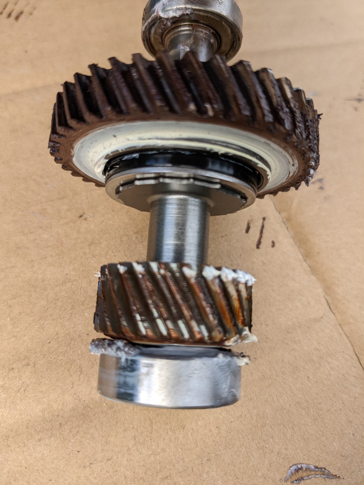

Hello everyone, lately my e8000 has become louder and when after a few minutes of driving it warms up a bit under heavy load in trail and boost mode, a rather loud interrupted sound is heard (kweek-kweek).
Otherwise, when I turn off the motor and pedal under full load, absolutely nothing is heard, everything works perfectly, does it make sense to change the bearings, since the ones that go most often seem to be fine ?

exactly this sound (video from 2:00min)
Yeah that is the sound of those 2 inner gears rubbing against each other...
It creates this repeating scratching noise about 2 - 2,5 times the speed of the cranks.
Ive posted about this problem here:
The solution is to replace those 2 inner gear sets (the 2 layshafts with gears and clutch on it) with parts from a donor motor. This is what i did and it finally fixed the problem 100%.
Or get a new motor, preferably under warranty.
Or alternatively you could keep on riding like this, but the grinding does get worse over time. Its not necessarily destructive in short term, and you can ride with it for a long time before something bad happens. But the grinding does create heat in the cogs, makes the lubrication fail (it burns black) and that causes cogs, clutches and bearings to wear out even faster.
Just replacing the bearings would most likely not fix your problem.

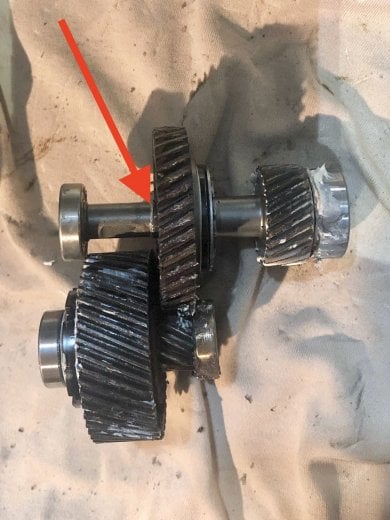

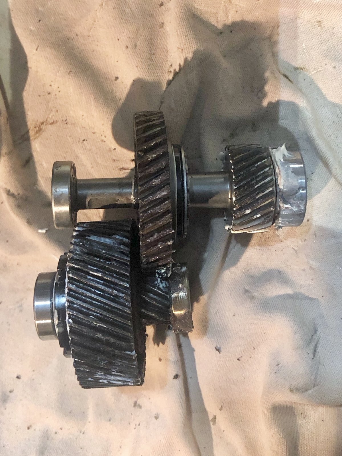

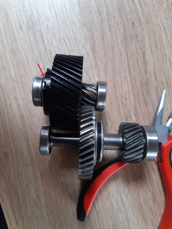

BTW, regarding those grinding noises from those inner gears, Shimano did change the design of those gears over time. And probably for the worse sadly. I had one of the later models E8000 (right before the EP8 was introduced) and it suffered from this grinding problem badly.
The donor parts i got were from an older E8000 and those parts were different.
Just an illustration to see what im talking about:
(ignore the arrow...)
When i was swapping the parts out, I spotted 2 changes with these gears.
The first is that the older motors had an additional (3rd) clutch mechanism inside that big black gear. This was completely removed in the later model E8000. Possibly due to cost and weight savings, the third clutch is kind of redundant anyway.
The second is that the big metal gear in the center of the photo was changed in width. The older motor had a narrow gear, the later model has a wider gear (as shown on this photo).
Makes you think if this grinding problem was actually introduced by changing to that wider gear? Since a wider gear had less clearance on both sides?

S13 thanks for the answer and it seemed to me from the sound that the problem is not in the bearings, the warranty has expired, unfortunately I don't have a donor motor, is there any possibility of repair?

If you cant find a donor motor and are able to either fix it yourself or know of someone who can fix it for you, your only choice is to buy a new motor. Im not aware of any company who does these kind of repairs. Shimano doesnt provide spare parts for their motors sadly.

Thanks again, I'll take the my motor apart these days to see if there are any scratches like in your picture, I have some technical knowledge, so I'll try to solve it somehow :)

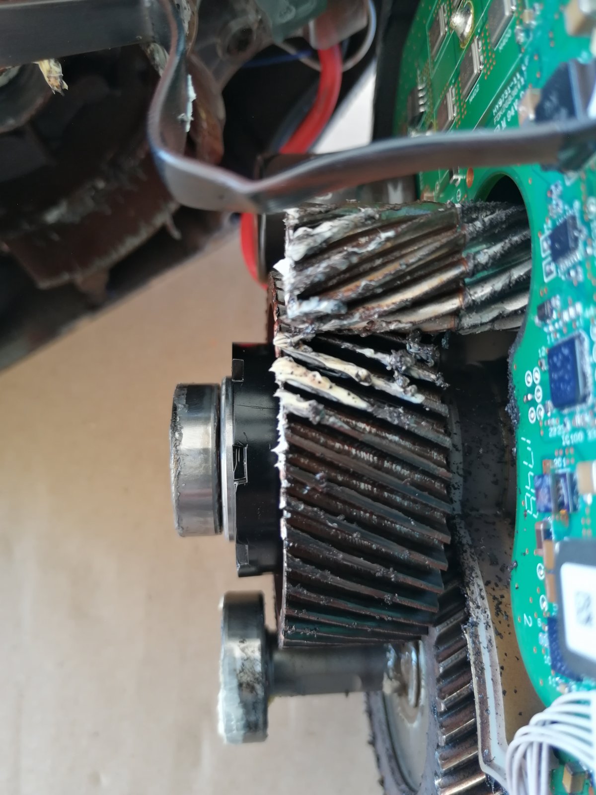

Hey guys,
I broke the magnet in 5 pieces (bearing puller) and thought that's the end. Superglue und some epoxy resin helped. There is no difference in the behaviour of the sensors. The magnet ring is just a 4 segment magnet, 2 segments magnetic and two not. It's no part of the torque sensor, just for rotation speed of the axle.

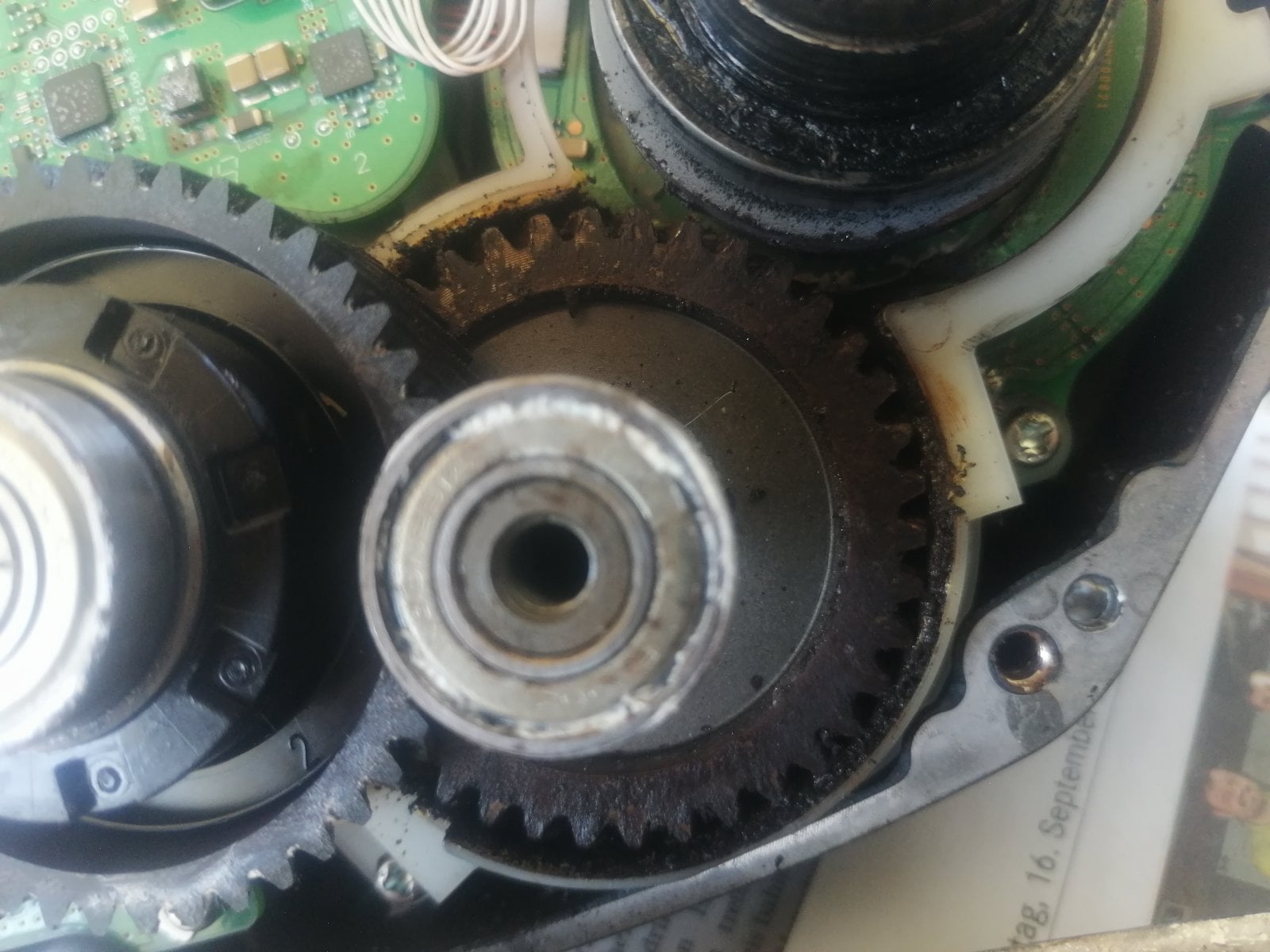

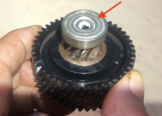

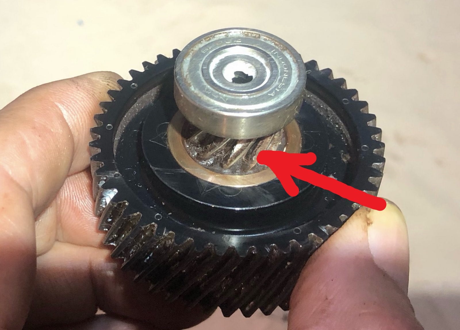

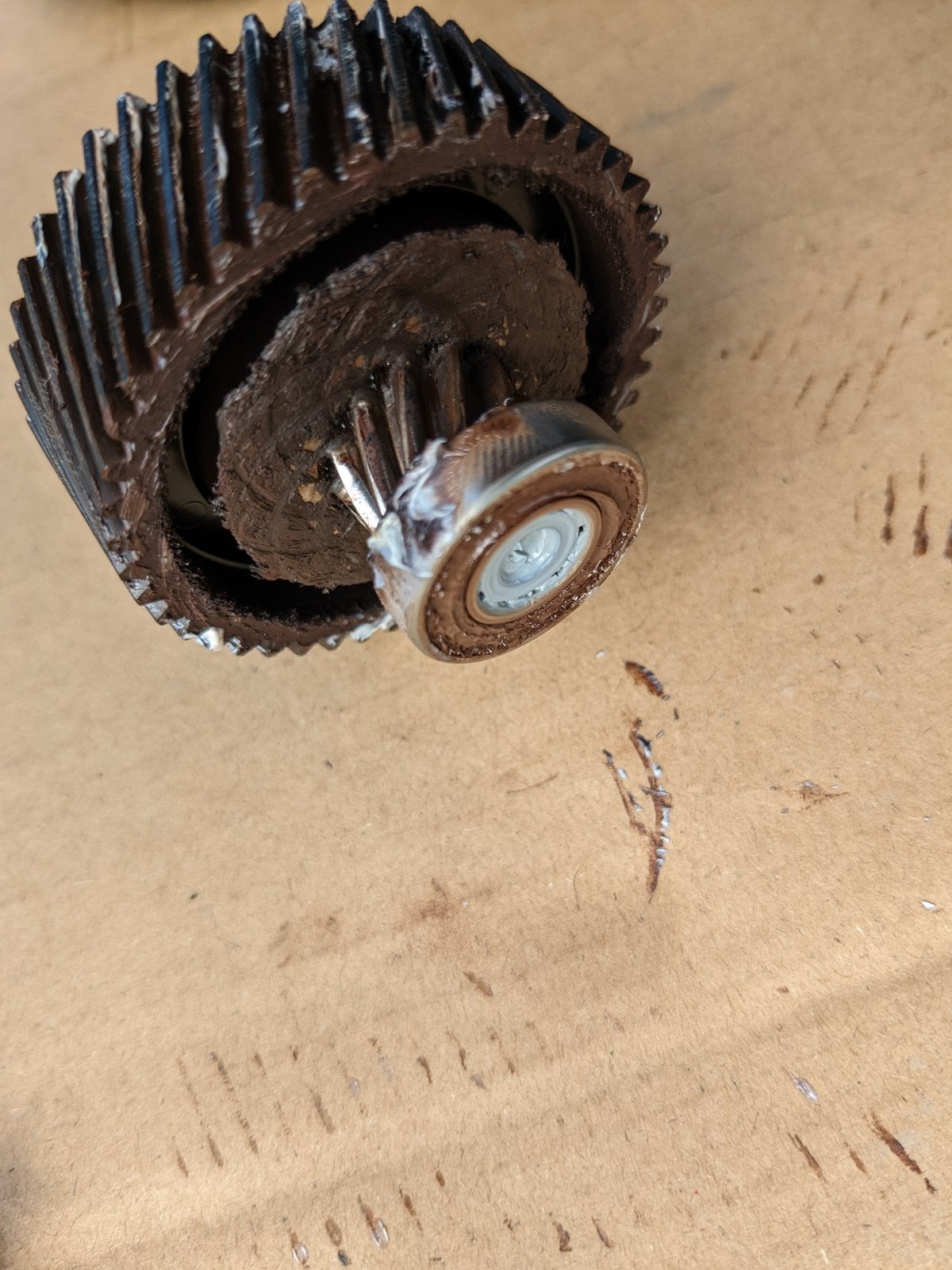

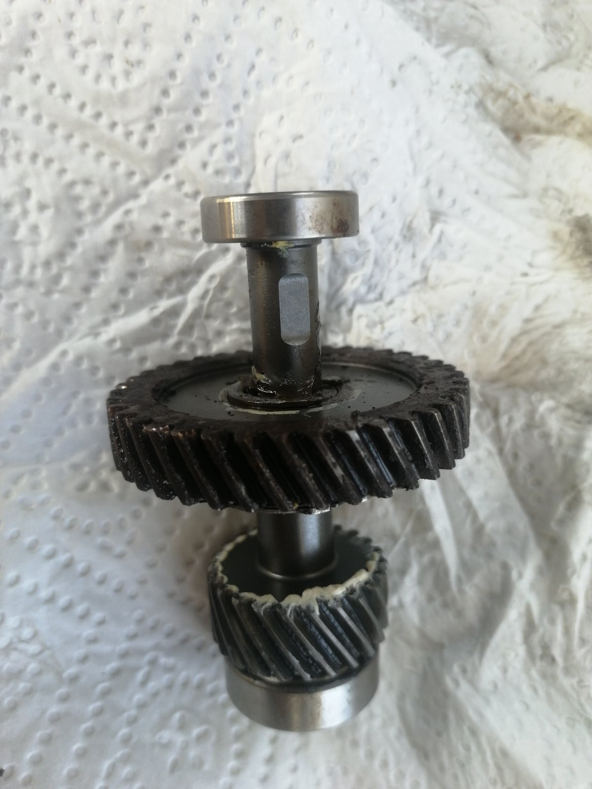

I opened my motor today, everything went quite easily, but I don't see any scraping marks like you have.
S13
Mar 1, 2021
237
145
NL
Maybe try cleaning it up and inspect it more carefully. Look for any kind of wear, debris etc. The wear pattern from my photo is from after many many kms of scraping noise (probably well over 1000kms) and several failed attempts of regreasing the gears. So that amount of wear took a long time to reveal itself.
Im not sure what that gunk inside the black cog is? Looks like powder or something?
Could also be that yours is not hitting the the black cog, but instead the bearing on the opposite side?
Is there a lot of axial play on the big metal clutch gear?
Dario
Mar 15, 2022
12
Croatia
I didn't notice any wear or debris, the gunk inside the black cog is hardened grease, I don't see any scraping marks on the bearing und axial play ist about 1mm.
The only thing is that my gear seems to be brass, not steel like yours, and it looks more worn than yours.
S13
Mar 1, 2021
237
145
NL
If the grease has hardened and turned black, then it has already deteriorated to the point of failure. Most likely due to overheating.
And yeah, that center cog doesnt look to good on the photo.
I still think that your best bet is to replace that set of cogs.
Also because the interval / period of the grinding noise points at these cogs.
Interested what you decide to do and how it works out
Dario
Mar 15, 2022
12
Croatia
In the end I put a thin washer under the C-Clip to reduce the axial play and I also replaced this bearing because it didn't spin as smoothly as the others, I lubricated everything well and for now, after 200 km, everything works as it did when it was new :)

Marc_250
Sep 20, 2019
42
21
Opened up mine today as it the fast paced shh shh (sometimes sounding like a tieclip been pulled) sound was getting louder.
This is how it looked for me, gears all look pretty good but grease seemed a bit tired, not sure if it all going brown is normal? The bearing covered in the brown gunk is rough to rotate rest seem fine. Will clean it up and replace all 4 bearings on these 2 shafts tomorrow, chuck it all back together and see how it goes.
S13
Mar 1, 2021
237
145
NL
The original color of the grease is white. So if its brown now that means its either heavily contaminated or burned due to overheating. Either way it doesnt look good.
