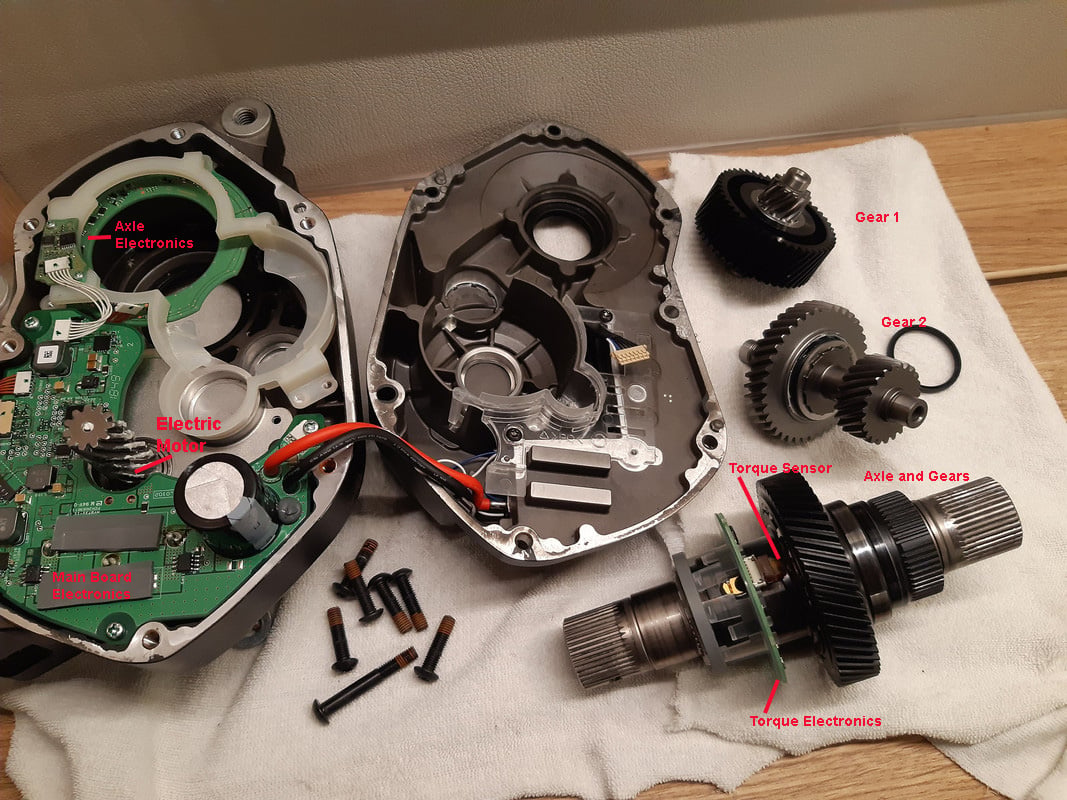

Hi, let me summarize what I believe you did and please, correct me if I am wrong. We know very little about the errors in these motors and these repairs help to improve the understanding.
  1. You had a E8000-1 where bearings exploded and damaged the gears, but electronics were fine
  2. You bought a second motor E8000-2 and after 300Km you had errors E010 and W013.
  3. Then you moved all the bearings and gears from E8000-2 to E8000-1 and now you ave a refurbished motor E8000-3 with new gears and bearings and old electronics.
As you did not invoque Shimano warranty for the second motor, I assume you bought it from 4mybike.de store or ebay, or another similar store. Can you please confirm where you bought it and if it had warranty.
So according this, the conclusion is that errors E010 and W013 in motor E8000-2 were caused by faulty electronics.
Can you please confirm which motor components you kept in E8000-3 (See image below):
  • From old E8000-1:
    • Motor housing
    • Electric Motor
    • Axle Electronics
    • Main Board Electronics
    • Torque Electronics
  • From new E8000-2:
    • Gear 1
    • Gear 2
    • Axle and Gears, which I believe includes the torque sensor that is glued to the axle
I am sorry for the many questions, but as Shimano does not provide any help, then we have to understand by ourselves how to fix the motor in case of failure.
Axle Electronic the key thing may be that this part is faulty, note that in this photo there are two different components that you have? with two processors or one

My motor is working fine so I have not opened it and I do not know which axle electronics I have.
Which one is the good one?

ll components were moved from the new engine, only the electronics was left over from the old one I made 19k km
So yes, the first motor damaged the bearing and the motor housing, everything else was good except for one thin washer that broke.
I put on a second engine that I bought a year earlier without a guarantee, but it had a mileage of 0km and was new.

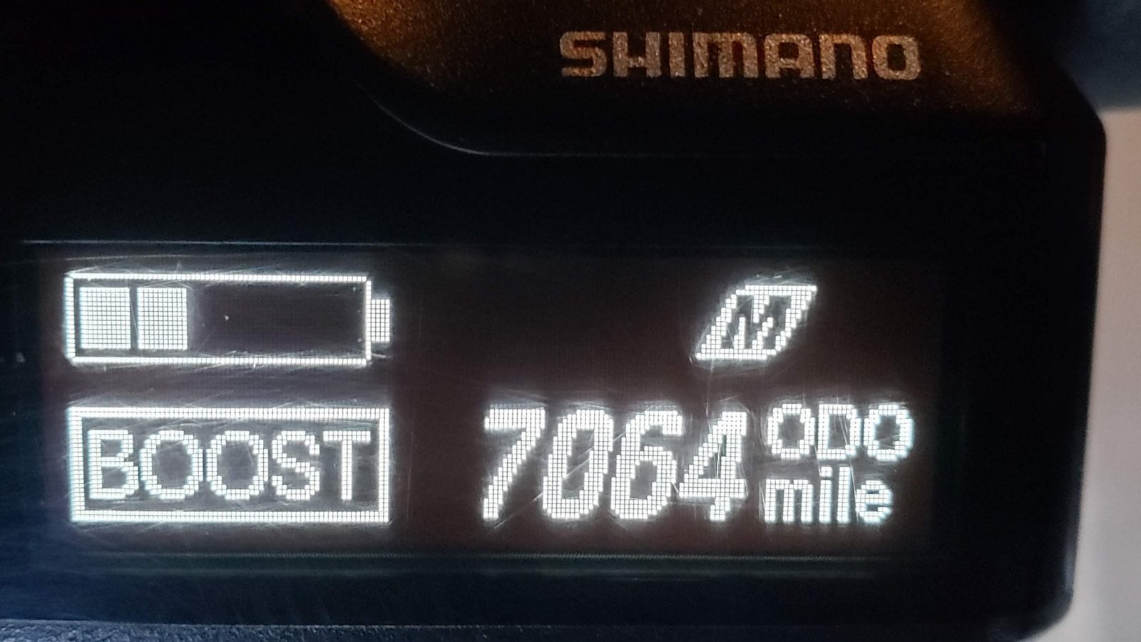

I put 7,064 miles on the 1st e8000 motor in my 2019 YT Decoy, before replacing it with a unit supplied by YT/Shimano due to a knocking noise my motor began making on long climbs. I ended up selling the bike shortly after replacing the motor.
