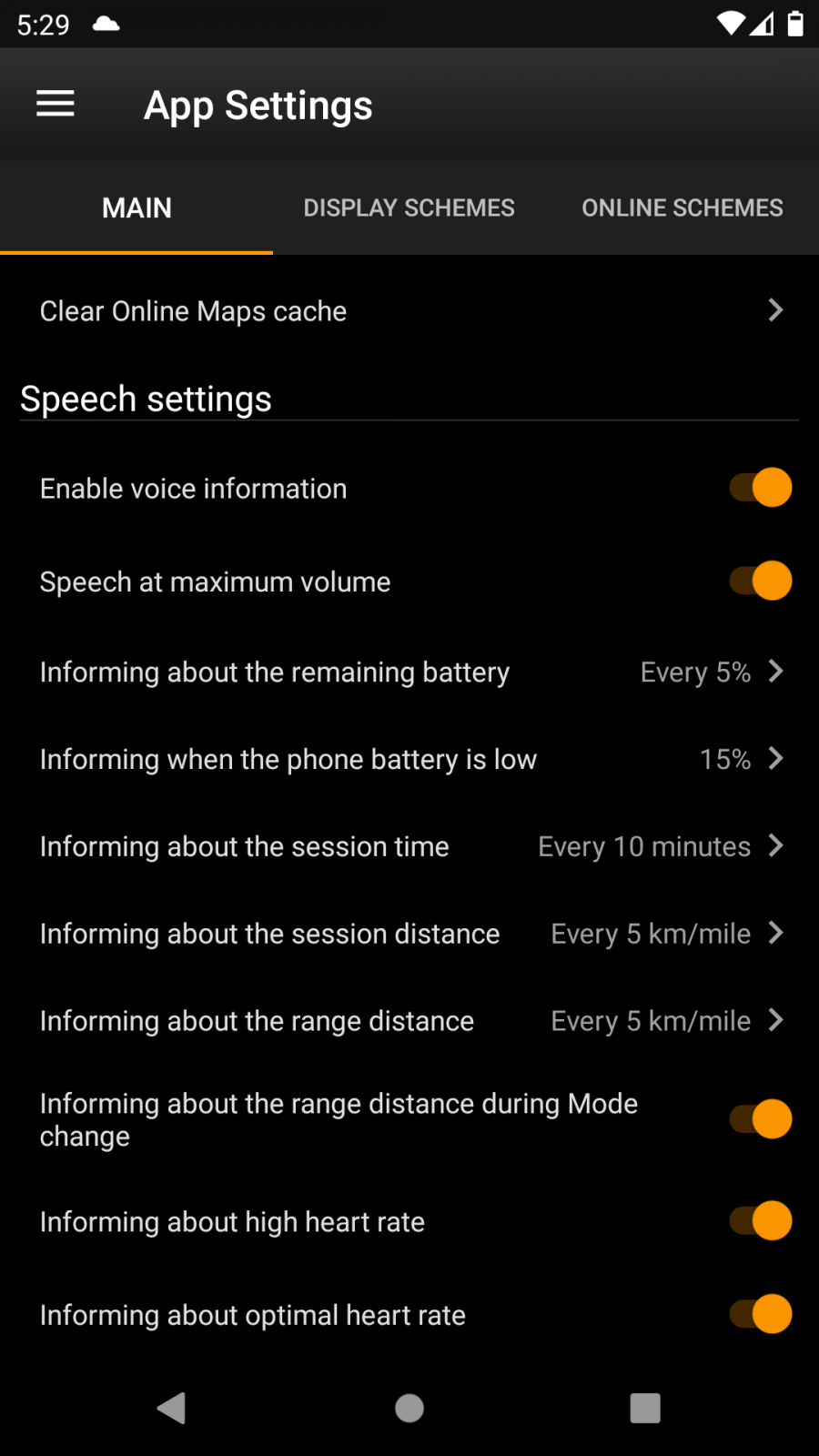

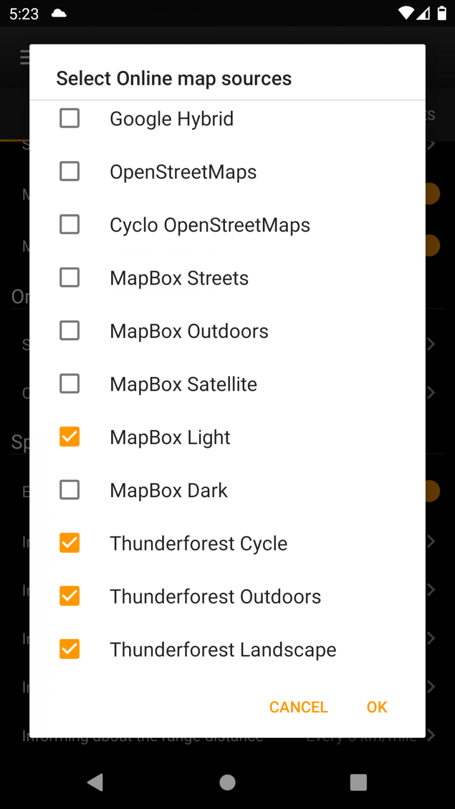

The new version 1.8 for Android is ready.
New features:
1. New online maps sources. You can select which layouts you want to use and cycle switch them on a map screen
2. Added voice notification for various events/triggers
