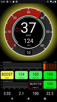

The new version for Android is available:
+ Assist mode usage in % (for each mode), also displayed on speedo as color arcs
= new version of Climb/descent calculation
= fixed font sizing when a phone has non-default font size
= extended session description for exporting
