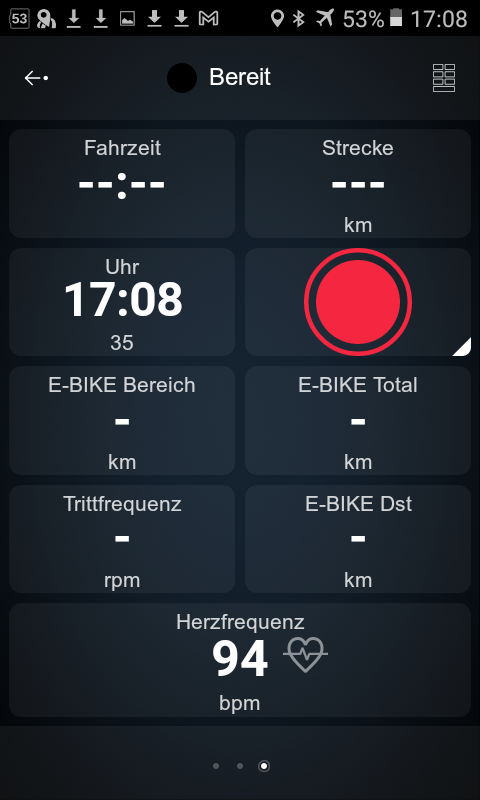

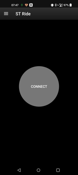

sorry...... I have problems with the HR sensor.
I get the feedback via voice: HR Connect but no value is displayed.
After a few minutes a voice message: HR disconnect
the sensor works perfectly with the Shimano Ride app.
vadII
Feb 19, 2019
800
576
Earth
This message only occurs if the Android system itself interrupts the connection with the sensor and informs the app about it. There is no way to control the quality of the connection between the sensor and the Android system.

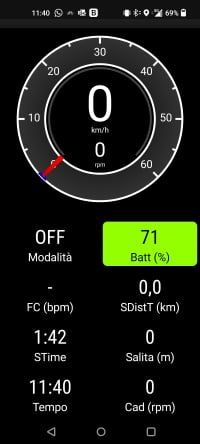

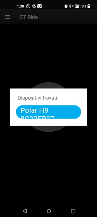

Vadll I bought your App that I really like, I find it complete.
My situation, I have a OnePlus 8T Android 12 smartphone and an Orbea Rise H30 ebike.
The ebike connects without problems, while I have a big problem connecting to Polar H9 heart rate monitor.
In all honesty before the last upgrade to version 1.10.60 the Polar band connected without problems.
Now after the last upgrade following the on-screen instructions, to connect the bluetooth sensors first and then turn on the ebike the App, detects the Polar Band as a device found but remains on the screen without going ahead if tap on the Polar inscription nothing happens, if tap on the screen the writing disappears but once connected the Ebike does not appear the dator on the heartbeat.
See image.
I tried to disconnect the Polar Heart Rate Monitor to reconnect it to uninstall STRide clearing data and Cache but without success.
I think it's a problem of the STRide App because the Polar H9 Heart Rate Monitor connects seamlessly with other APPs like Wahoo, Polar, OruxMap and E-Tube Ride.
I wanted to understand if there is the possibility to download the apk of STRide previous to understand if it is a problem related to the latest version.
Or alternatively if I can send you a log to understand what the problem could be.
Thank you for your support.
dipol
May 19, 2022
8
Italy
Dear Vadll,

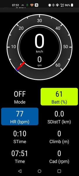

I think understood the exact procedure to connect both the HRM and the Ebike.
With the Ebike off, launch the App and then tap on connect, as soon as STRide reveals the sensor and the sensor found is displayed on the screen, without any tap (don't touch the screen), you have to turn on the Ebike the App connects to the Ebike and are finally displayed both the data of the Ebike and those of the HRM.
Tried 2 times and seems to work fine.
I also send you logs via email to see if everything is working smoothly.
I will also try in the coming days to see if everything is working properly.

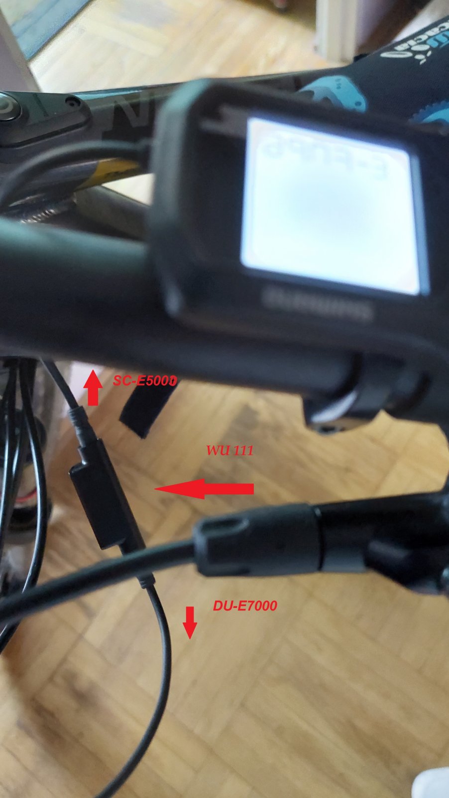

I have a KELLYS electric bike, model R90. Motor model: Shimano DU-E7000. Firmware: 4.5.0. Display model: Shimano SC-E5000. I purchased the Shimano EW-WU111 transmitter module. I connected the module in series, in front of the display. Just like in the picture. It is visible on the Android phone as a bluetooth device. I have purchased the 'ST Unlocker' application. The application connected with the bike without any problems. When the 'ST Unlocker' app is connected, only 'Etube' is displayed on the SC-E5000's display. Other data on the display is not displayed. In the application I can change the 'market' and 'circumference'.
But ....
I also purchased the 'ST Ride' app. I can't connect to my bike. The SC-E5000 display is dark, there is no data showing. When I disconnect the WU-111 transmitter (native connection), the display shows the data. Where is the problem ?
Please help.

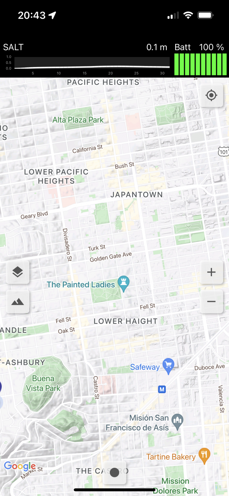

It seems like the latest version on iOS looks strange for me using Info vs Map: It's just a tiny sliver at the top that shows the info. Using latest iOS 15.5 and ST Ride 1.5.16)
