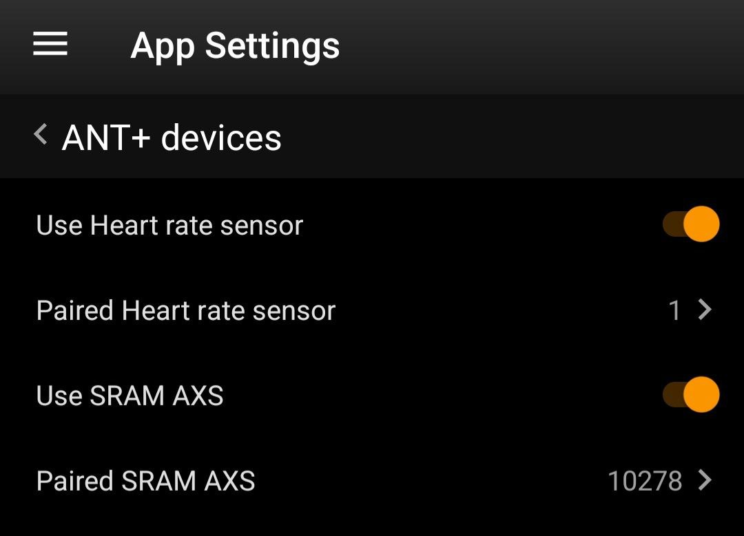

The new 1.18 version was released.
Added ANT+ heart rate sensor and SRAM AXS.
To work with ANT sensors you have to enable it and pair at "App Settings"

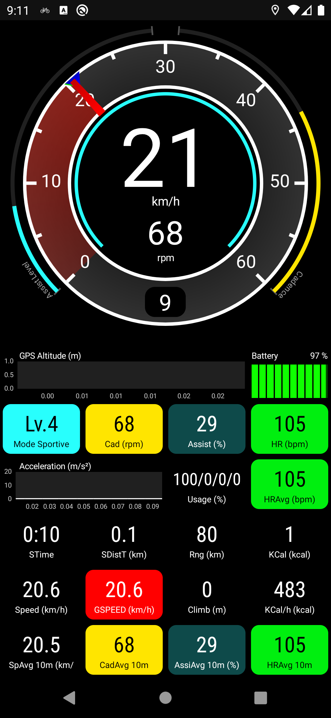

Configuring the dash was really easy , now I have my dash with the basic info I need when I ride(Battery,distance,time, ride time:
Question: I am thinking of buying a Samsung Galaxy 6 (47 mm screen). With the minimal info I want, I should be able to read the display Did someone try it? I resized the screen capture to h=47 mm, so it should look like the pic I included.
