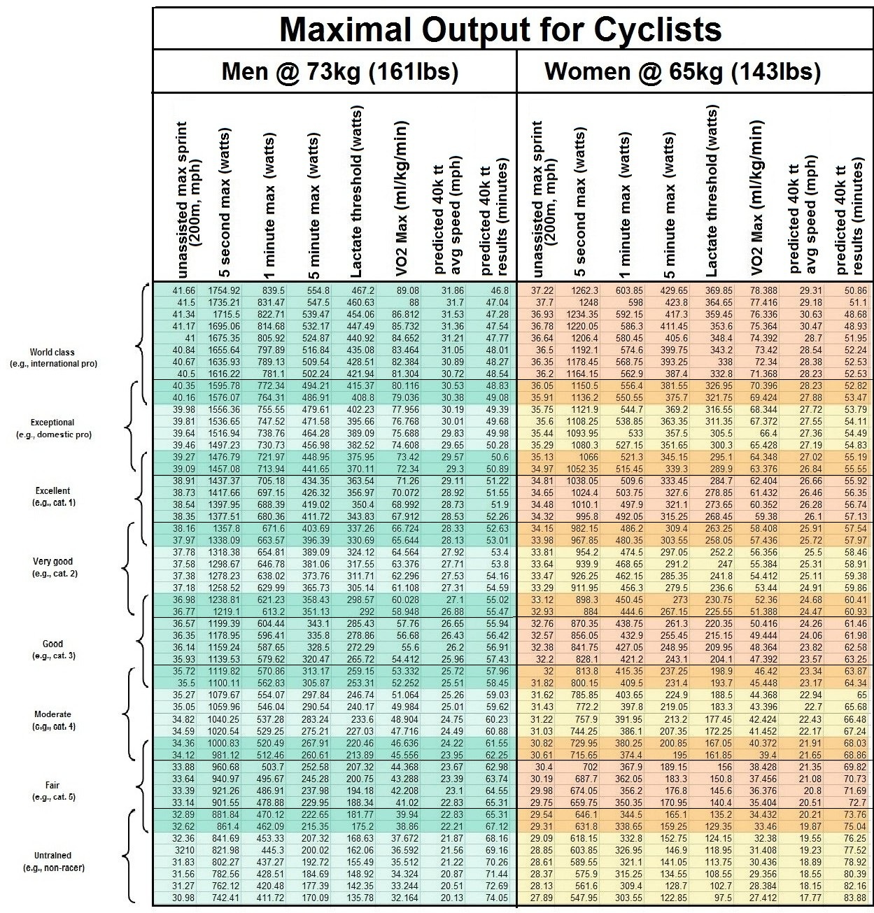

Hi, looking for some advice on settings. I've got a 2018 comp carbon with uptodate battery and motor firmware, so I'm using the new app.
In turbo I'm 100 assistance 100 peak power. From my understanding the more the rider inputs the more you get from the motor.
On a steep loose climb I'm in turbo and spinning in the highest gear/biggest cog. As I get to the top my legs are getting tired and I'm obviously inputting less. Does this mean I'm not getting full power when I really need it?
Cheers
MATT
@Matt b this is how I think it works, but someone can correct me! This other post gives useful info Mission Control iOS App 1.2.0 featuring Infinite Tune - Now Available - EMTB Forums
At 100 assistance support the Levo provides 320% of the rider power, and at 100 peak power up to the maximum of the motor power (let's assume that is 500 watts as mentioned in the post I linked).
If at the bottom of the hill you are pedalling at say 300 watts, then the motor power will be maxed at 500 watts giving a total of 800 watts.
If at the top of the hill you are tired and pedalling at 200 watts, then the motor power will still be maxed at 500 watts giving a total of 700 watts.
But if you were even more tired at the top and pedalling at 100 watts, then the motor would only be giving 3.2 times that = 320 watts, reduced from the maximum possible, and giving a total of 420 watts.
So it does depend on what power the rider can provide relative to what the actual power output of the motor is. I don't know if Mission Control can display those actual values? But I've seen that the BLEVO app can display them. So it might be useful to do a test and see what actual values you experience yourself.
I found a chart here which shows comparative power of different cyclists My World From a Bicycle: Comparative Measurements of Maximal Outputs for Cyclists
Note that to sustain even 200 watts you will have to be fairly fit!
