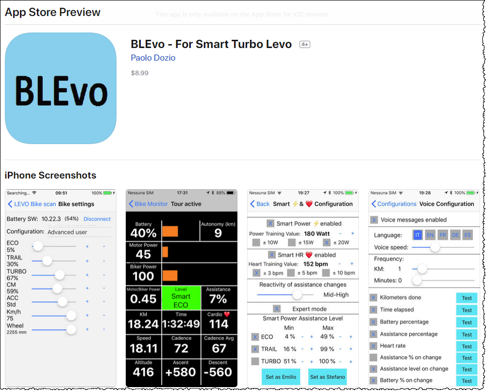

Really mine had to be plugged into box which was connected to a lap top without the box can’t see how it’s possible I asked about blue tooth connection & was told they were looking into it for the future
JonasH
Jan 23, 2018
169
104
Norway
Hey! I chatted with the developer of BLEvo. Unfortunately there will be NO acceleration settings for anyone that have updated the FW to X23
