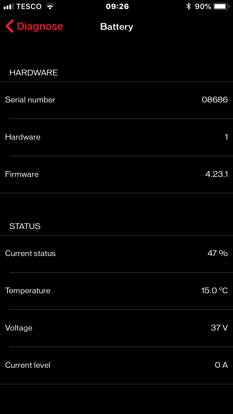

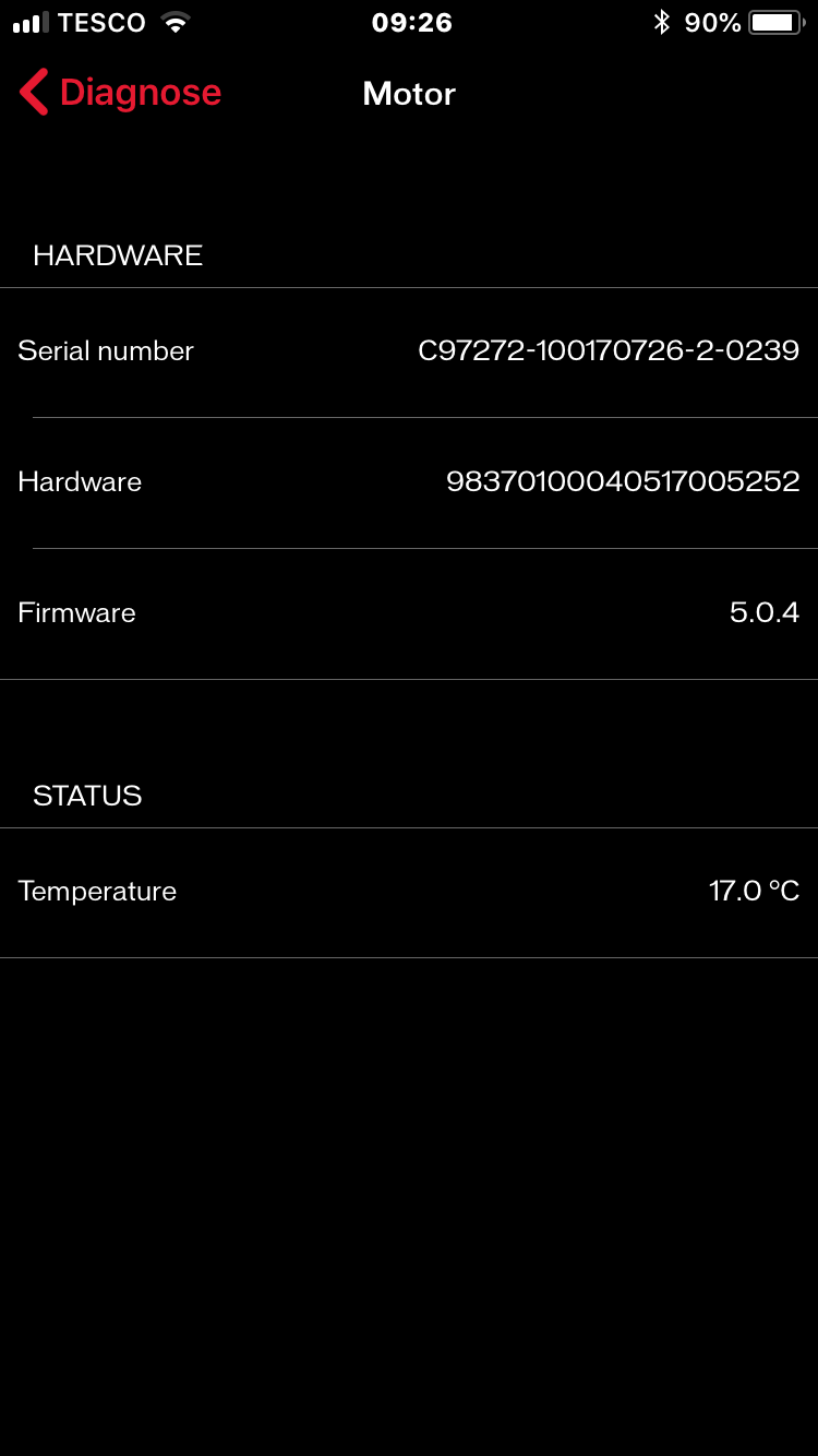

CyclesUk maidestone kent branch did my battery firmware up-date today & the lastest motor update which is deffo out now....great bunch of lads I then headed to Bedgebury Forest for a blast....same settings ECO 15% SPORT 55% TURBO 100% left the other settings at default did two rides on the Red Routes totaling 35km with 670meters of climbing....had 50% battery when I left to come home bike felt really good to be honest no different than before the up-date I’m really pleased I took the plunge
Mountie
Apr 29, 2018
421
254
Canada
Hi what motor software are you running now?

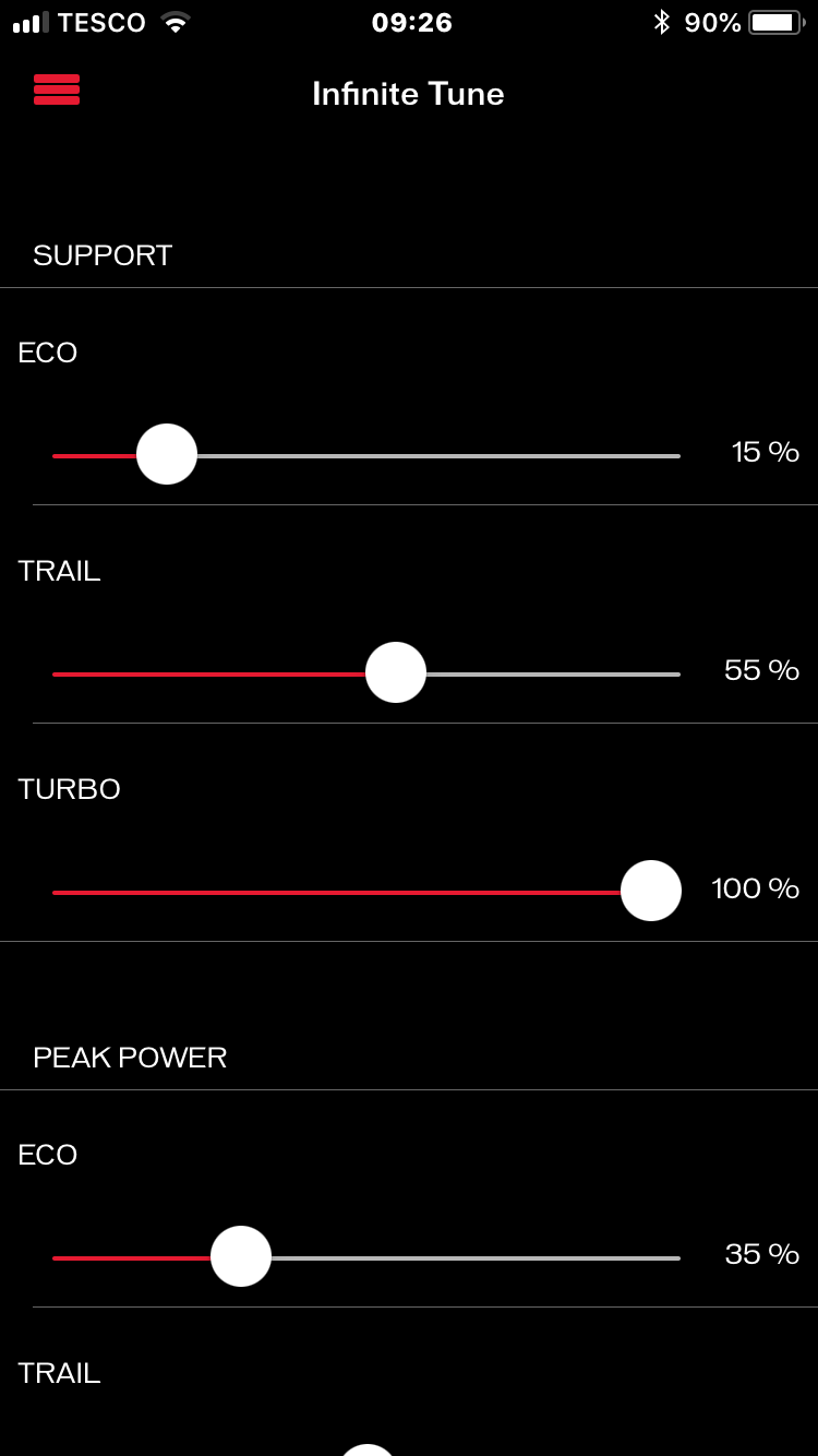

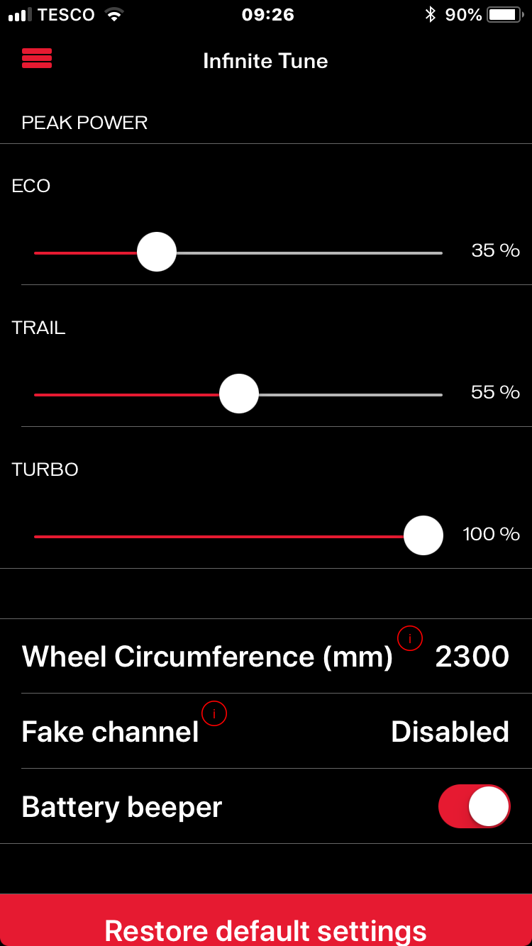

I’ll check tomorrow & let you know out for a few beers now
Here’s my settings for anyone’s interest

I managed an extra 500ft of climbing (on the new motor\battery firmware) on my first ride.
Support 80/85/100 with Peak 70/80/100
Will continue to experiment
