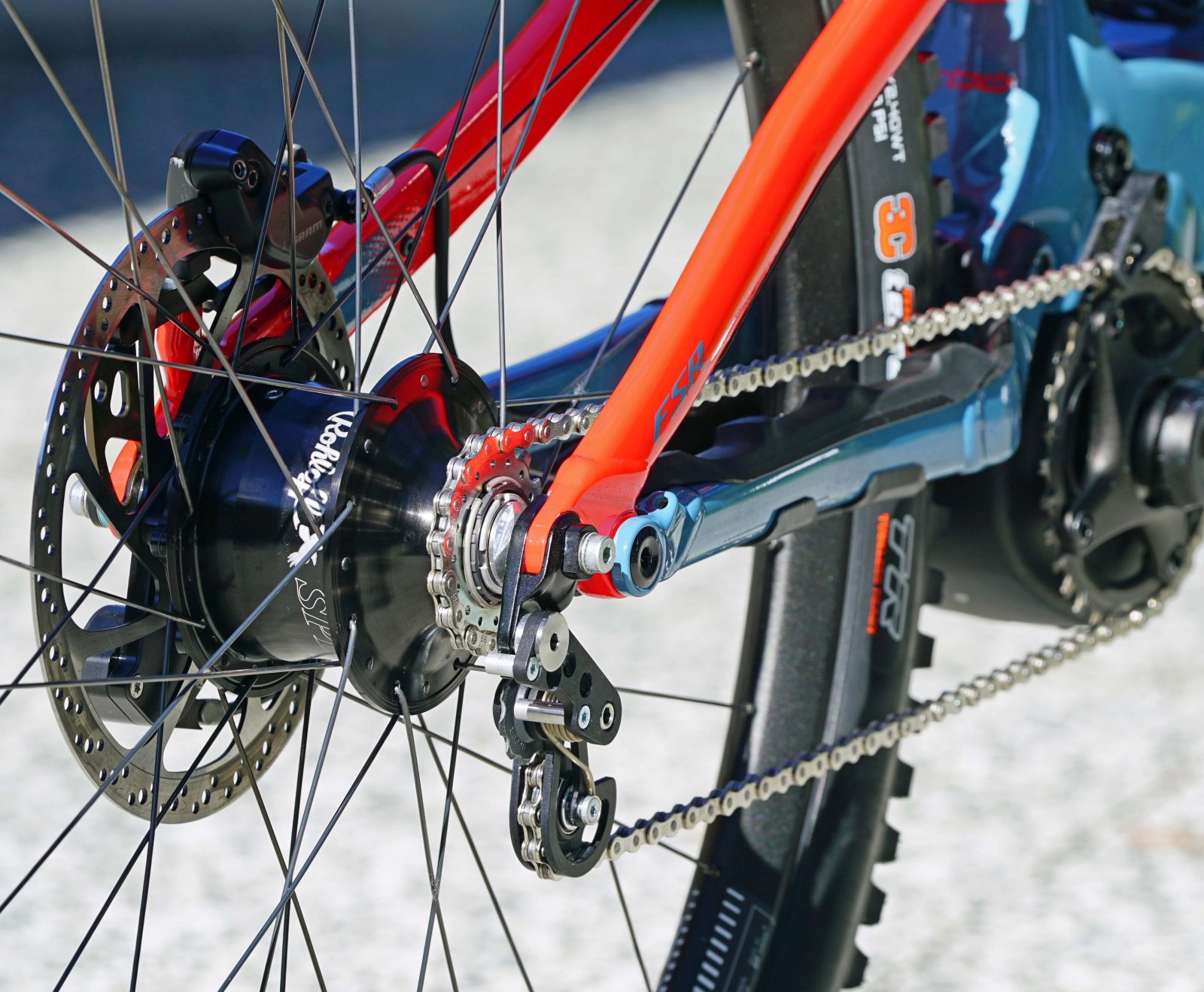

Specialized Turbo Levo - closeup disc brake side setup Rohloff Conversion 06Apr19d-r3.jpg
650 kms... no measurable chain wear, rear sprocket and front chain ring no visible wear. Keep it washed and cleaned, retensioned spokes twice during the first few weeks. Last week removed all the rear end linkage bolts and cleaned up and re-greased all linkage bolts, seals and bearing faces and reassembled - all looked good and retorqued everything back to recommended settings. Removed engine covers and inspected and cleaned out, again all good. Replaced a worn rear tyre last week... apart from that, love riding my Turbo Levo!
Do you have any other information on the. Hub please ?
