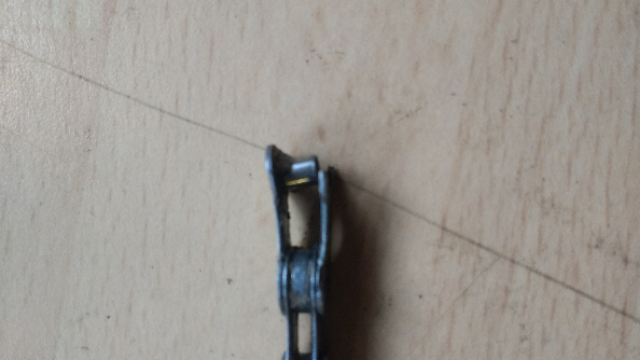

500km of it was wet and muddy and sandy riding which is very unusual here. I only used a wax based chain lube, and the chain copped it.
The shop took the motor out, but in future I will do it myself.

This is what happened to mine
I've had kmc chains in the past no good in sand and prefer sram pcx1 x11 , lasts about 500 -600 miles I never lube my chains only makes grit and muck stick to them thereby making it noisy and I've been doing to all my bikes for years including motorbikes offroad ect .chains wear from inside, why o ring chains have grease sealed in them , that's gonna upset the chain lube suppliers
