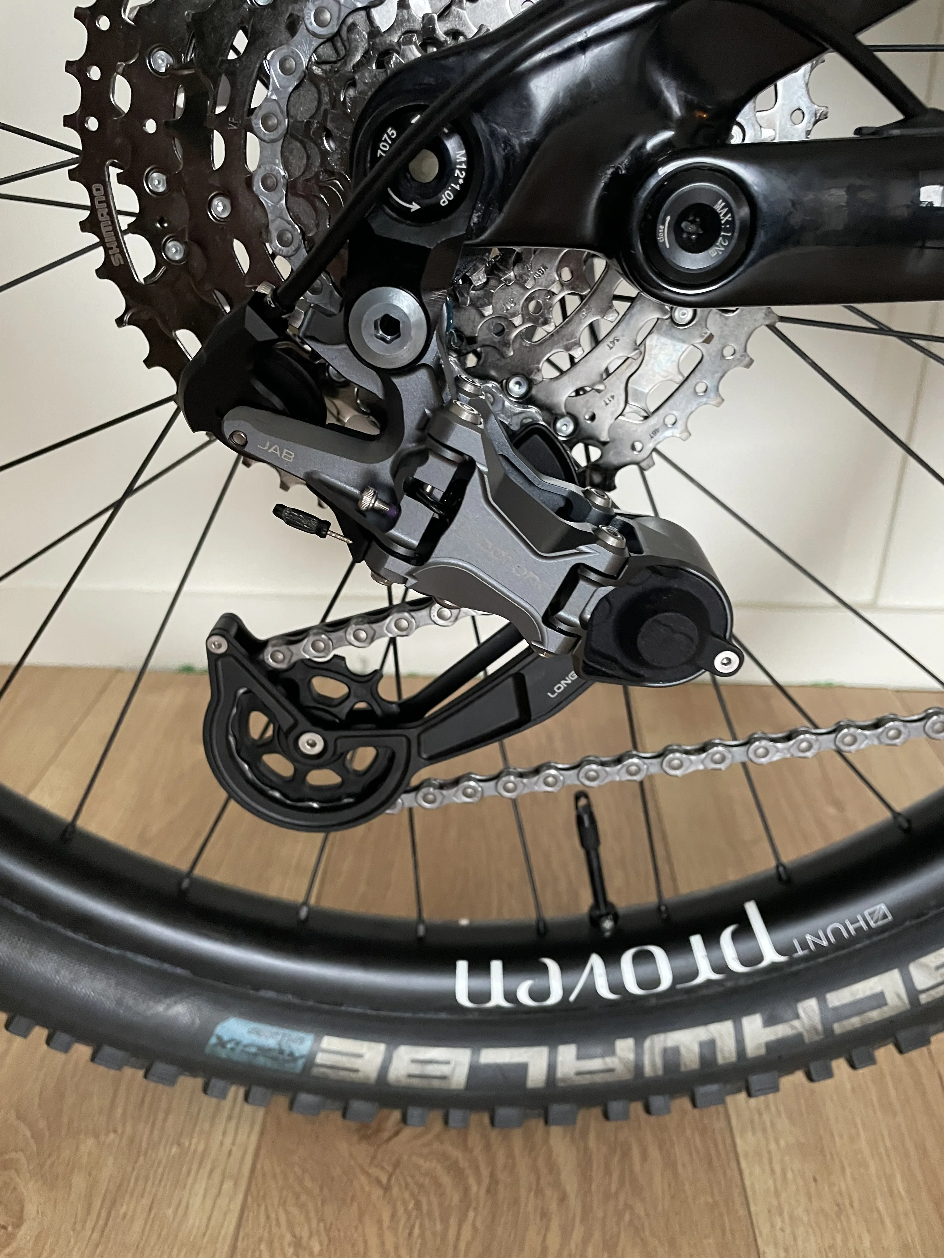

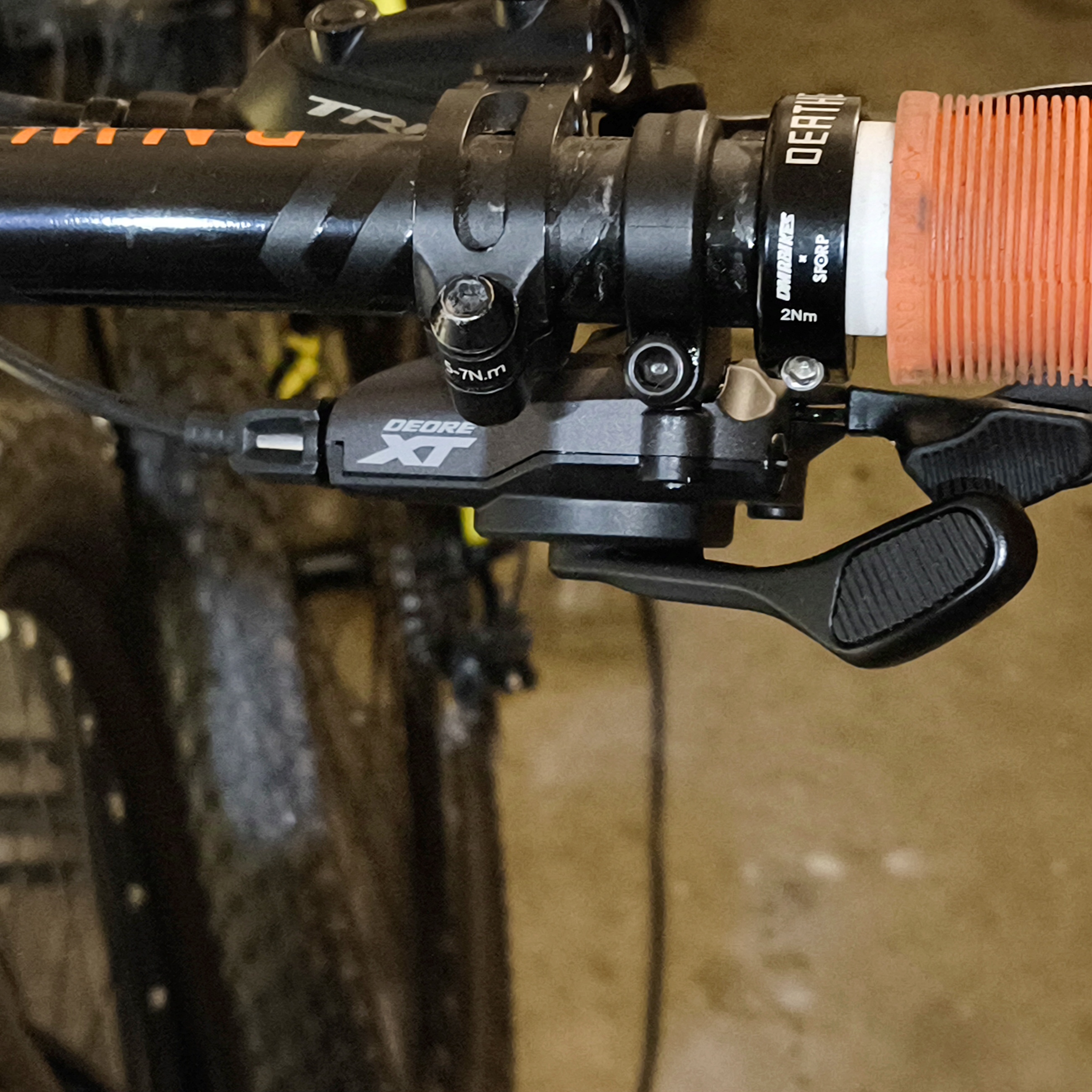

Just ordered the 10 speed Linkglide with the XT 11 speed shifter:
LG 400 cass 11-43 (as I realised I don't and won't ever need 50T)
M5130 Deore derailleur
M8130 XT shifter
LG 500 chain.

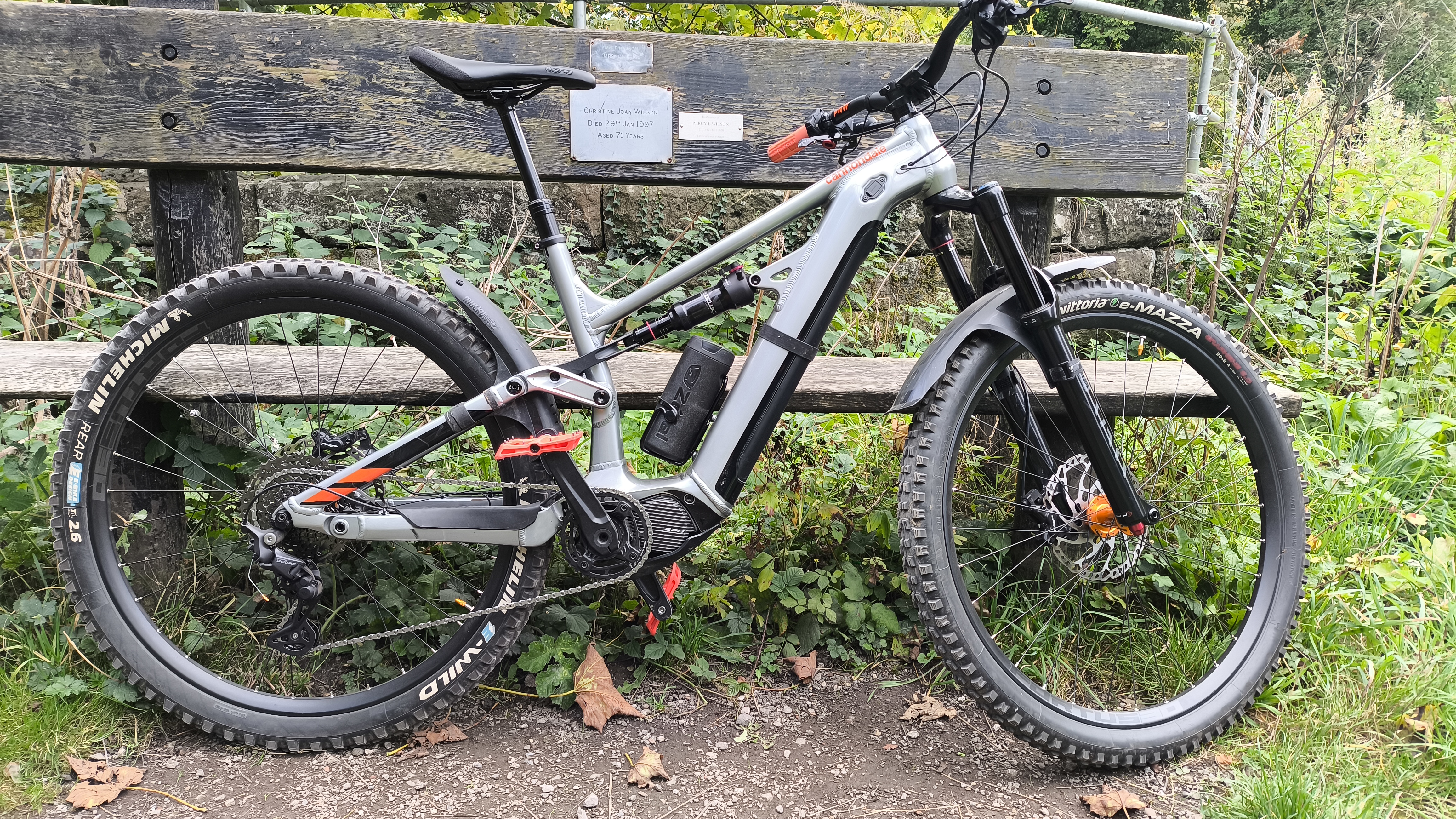

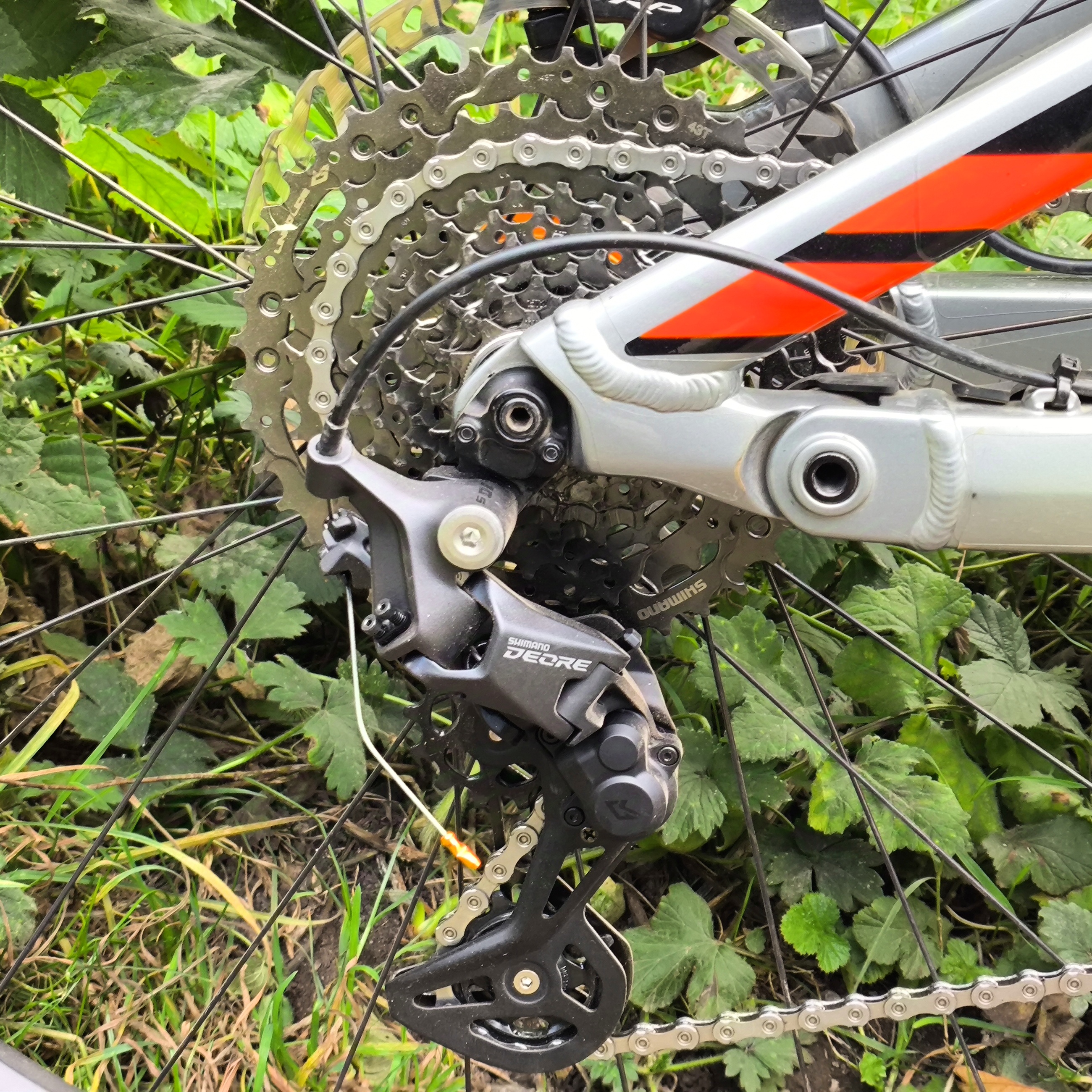

Yes it's fitted and all good. The only problem you'll probably run into is the original B screw is laughably short. I pinched the screw out of the SRAM derailleur I replaced (don't forget to swap over the small friction block before installing the longer screw).
When installed it's just a case of limiting the upper and lower screws to get the correct cassette range, and setting the B screw. The 11sp XT shifter works fine with the 10spd Deore derailleur. The shifter has single downshifts (going to a larger sprocket, easier pedalling) if using your forefinger, or double shifts if using your thumb. Which is great.
Shifting is a little slower, say 0.2 seconds which takes a while to compute that you need the pressure off the pedals slightly longer than normal, but once keyed in, it's a smooth firm shift. First ride setting the gear cable tension is also critical but easily done whilst riding, the drivetrain taking about 15 miles to bed in, it gets much smoother after those initial first miles and you change your 'off pedal pressure timing'. Single half shifts with the thumb (to a larger cog) aren't super accurate but work as your guessing the single shift point (bar the full double shift from the thumb).
Changing gear on techy climbs is WAY easier with the double shift, two full presses and you've moved 4 (over the NX shifter I had before) and being a 10spd and not a 12spd thats bloody fantastic for gradient changes. Here's a few pics:

I forgot to add, you will need a spacer between the hub and cassette (you will probably already have one fitted on the HG driver). Ensure it's on before torquing up to 40NM!

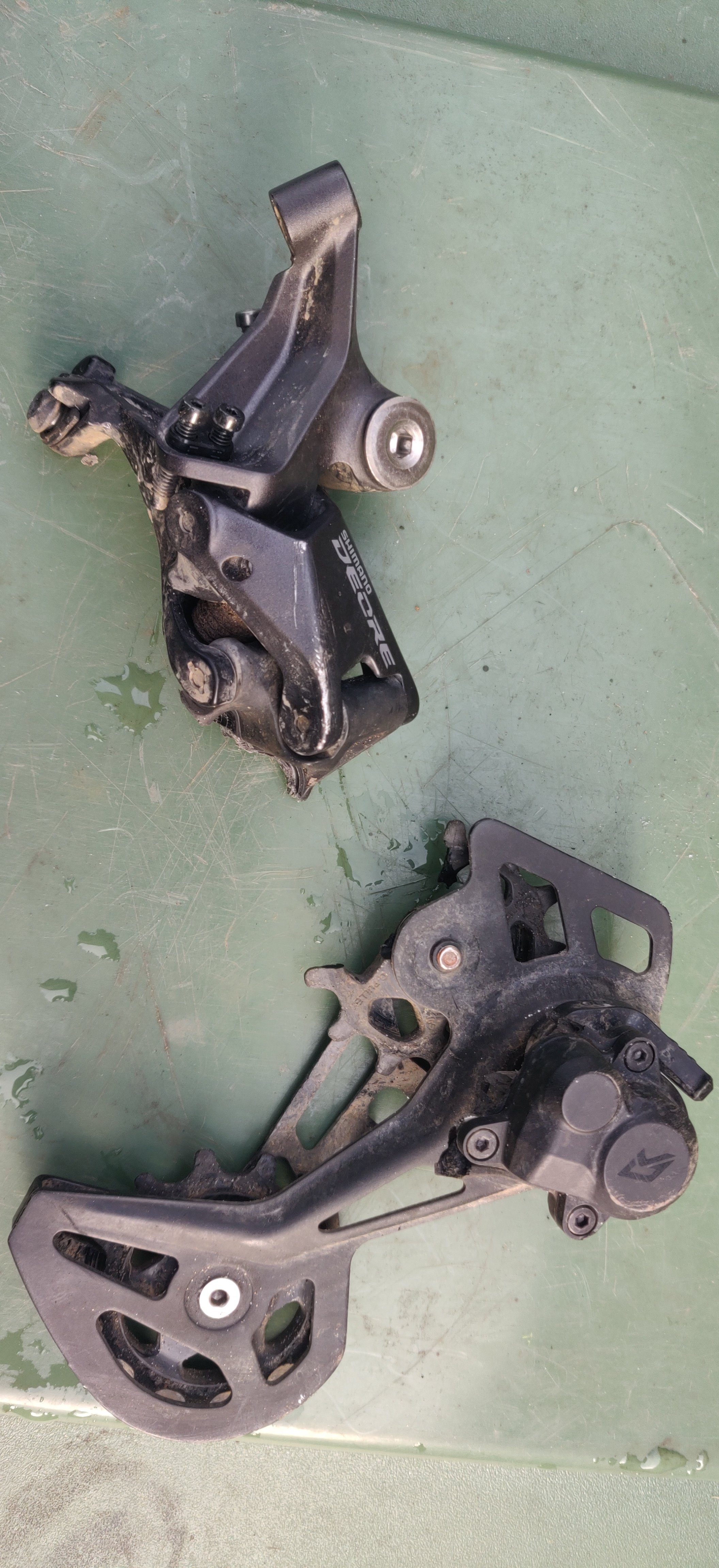

Took a big hit at the park today and exploded, luckily near the end of the session.
New one ordered from banana industries, who i have never used before and have doubts about 😬, but it was £25 with postage.
Sure glad i don't have one of them daft expensive electric sram mechs!
Usually break one each year so right on track.

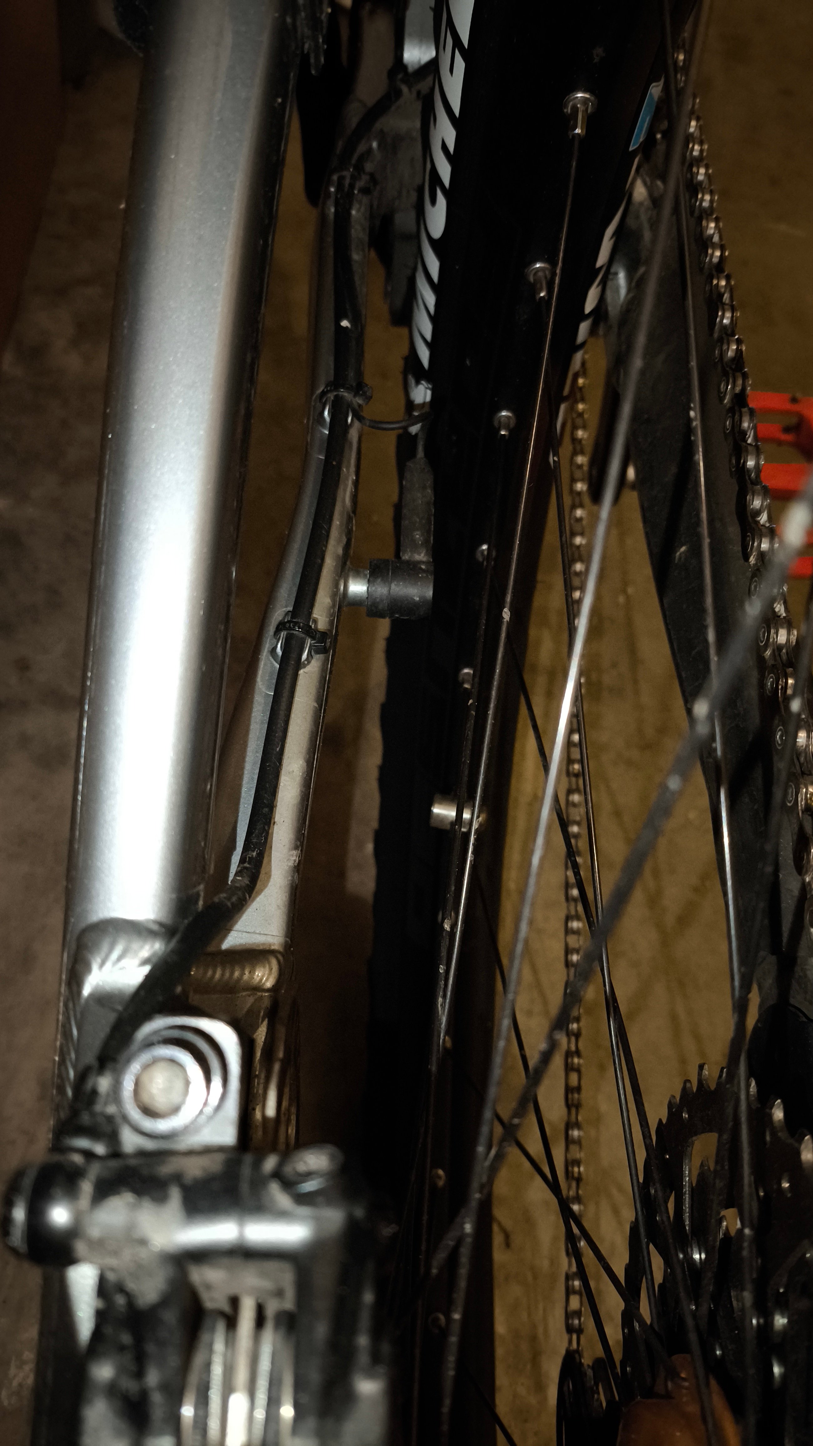

Ran into the first problem with the Shimano M5130 short cage mech today. I removed the rear wheel (easy), put a new tyre on the wheel but getting it back in was a 100% PITA. I ended up removing the derailleur slipping the chain on the smallest cog, got the wheel in then re-fitted the derailleur.
Anyone have any tips on getting the wheel back in? I tried all the usual methods of pulling the jockey wheel forward, taking the chain off the chainring etc but to no avail.... I needed a third hand as I couldn't hold the wheel, pull the mech forward and fit the chain all at the same time. I was using a bike work stand..is it easier with the bike upside down with Shimano mechs (as they don't have a SRAM type wheel change lockout)?

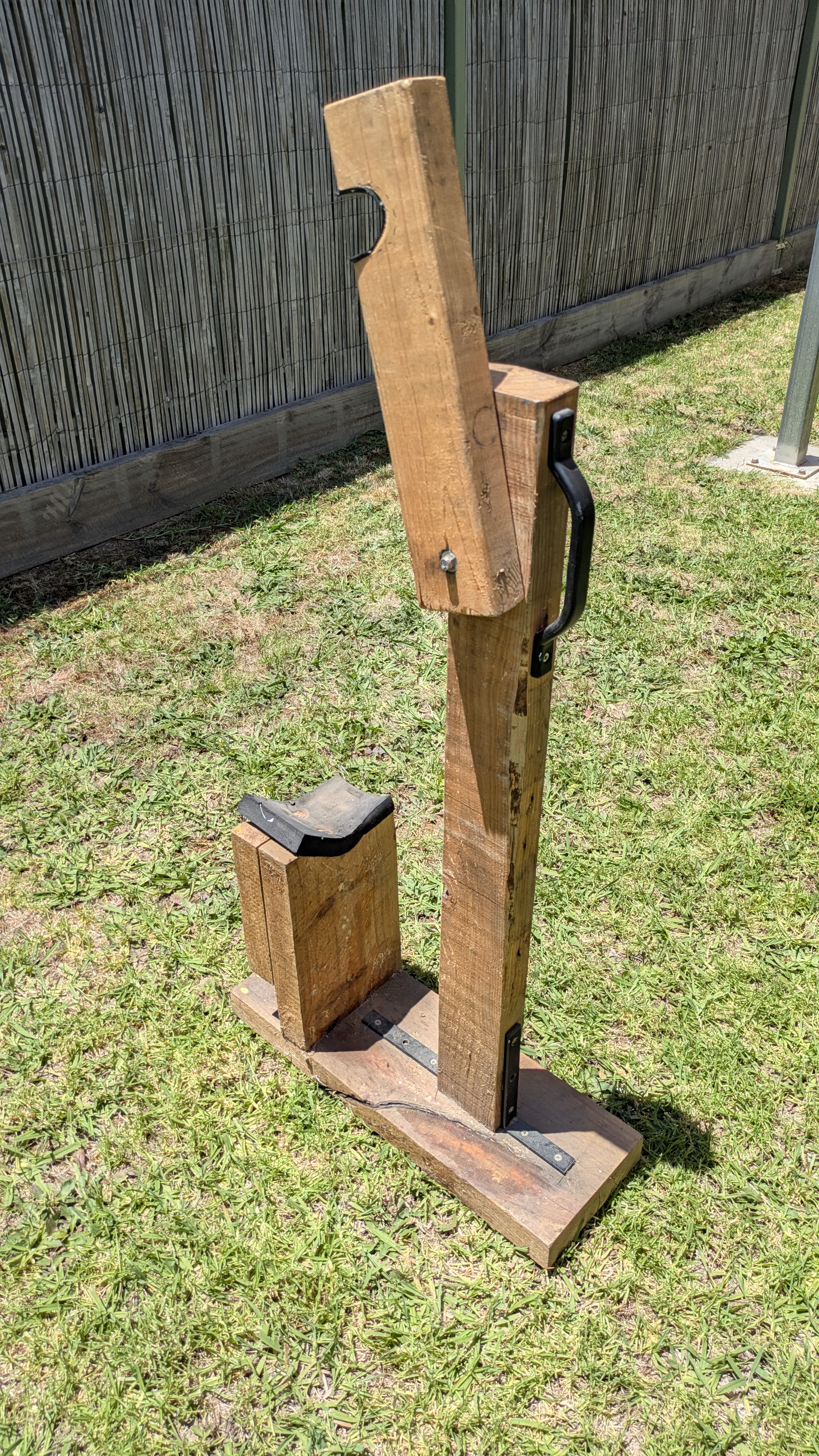

Maybe removing the chain would be the simplest way around this ? I assume you are moving the clutch lever forward to ease the tension on the cage ?
The mech can be a handful to pull back and refit the wheel at the same time but that's how I do it. I don't use a regular work stand though. I hate those things and don't know how most people put up with the bike flopping around while you're trying to work on it.
My basic , home made stand....

Yes that's the normal procedure but it doesn't work on my bike and I've found the problem.
Amber Valley Guy
Oct 15, 2023
199
194
Alfreton
Found the problem.
Take a look at these pictures, the spoke magnet pickup sensor ( on the inside of the chain stay) gets in the way as it sits further in than the tyre width. So to get my wheel back in I have to get the tyre past the speed sensor which then pushes the wheel into the other chain stay, making it bloody difficult if not impossible to pop the chain back on and line the rotor up with the pads at the same time. The SRAM mech had more movement than the Shimano which is why I didn't have a problem before..I could pull the top jockey wheel up a bit.
