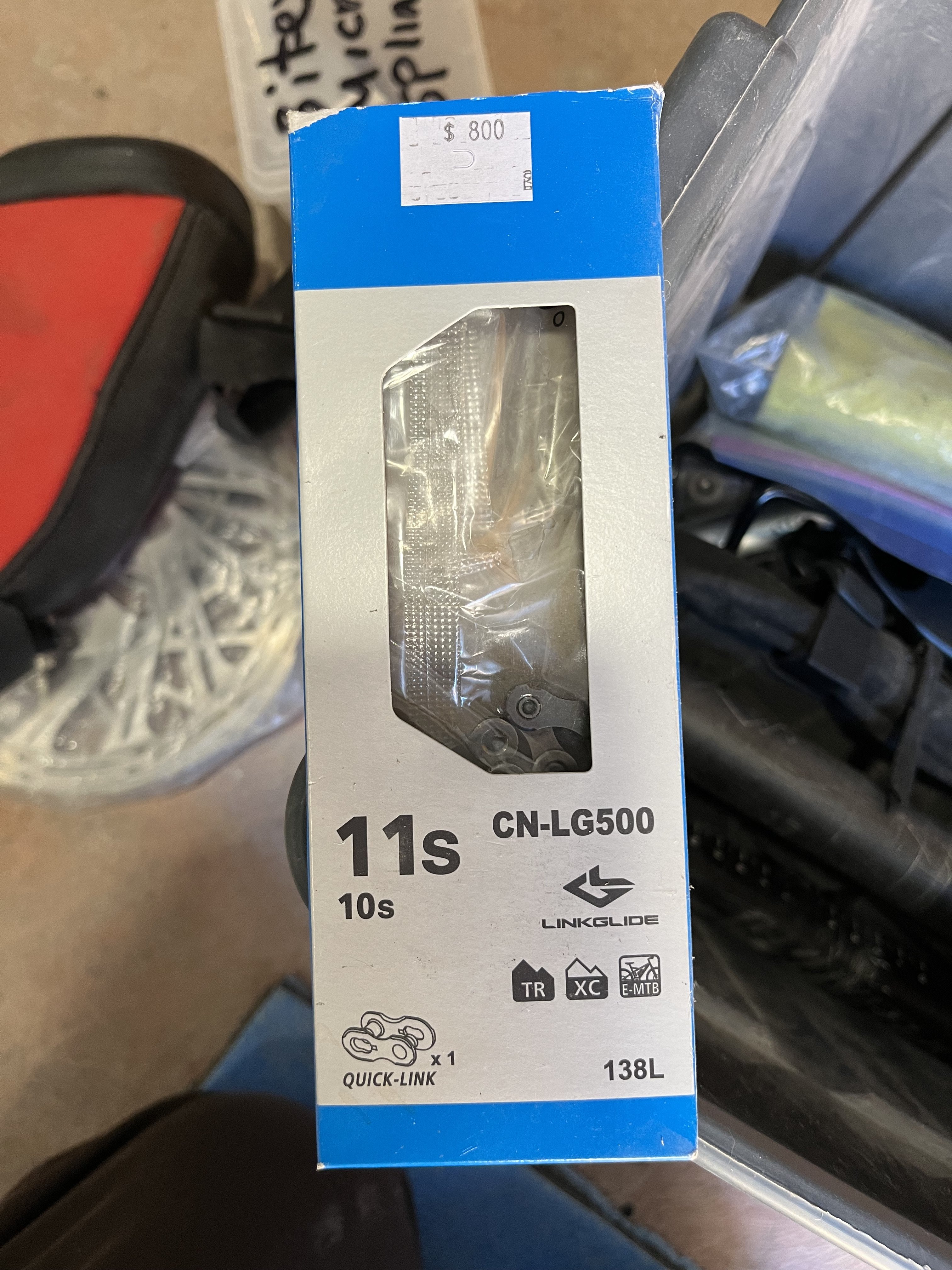

FYI - the CN-LG500 11/10 Linkglide has quick link and costs about $45
I see your location is Mexico, so maybe there's some kind of exchange rate difference or such. That chain sells for $29 at our shop full retail and you can find them all over the internet for about $24. Most at that price are 126 links, but it looks like even that 138 link is only $30. I use that 116 link chain on the Trek Rail 7 and 9-speed Cues components mentioned a few posts back. They've been bullet proof so far at over 800 miles and chain still showing good life with the chain checker. I'm actually pleasantly shocked for how inexpensive this whole drivetrain is.

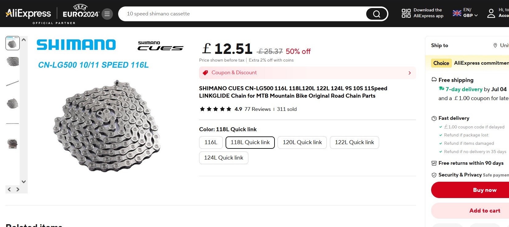

I buy the chains and cassettes from AliExpress. About $40 USD for both.
Chain
Cassette
My Linkglide drivetrain has now done 2000kms. The shifter and derailleur have been consistent and faultless. I have been replacing the chain at 1000kms and am about to replace the cassette at 2000. To be fair , neither really needs replacing , shifting is still very good!
Chain
Cassette
Never used AliExpress, always assumed it to be full of fakes and scams.
How on earth can a genuine chain be £3.50 instead of £30? Thats a pre tax price im seeing and without creating an account i cant tell how much it would be once it gets to my door.

I changed delivery to UK and GPB currency , got this...
Thats silly cheap. And you are happy they are not fakes?

Yeah , the current chain with 1000kms on it was an Ali special. It has just enough wear on it now that it will squeeze into the first indicator of the chain checker.
Bear in mind , 95% of my rides are in dry conditions and I keep the chain well cleaned and lubed.
My theory with the Ali stuff is , it's out of the same factory as the real stuff but it either doesn't pass QC or it slips out the back door. 😁
