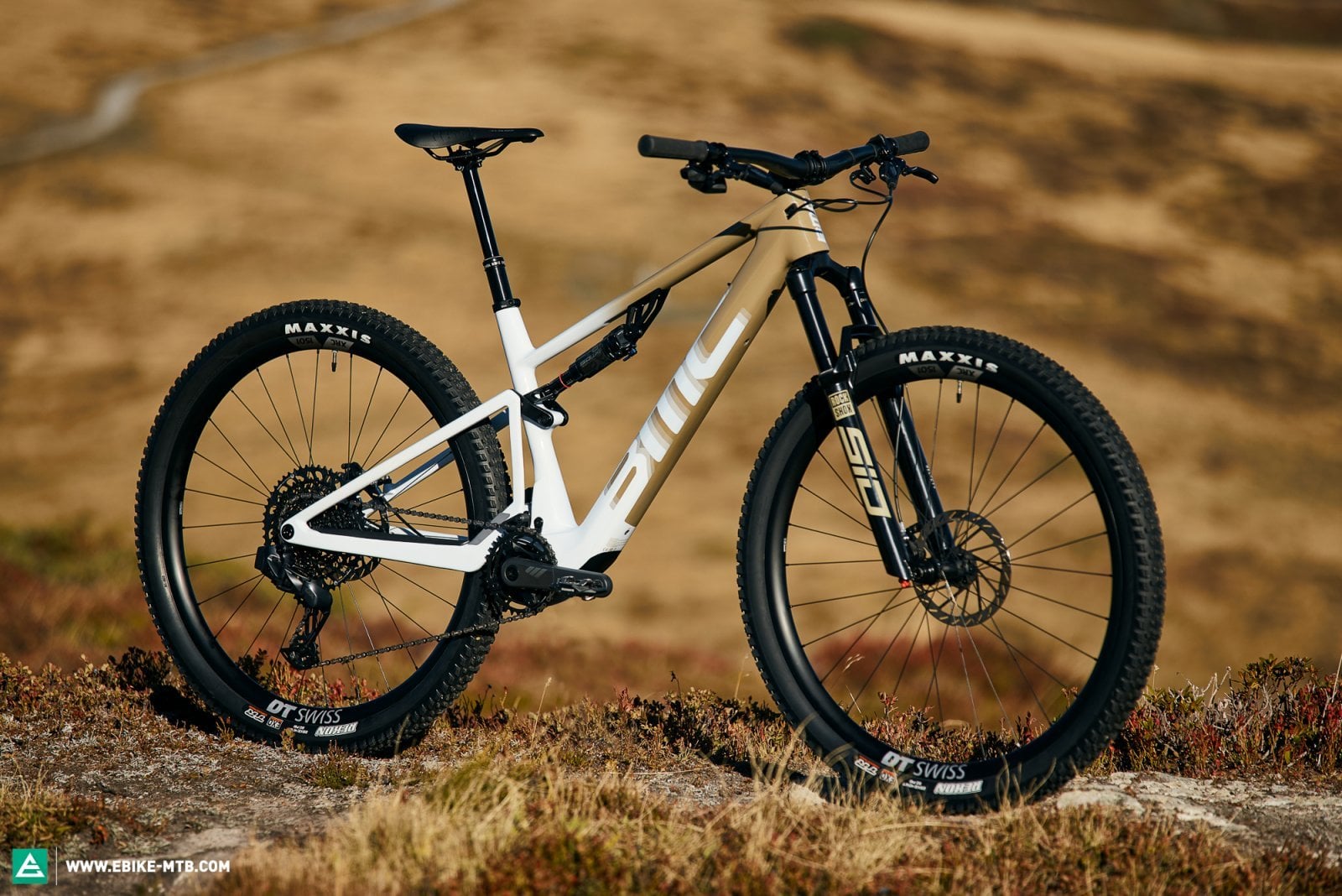

BMC

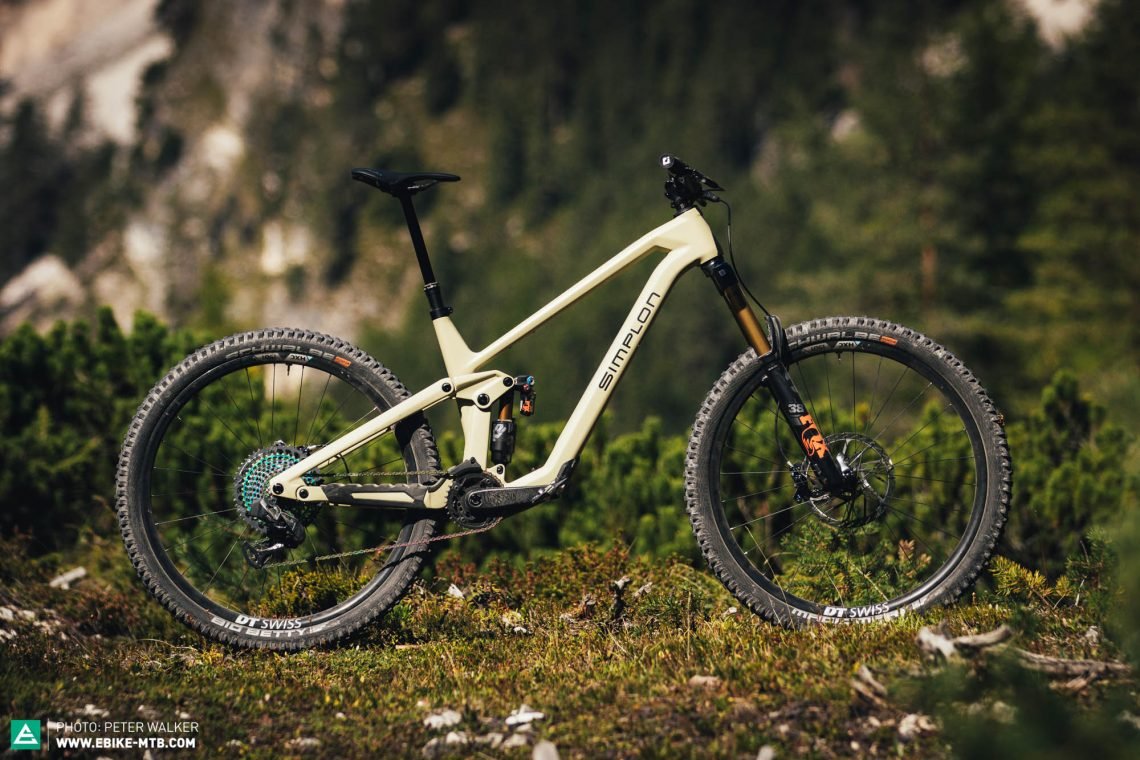

SIMPLON
I am sure we will see some more over the next few months - the above two bikes very different approaches so clearly the motor will be finding its way into all sorts of bikes.

That Simplon looks awesome! :love:

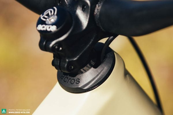

An then, a wild headset appears...
That's me out, oh well.

I actually rather like the BMC - I would slap a 130mm fork in though.
Whilst I totally agree that the motor on an EMTB means you can go straight to full on enduro with little consequence unlike a regular bike, for a lot of my local riding which is effectively mellow blue trails a bike like the BMC would be a lot of fun - for most of my local rides the sole reason for using an EMTB over a regular bike is time, and the ability to blast out an hour loop which you couldn’t do on an analog. The motor effectively enables you to get to the fun stuff quickly.

The simplon looks great (apart from the headset -cant decide if that headset would put me off a bike if everything else was right - it probably would), but there appears to be only one simplon dealer in the uk, and they are in glasgow, so that rules out simplon for most people in uk.

Also, you just know that it'll end up being called the Simpleton...

I vote for the Simpion as best of these!

That BMC looks beautiful- it’s designed for a mountain biker. As always 95% of mountain bikers are way over biked - same goes for ebikes - more travel doesn’t always equal more fun
