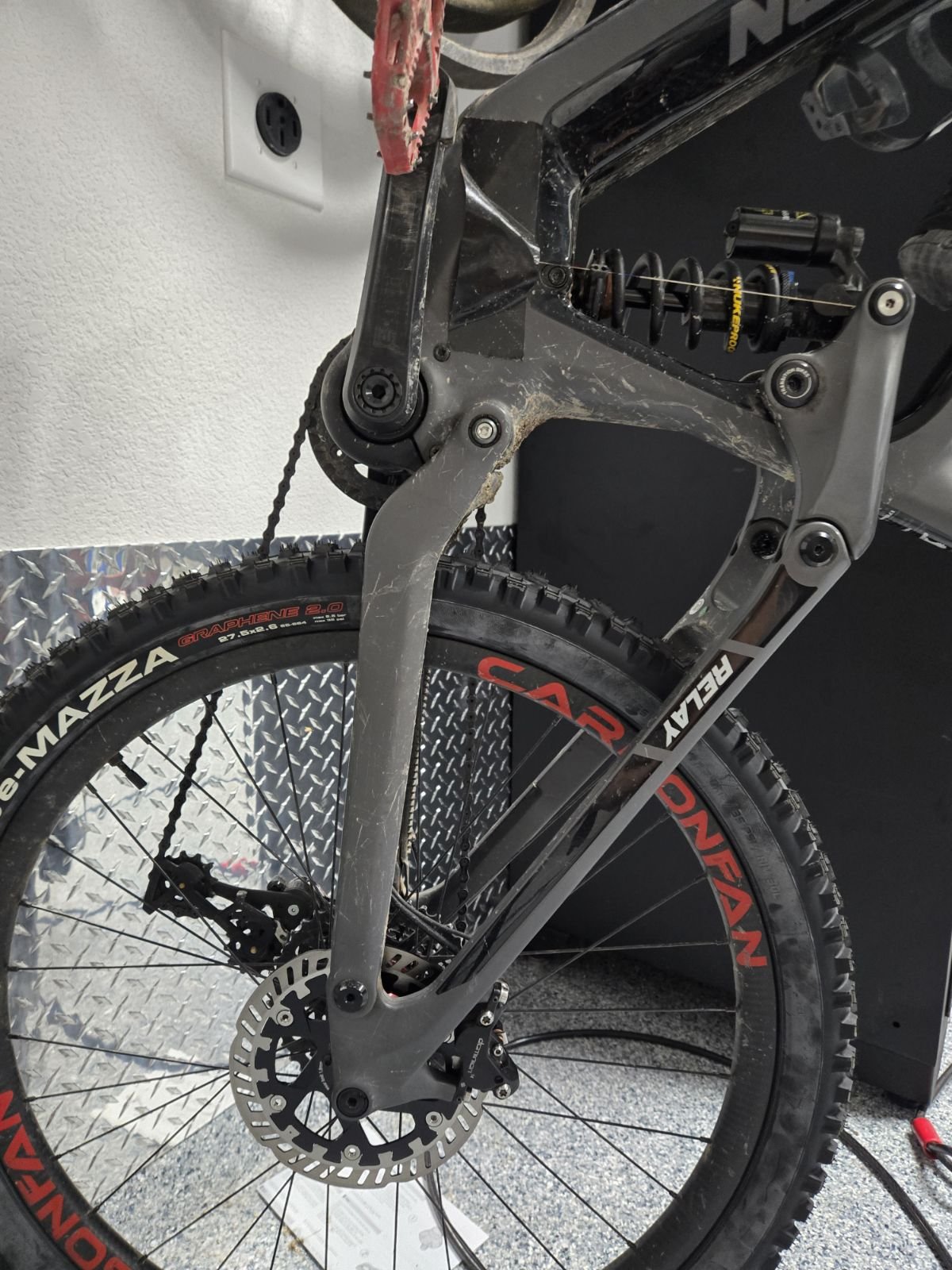

I‘m experiencing a load knocking sound coming from the BB area i assume.
Happens when charging over roots and rocks or when lifting and then dropping the bike.
Maybe it‘s the dhx2 (sounds similar to when the shock is loose / loose spring, defective bushings) but I didn‘t find anything wrong and also torqued all screws of the bike again.
I need to try another shock to eliminate that possibility.
Other possibility would be that the motor is doing this noise and something inside is loose.
Anyone had a similar issue so far?

Maybe, the 2 knocking sounds I had were
1) Loose cables from the Motor BB area- wrapped them in foam
2) Loose lower chainstay bolts, it made it sound and feel like a bad rear wheel bearing- tightened and went away

Also had 2), for 1) i never had issues but also added foam to exclude the cables just this week.
I highly assume it‘s the motor, i‘ll update you

turned out it was a Defective DHX2, the base unscrewed a bit from the top (it‘s screwed on with high torque and high strength loctice, shouldn‘t unscrew at all). I was losubg oil bit by bit, finally the damping didn‘t work properly and caused a load cloncky noise, similar to a loose spring / bad bushings.
Have a Marzocchi bomber CR in now and send the DHX2 for service.
Luckily it was not the motor 😀

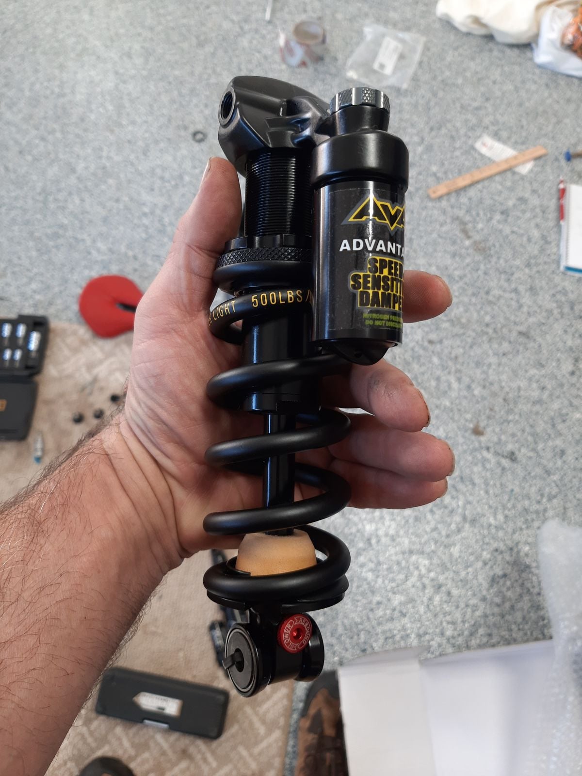

In Germany it was easier to get the non PNW version, especially with some discount. I went for the GX AXS version and swapped everything except the dropper and the drivetrain. Dhx2, maven, zipp moto mullet, fox 38, oneup bar…

I see. Thinking of swapping the DHX2 out for something else? I have a Push 11.6 on the Relay and EXT E-Storia on the TR11. Both are fantastic by my usage. Cane Creek TiGon would be my next choice. The DHX that came on the PNW relay has been regarded as the worst coil shock on the market. I looked at the DHX2, but decided to go a little bougie. haha. Definitely don't regret it.

Hehe, Push and EXE are of course the high end choices 😃
I went for the DHX2 because on my jeffsy i‘m also running one and quite happy, also it was very relyable, -well, was 😅
I sent it to Fox for repair and also to get it tuned to the relay.
So currently i‘m sticking with dhx2, was also happy on the relay as long as it worked.
Next one will be probably exe or öhlins.
I bought an marzocchi bomber CR for the repair time, feels somehow quite firm/overdamped compared to the dhx2. The DHX i didn‘t try but it‘s the successor of the Van coil (basically a marzocchi bomber), so might be a bit similar.

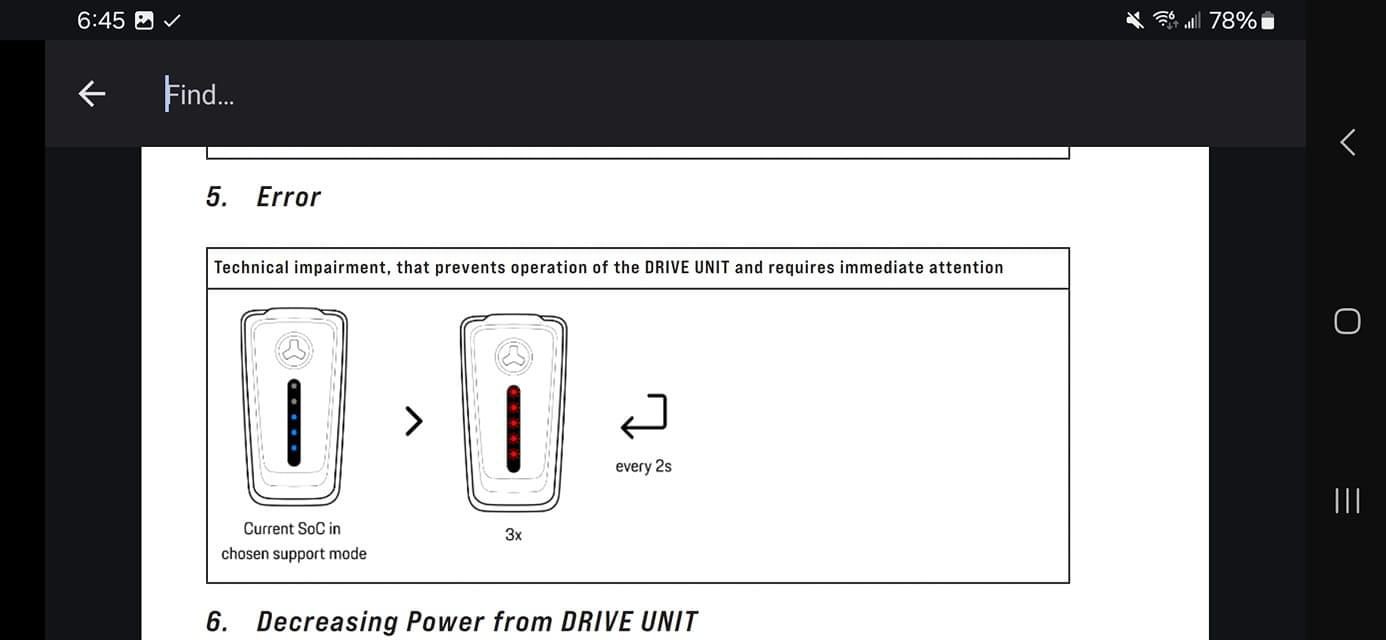

All, had an odd issue at the bike park today and can’t seem to find any data online. Installed my battery and all 5 lights on the display flashed red. The flashes were in a sequence of three, pause, three flashes, etc. no power and could not use the bike. Any idea what this fault means and how to resolve? Nothing I can read says anything about all five lights flashing red, only a single one. Any help would be appreciated. I’ve got a big ride coming up so want to resolve as quick as possible.
The only mention of red LED flashing is from a drivepack impairment. Do you have any errors on the app?
So unfortunately with the flashing red lights, it won’t connect via Bluetooth. It tries and I can see the blue lights doing the “connecting” thing, but just as it connects, it drops the connection and goes back to the flashing red lights again.
Looks like I found what it means in the instructions, any ideas on this?
every now and then I get flashing red lights. Almost always after I let the bike turn itself off and then turn it back on to resume the ride. Pulling the battery for a second or two has always done the trick. Only once or twice have I seen red flashing after inserting the battery. And again, just disconnecting the battery for a second solves it.
Hopefully your issue isn't anything serious. Keep us updated.
So unfortunately I've take everything apart, cleaned it well, and reassembled - same issue, all lights flash red 3 times, delay, then again.
Doesn't seem to be something I can resolve at home - so to the LBS it goes tomorrow. Bummer - I've had good luck with this bike so far and love it. I have a week off next week and was planning a full week at Kanuga, Rock Creek, Fire Mountain, Bakers and more. This will be a huge let down if unable to enjoy.

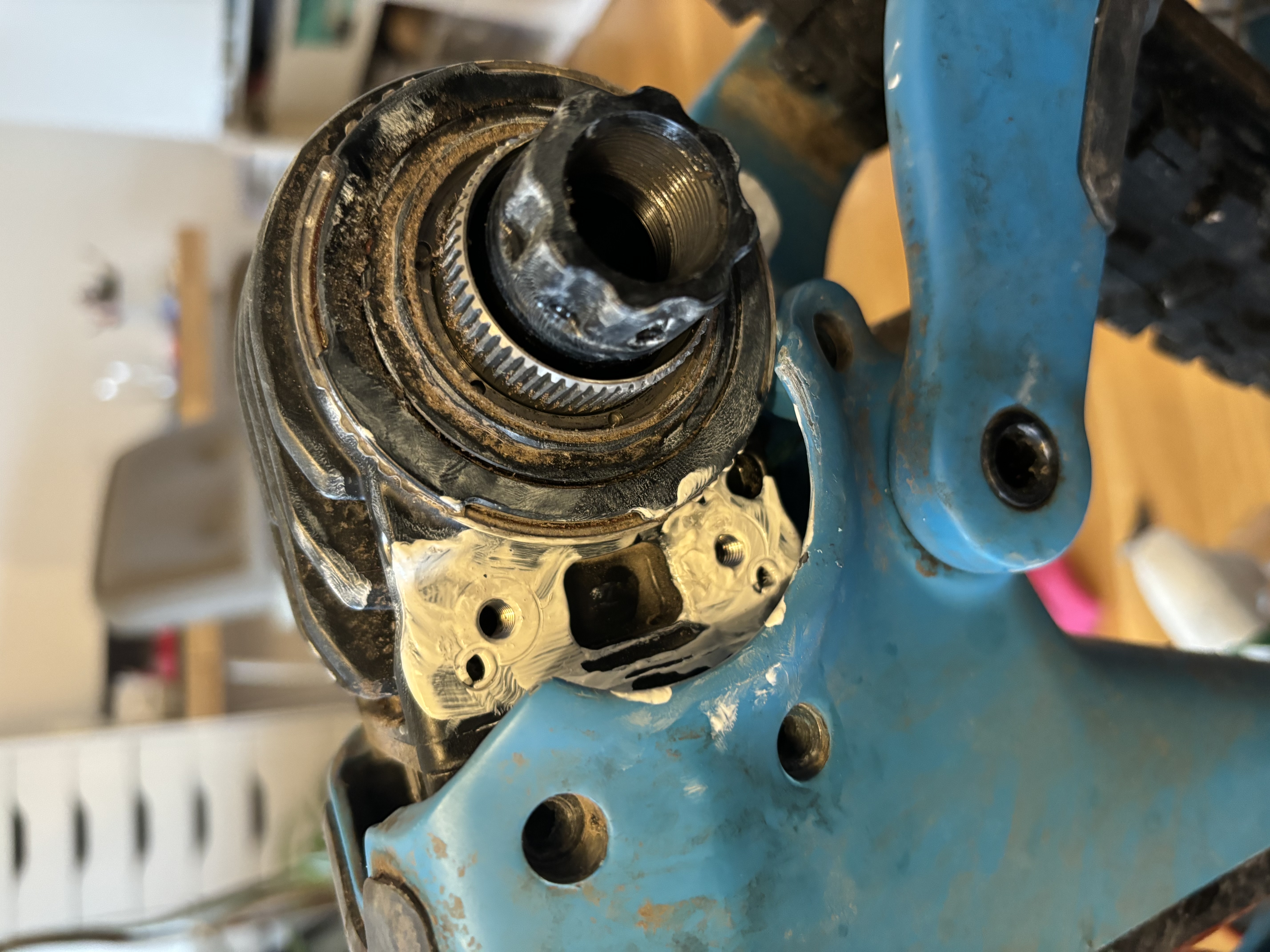

I just made same anti squeak noise maintainment.
Thanks Mr. Tonka for the hint with the chainring screws. 3 of 4 already loose.
I applied assembly paste to the contacting surfaced, sticked the screws with locktite, applied a bit force clockwise (chain pulling direction), and torqued to 8,5Nm, this hopefully does the trick.
Regarding the motor metal sleeves it was quite tricky not to lose the small „grub spring“ (the one blocking the metal sleeves from twisting), because the motor couldn‘t be pulled out more to make it convenient. If it falls down it‘s lost in the frame.
How did you do it? Any trick?
Anyway, it worked out and i put assembly paste to the contact surfaces, metal sleeves and „grub springs“.
Let‘s see if and how long it helps.
One other topic, unfortunately my rear brake hose is faulty from factory and i need to replace it.
Anyone did this already?
Mine started creaking again after 2000km, I just applied copper anti size paste. Let‘s see how long it holds up.
@Mr Tonka is yours still squeak free? How many km/miles since ypu applied the copper anti size?
1 of the chain ring screws also got loose just recently btw. Retorqued again with loctite (9Nm)
My motor bolts are still creak free. Last time I did them was in March I think... I'm not sure of the mileage.
