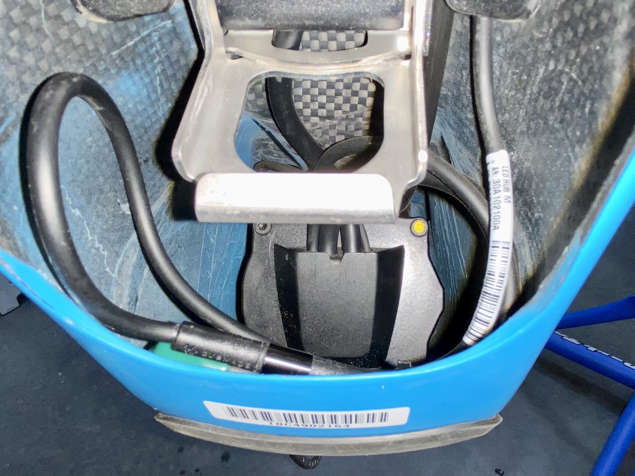

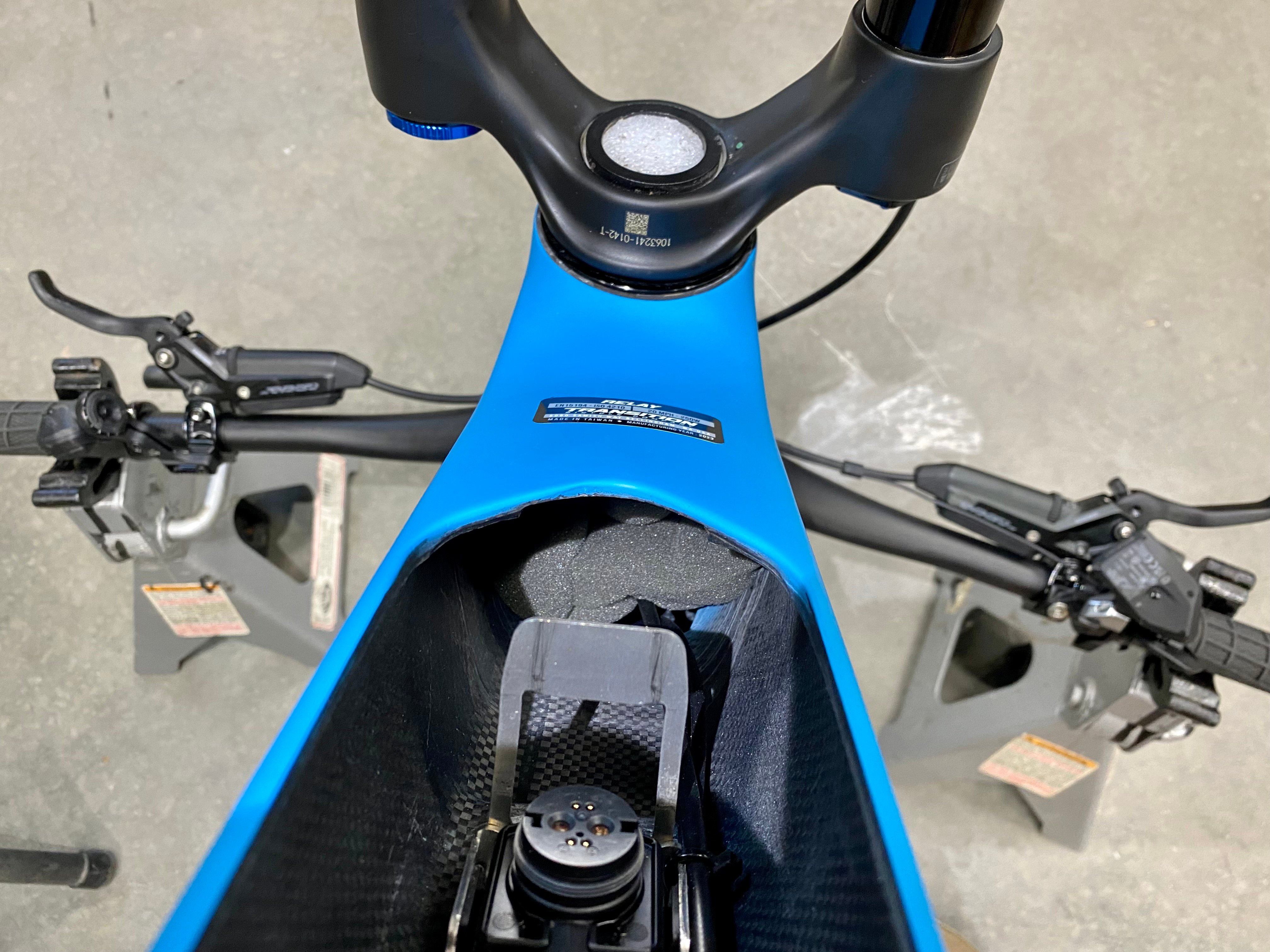

Also, if you remove the battery and look in the frame above and below the battery you'll all sorts of loose connectors and stuff flopping about. Zip ties and possibly some foam are going to be your friends here.

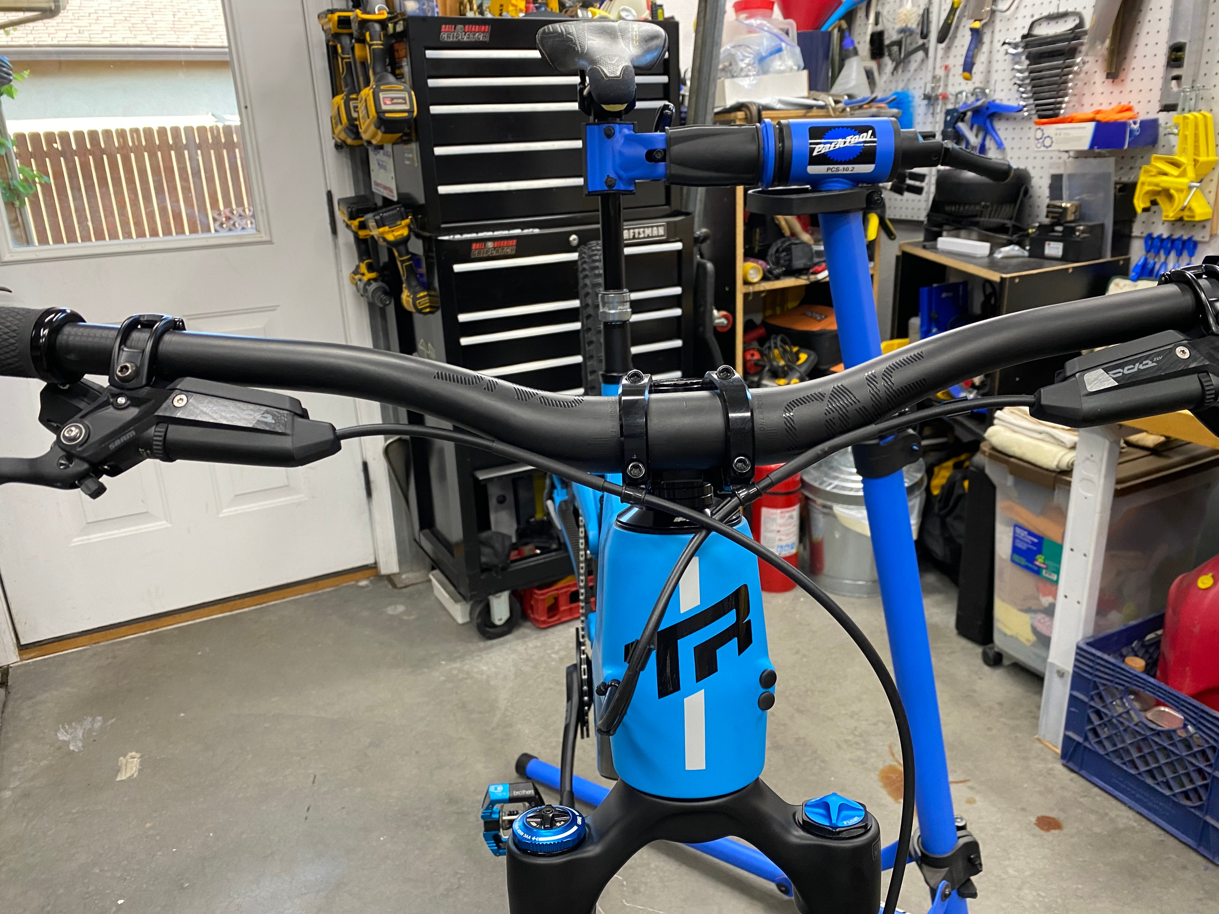

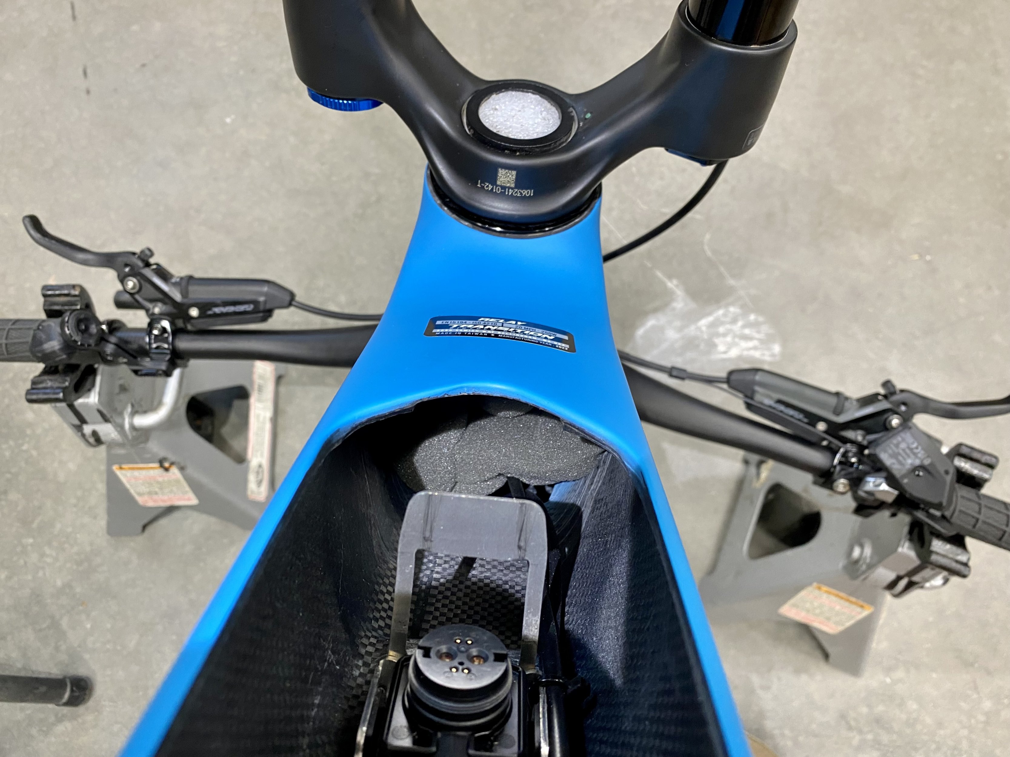

In the process of rerouting the rear brake cable exit to the other side of the frame headset to have a clean moto style brake configuration. And while reviewing were I could add some foam to prevent cable rattling the view to the top of the motor shows quite a bit of space between the motor and frame. I think the motor noises could be damped by pushing foam into the free gaps; thoughts? The extra clearance likely aids in heat dissapation and insulating foam wouldn’t help this; but there are cooling fins on the bottom. The motor control system certainly has thermal protection? Anyway I do plan for some foam in front of the motor to reduce cable rattling.

I intend to get some of that very light grey pipe insulation and place the cables in the center and stick a piece right there when I get my Relay back from the shop for a motor replacement.

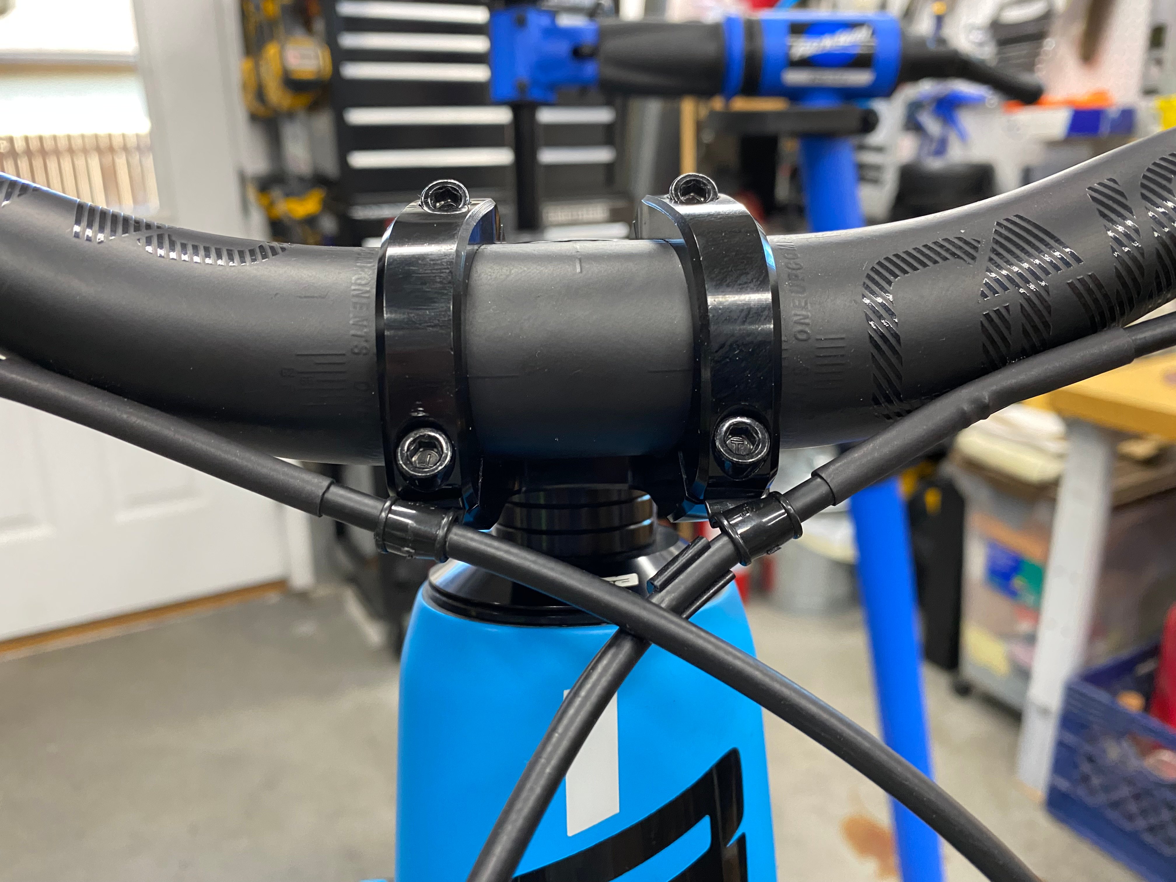

Next issue was clean up the front cable routing, length and move it to moto style; front brake should only ever be on the right. Idea was from this sram vid . Used 18 gauge plastic wire clamps for brake cable stem mounts. IMG_4769.jpeg IMG_4771.jpeg IMG_4777.jpeg

I had persistent rattling noises even after checking several things.
So then I just grabbed some gasket sealant and squeezed it into the head tube cable ports right around the cables, and problem solved.

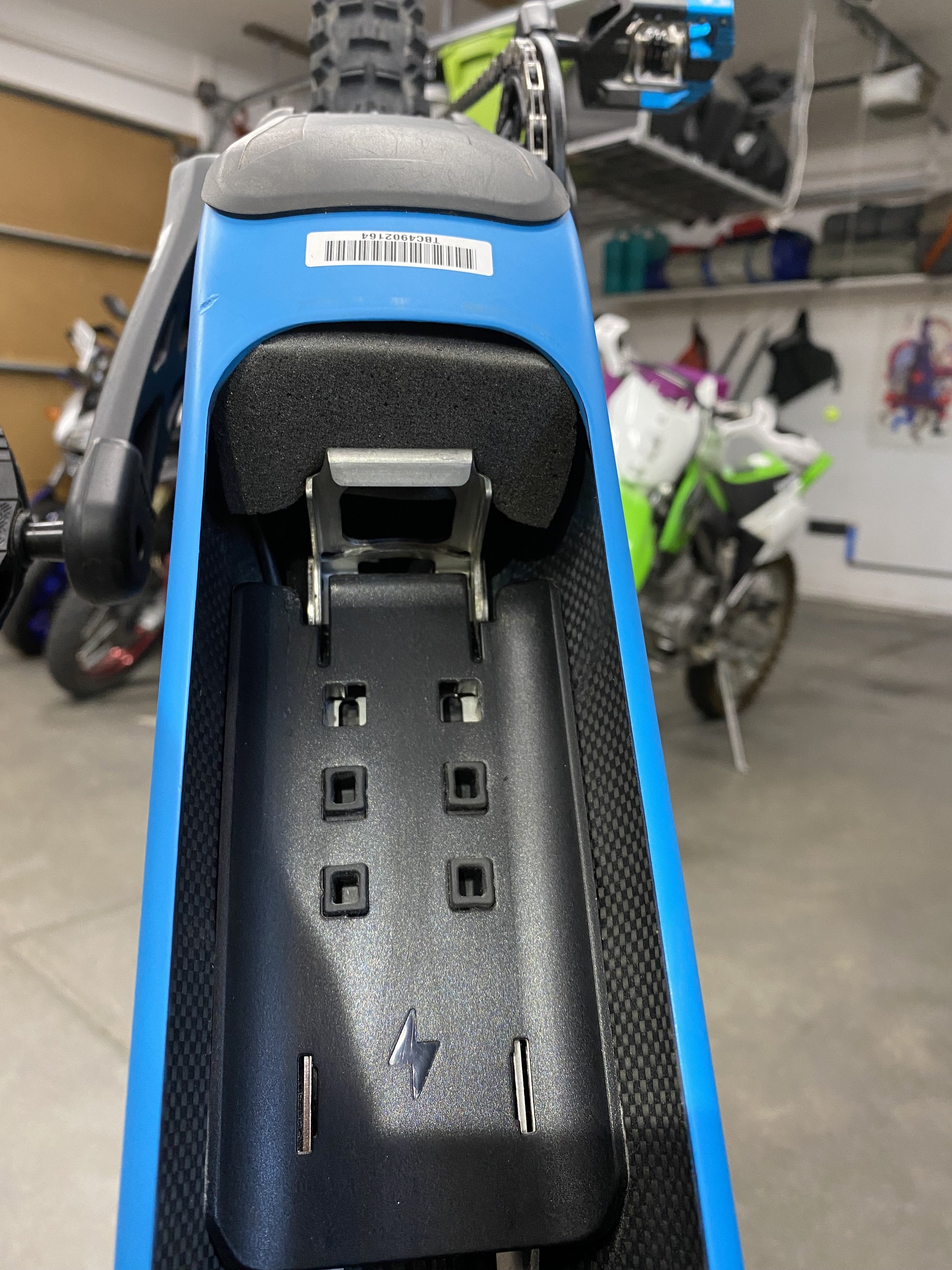

I had a bit of an issue with by battery cover flapping against the battery so I stuck a bit of window seal on the inside, solved that issue.
Hi, do you have a picture of what you did please. I’ve just ordered a spare cover, so I can try and modify my original to make it fit better. Have already steamed cover and reformed to make it seal better. Battery still got wet after a ride though.

Here's the list of things I've done so far- based on this and MTBR the bike is deadly silent
  • Added mastic tape on the lower chainstay to stop Rear brake hose/Speed sensor rattle
  • Foam/Pool noodle above and below the battery compartment
  • Velcro strap around the Battery lid
  • Opened zip tie in both internal cable routing entry points

@Suns_PSD- I was thinking about wrapping my cables at the entry point with Mastic/electrical tape, but was curious about your Gasket Sealant you used

I have steamed and reshaped my battery cover. I really don’t want to put a strap around battery compartment. Looking at getting some thicker foam as water still got into battery compartment. I wrapped all the cables in the void above battery with foam. I do like your idea of pool noodle though.

I've read that some users are adding rubber gasket/Window seal on the cover
For me, the velcro strap does a pretty half-decent job, it does allow water ingress but the amount that it allowed in after riding in the rain/snow + bike rinse was 1-2 drops on the foam...tbh I'm not 100% that it wasn't water coming through the drain hole on the lower chainstay
I wish I did, but the bike has moved on to a new user, It was a strip of the one sided sticky window seal just down the center.
