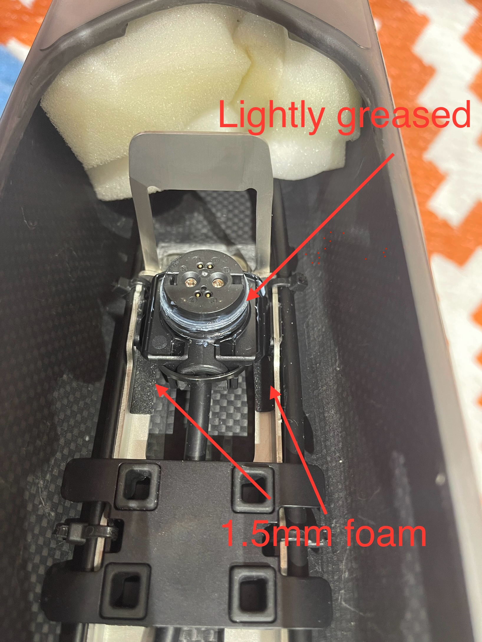

I've had some issues with the Relay turning on, displaying lights, but no power. Usually resolved by turning off and back on. Also have turned it on to get the flashing red lights, usually resolved by popping the battery and putting it back in. But I have been trying to be better about turning the bike off when I know it's going to be stationary long enough to turn itself off. And not once have I had either issue when I physically turned the bike off and then back on. Seems like the system has a bug regarding time out turn off. Didn't take notes or get scientific about it, but that's what my experiment points to.
Bringiton
Jun 29, 2023
8
Canada
I've had similar issues.
Sometimes the bike will just turn off while I'm riding, usually after a hard impact or rock garden. Upon turning the bike back on the lights will appear but there will be no power to the motor. Reseating the battery always solves the issue.
I've also had it just shutdown twice while climbing smooth trails and have no lights/not turn back on again until I reseat the battery. I've inspected the battery, cables and port and nothing looks damaged but there is defiantly something wrong.
I’ve noticed the bike powers down after I’ve been stopped for a while (battery saver I presume). What usually happens is I set off and think “this feels a bit sluggish” look down and notice at that point the display is off. You can’t seem to start the system if bike is moving. You then have to stop and then it turns on. As far as cutting out mid ride, I ve not had that, but during rattle/ knock solving, I noticed the battery connector was very loose on its chassis. Also the rubber seal around connector created a lot of friction which was making the connection not go fully home. I have attached a photo of my mod, that resolved this.

Any specific grease? IE dielectric? marine?
I've also had the power down after resting/chatting- I think its around 5 mins

I have owned a Relay for 2 weeks. I had the same problem bike shutting down on rough trail. My theory is the battery comes disconnected slightly. I have had to very slightly bend the metal tab down to get the battery to lock in good.
My first Ebike I originally bought a Relay for my wife and that turned into us fighting "I was riding it to much" So I picked up a Relay for my self. It's so fun to ride crossing my fingers we have no motor issues.
I added some foam under the connector like Poggs38 said in his post and I have not had it turn off since.

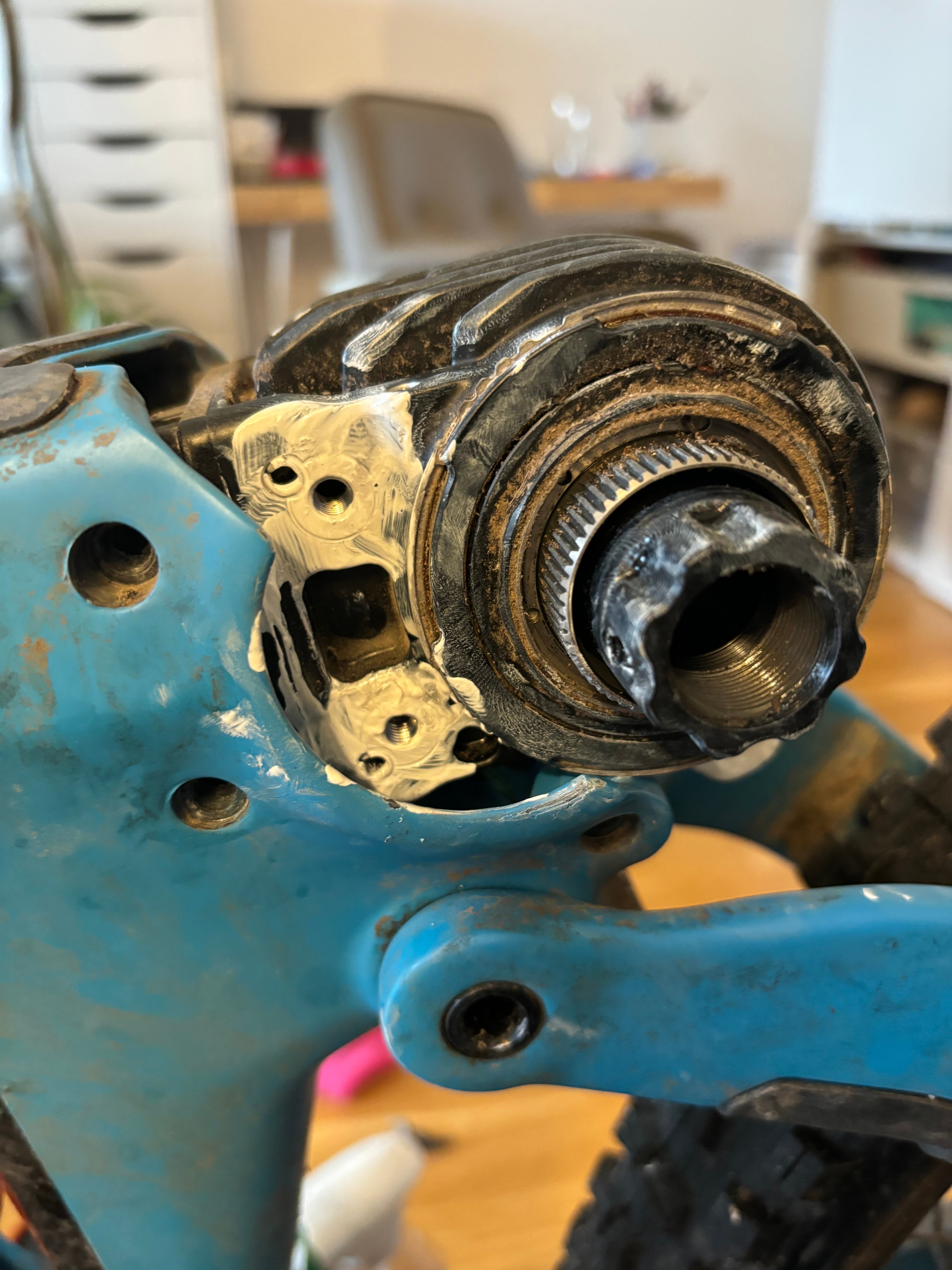

I just made same anti squeak noise maintainment.
Thanks Mr. Tonka for the hint with the chainring screws. 3 of 4 already loose.
I applied assembly paste to the contacting surfaced, sticked the screws with locktite, applied a bit force clockwise (chain pulling direction), and torqued to 8,5Nm, this hopefully does the trick.
Regarding the motor metal sleeves it was quite tricky not to lose the small „grub spring“ (the one blocking the metal sleeves from twisting), because the motor couldn‘t be pulled out more to make it convenient. If it falls down it‘s lost in the frame.
How did you do it? Any trick?
Anyway, it worked out and i put assembly paste to the contact surfaces, metal sleeves and „grub springs“.
Let‘s see if and how long it helps.

I also added a small bit of foam under the battery plug to make a more solid connection. Added a bit of lube around the gasket as well. (both are tips I found in this thread) Zip tied all the wires and cables back down, added a bit of foam in the down tube above and below the battery. Bike was very quiet and solid feeling the next ride.

Btw, the anti squeak work with assembly paste payed off, completely silent now, let‘s see how long it holds up.
