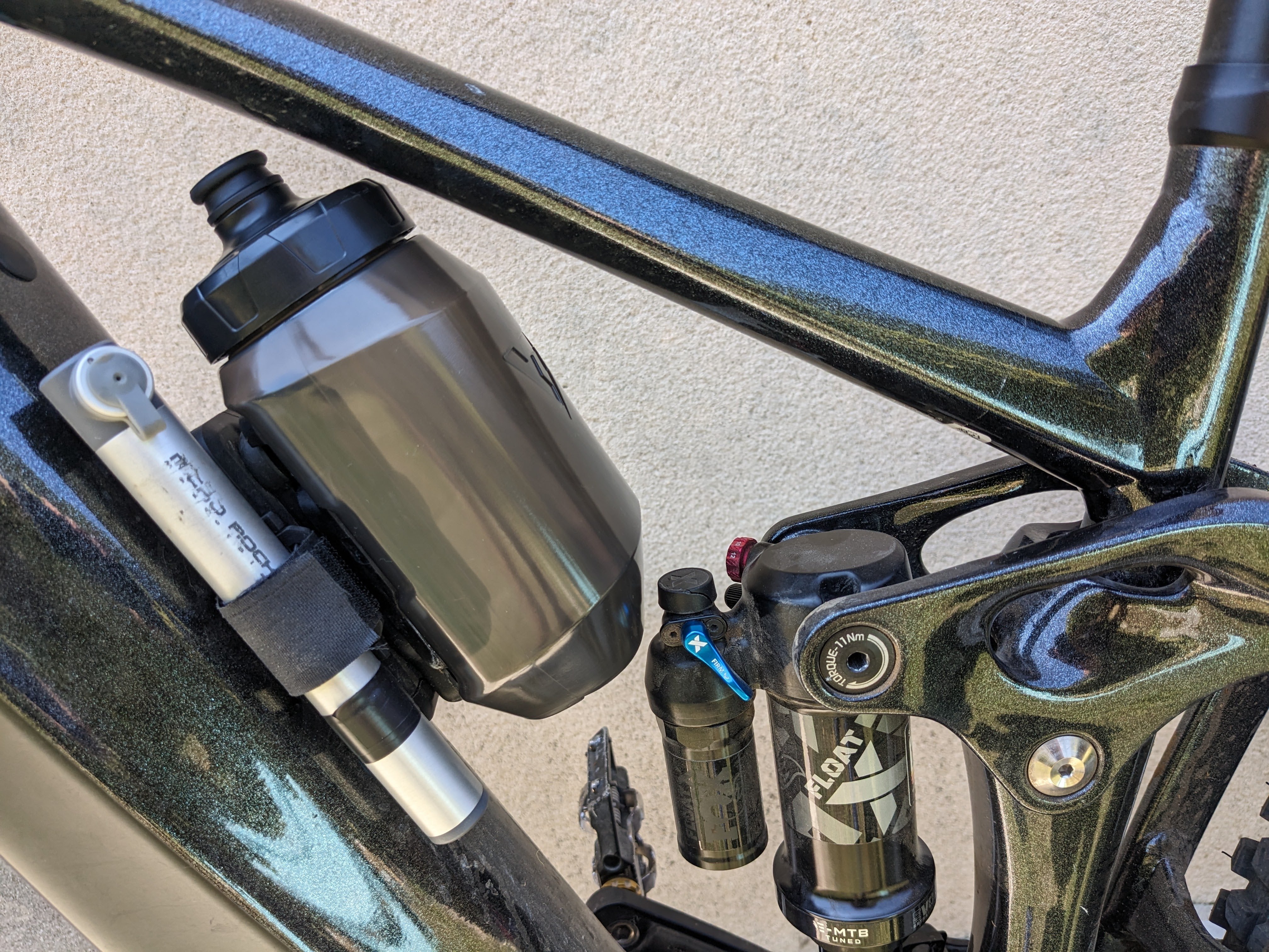

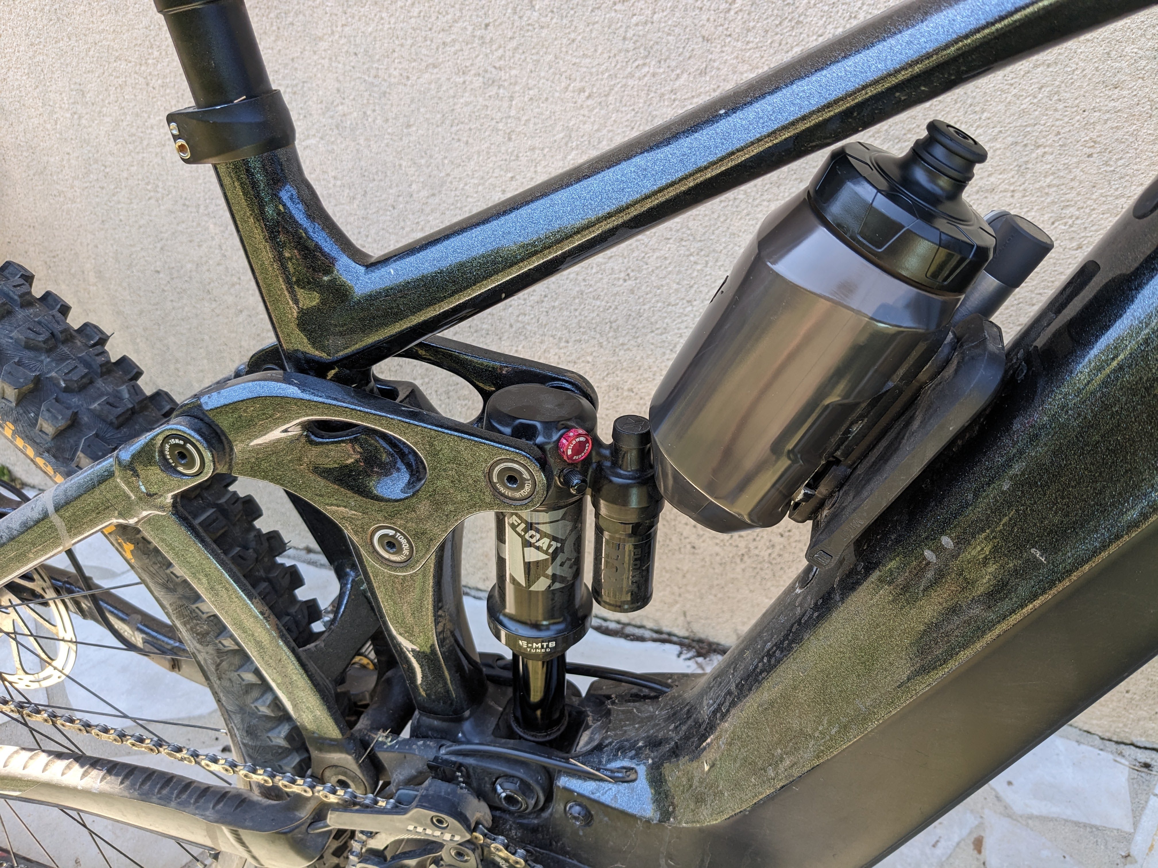

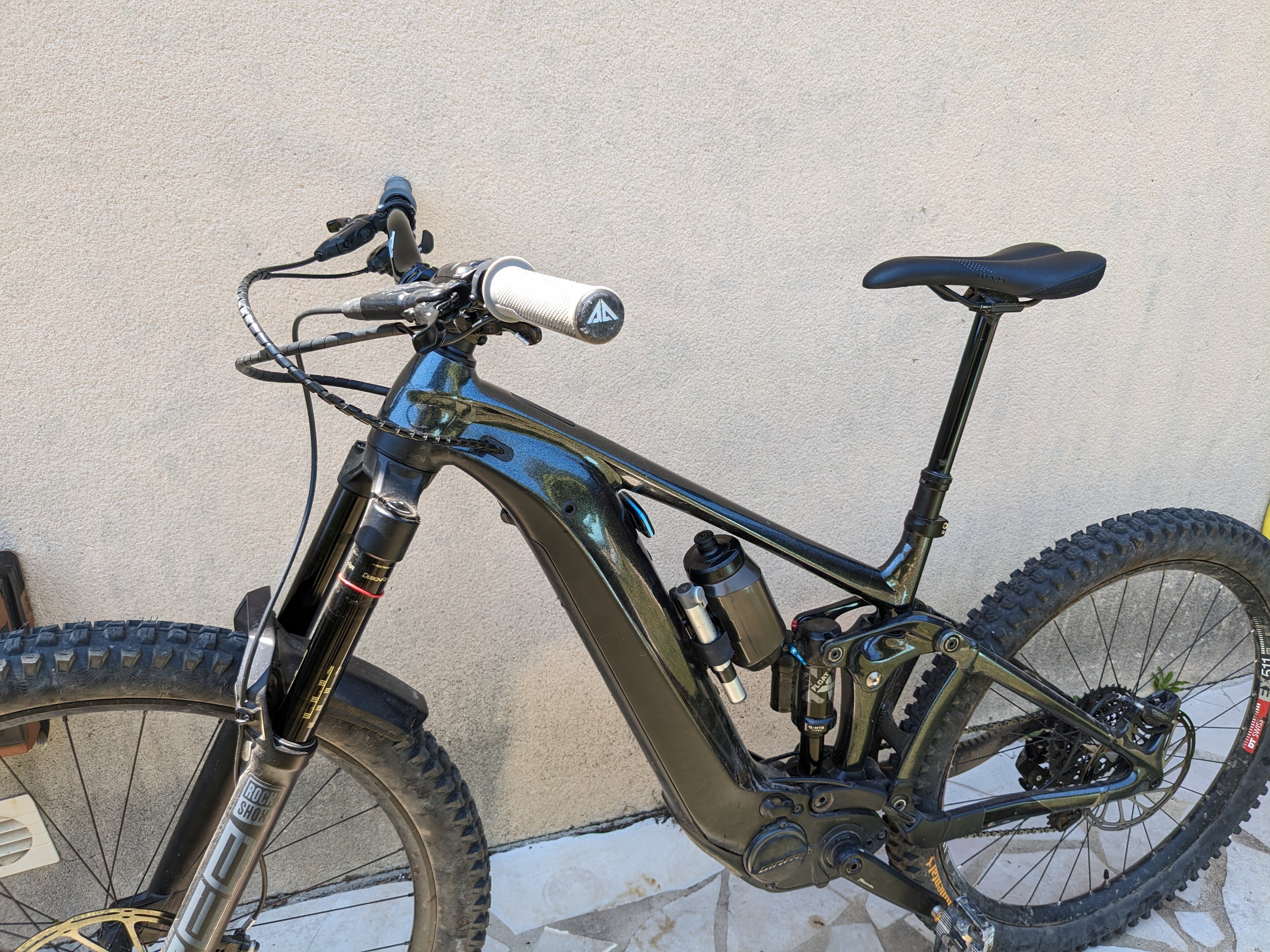

Quick post now that my build is pretty much complete!
180mm Zeb, Kryptotals 2.6 front and back, DT swiss ex1700, 45mm stem, 38mm rise Title bars, 180mm oneup dropper, GX 11s drivetrain with an X01 cassette, 150mm miranda cranks. Just waiting (not so patiently) for my 800Wh battery for this to be close to my dream bike.
Can highly recommend the milkit Hassle'off toolkit, has everything you need and fits neatly underneath the bottle mount. Just received my YT fidlock bottle, it's a 600ml bottle that fits in the same space as the 450ml from fidlock, but be warned the bottle doesn't come with the magnet kit on the bottle (some cheek if you ask me).

View attachment 120107 View attachment 120109
lovely build

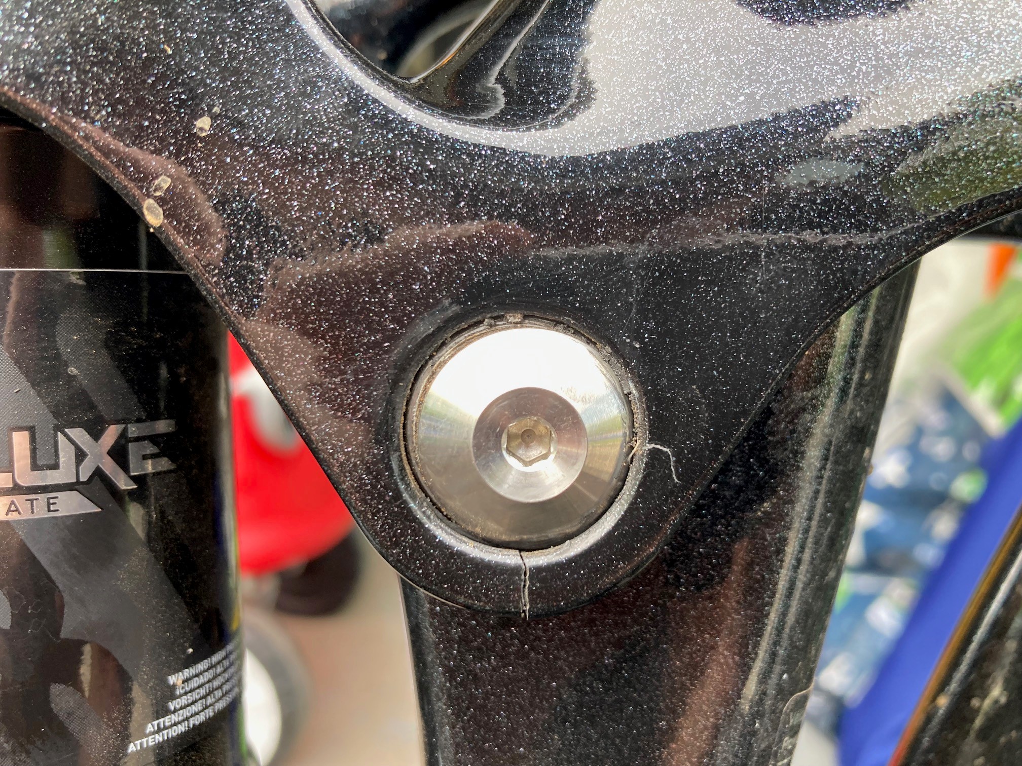

Well my Reign E+ is cracked, but looks like only the rocker link is affected.
Local suspension shop last month told me my rear shock was getting marked on just one side of the stanchion, which can be typical to trunnion mount so didn't make a case of it.
Bike started making a weird cracking sound in the last 2 rides, but wasn't able to pinpoint it...even greased my dropper again.
I rode a trail with large drops today and the cracking sound was getting louder, came out that the rocker is cracked on the left side at 2 places and since I didn't catch it right away the diamater of the hole is now off, ouch!
I truly hope that Giant is not going to take forever to replace it right in the middle of summer.
