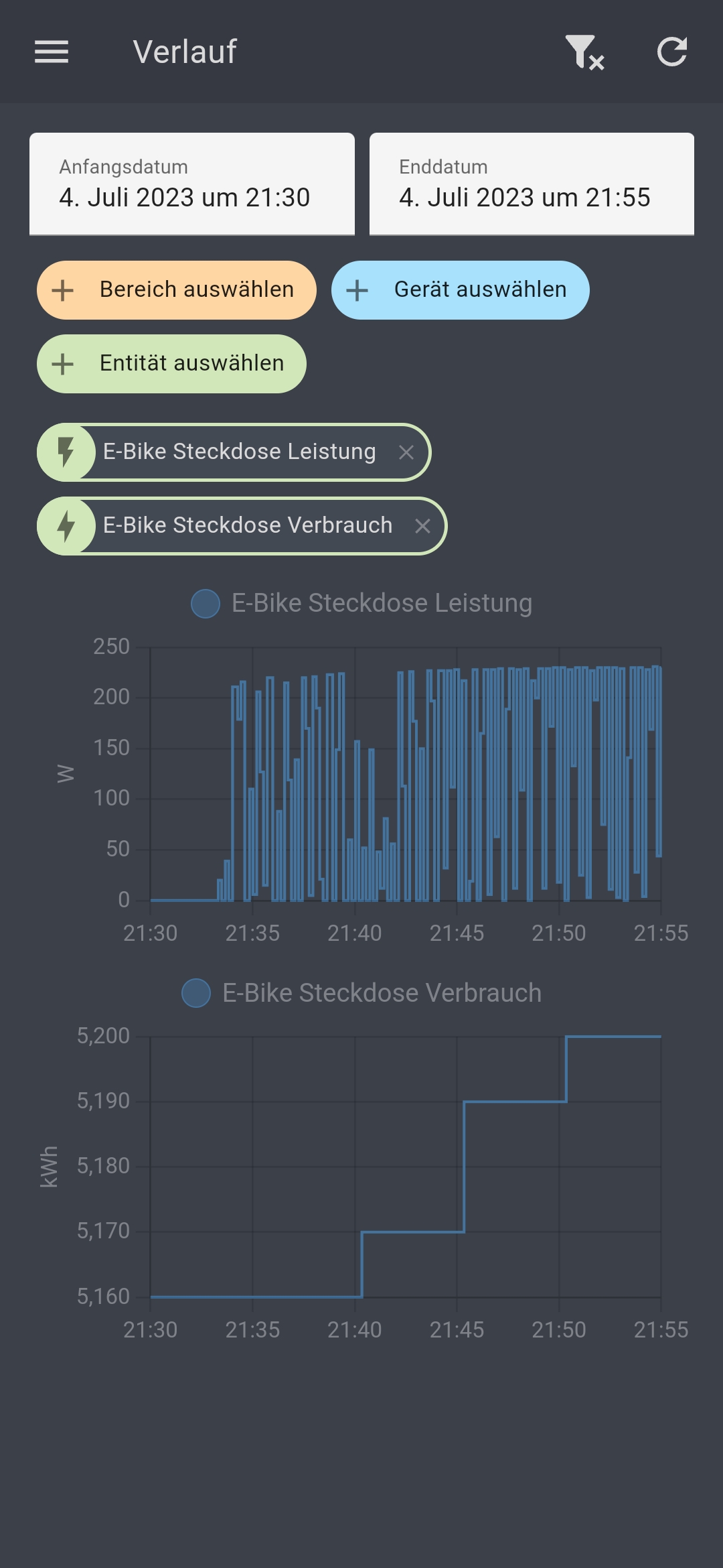

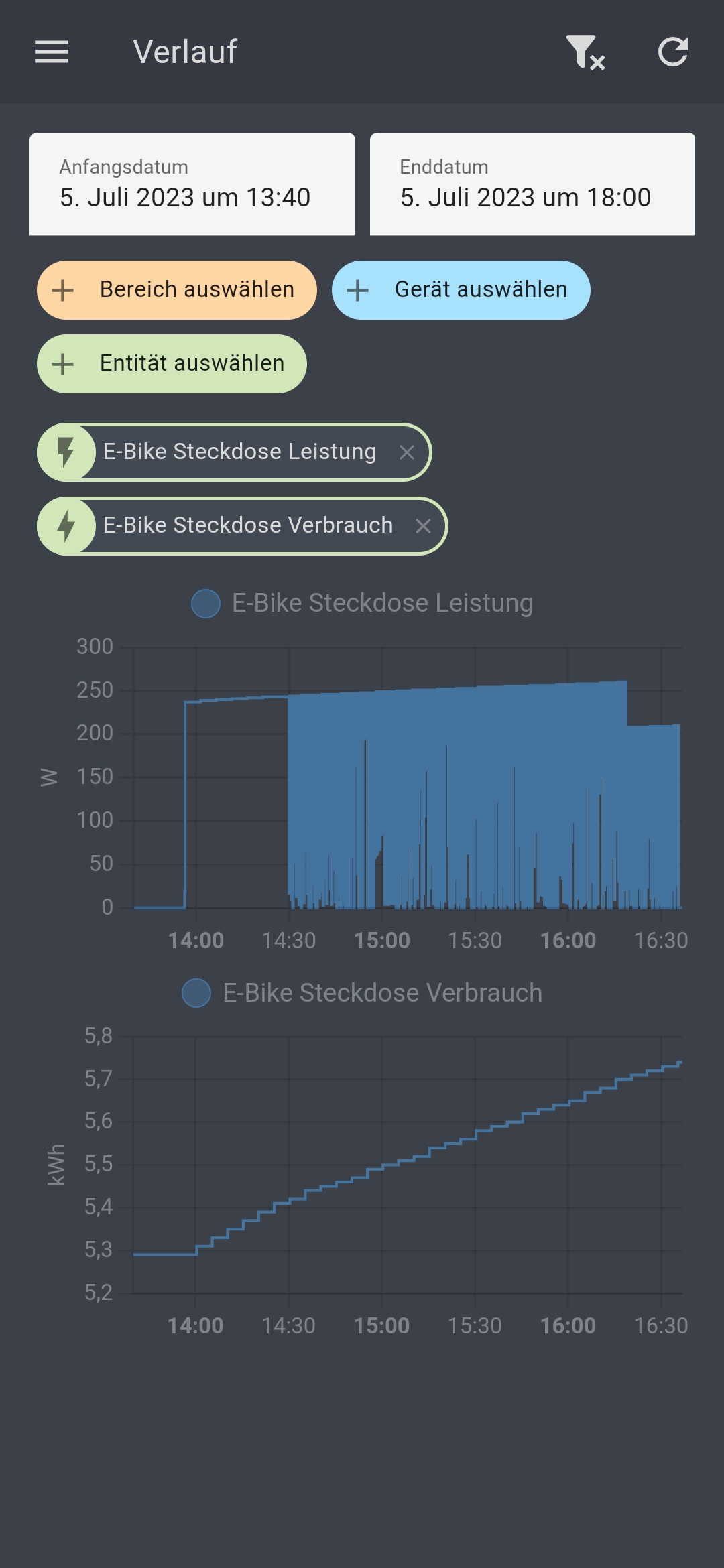

I have the charger on a power measurement socket at this is what I noticed today after the ride. It seems that the charging is restarting every few seconds. I turned it off and 10min later on and now it seems to be stable.

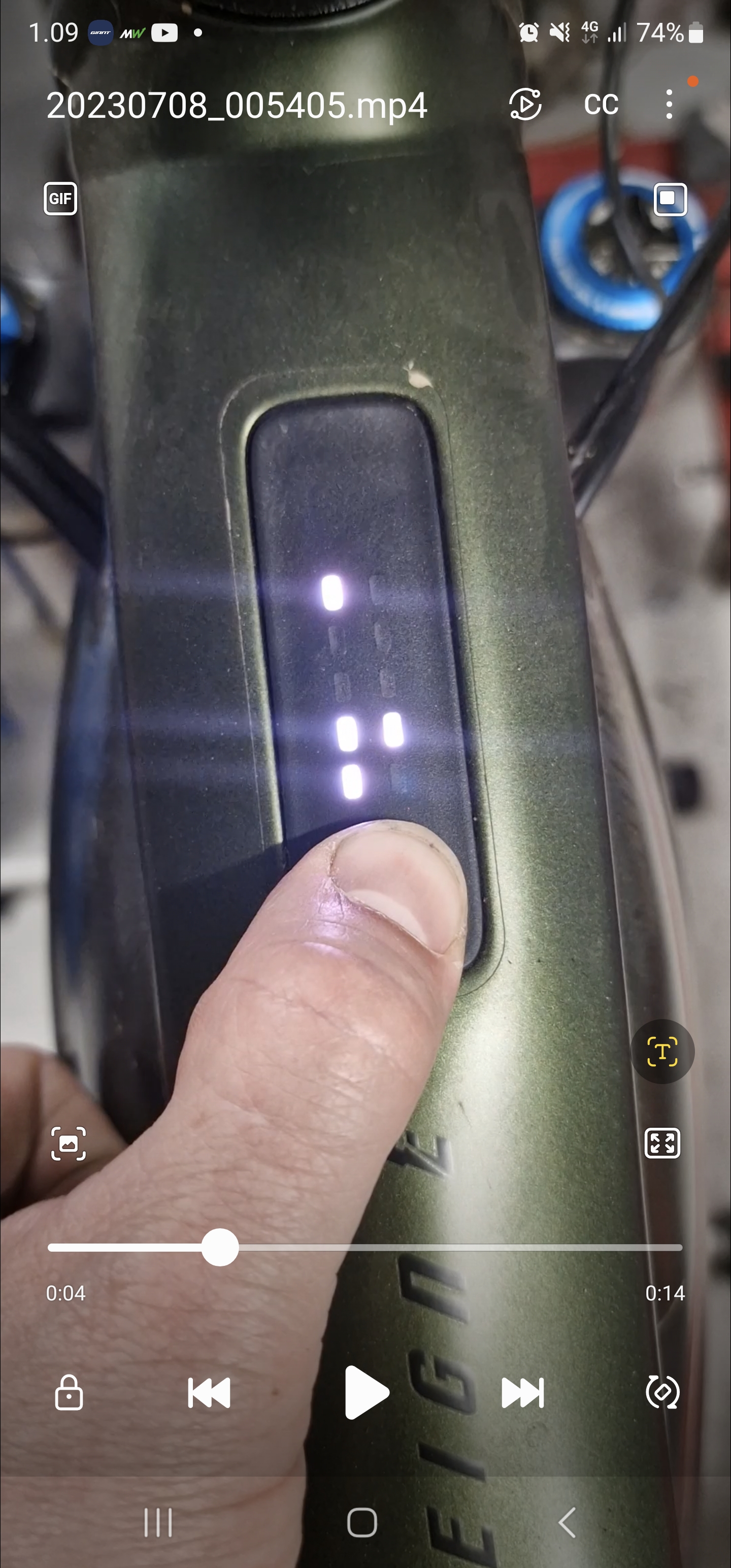

I also think I found the reason for the "Knight Rider" LEDs, also I succeeded to film it.
Giant Reign Knight Rider LEDs
It occurred when the battery was charged to full 100%. Then it occurred to me that the last two times I've seen it the batteries were also at 100%. Edit: My assumption was wrong, today the usual charge problems, and the "Knight Rider" LEDs when the battery was not fully charged.

Another battery charge and the same thing again. Battery charging freezes. The bike was charging for a day and the charger light was still flashing charging. the charge was about 50%. I unplugged the bike and noticed that the charger continued charging, the light should change to red when unplugged. When the charger is used without power, the status is reset and the red light comes on. It started to charge again but the charge had stopped again after 20%, the same thing the green charge light was flashing.
I got the knight rider lights done when I put the bike on charge and turned on the power. Normally, you can't turn on the power during charging.
I tried a second time and got completely different light codes. That must be a bug that allows you to turn on the power during charging.
Now it's starting to really annoy me that I can't charge the bike without these measures. I have to remove the battery from the charger 2-3 times to get it full.
So when it has stopped charging, you can start the bike normally and you can connect with ride control, even though the charger shows that the charging is in progress .
You cannot do this while the battery is charging..
