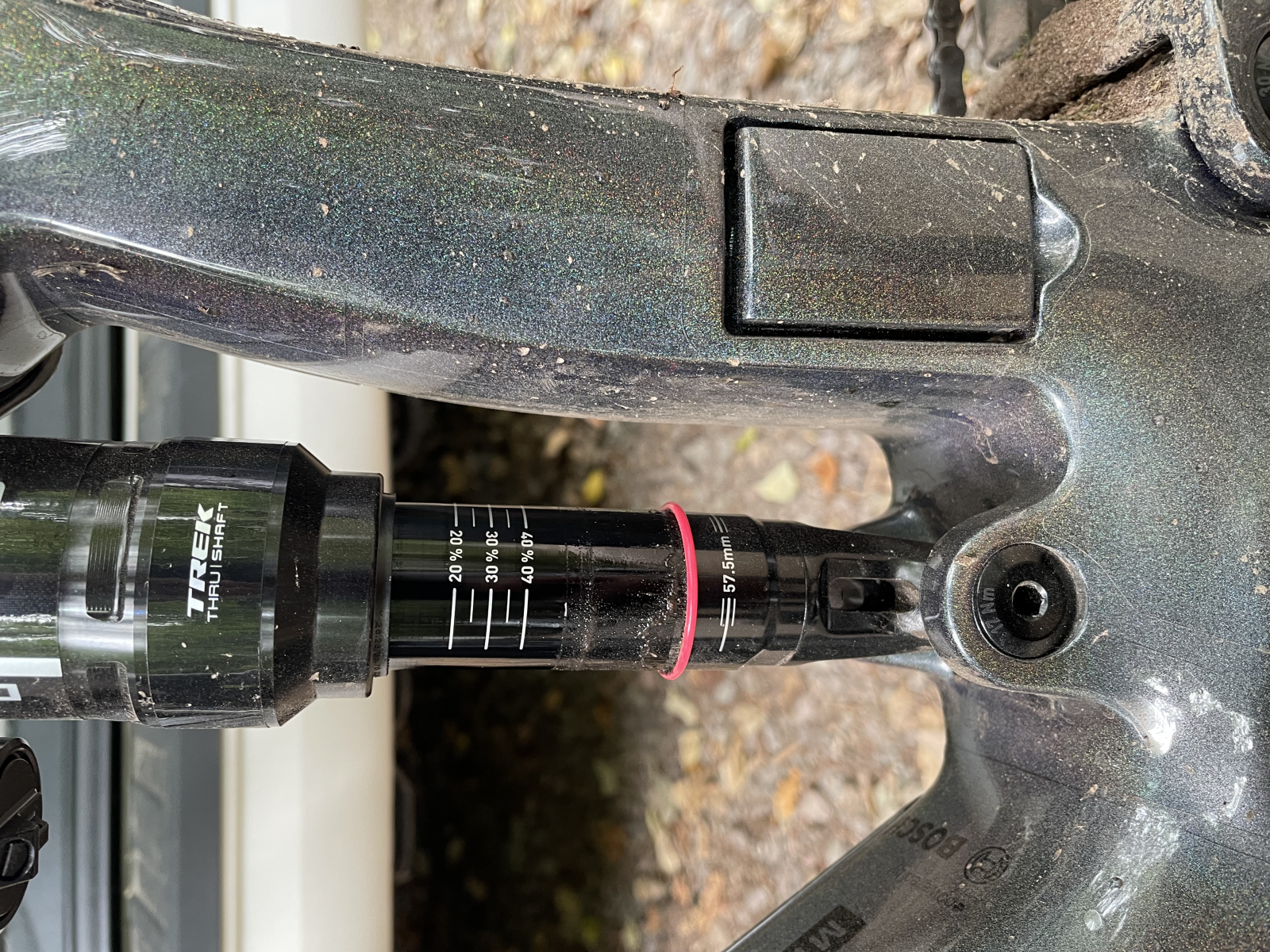

Today was my first ride. I played around with the setup before the ride, set my fork sag to just under 30% at the recommended AirWiz target pressure for my Weight (85Kg) 85psi (very similar pressure to all other forks on previous bikes), set the rebound to be as fast as it could be without the bike lifting off the ground when compressed and released while stationary. Set the shock up with target pressure of 225psi, 30% sag and set the rebound to where I though it should be and put the LSC in the middle position.

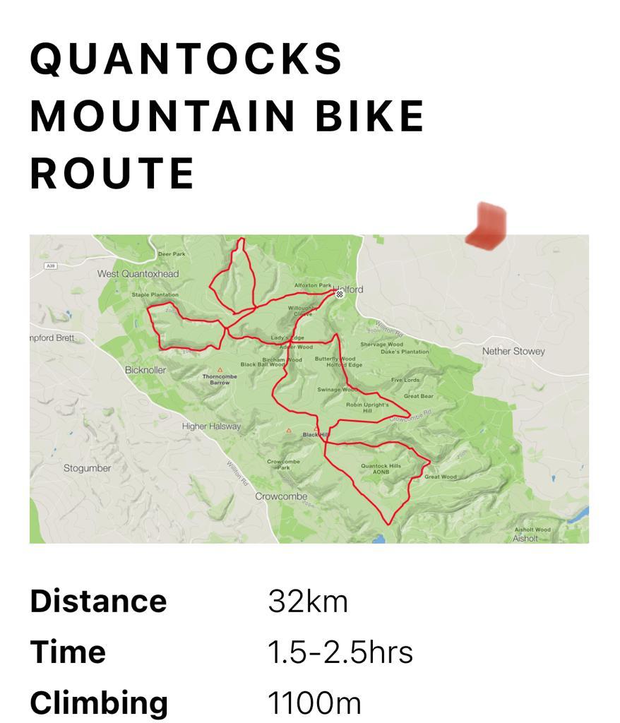

I went to the Quantocks today to do a range test, never ridden there before, so downloaded the Killer Loop for the Garmin and off I went.
Conditions were dry, stoney, large rocks over hardback, some roots, some loam in the wooded sections. Similar to riding Wales or the Peak District.

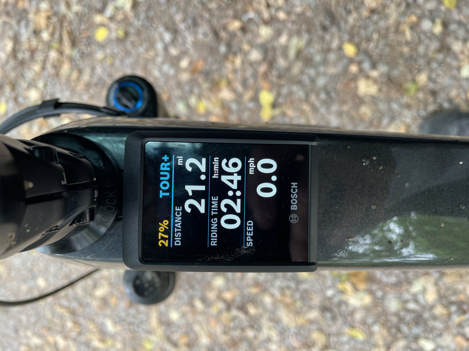

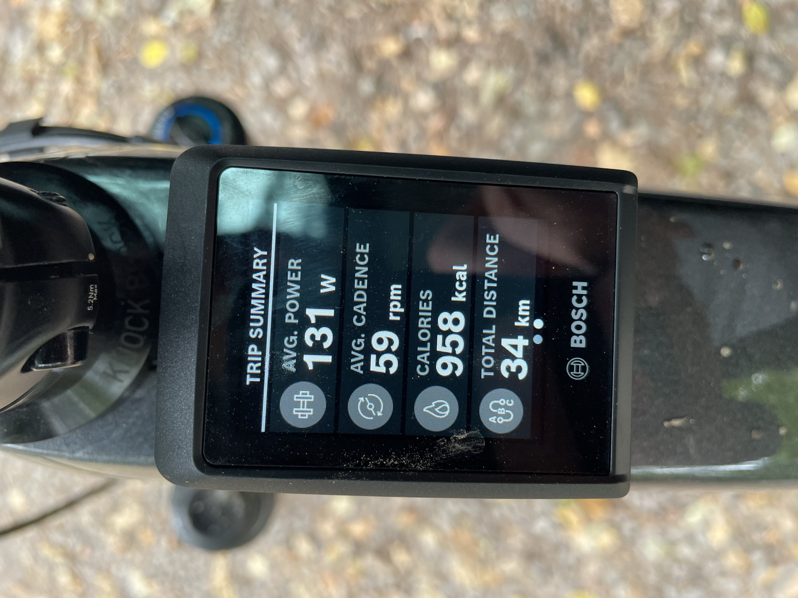

KIOX and remote. I think they work really well. The KIOX display is very good, bright, readable, doesn't get in the way. the remote is fine, I have mine rotated quite a way back on the bars, so it does not sit 'on top' looking silly.

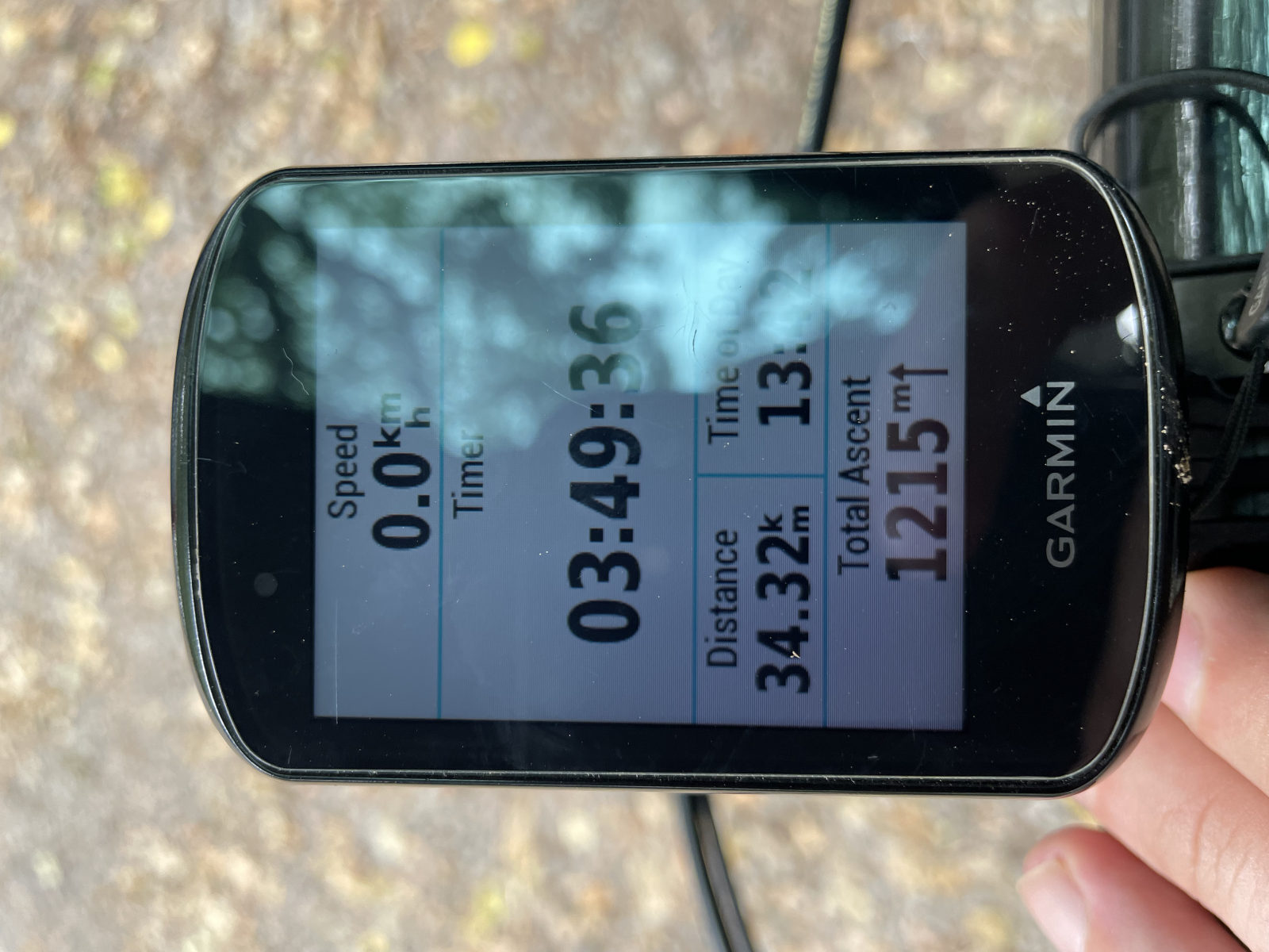

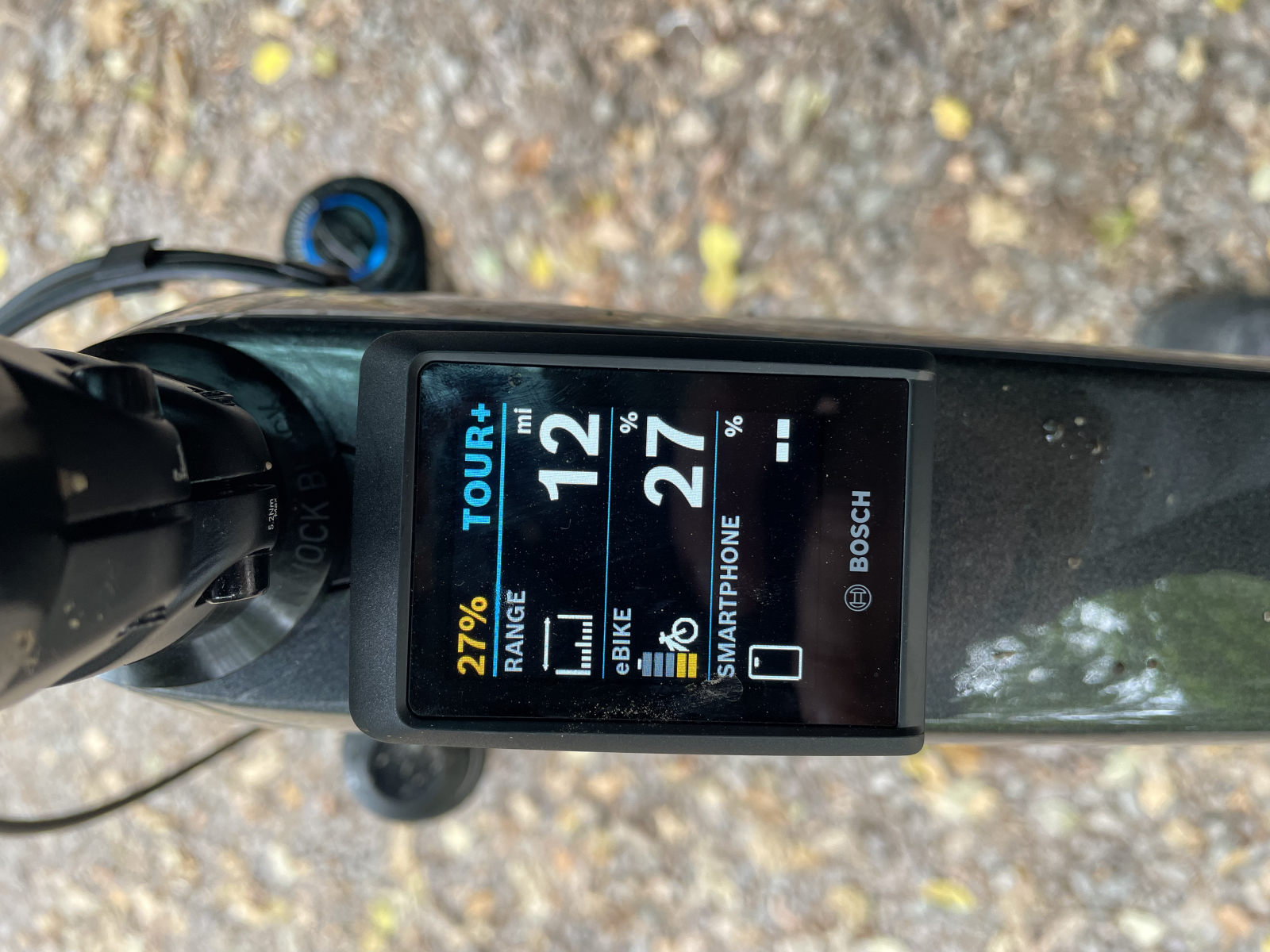

Range.
No complaints on the range. I was worn out well before the bike was (but it was my first ride in about 10 months).

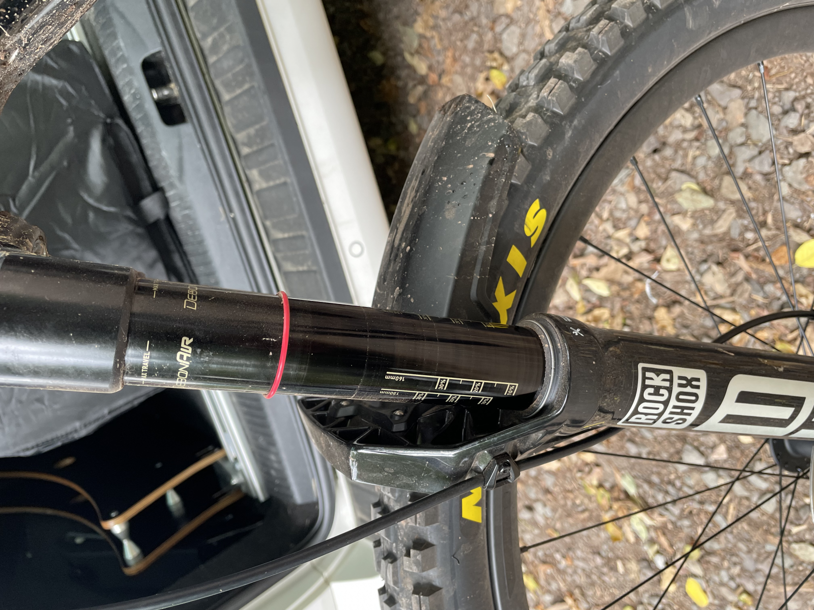

I didn't use all the travel at either end. I wasn't really expecting to on the trails I rode, but over some small drops, the bike felt a bit hard on the landing. I don't know what tokens are in the fork, if there are any in there, I'm removing them.

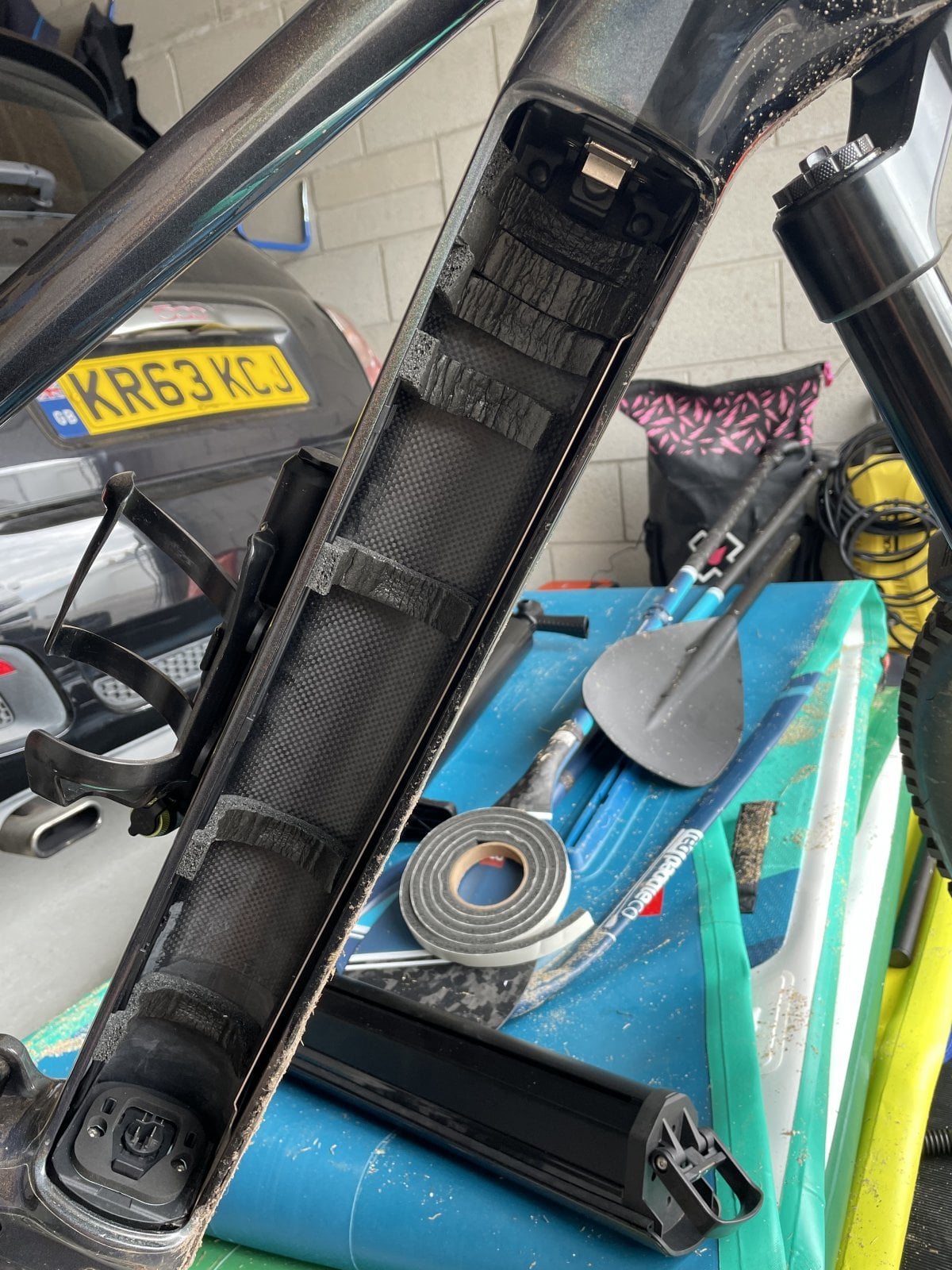

The NOISE !
No idea what it causing the rattle. It sounds bigger than the expected motor rattle and sounds like it's front end rather than down low.
Does the battery rattle in the latest Rail's? It does have the newer battery mount. Is it why the bike turned itself off on one descent?
Is it just the motor? I really hope not.
Maybe I should have tried more rebound in the rear shock, I'm on 5 (220 ish psi) Maybe going higher (faster) will make the rear end even more plush to counter all the trail chatter and hence quieten the bike down more? Maybe a Coil would be better? I'm at 30% sag so don't really want to reduce air pressure. Maybe the standard shock needs less HSC damping?

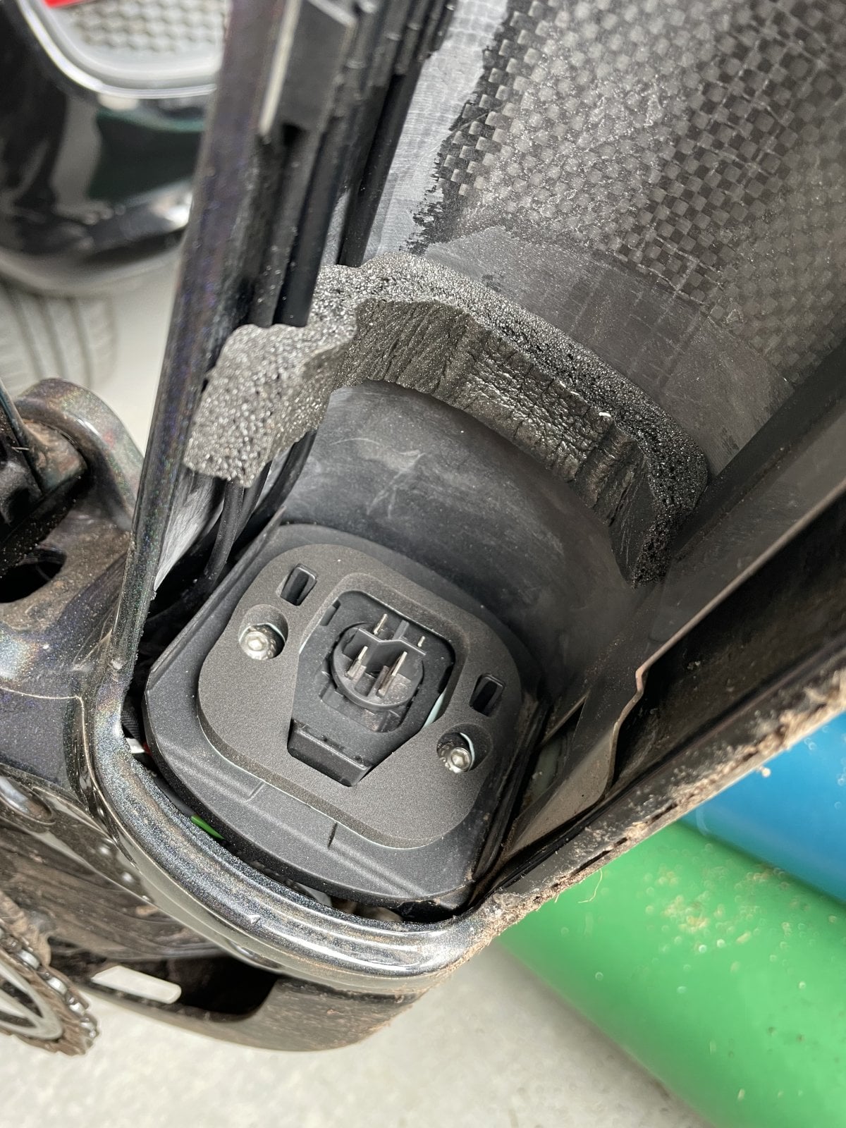

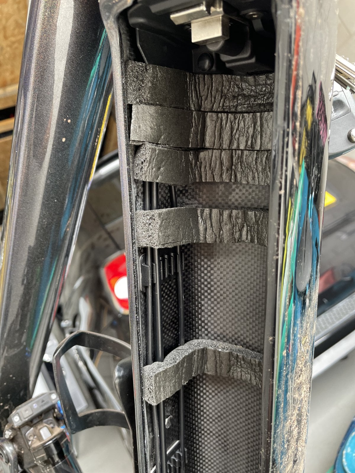

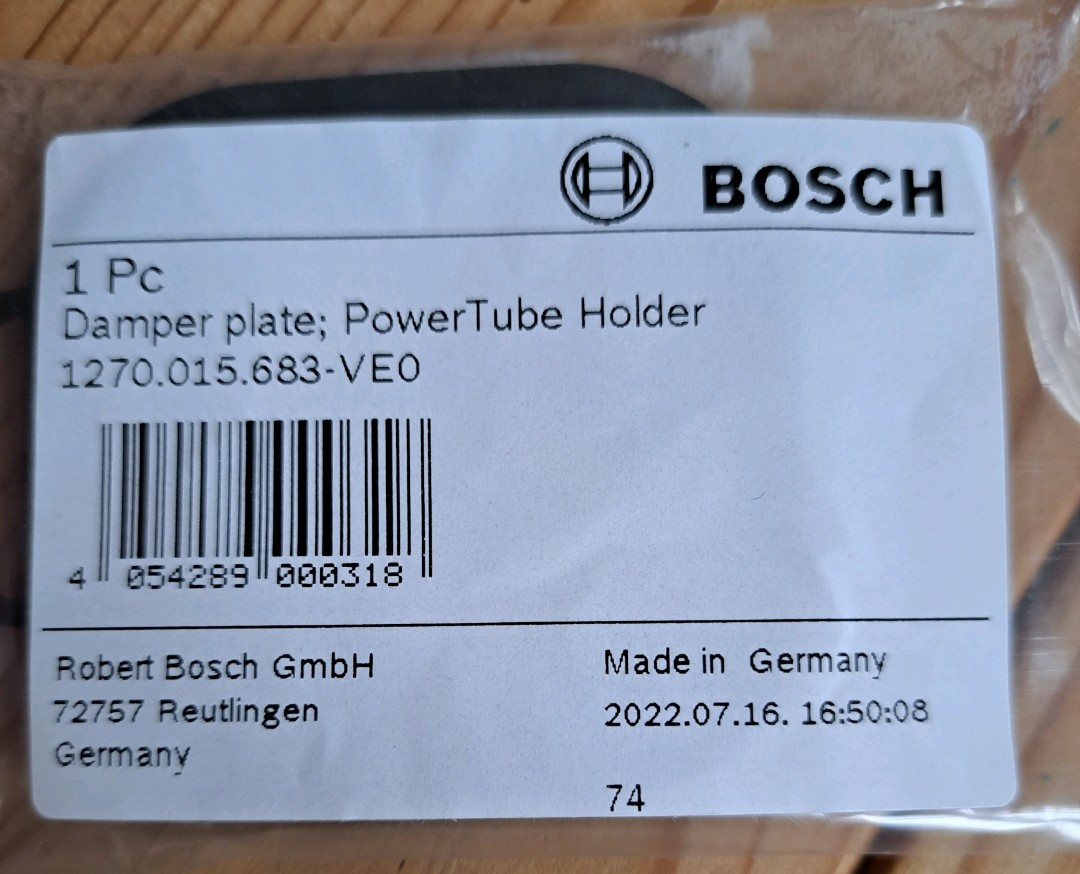

Sounds like battery rattle. Some people are using foam to dampen the sound and prevent it moving.

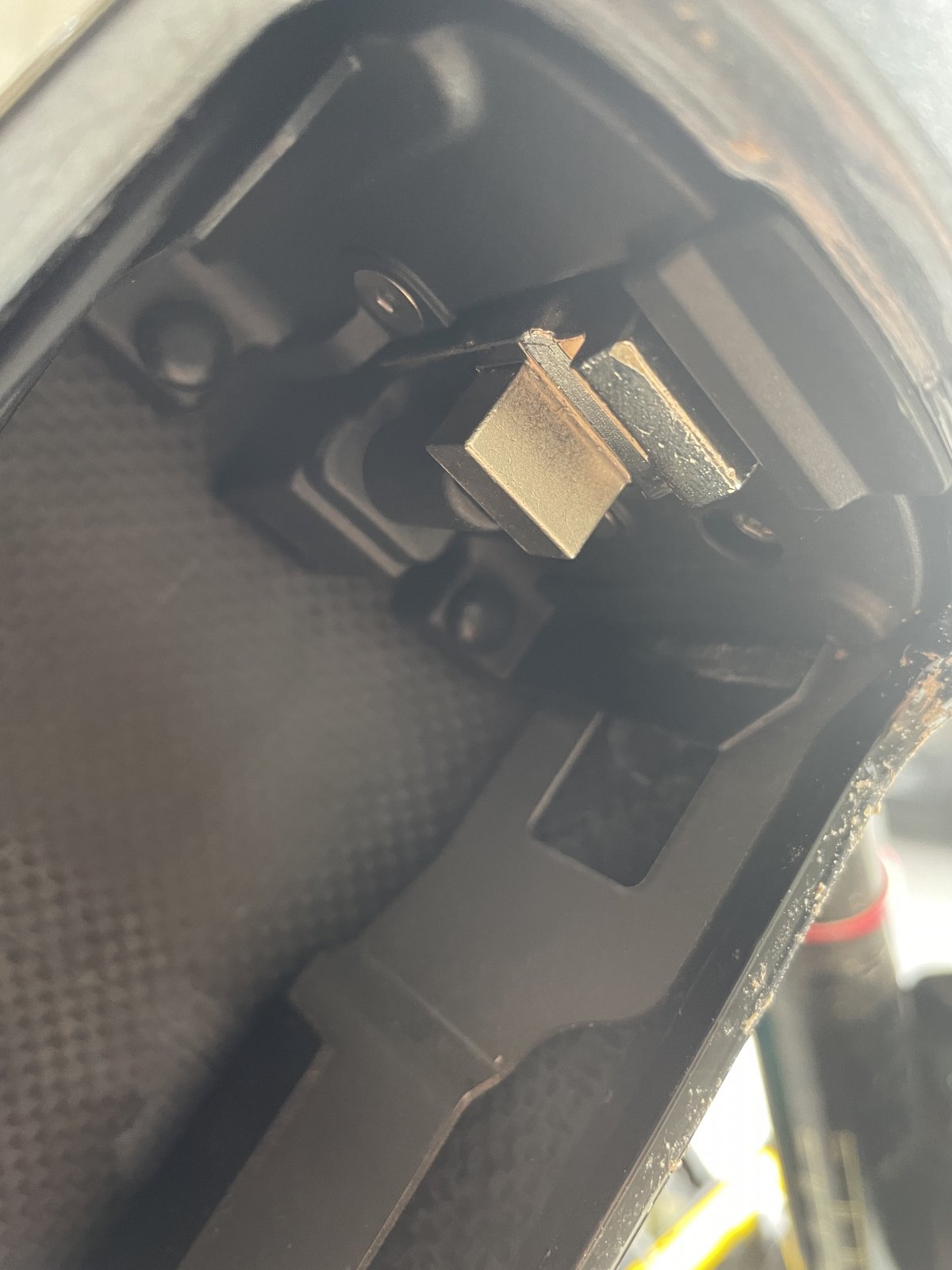

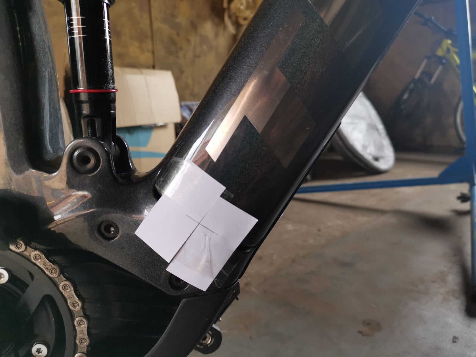

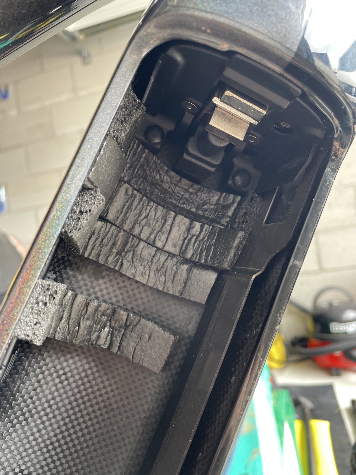

I’ve just had a quick look for some potential rattle sources……

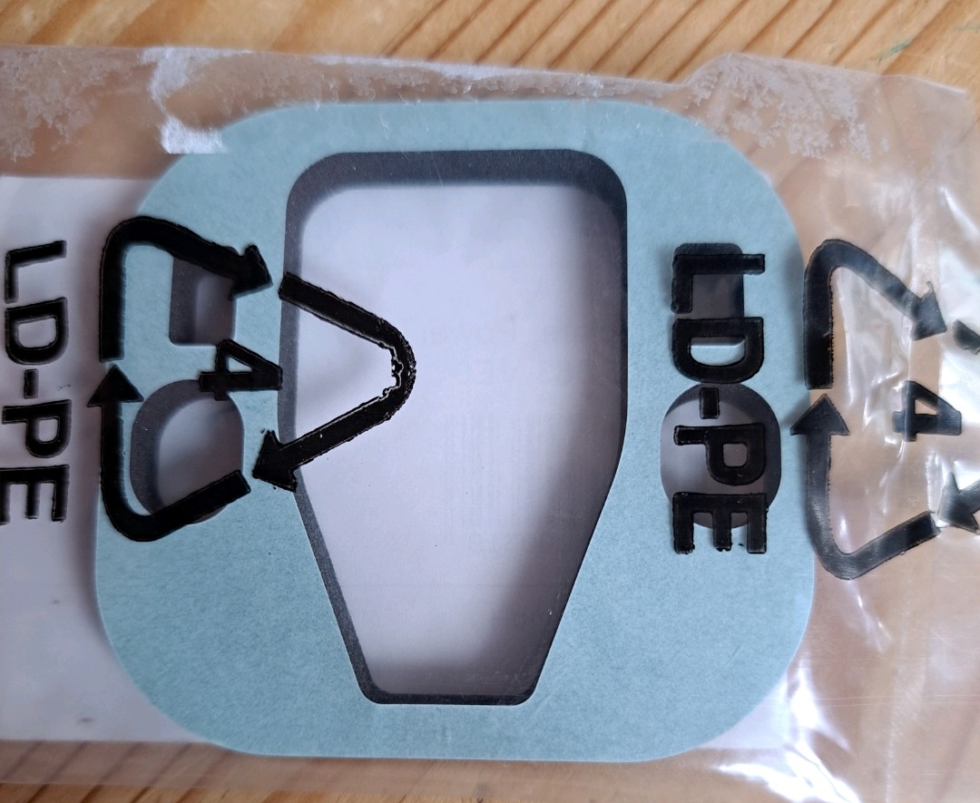

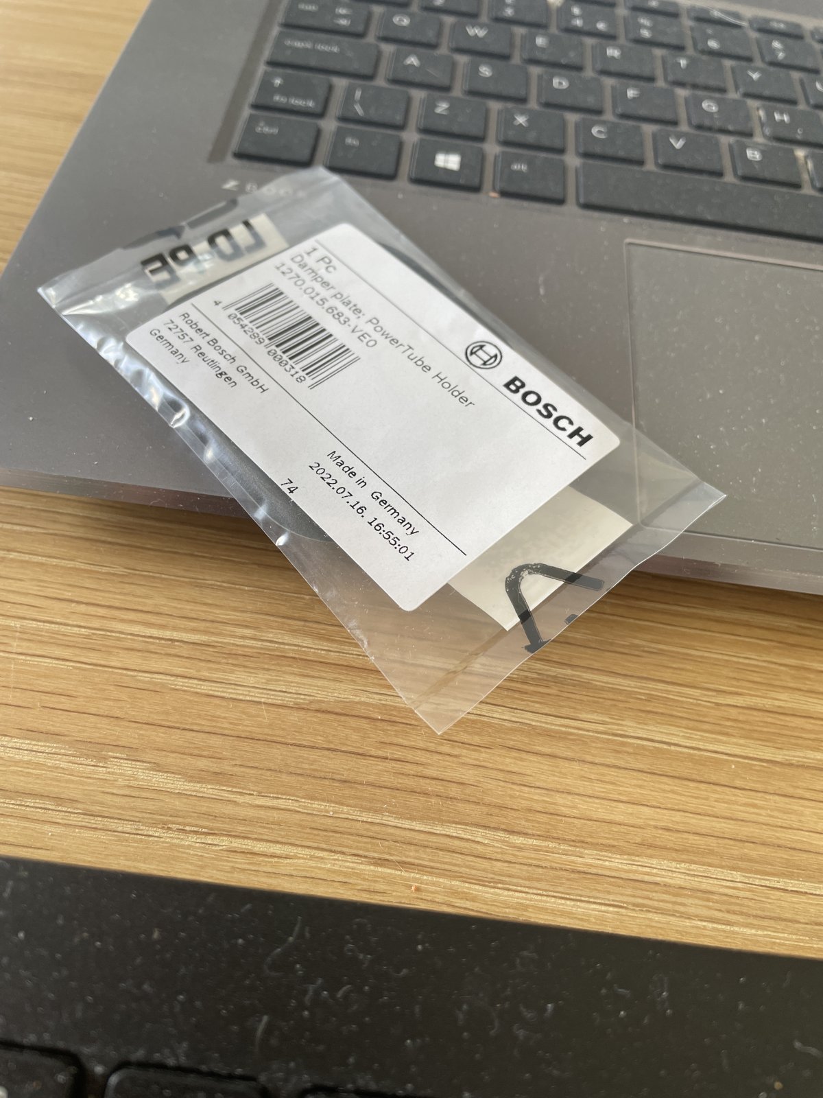

Worth trying this:

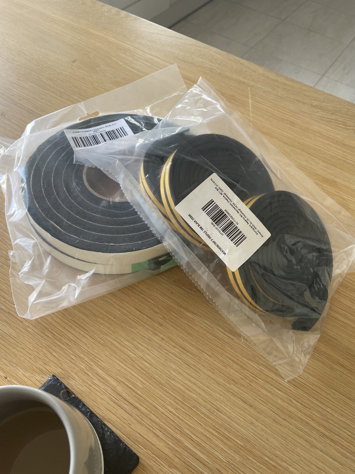

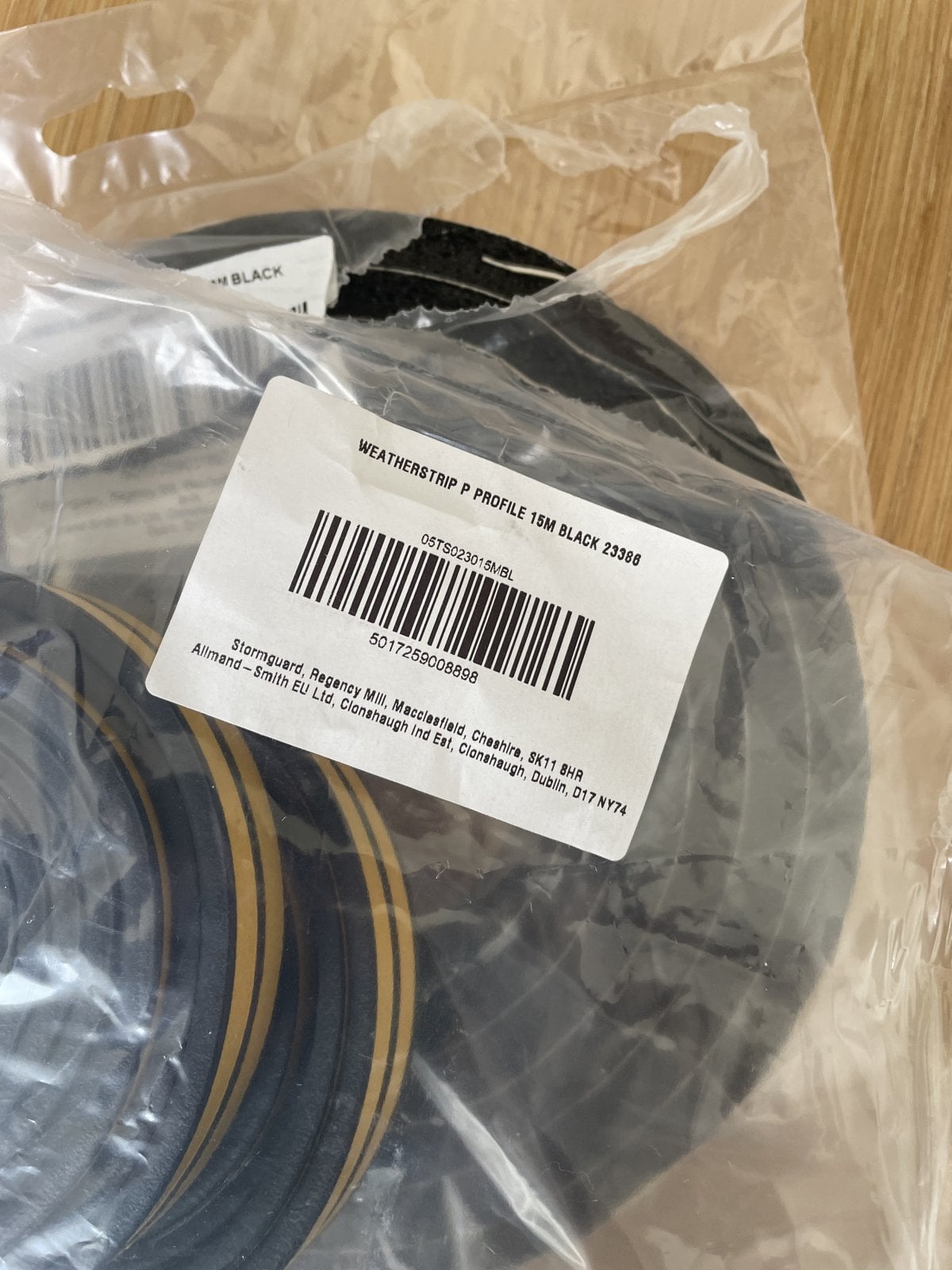

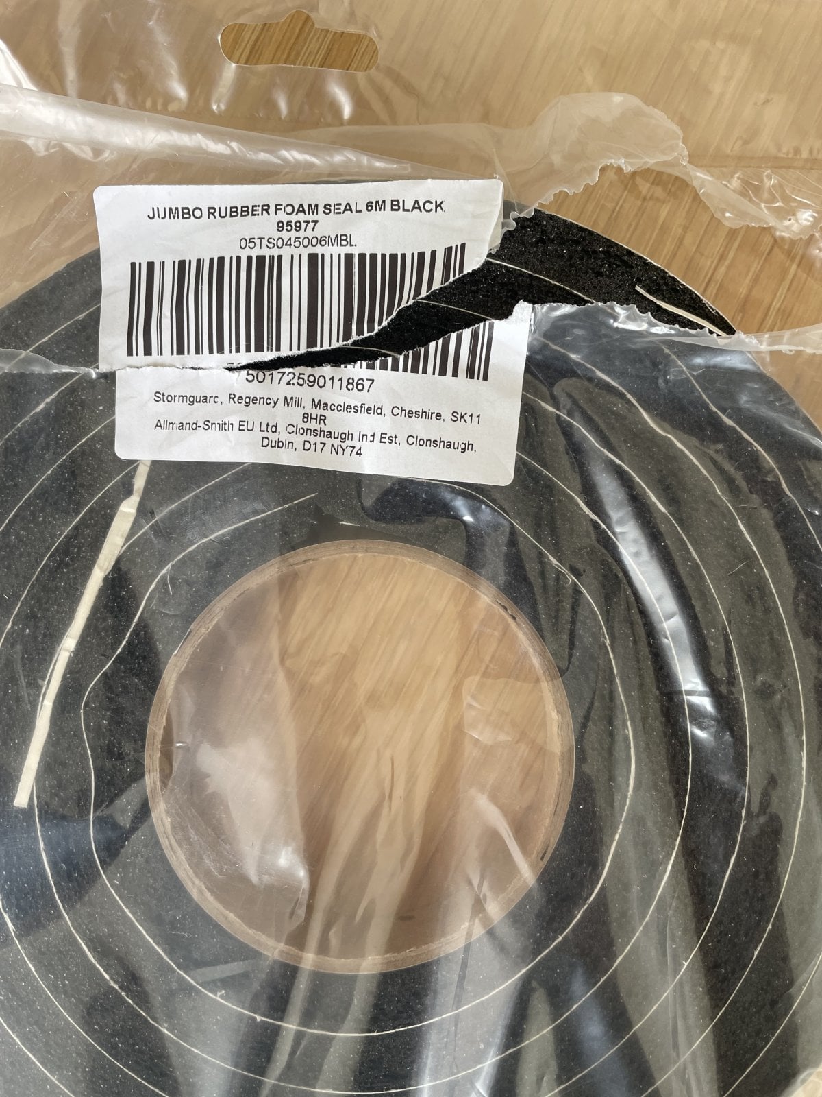

I used P seals (link below) which I think fortuitously also help to prevent any battery vibration.
these?

I have rear shock, 210psi with the rebound set to 4 and the front fork I have 69psi leaving in the standard 2 tokens with 7 clicks of rebound from fully closed and 4 clicks of compression from fully open.
85psi on the Zeb seems a bit too much?
Also definitely get the foam damping plate as previously mentioned, it makes a big difference.
But there shouldn't be that much noise.
To discount the battery making a noise remove it for one descent.

these?
Yes, that's exactly what I used. There's enough to do most of the bikes in the western world (might be a slight exaggeration there).

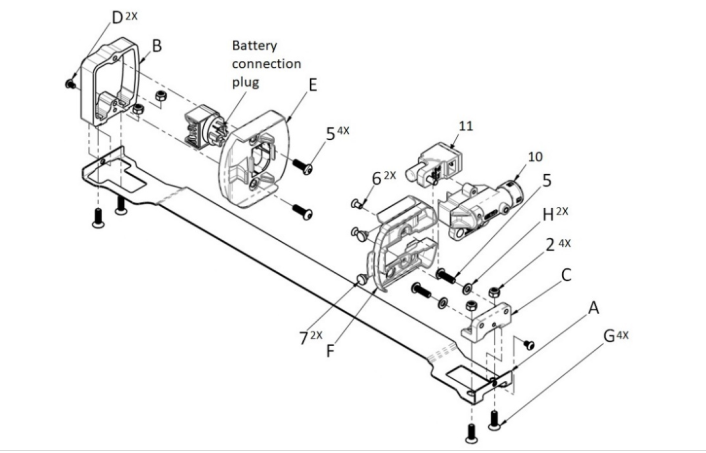

I don't like this rattling noise either. Moreover, I feel that the battery moves inside on a big rock and jumps. I know that feeling because I had a loose battery fitting on my old Merida (which is way quieter than the rail).
There is a difference in battery level when I put the bike upside down:
This new alignment system doesn't allow tune distance between the top and bottom brackets and seems like there is a 1.5mm too long.

Worth trying this:
Mine arrived this morning. Self adhesive on one side.

It is tight, but goes in no problem and locks in place. You can actually feel significantly less
Movement of the battery (almost no movement at all). I haven’t tried with just the damper plate.
I haven’t ridden the bike yet with this mod.
I also installed the P rubber strip on each side of the battery where the cover meets the frame.
it all adds up to keeping the battery very snug when fitted. Fingers crossed for a quieter ride.
I will definitely test a descent with the battery removed to get a base line noise test.
such simple things to add to the bike with no downsides. really struggle to understand why Trek haven’t fixed this? They must test ride the bike and simply accept the noise levels as ‘normal’.

Someone else (possibly in this thread) did mention you can adjust the bottom plate with the bike upside down to close the vertical gap/movement within the battery area? Has anyone tried this yet? Possibly it may have to do with the RIB alignment?
Just be thankful the reports of batteries falling out haven't happened yet, if some cheap foam tape and a $4 part fix the issue I will be very happy.
Both brackets are attached to the alignment plate, you can't move them without bending the plate.
