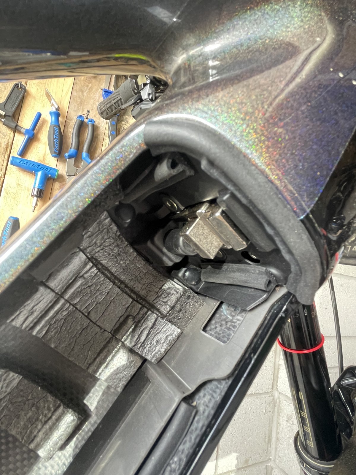

My fix has not fixed it.
riding today over some chunky choppy roots and generally blown out trails and I am sure it’s still making a noise. Not as bad, but still there and enough to be distracting.

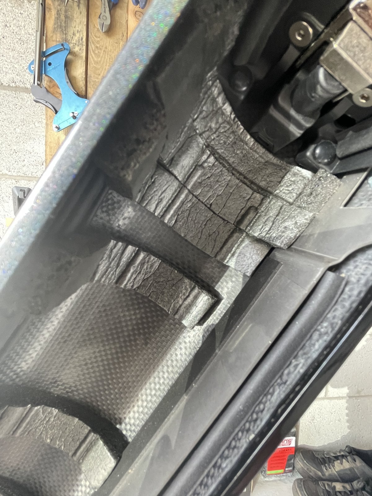

I’ve got rubber strips under the metal plate and all the foam that I posted pics of and the Bosch rubber damper.
I do now wish I had bought a Levo. Even though it would have been lower apec
regarding battery mount alignment.
does this look right?
still not reaching full travel on the suspension either. So I suspect the fork has a few tokens in it and the shock must also.
the rear end feels very crashy over repeated chunky stuff (shock is open and on the most open LSC setting). Maybe changing to a coil shock will help this and along with getting the forks dialed in, may improve the rattle situation.
@Mitch@Trek why release a bike with such a massive issue? The battery weighs 5kg. To have it rattle like it does, for me and I am sure many others, ruins the ride.! The bike cost me over £9k, it’s a bloody expensive mistake. What are Trek going to do to fix the issue?

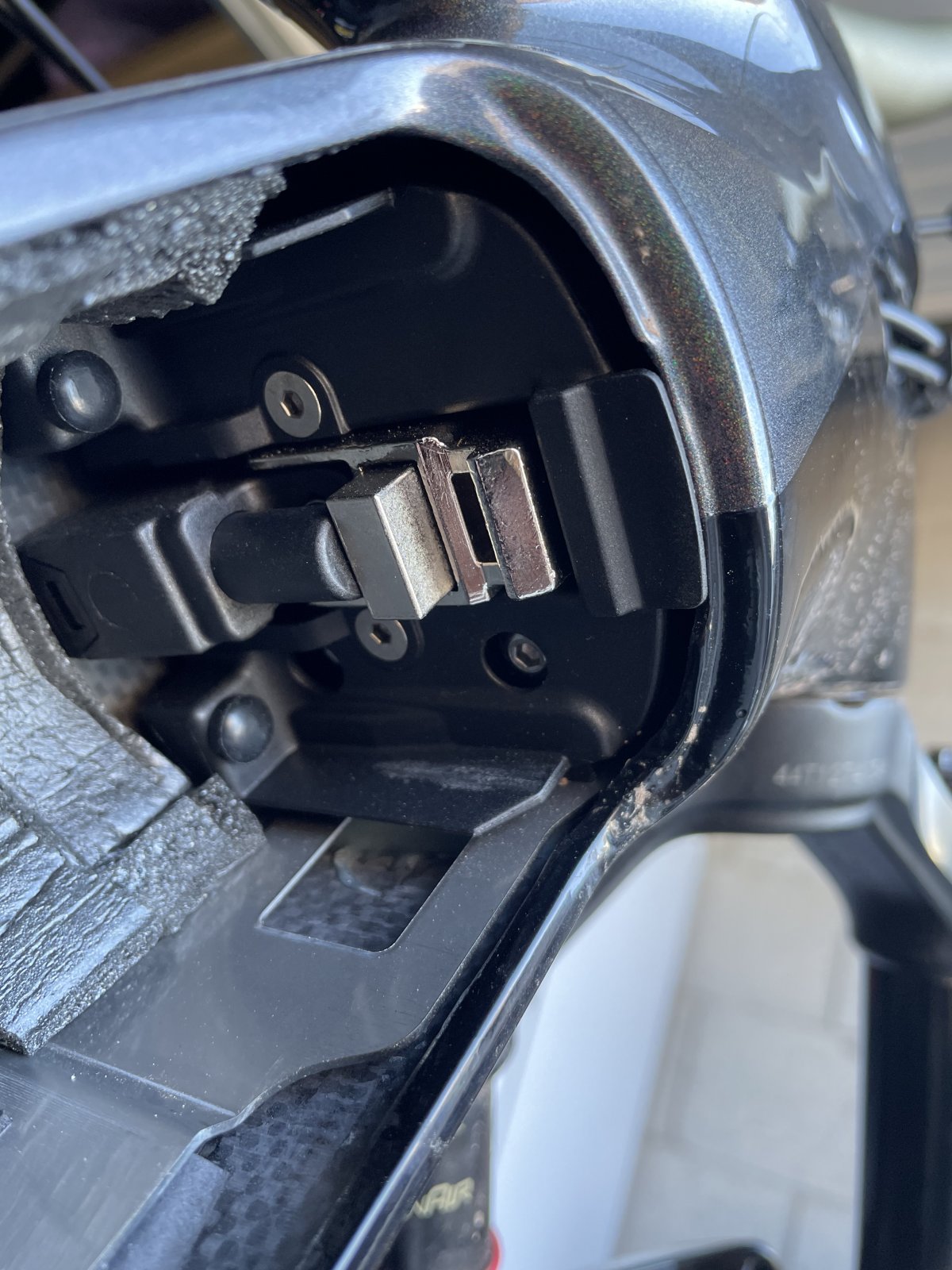

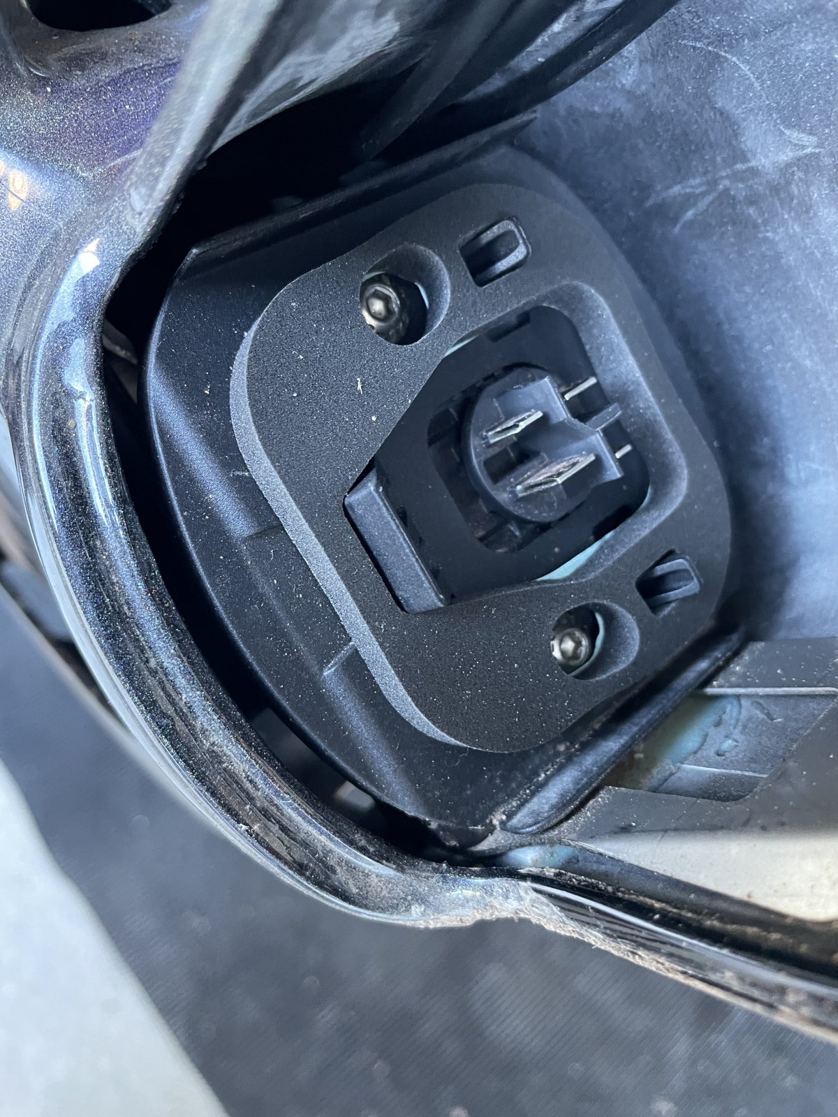

Oh and great… 1st charge and just pulled the bike charge port away from the frame when removing the plug 😂

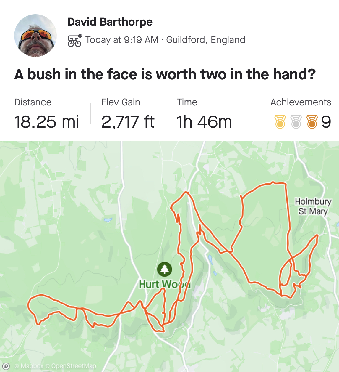

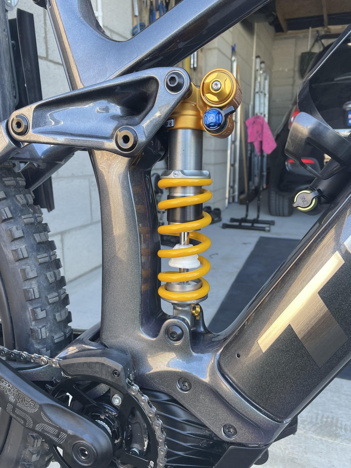

Second proper ride today.
Major upgrade to previous ride was adding a new shock.
came from tftuned ready to bolt on the bike, sag was perfect. The only adjustment I made was opening the rebound by one click.
very impressed with the coil, first time riding a bike with a proper coil setup, felt fantastic, grippy, good on the climbs and pretty planted on the downs.
Rear end feels better with the coil, less chattery, much more stable and controlled over the blown out braking bumps.
I’ve fiddled with the fork as well, I’m at 85psi, I’m 90kg, one click of HS compression, about 10 LSC and about 6 from closed on the rebound (Zeb ultimate). It’s still not dialed in. Unlike the lyrik which was very good, the Zeb feels harsher, I’ve removed the token that came with it. Think I need to drop the pressure to 80 which will give me a little more than the 20% sag I’m running. It needs to be a bit plusher than it is at the moment, feels choppy over repeated braking bumps.
battery rattle is much better, but still there, need to try more padding. Sitting on the bike going down rocky fire roads, I can hear it vibrate.
motor rattle can be heard, but not something that will bother me once the battery rattle is sorted.
Rode round Surrey Hills on trails I know really well and I’m really impressed with how the bike rides and handles, it’s easy to jump, good around the tight stuff and stable on the steeps.
I use nothing but eMTB mode, which feels great. Turbo is not as strong as the Levo Gen3.
Finished this ride with 47% battery remaining.
The range is just mega.

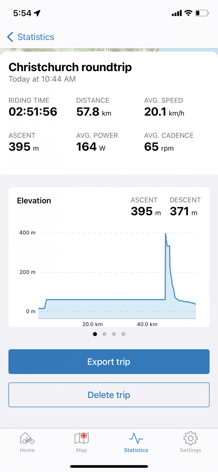

So, today I did a ride I imagined as what I wanted to do as my first ever EMTB ride. Yesterday when I used strava the bosch app automatically recorded and triplicated my strava ride.
So today I used just the bosch app and see what happened. Turns it the distance is right but nothing else:cry: elevation is wrong and the whole gps map is wrong.
96% charge when I left and did around 1200m of climbing and 58km (36 miles) it took around 3 hours with a few stops. Really really happy, I can hear the motor rattle now but nothing at all from the battery. Finished walking in the door with 5% battery.
im going to start a new topic in how to setup recording between Kiox 300, Apple Watch and strava.

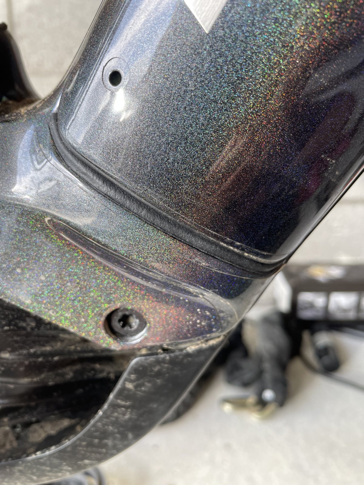

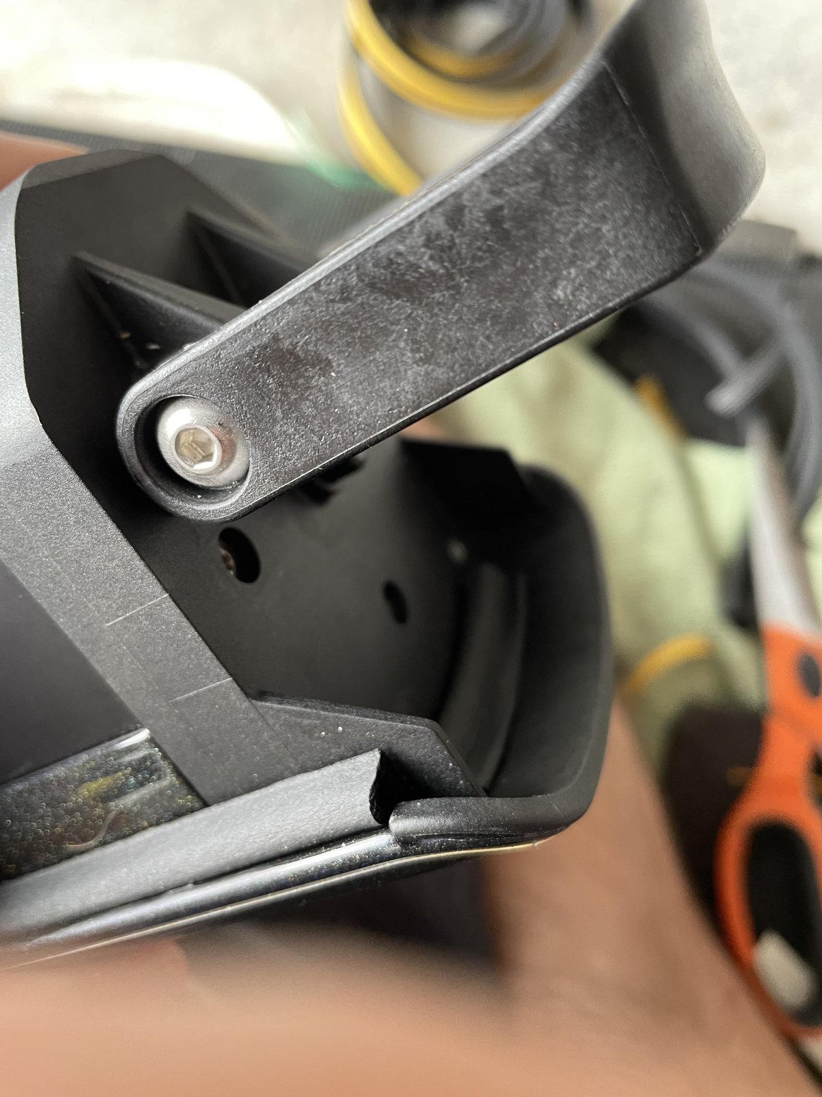

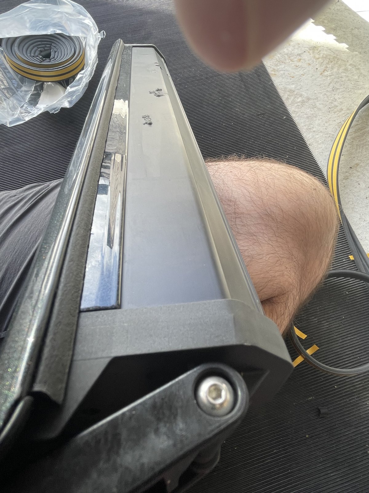

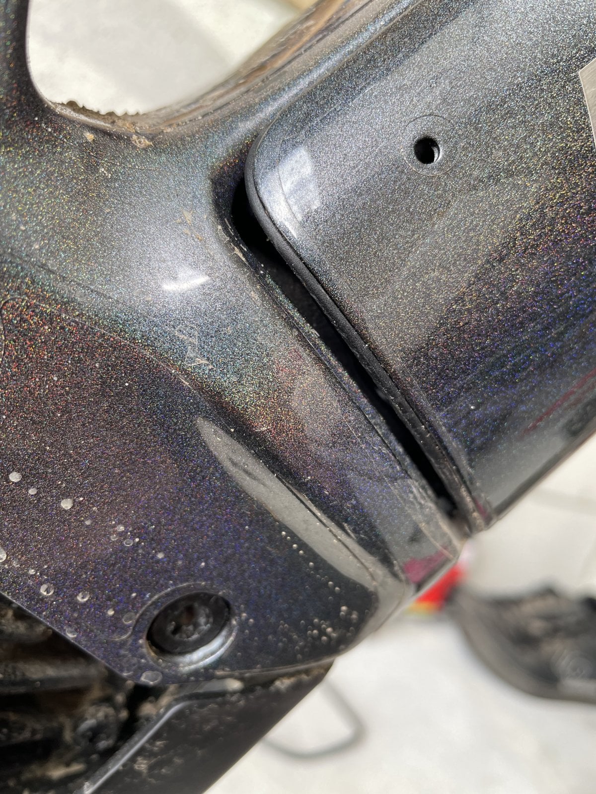

After another long ride yesterday, am still not convinced the battery movement has been cured.
so, I had a closer look today.
Whatever movement is happening has to be longitudinal. You can clearly see from the imprint on the foam that the battery is squeezed into the frame, so I can’t believe any side to side movement is happening.
so I looked more closely at the top battery mount and the frame gaps between the battery coverplate and the frame.
there is a significant gap here
from what I can tell, the only part of the battery that is in contact with the top battery mount is the folding handle. For my bike, I think this gap is not entirely closed when the battery is fitted.
to test, I stuck some rubber p strip to the handle to see if the battery would still fit. It does, indicating there is still a gap that needs filling.
After several trials, I ended up sticking some p strip onto the top mount.
trial test
End result
The battery does go in, but with a bit more resistance and when removed, the p strip is squashed so a good sign of a tighter fitment.
for good measure I also added a strip under the battery handle.
I also then looked at the foam pad from Bosch. It actually fits inside the trim on the lower part of the battery, so you are not really getting padding from the full depth of foam.
so to add more padding/anti rattle, I’ve added some more P strip to the lower battery plate each side of the Bosch pad. (Forgot to take a pic)
I’ve also used p strip to fill the lower gap.
I’m reasonably confident that I have filled all areas where there could be noisy plastic to plastic rattling. I will find out on my next ride.

Dave I honestly think your LBS hasn’t installed the RIB plate correctly. The vertical movement we be from that.
Bottom of my battery gap looks the same as the first pic you posted.
I may take it to them tomorrow to talk them through the issue.
are the plates not factory fitted?
JP-NZ
Feb 17, 2022
1,375
1,077
Christchurch - New Zealand
They are but I believe the LBS can alter them instore. I know a few reviewers have mentioned about it negatively affecting their riding but I don't understand how some can be fine and others are rattling badly.
Rob has not mentioned battery rattle from what I can see and loamwolf didn't mention it in their review either.
