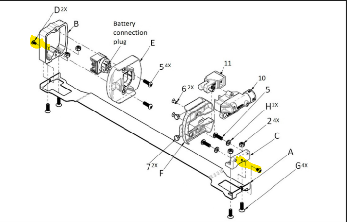

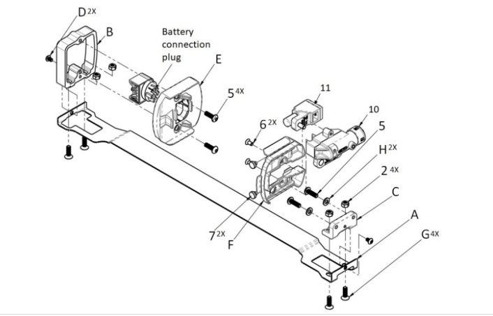

Yes you can they have a clearance hole through the plate, so there is float in the brackets for adjustment.
Brackets attached to the plate with bolts you can move only the whole construction:

No sorry you are right, you can’t slide it up only rotate it with the plate. My Rail 9 didn’t have the plate and once I moved the bottom bracket up it removed all play and was rock solid. I might take the plate out of my 9.8 and try it. If not I’ll sell it and get a Levo, as much as I love my Rails I’m sick of messing about with them. They should have fixed this 2 years ago

One or two washers between the lower battery mount and the battery plate to space it up might do the trick. Painful to do though as motor will probably have to be removed.

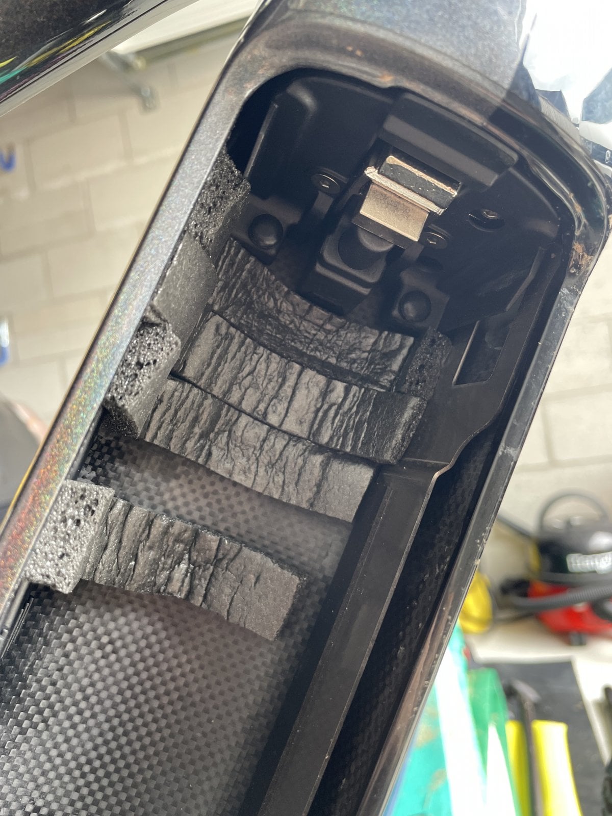

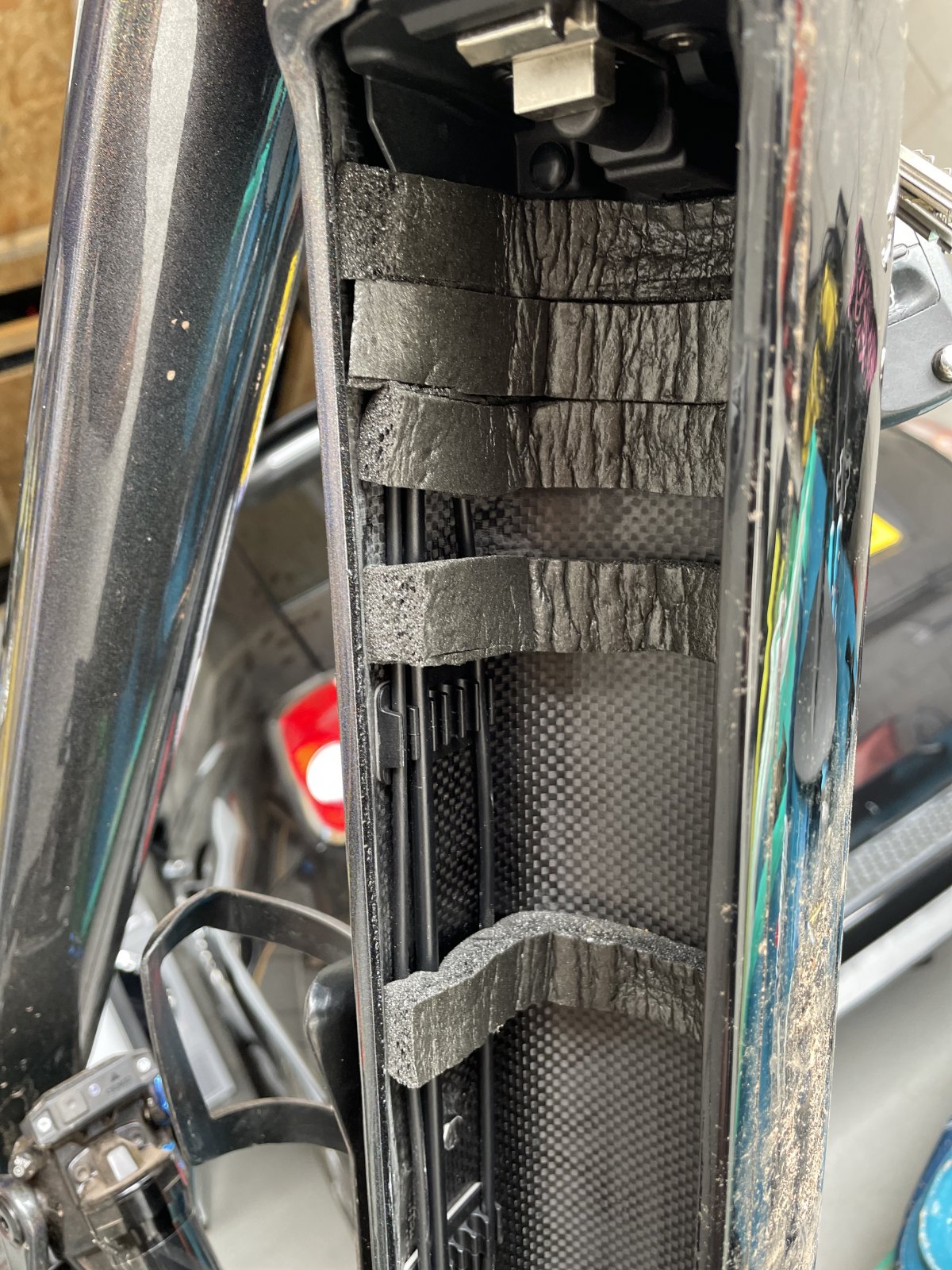

I did it today: put one 1.5mm washer between the top bracket and the plate. So far so good, the battery is no longer moving inside. Still not happy with the result, still rattling and clucking inside, will try to add some foam this weekend.

It is tight, but goes in no problem and locks in place. You can actually feel significantly less
Movement of the battery (almost no movement at all). I haven’t tried with just the damper plate.
I haven’t ridden the bike yet with this mod.
I also installed the P rubber strip on each side of the battery where the cover meets the frame.
it all adds up to keeping the battery very snug when fitted. Fingers crossed for a quieter ride.
I will definitely test a descent with the battery removed to get a base line noise test.
such simple things to add to the bike with no downsides. really struggle to understand why Trek haven’t fixed this? They must test ride the bike and simply accept the noise levels as ‘normal’.

Dave, are you also running the updated alignment plates too?

@Mitch@Trek you can see the alignment plate in my pics.
You likely may still needed a slight tweak in the alignment for your plates, which we have part of it stickied to the thread. But the foam insulator is something we can certainly help with for those who need it. I'll share the feedback along though!

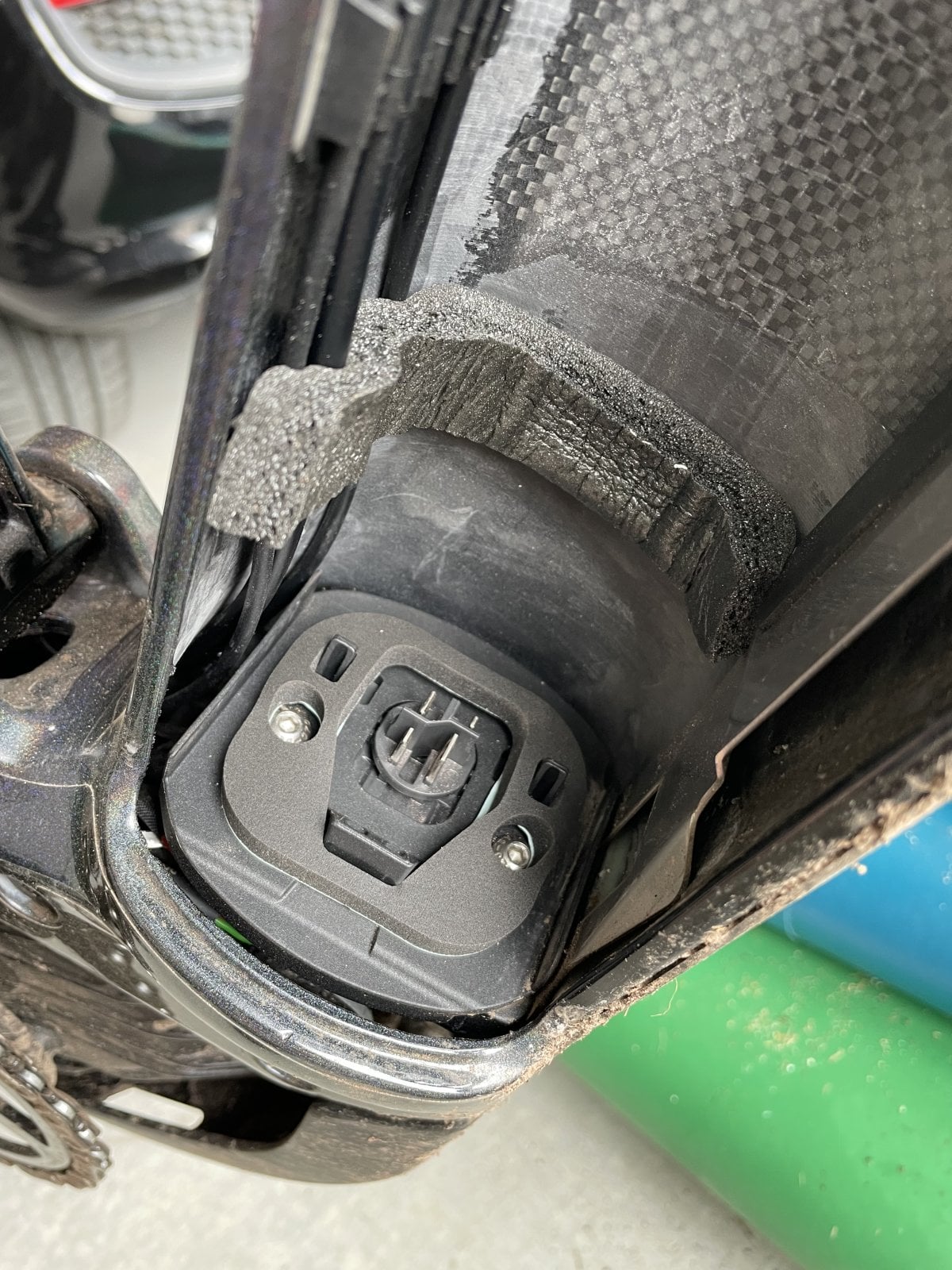

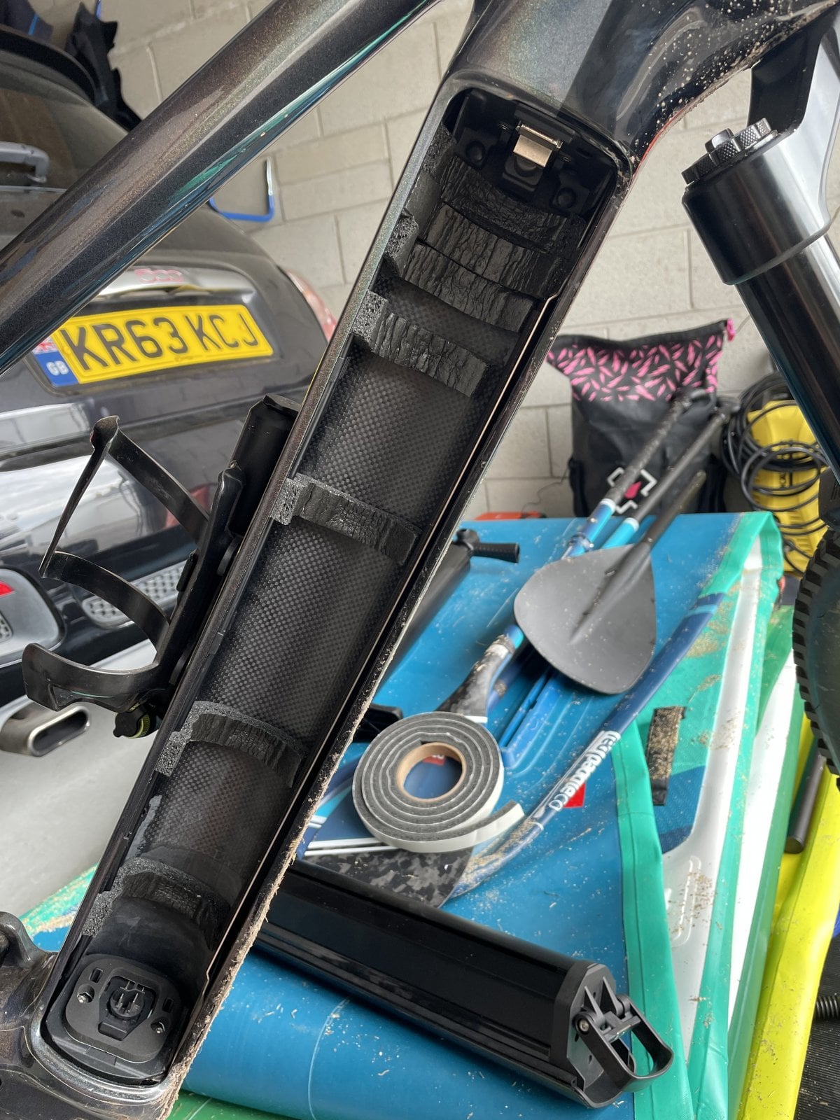

My fix has not fixed it.
riding today over some chunky choppy roots and generally blown out trails and I am sure it’s still making a noise. Not as bad, but still there and enough to be distracting.
I’ve got rubber strips under the metal plate and all the foam that I posted pics of and the Bosch rubber damper.
I do now wish I had bought a Levo. Even though it would have been lower apec

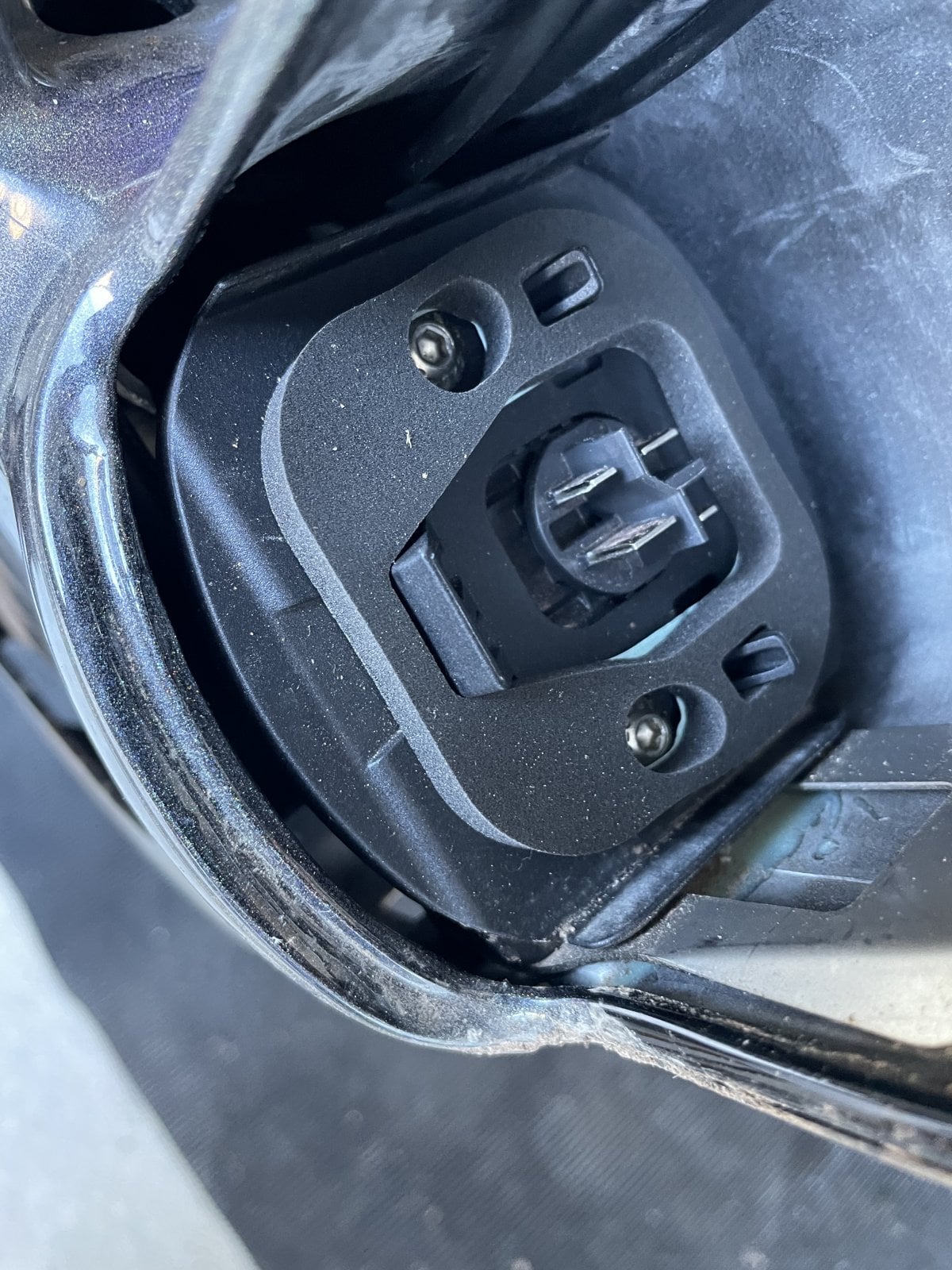

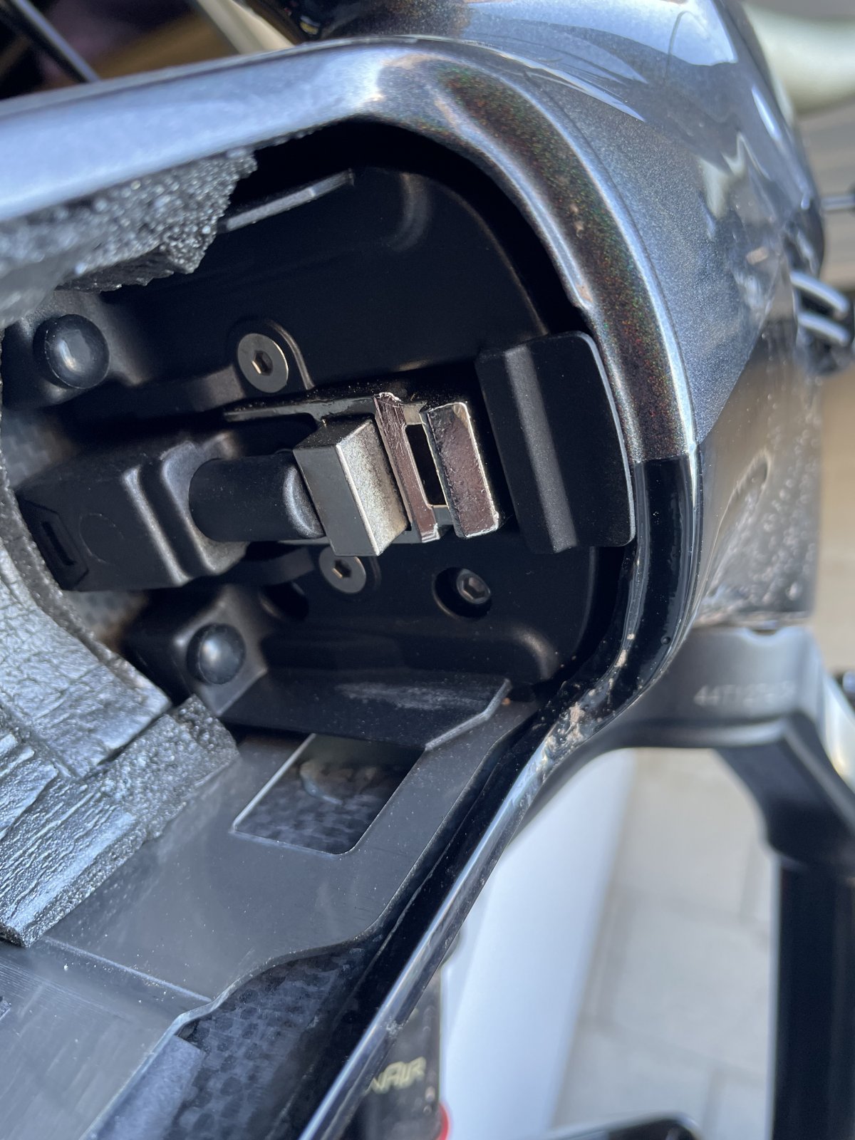

regarding battery mount alignment.
does this look right?
still not reaching full travel on the suspension either. So I suspect the fork has a few tokens in it and the shock must also.

After putting a few stripes of foam as @Dave_B did, and a shim between the top bracket and plate, to shorten the distance between brackets, the battery feels still. Also, I put a tire insert to my rear wheel, which made the rear end softer.
I don't have that feeling that the bike is falling apart anymore. But it is still much noisier than my old Merida eone-sixty.
