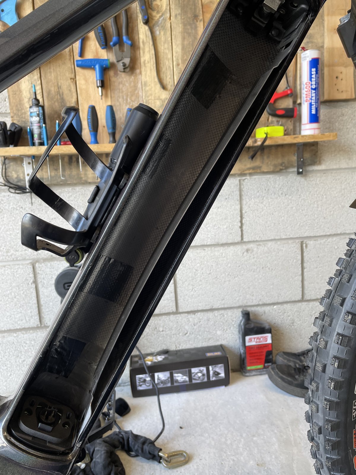

I’ve got my bike back from the shop.
Both battery plates have been moved closer together and some rubber supports have been positioned against the top mount to prevent any bending/movement of the plate under the load of the battery.
significant upwards bow in the rail plate, suggesting to me and the shop tech that the plate is actually too long.
there is significantly less movement on the battery door, in fact, very difficult to physically move it (compared to the standard setup where it’s easily to wiggle the battery whilst in place.)
Im at FoD on Sunday so will report back after the ride.
I’m not removing the battery to take pics, I want to leave it as is and judge the noise/rattle before I mess with it.

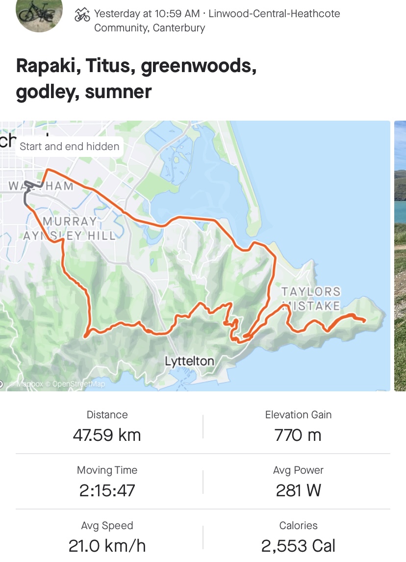

Went for a ride this morning. A lot more downhill trails with some decent chunk. Super happy again although the standard grips are on their way to the bin. Im doing okay on the Aravada saddle surprisingly.
Felt great after this ride and home with 28% battery (from 100%) The whole ride in 60% eco and 40% Tour+. I have altered my eco to plus 4 power. It’s perfect on the road and smooth climbing trails.

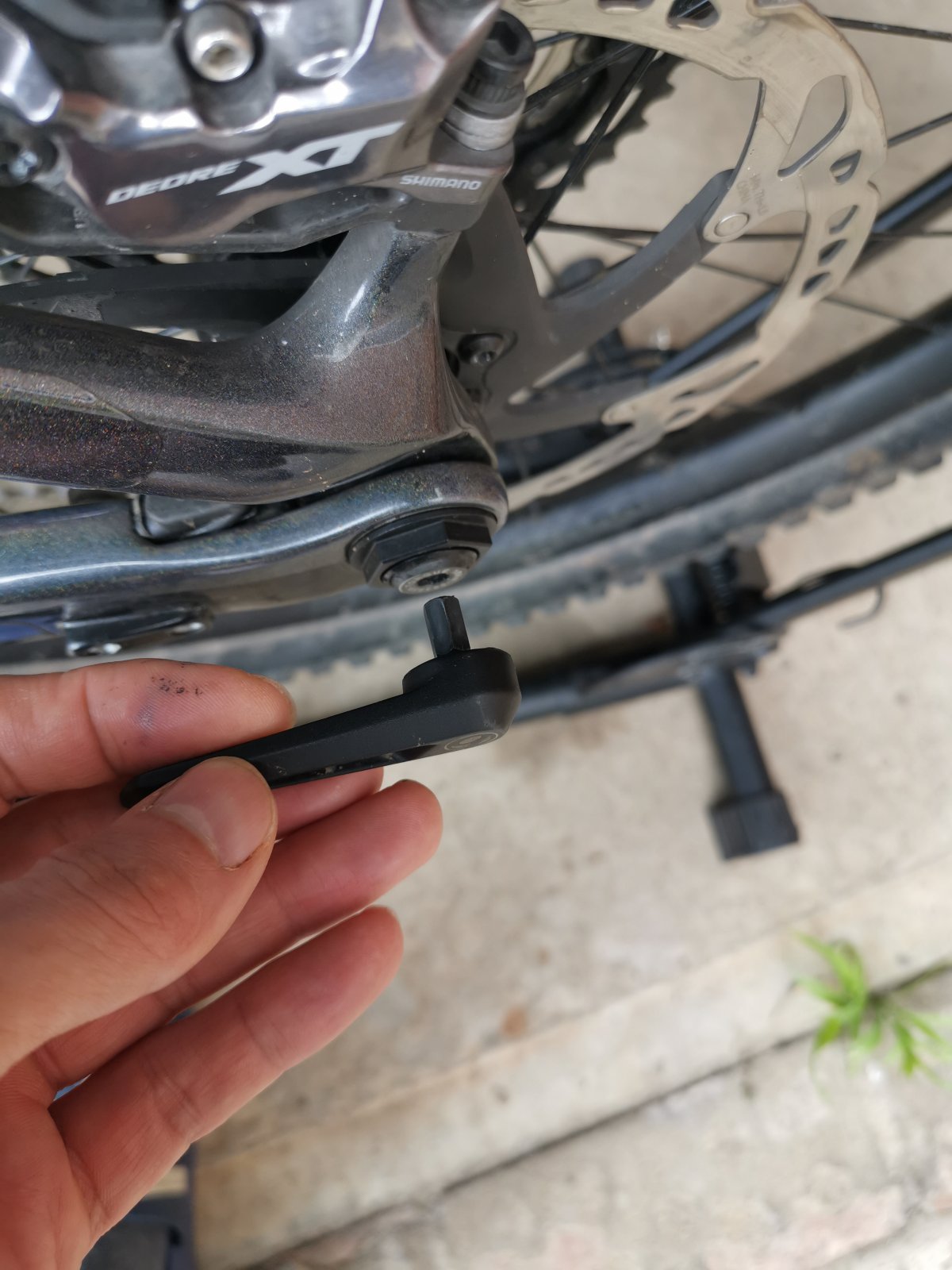

I think I found another clunking peace in my Rail! I removed it today and it seems there's one clunk less in the Rail clunking symphony :)
It sits loose and clunks when I just touch it.

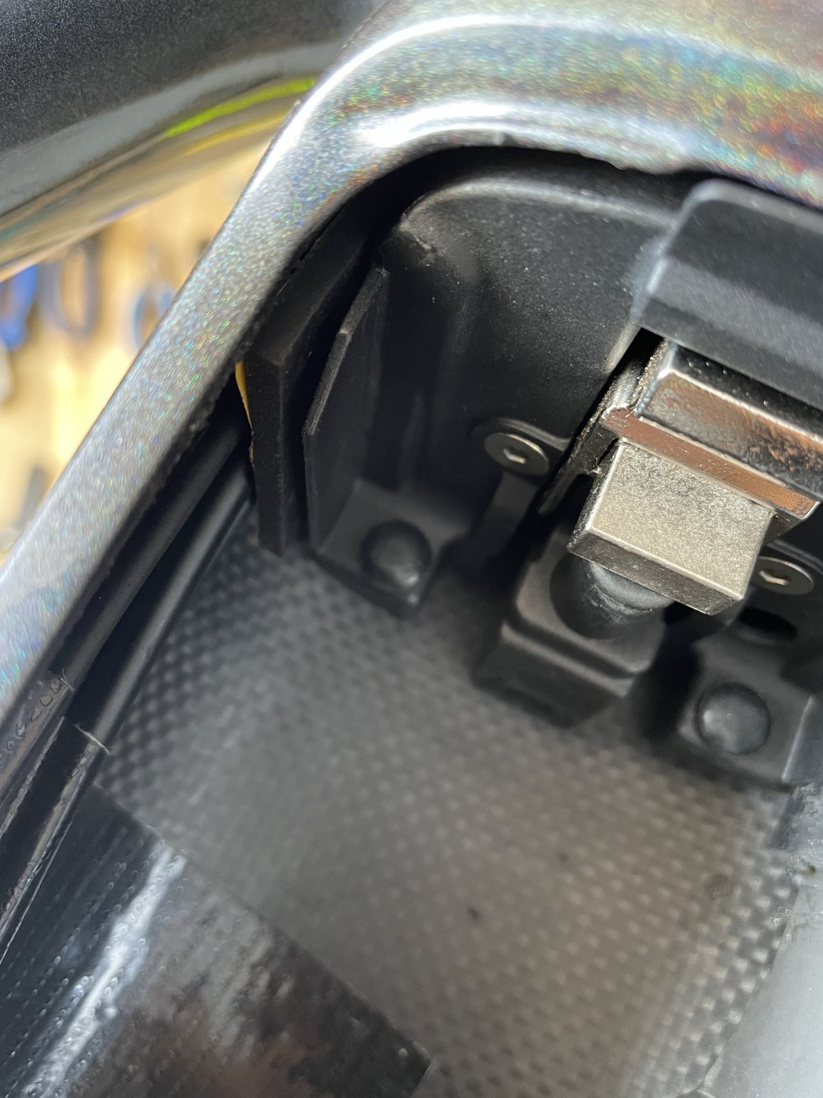

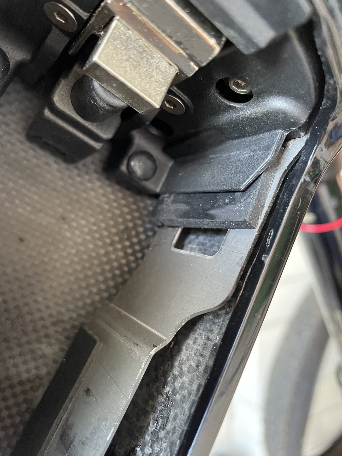

Ok here are the pics of the adjustments made by my LBS. Still not ridden the bike yet but will be doing so tomorrow.
Some thick dense rubber to support the upper mount and some significant adjustment to move the battery mount plates closer together.
The battery needs a very solid push to get it to fit and for the lock to latch (you have to use the key to latch the lock). It feels very solid when in place.
do you mean the upper and lower part to get closer? or something related only to upper part where the lock is?
is the same suggestion of Rob?

Yes, both ends moved closer together.
After todays ride I can report it has massively improved and I think there is now zero movement noise from the battery.
the motor noise however is always going to bother me.

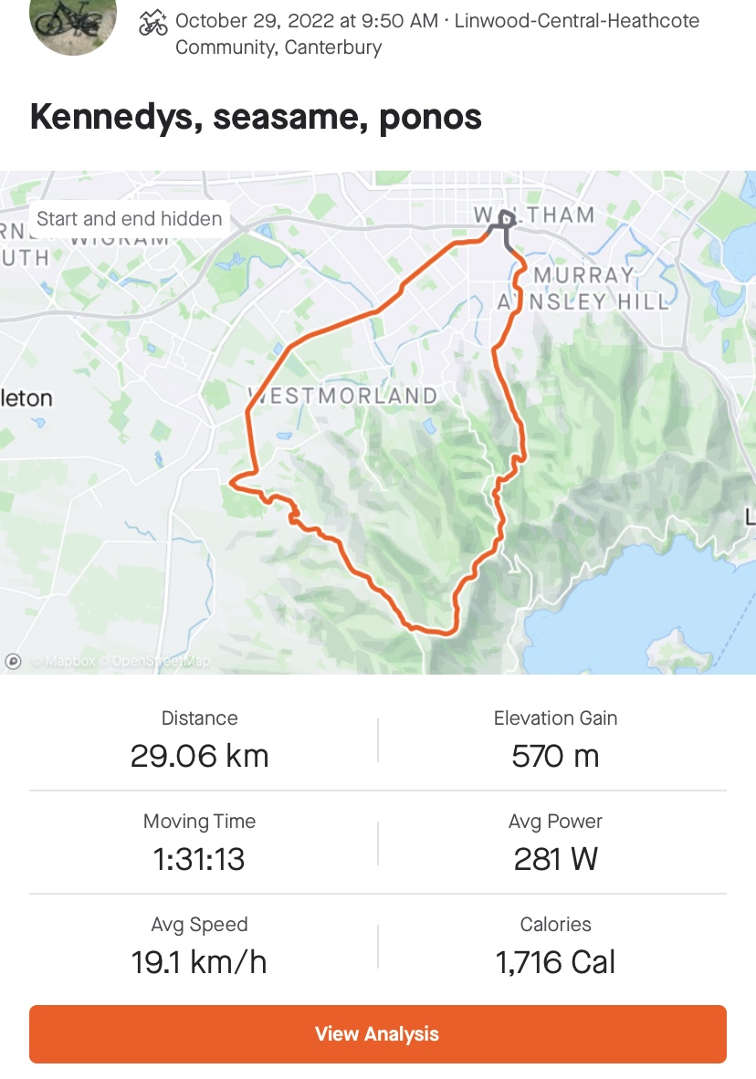

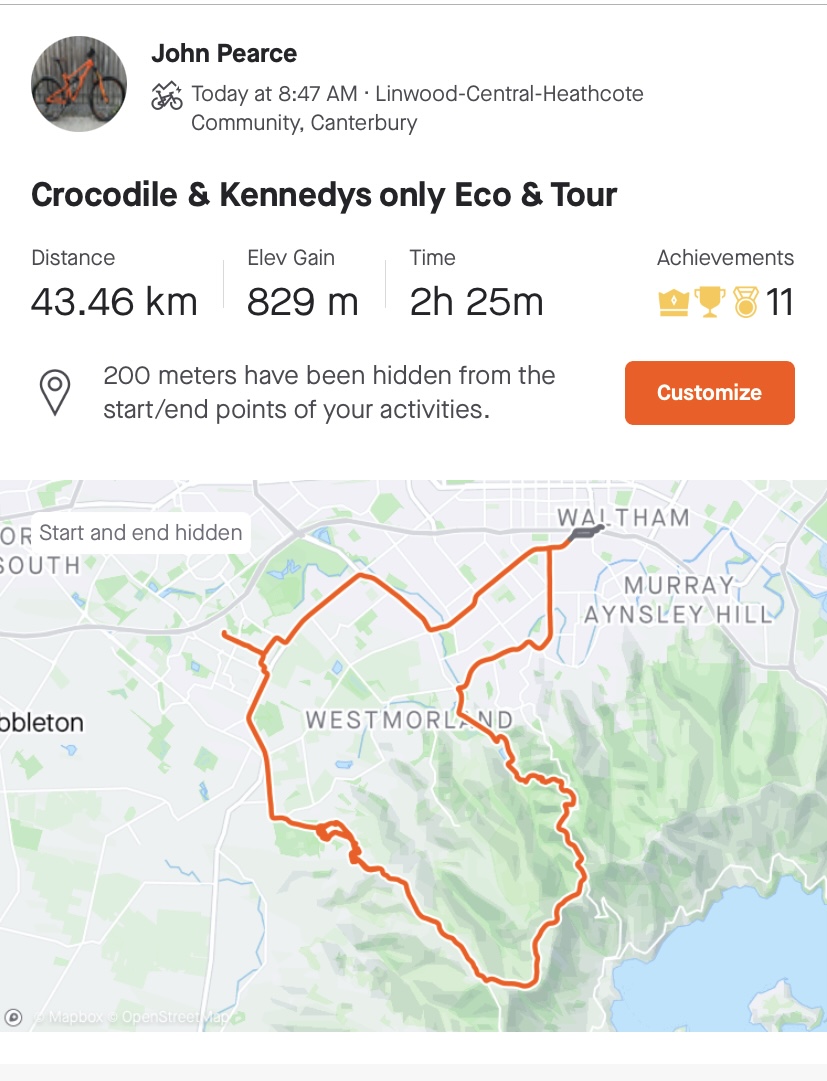

Fully charged my 9.8 on Friday, did two rides with no charging in between. 50/50 mix of sealed road and trails (summer here). Think I'm at a good place with the battery now on its 8th cycle.
Distance = 76.65km (47.6miles)
Elevation = 1340m (4396 feet)
All climbing done on Tour+ and everything else on Eco. NO EMTB or Turbo used. 106kg riding weight, Bontrager XR4 29x2.6 tyres.
Came home with 7% battery left (range said 5km remaining on Tour+)
