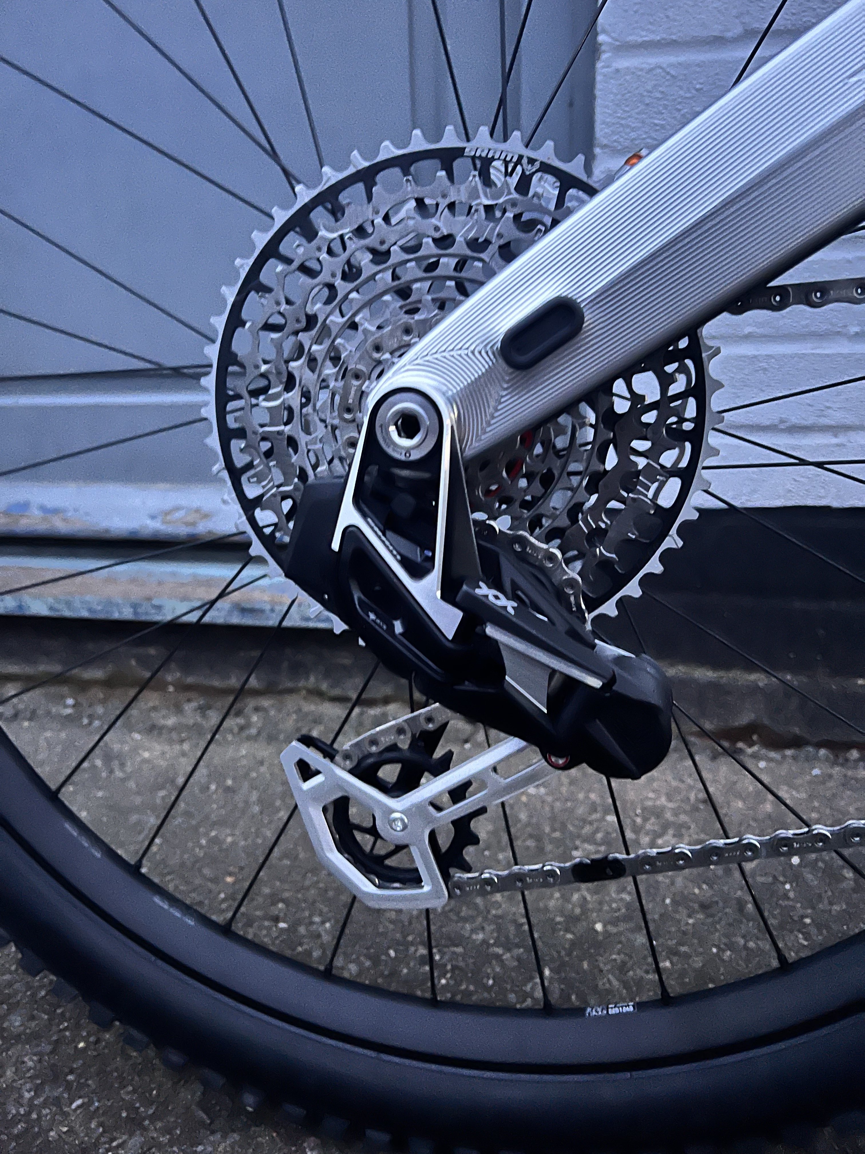

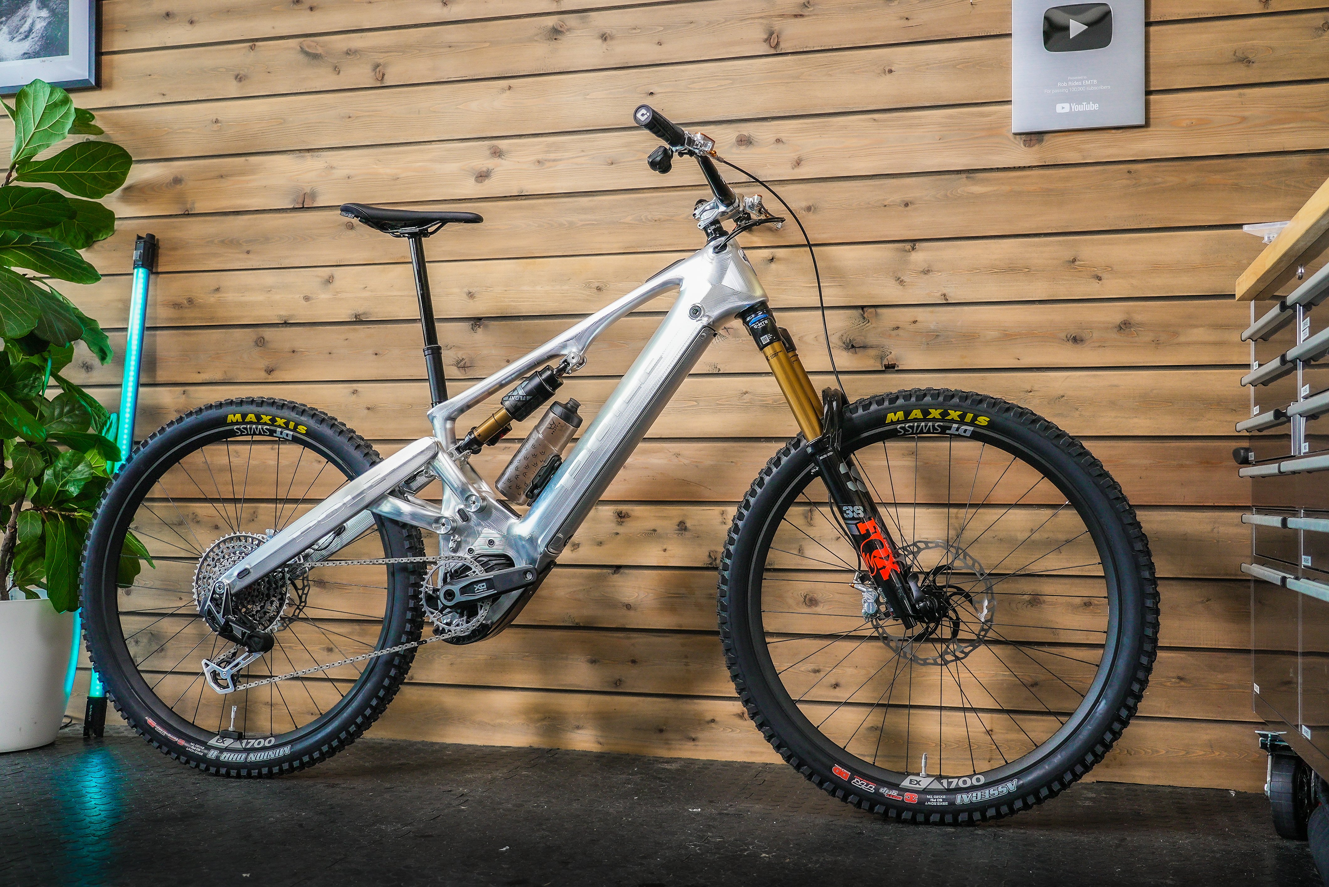

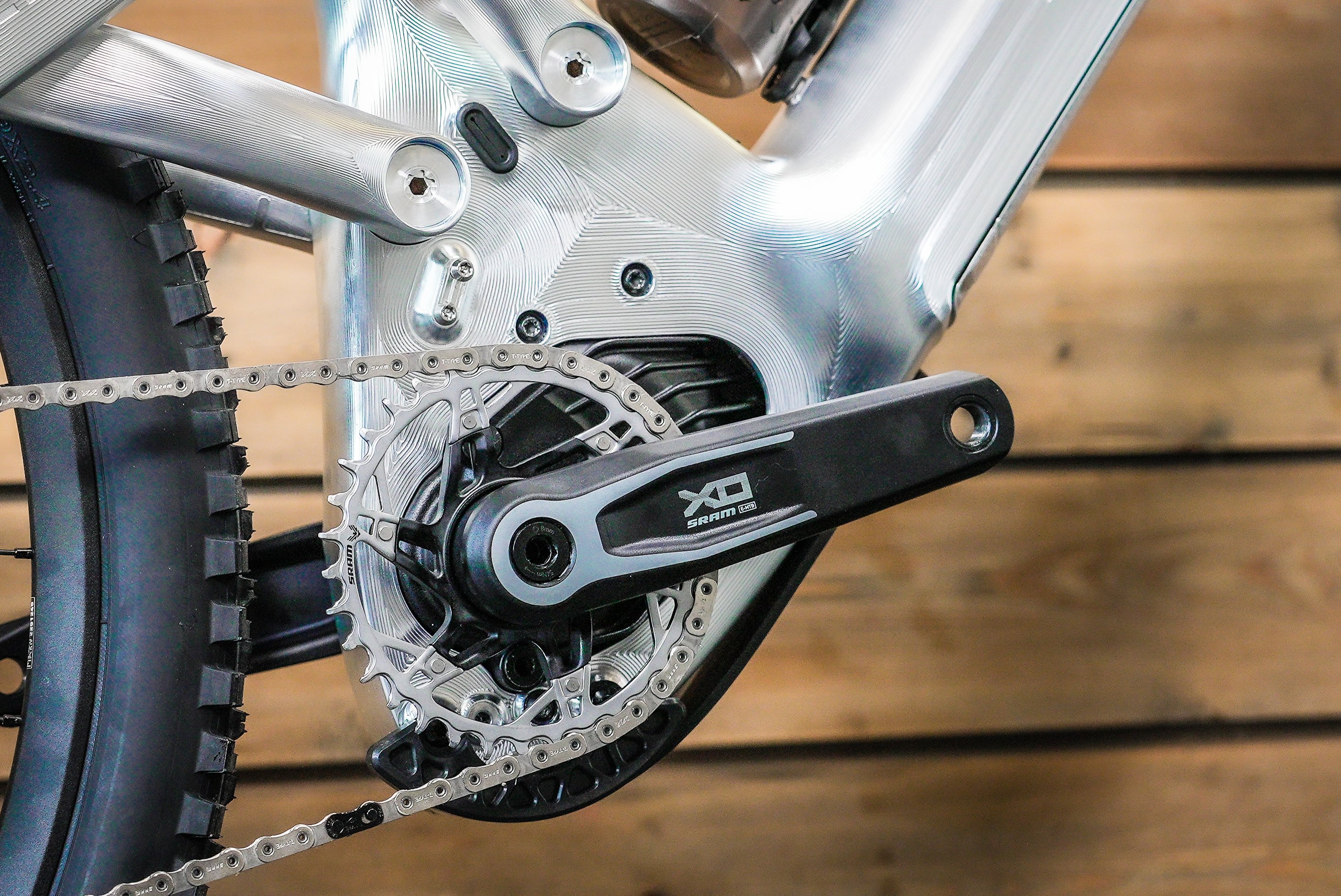

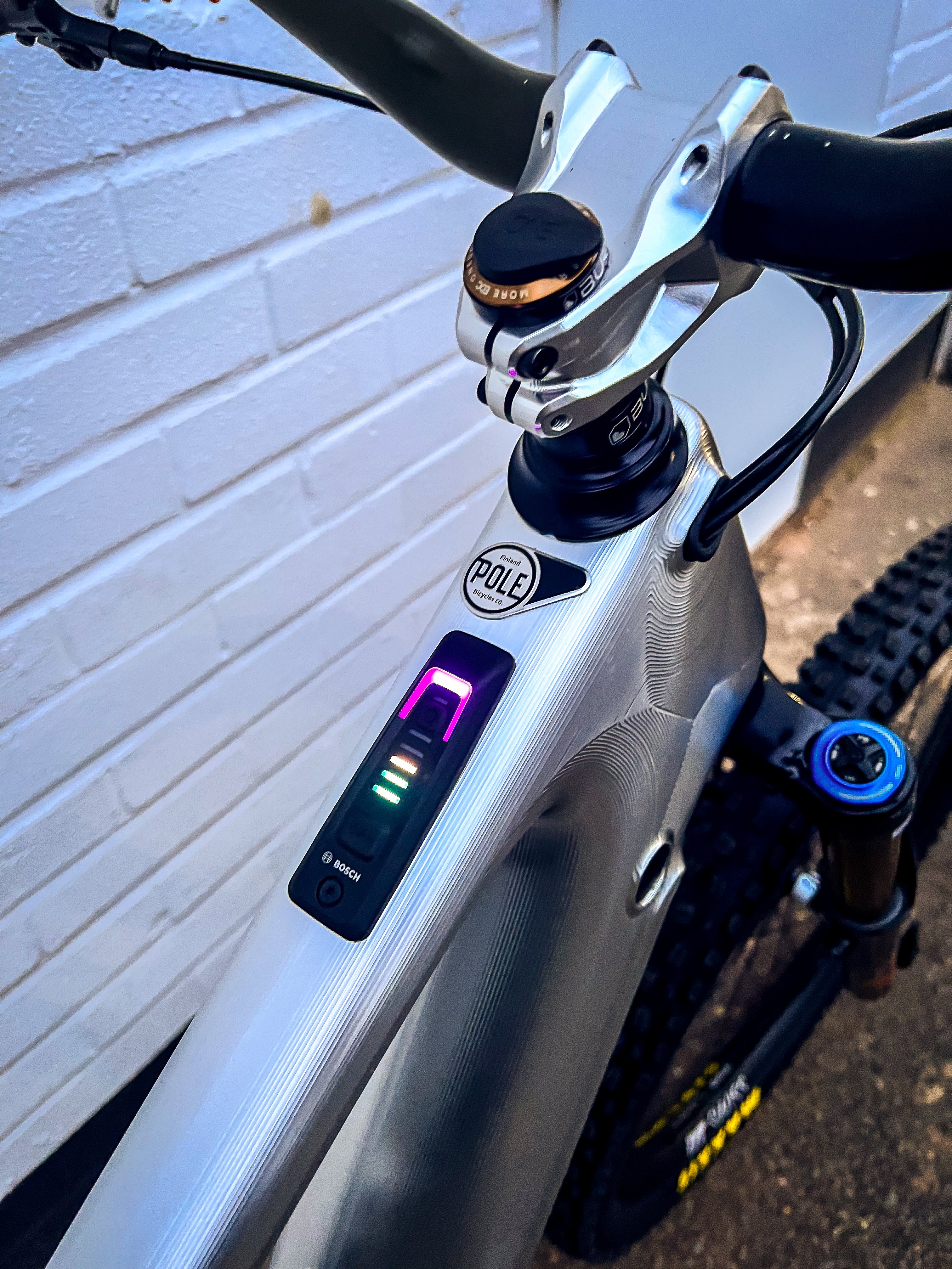

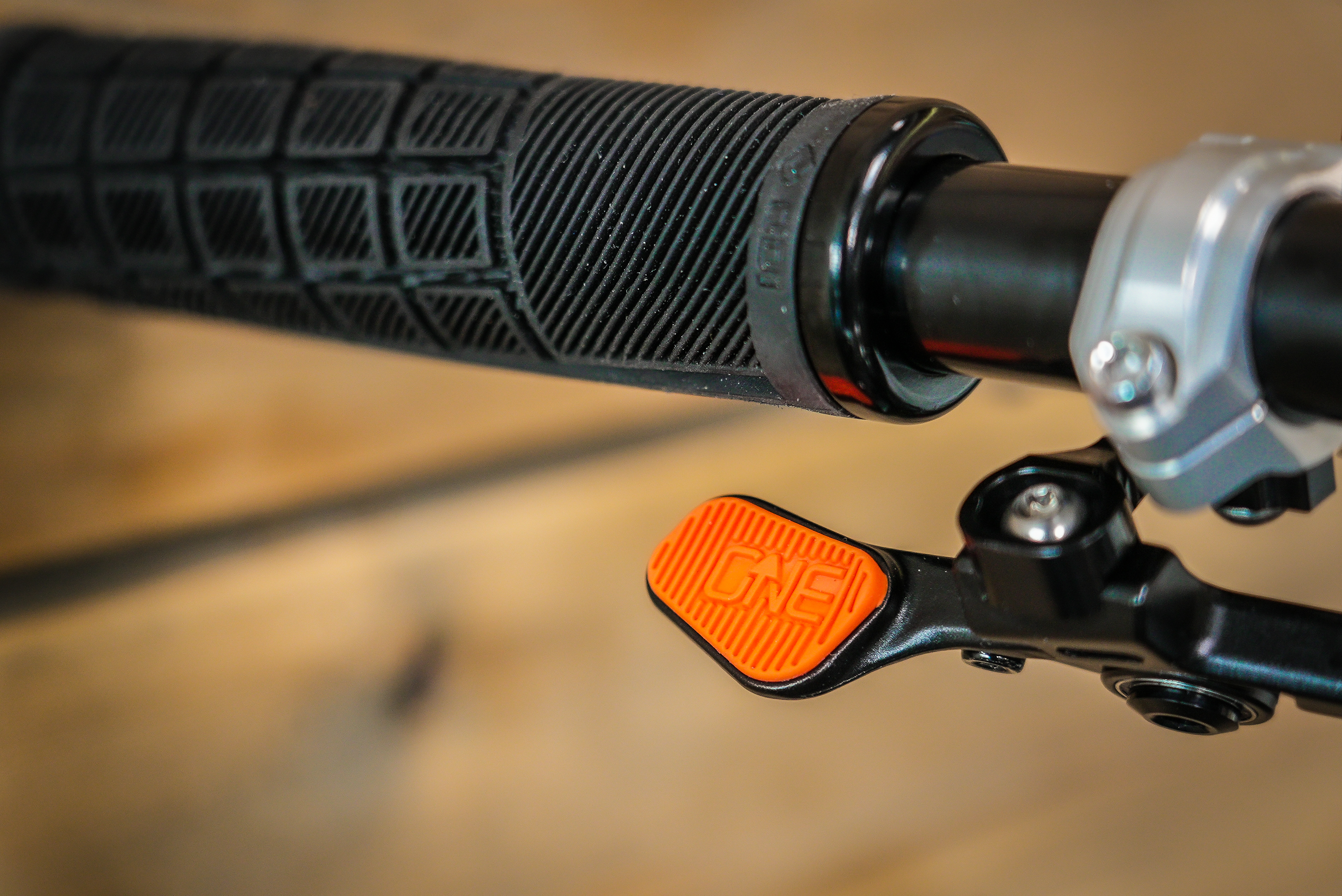

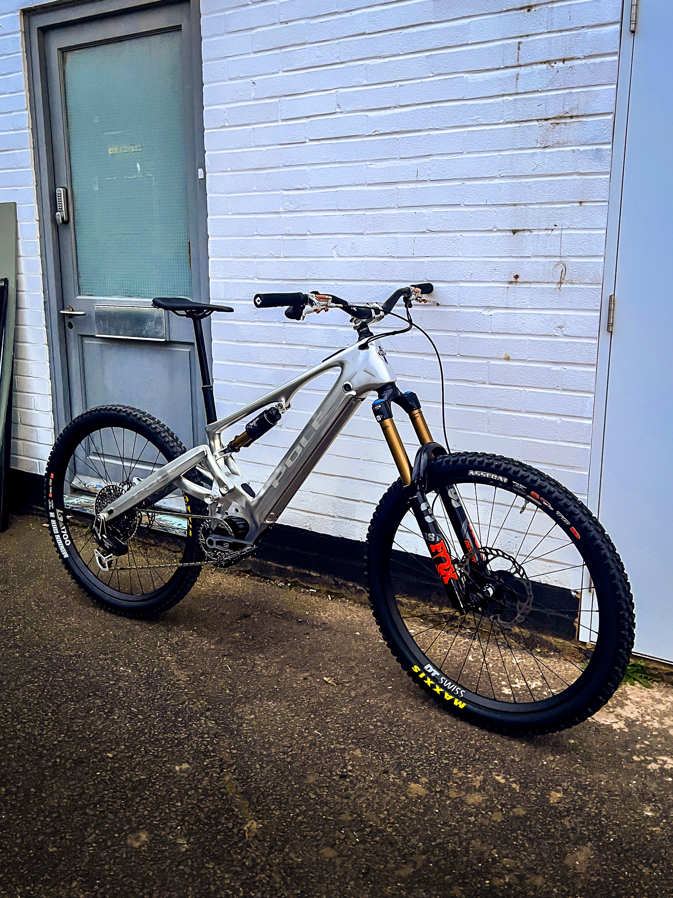

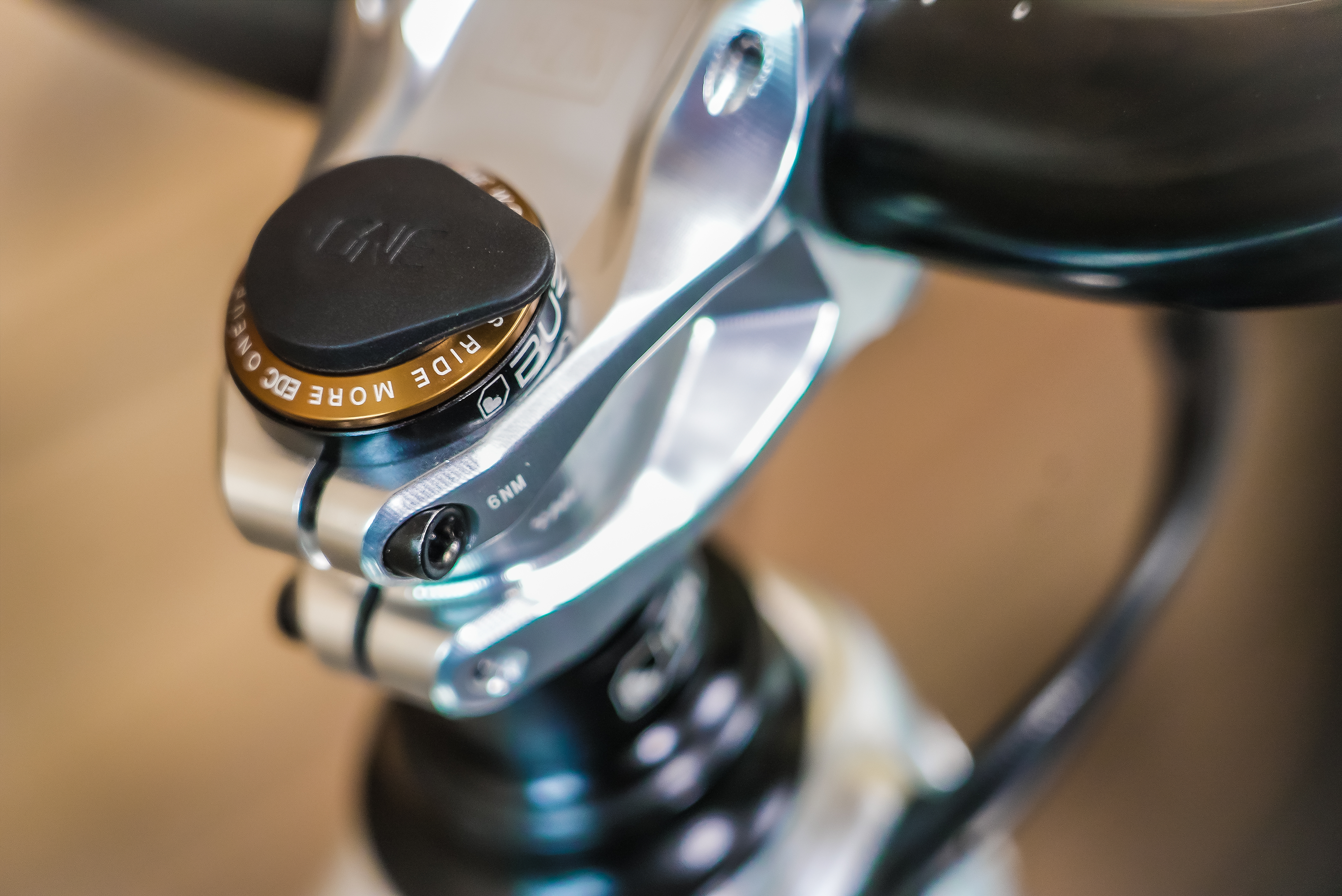

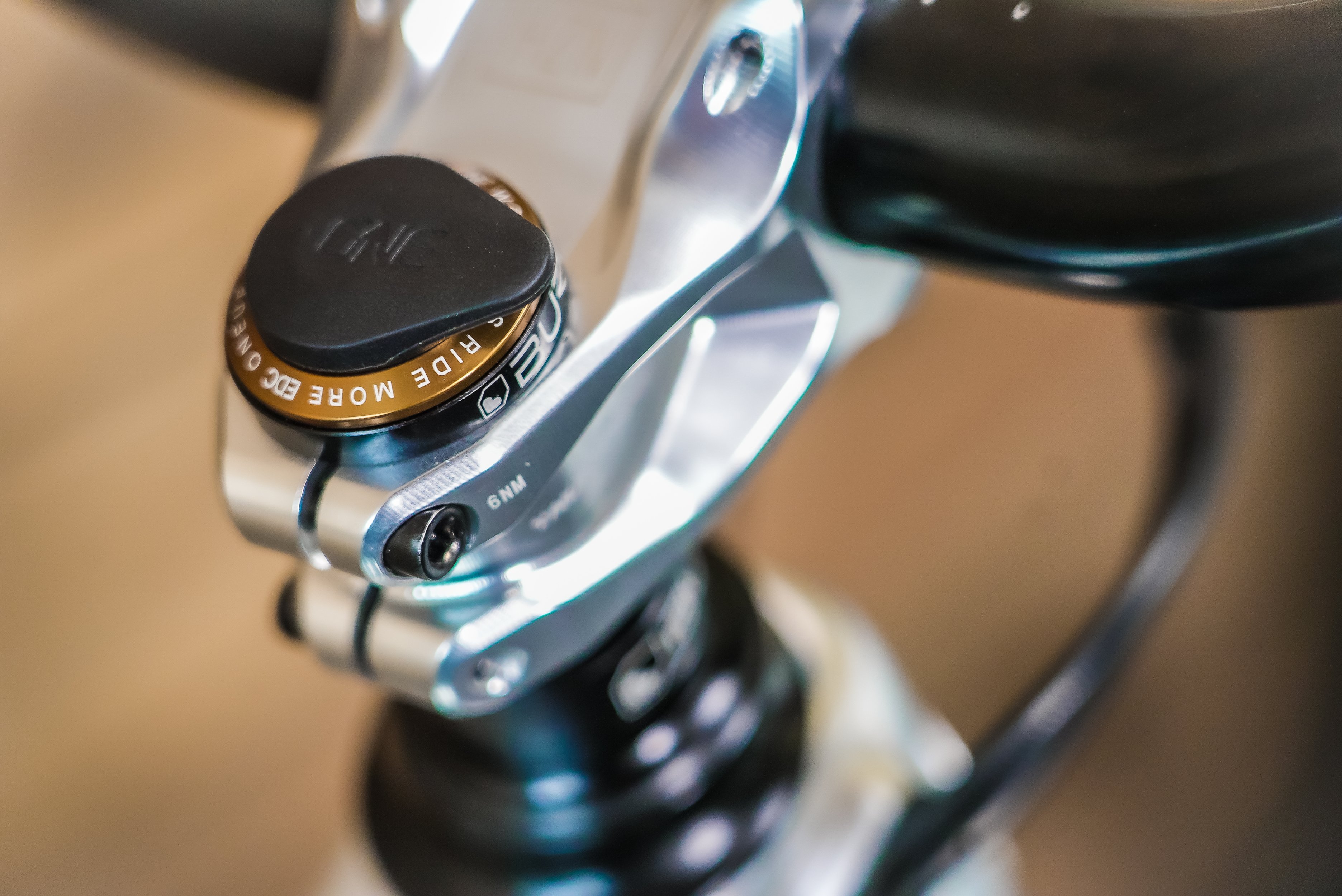

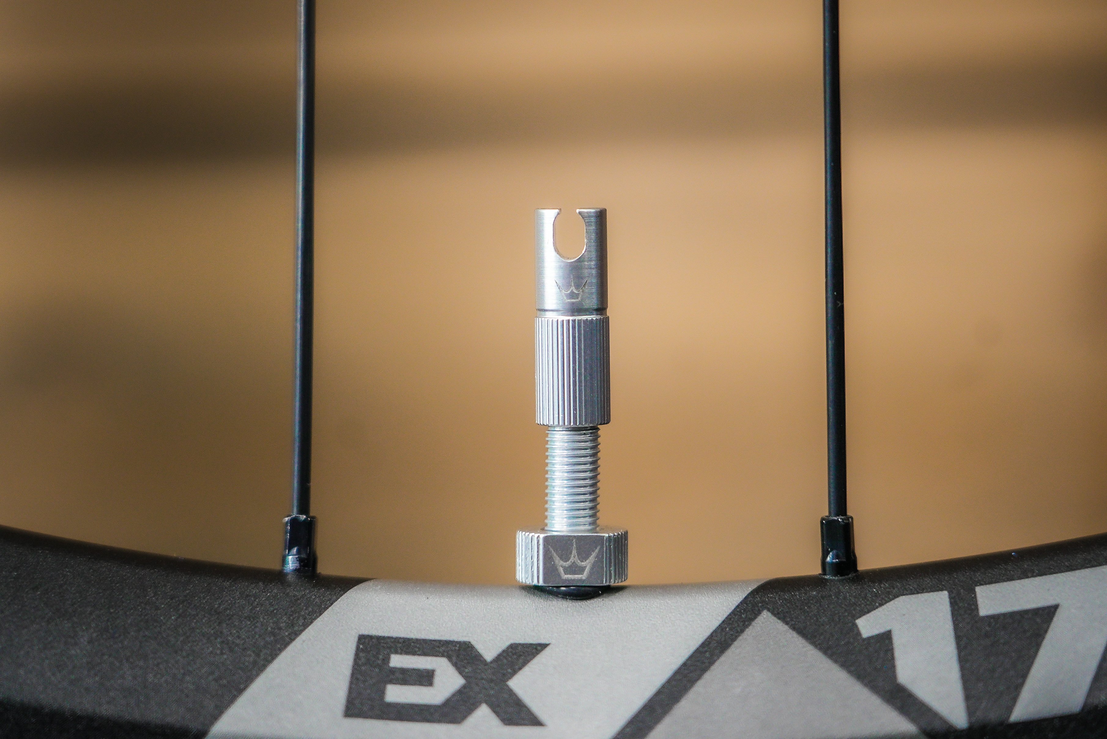

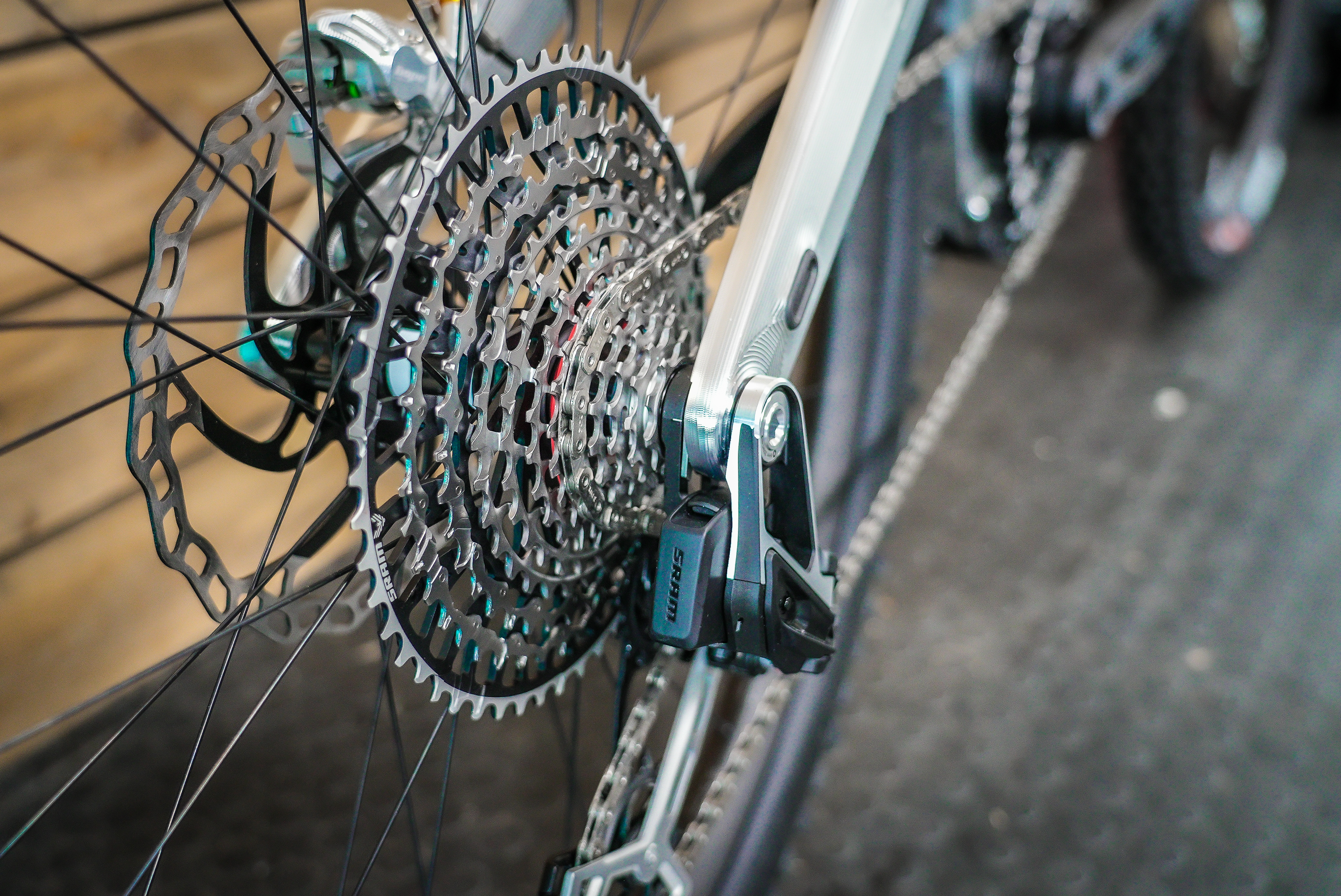

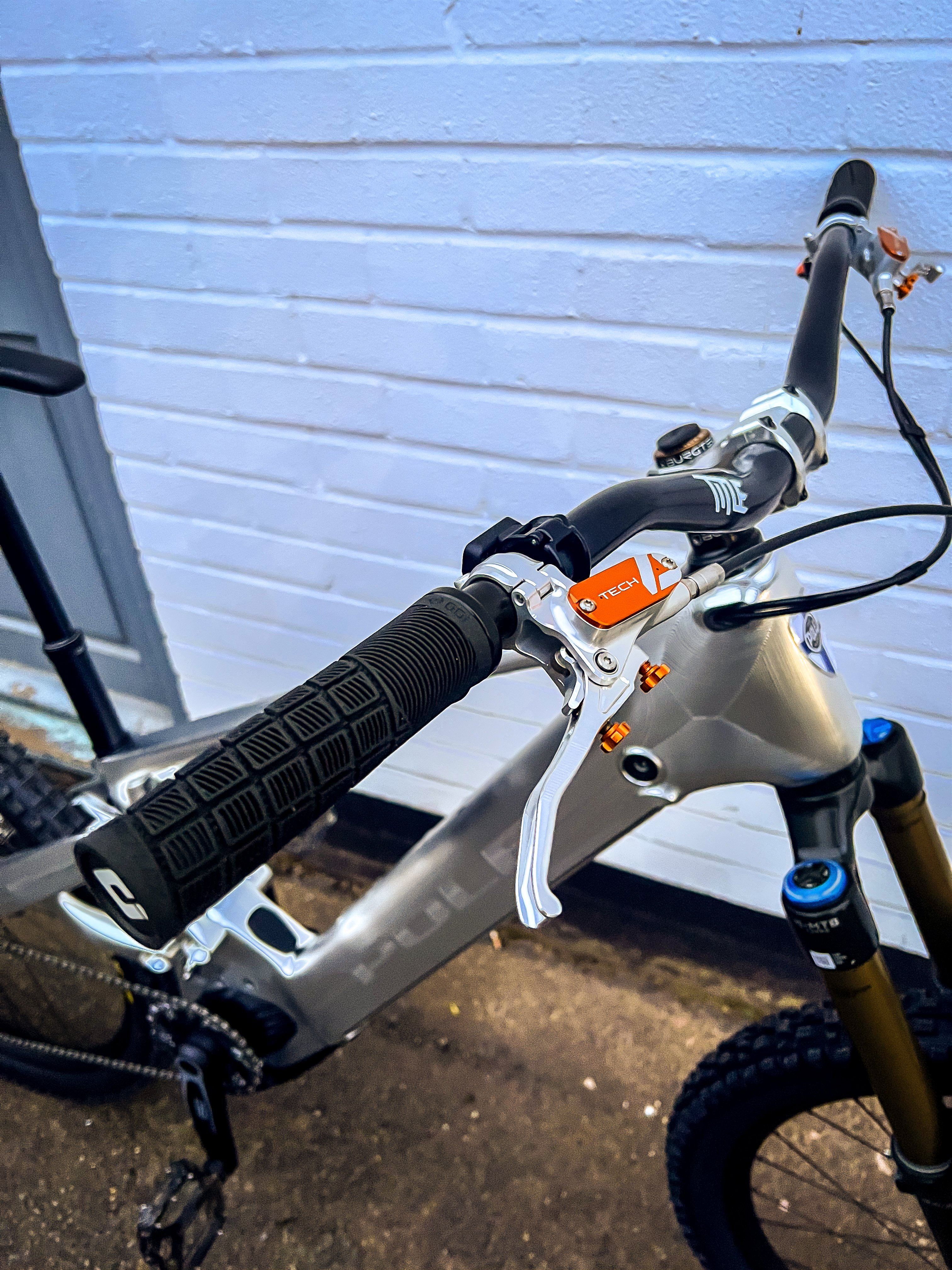

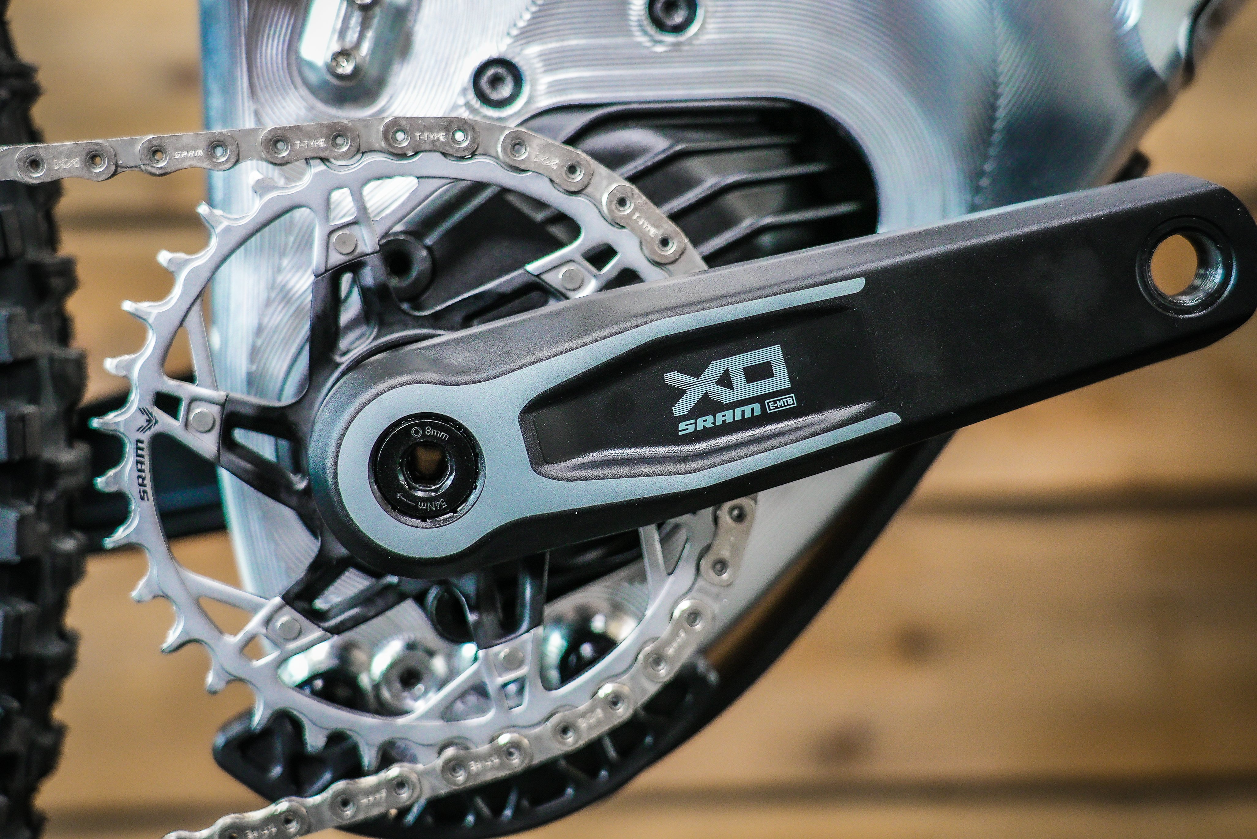

Done.
IMG_7388.jpg IMG_7381.jpg IMG_7379.jpg IMG_7378.jpg 56DA745C-3B45-4710-BAF4-2DBB562B85EB.jpeg

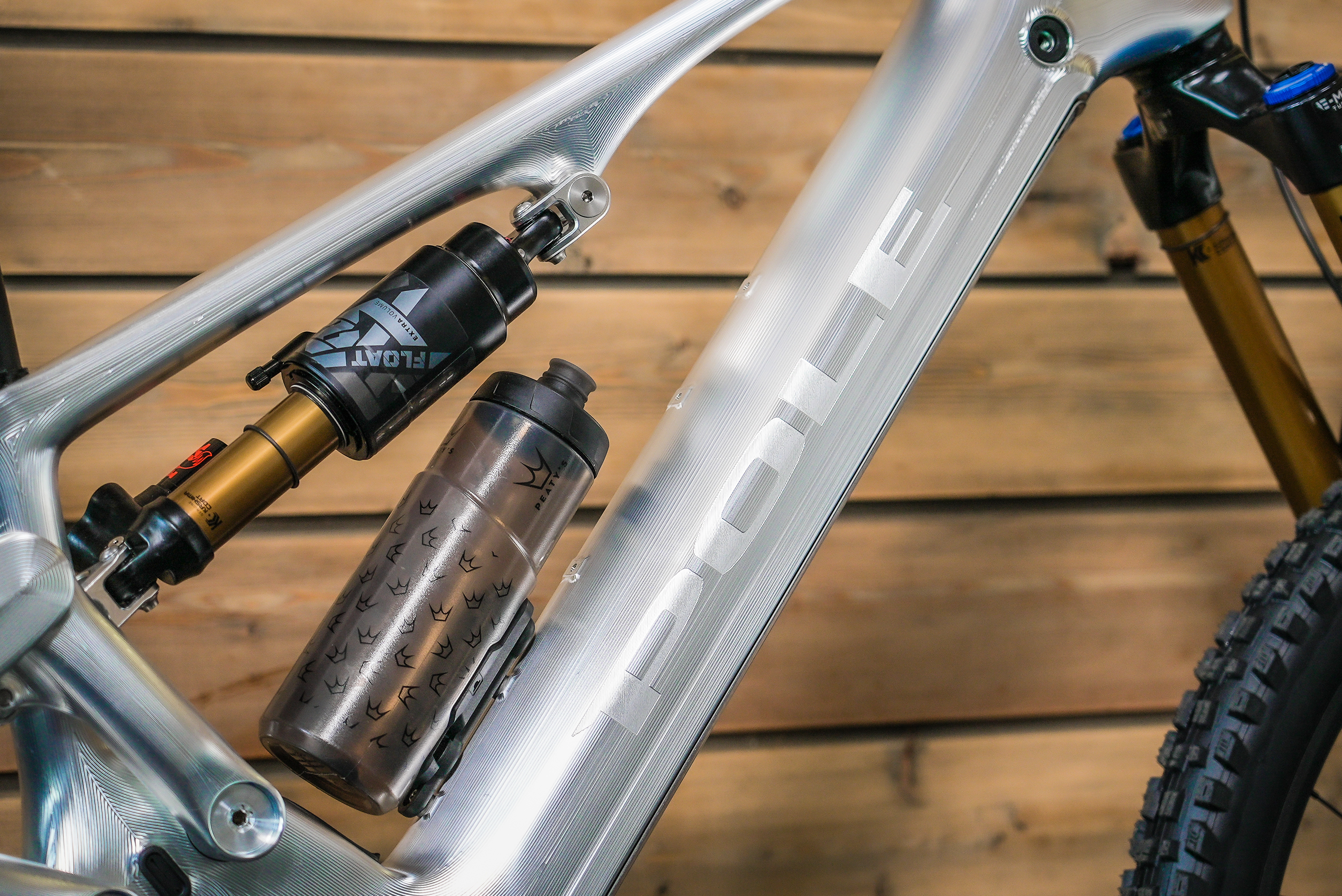

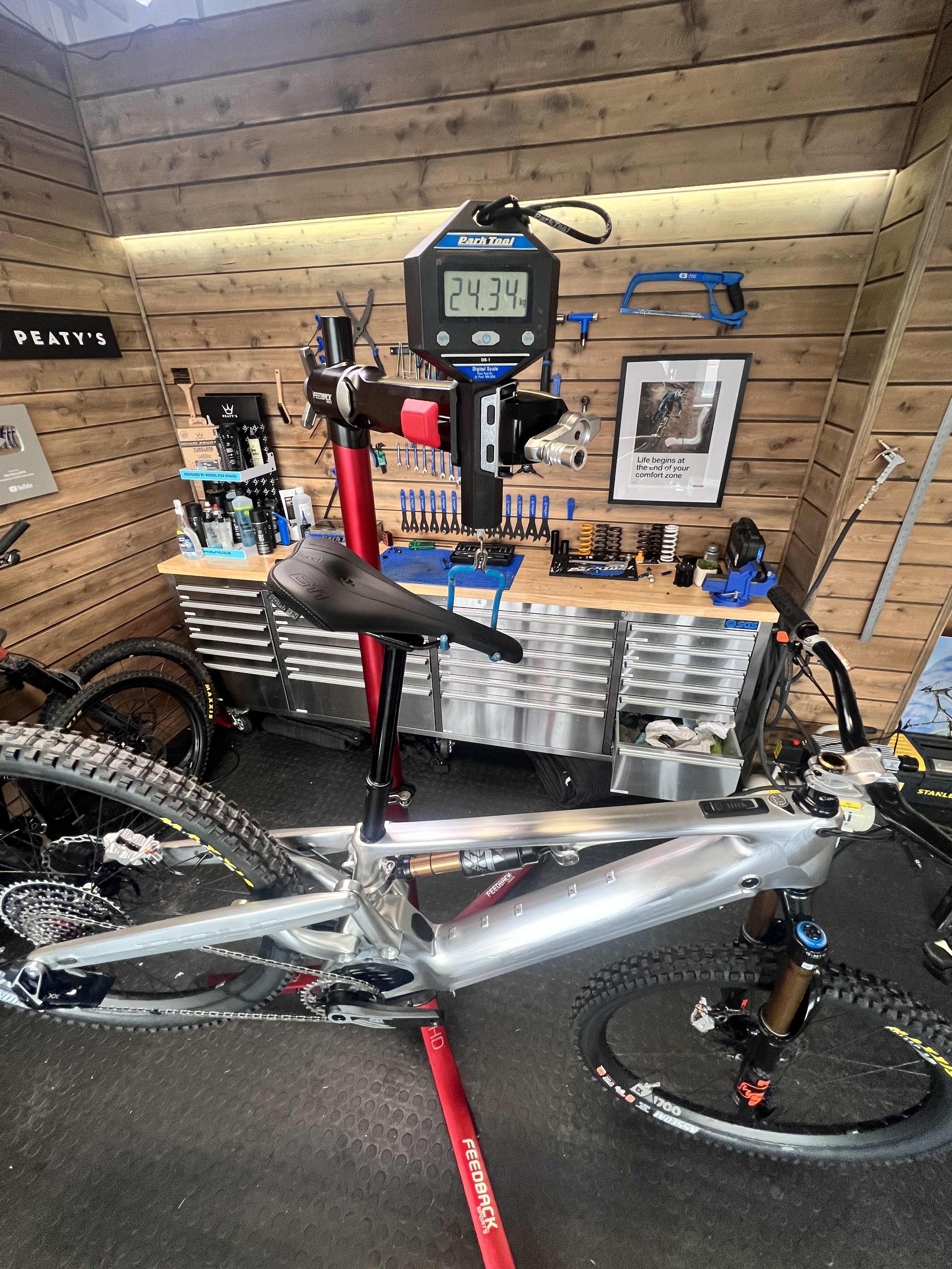

Weight is 24.6 KG
Fox 180mm but stock head angle and front height maintained by using the +5mm Works Components reach adjust

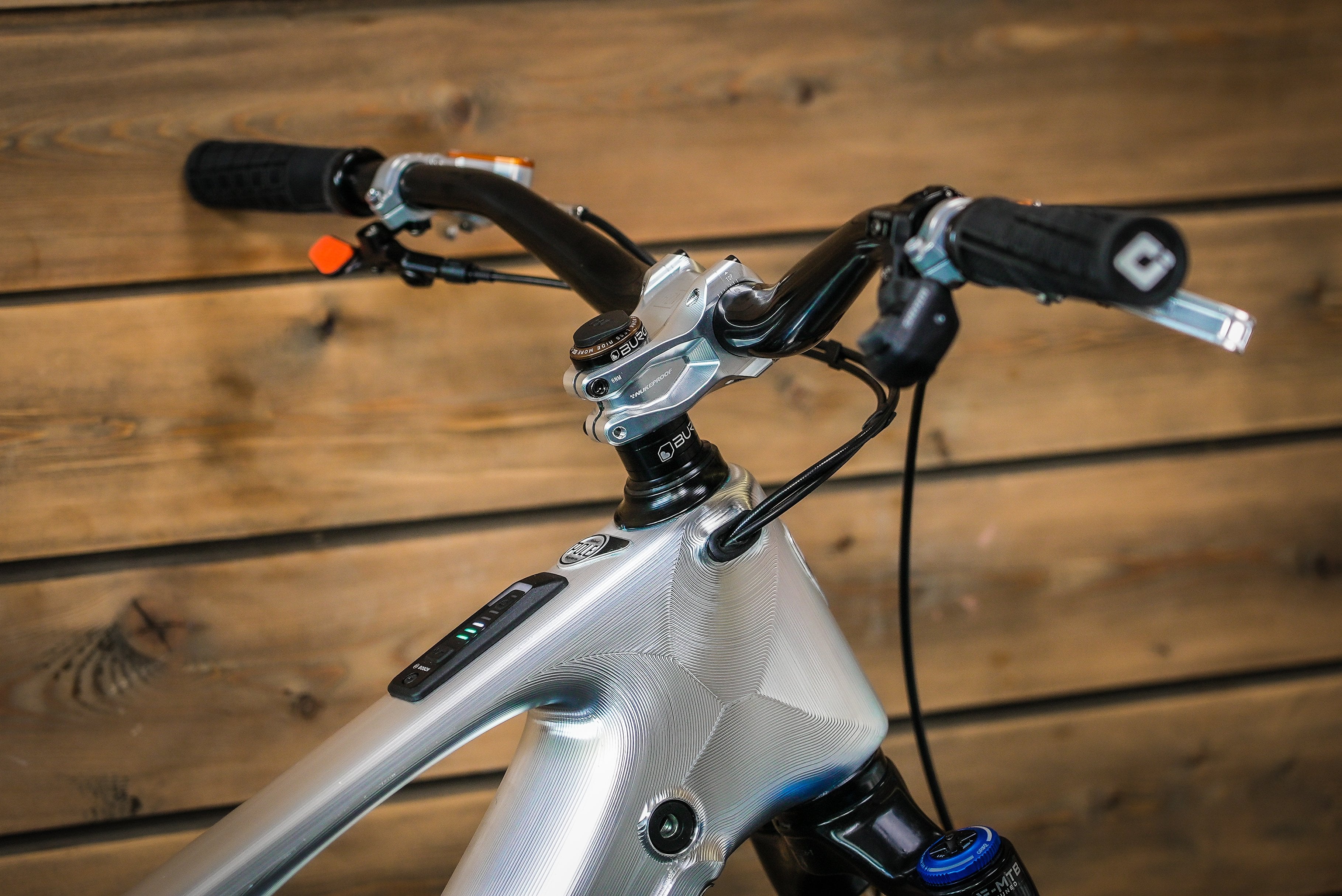

Pretty much perfect.

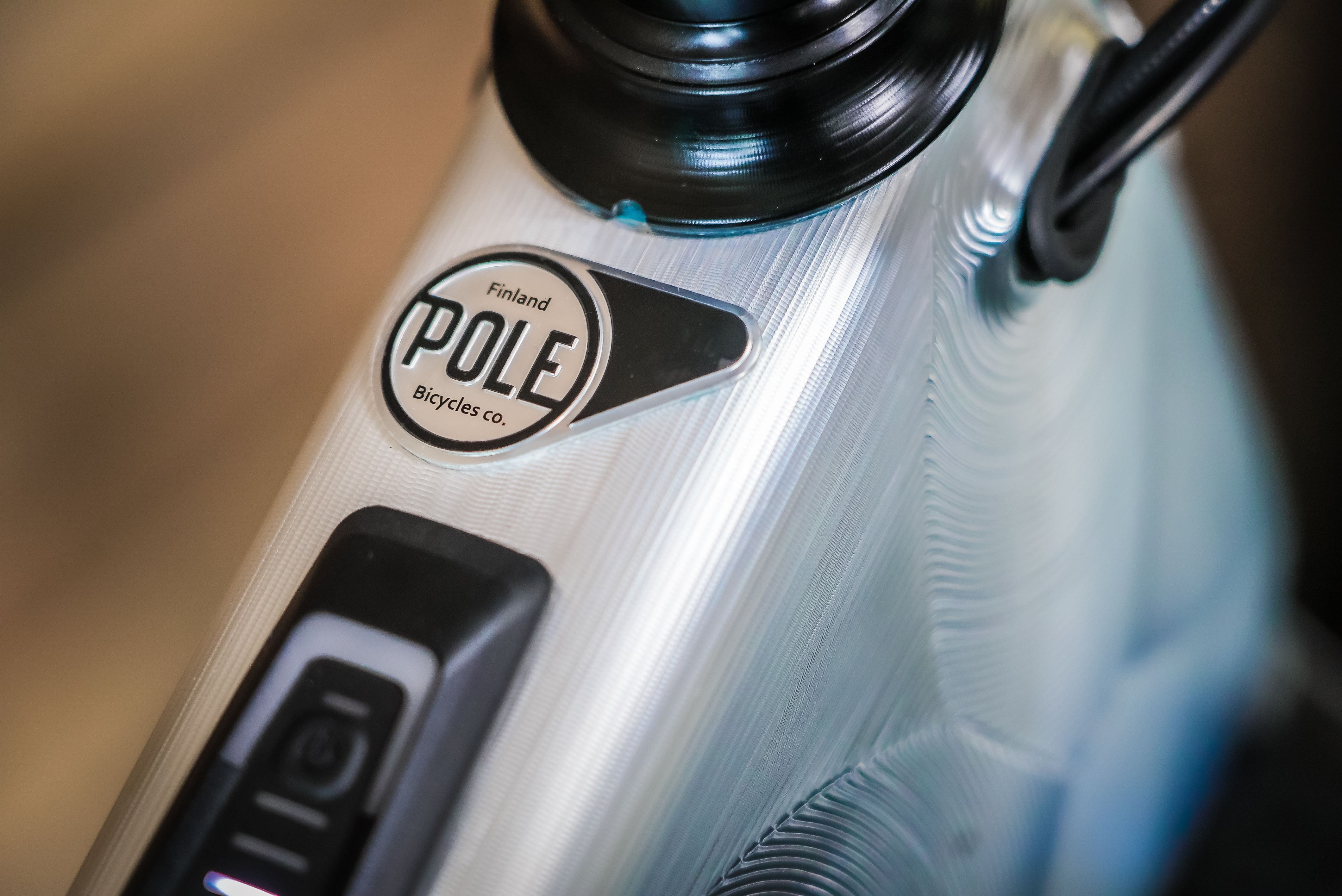

I hope you persuaded Leo to get rid of the battery lock and key for the next version 😊
I did speak with him about this. And the charge port rubber plug.
He also mentioned that these are Bosch problems to solve as well - and hopefully we will see some better solution in the future.
My wish list for Bosch is a better lock system, keyless, a better charger integration (MagSafe / unidirectional would be much better, that port sucks trying to work out the correct way round!) and also a 750Wh Race Battery, that saves a chunk of weight. The 750Wh is thicc and chonky.

well damn, my Large Levo is 455 reach with 1235 wheelbase
My XL Levo had a 480 reach with a 1266 wheelbase
you're still a brave man ! but if it fits you it will deffo fit me

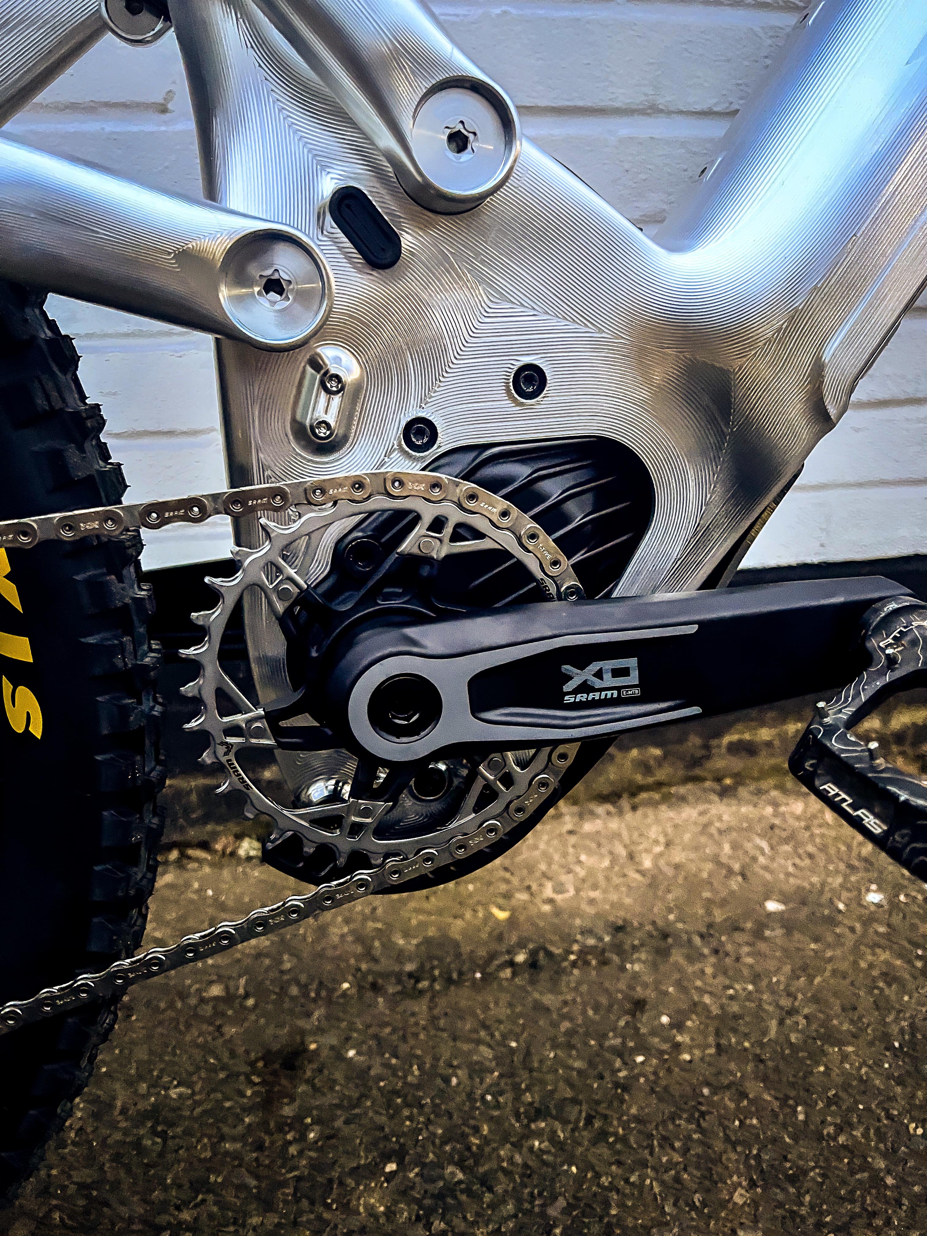

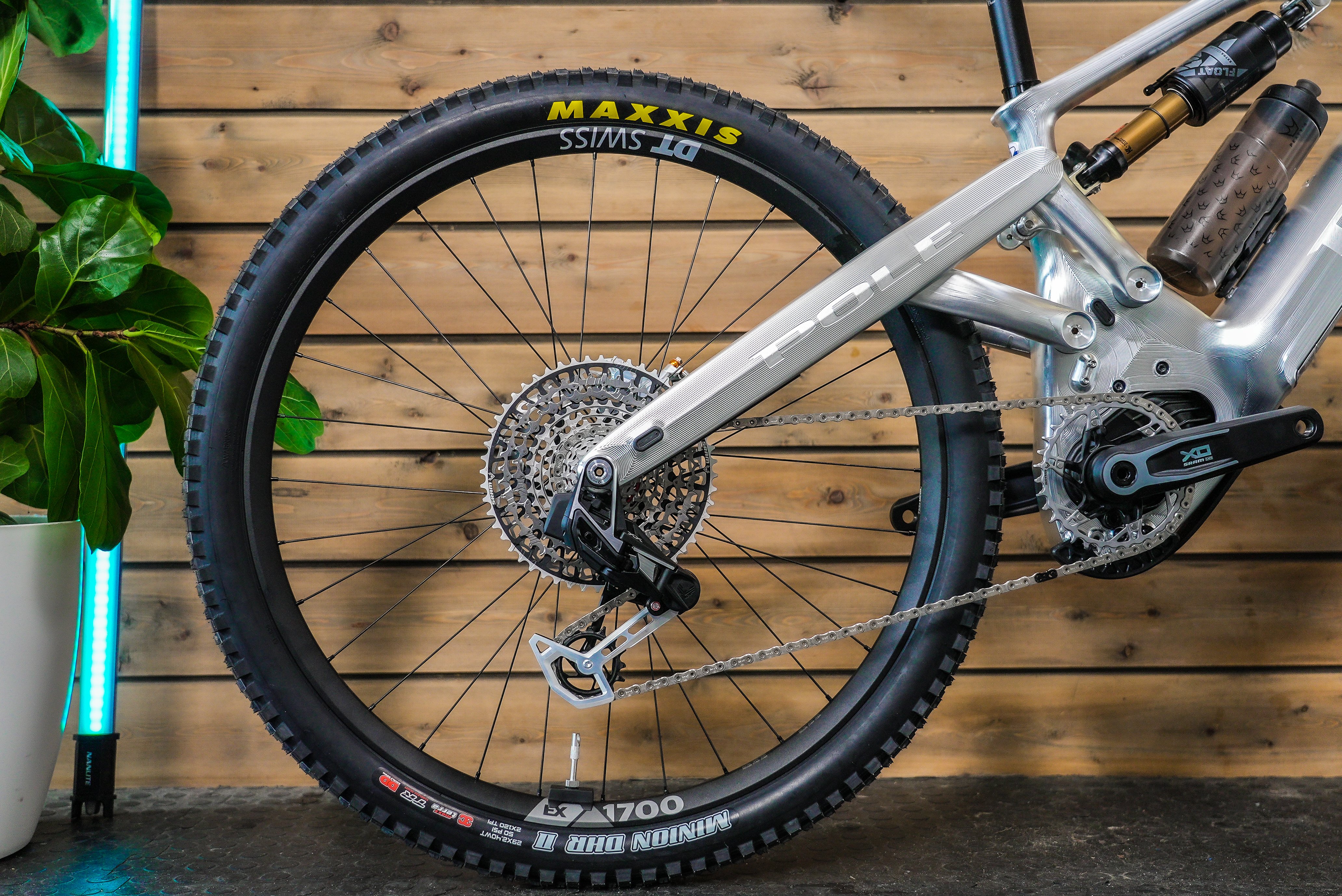

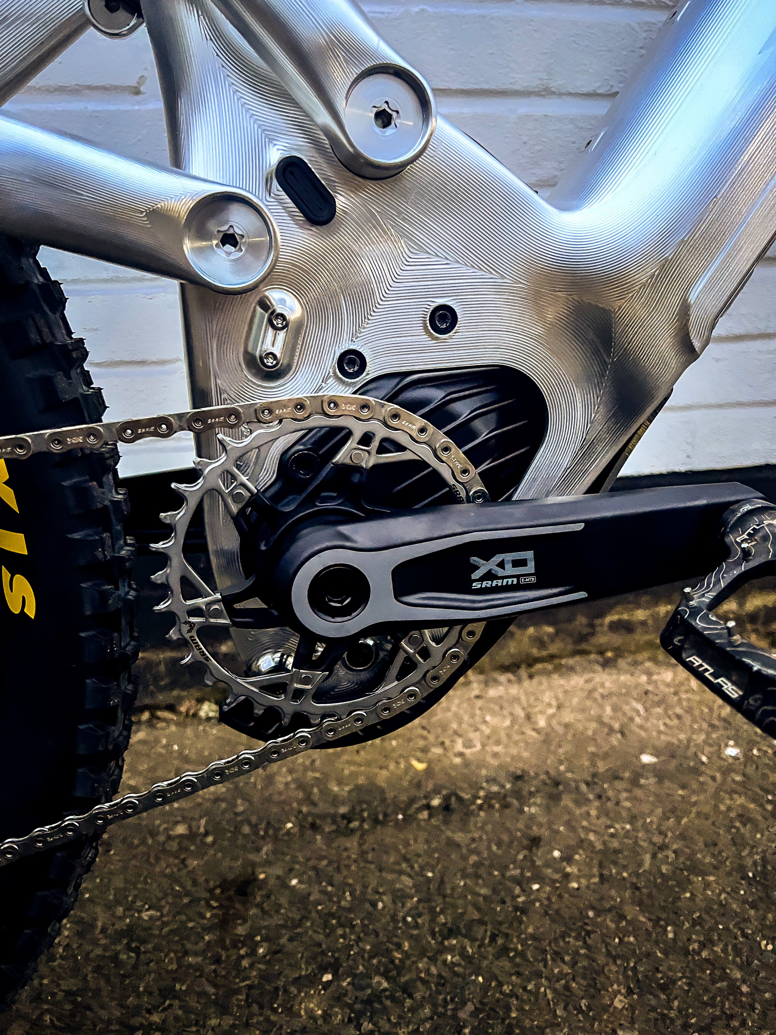

No chain guide required with the new Sram?
Looking good 🤙
I ran the new SRAM without a guide for months and no issues. So will see how it goes on the Voima 👍
In terms of sizing @dobbyhasfriends - overall geometry is the most important factor to consider IMO. For example, I’d prefer something a bit longer if I was riding a 65 head angle and 150mm travel bike - because it’s not quite as stable / forgiving on the steep tech. They can feel a bit twitchy, especially if short reach and short wheelbase with steeper head angle.
For the Voima, wheelbase in K2 is still longer than most L and XL bikes. It’s slack, and has long travel - and it’s just so stable with this geo. Reach at 485 is totally doable.
I still have the K3 demo bike so can share more comparisons when I’ve ridden the K2, but after a quick test it feels great so far.
In summary=
Slack bikes, long travel, modern geo = can go shorter
Trail based bikes, conservative geo = a bit longer

I will repeat myself but based on your saddle horizontal position and the reach adjuster something seems off. It could be either the K2 size or the seat tube angle or the combination of both.
yorkshire89
Sep 30, 2020
468
663
North Yorkshire
I think it's just the seat tube angle / short cranks that puts me off. My knees hurt just looking at it, can't imagine pedalling it on a big ride.
The bike looks slightly less ugly the more I look at it though!
