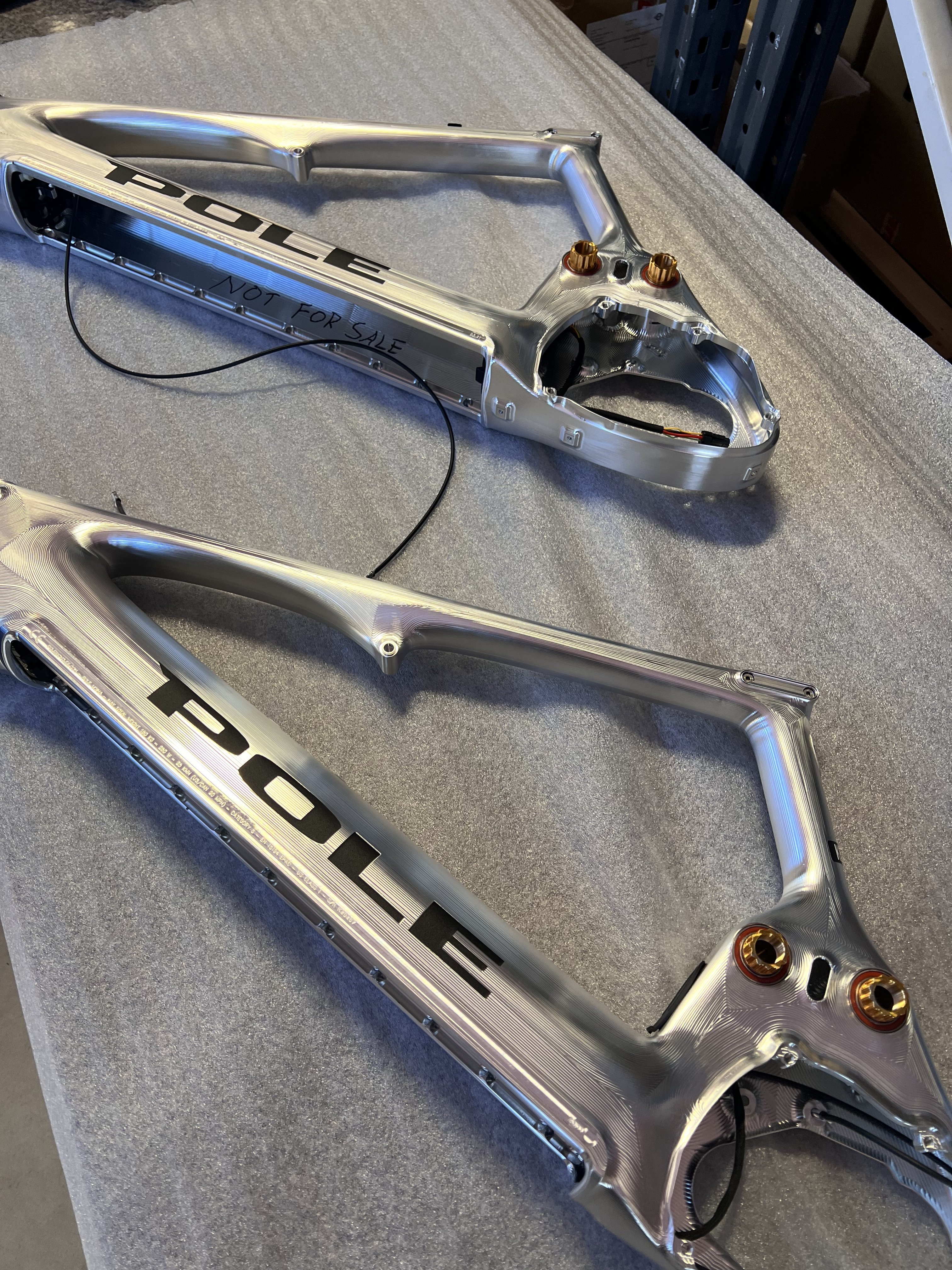

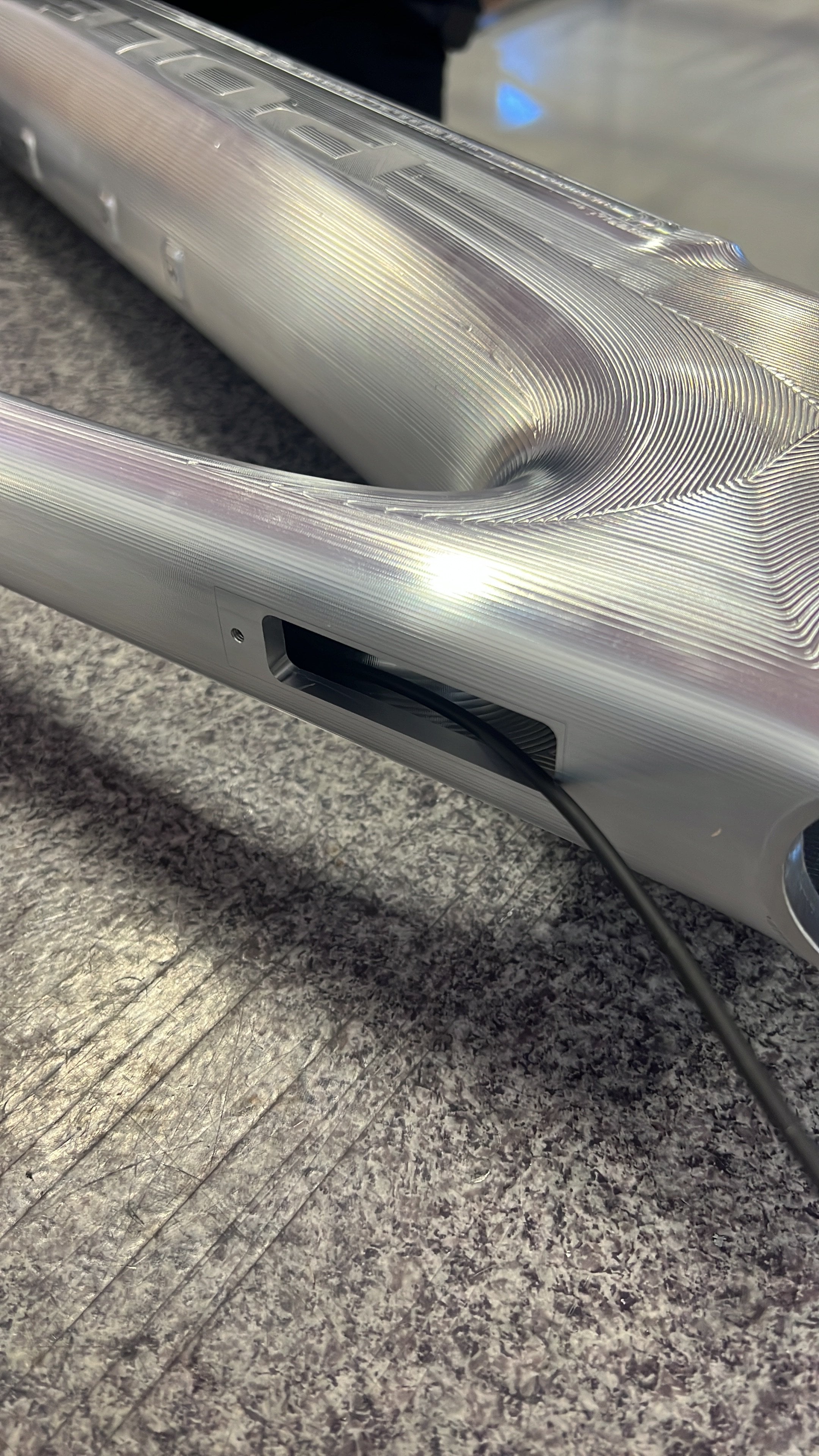

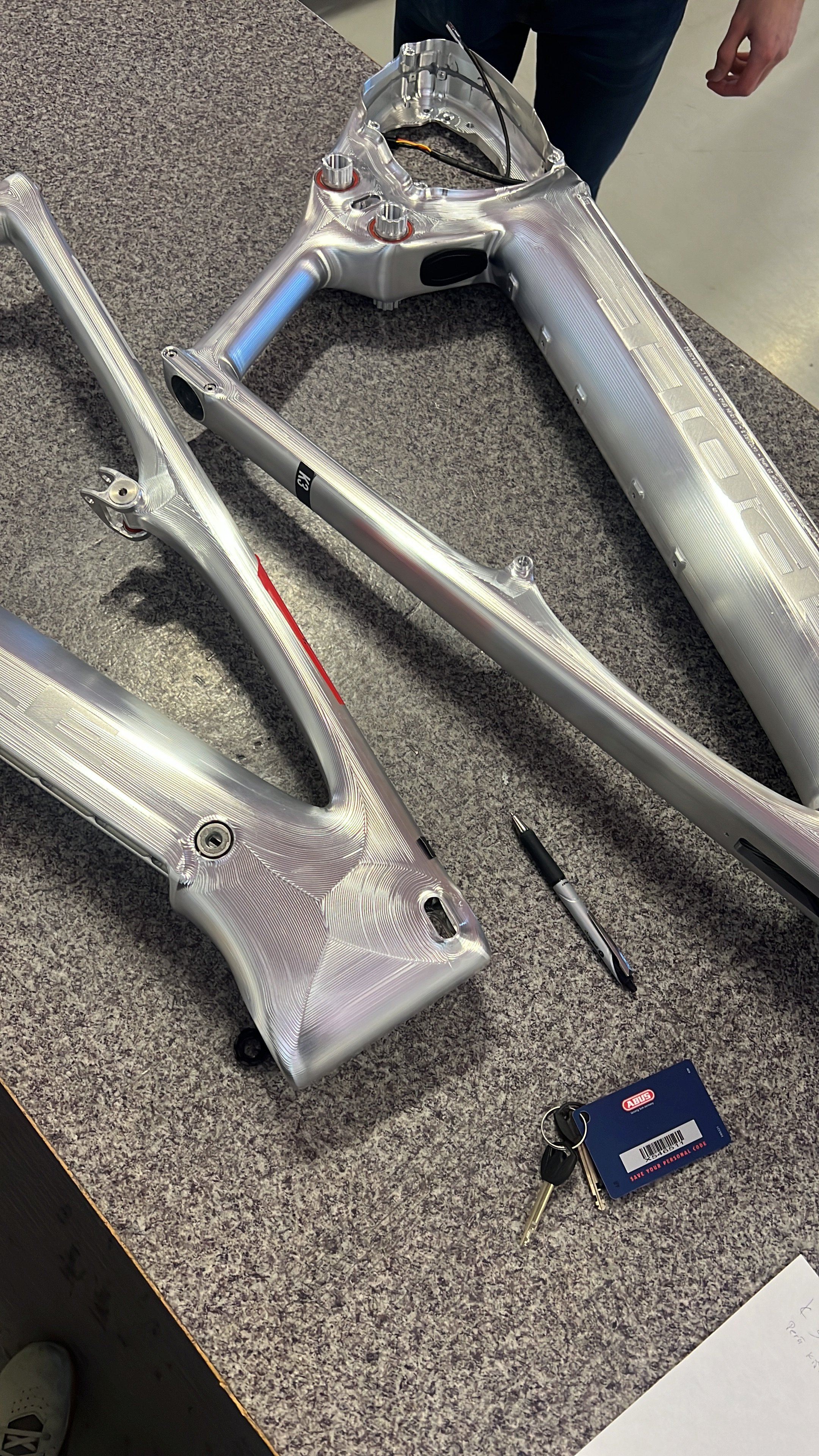

Got my Voima ID after my factory visit. The factory is amazing really, the work they and attention to detail is superb.
It really is such a unique manufacturing method to these bike. Leo can make any design changes as required and send to production immediately - the very same day a frame is produced with that change.
By the way, I got a K2 and am 190cm 😊
View attachment 110641 View attachment 110642 View attachment 110643
Absolute awesomeness, can't wait to get mine 🤘

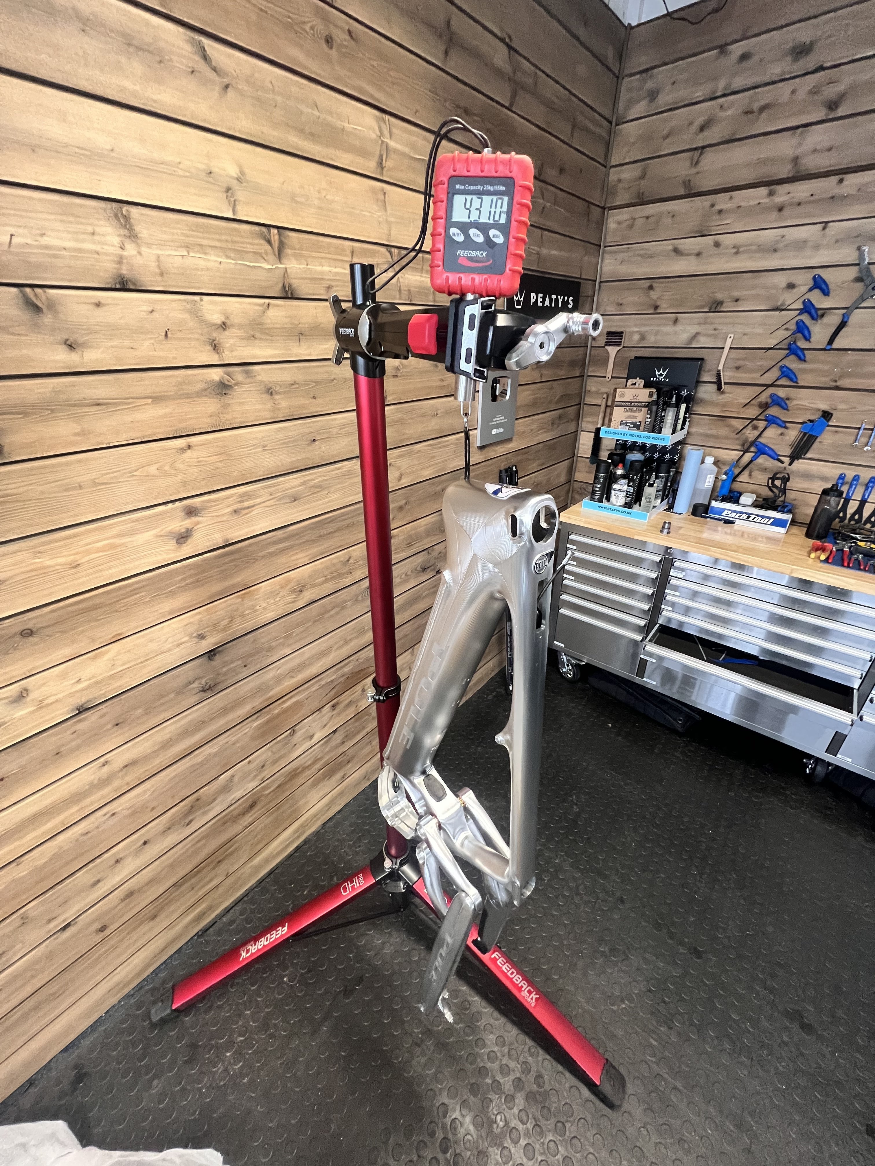

Voima ID Frame Weight, K2. With battery lock and mount. No shock linkage.
Weight: 4310g

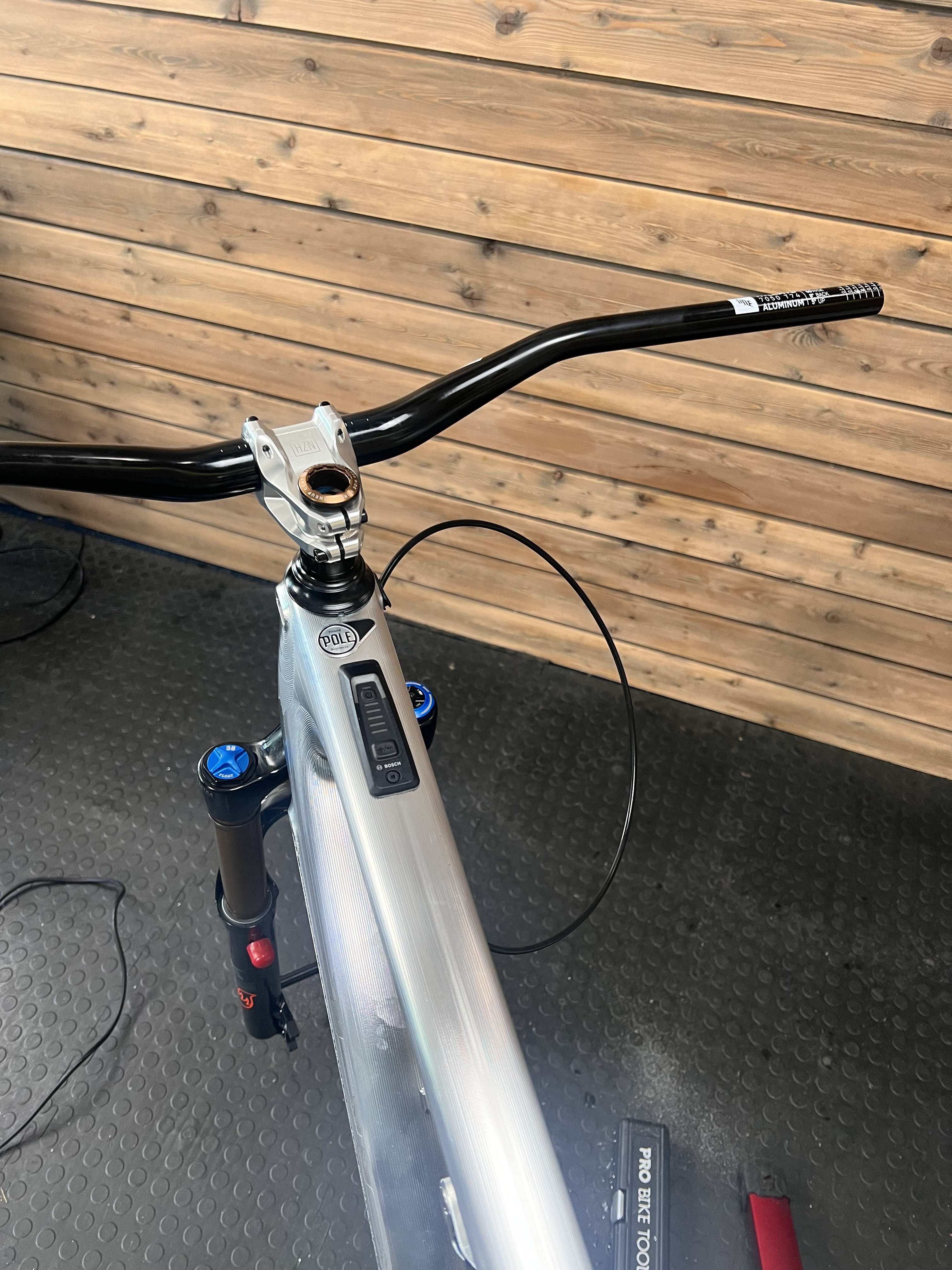

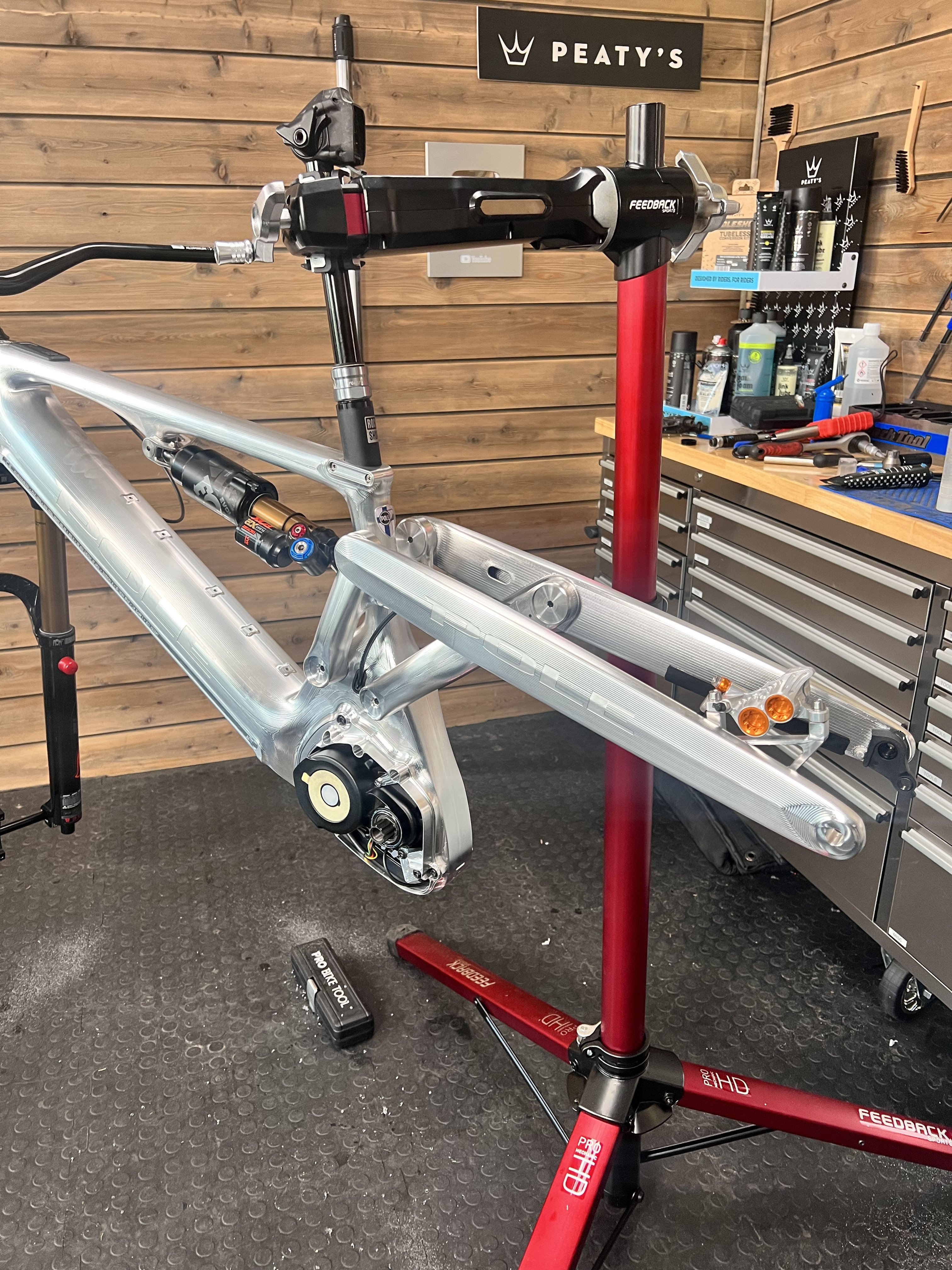

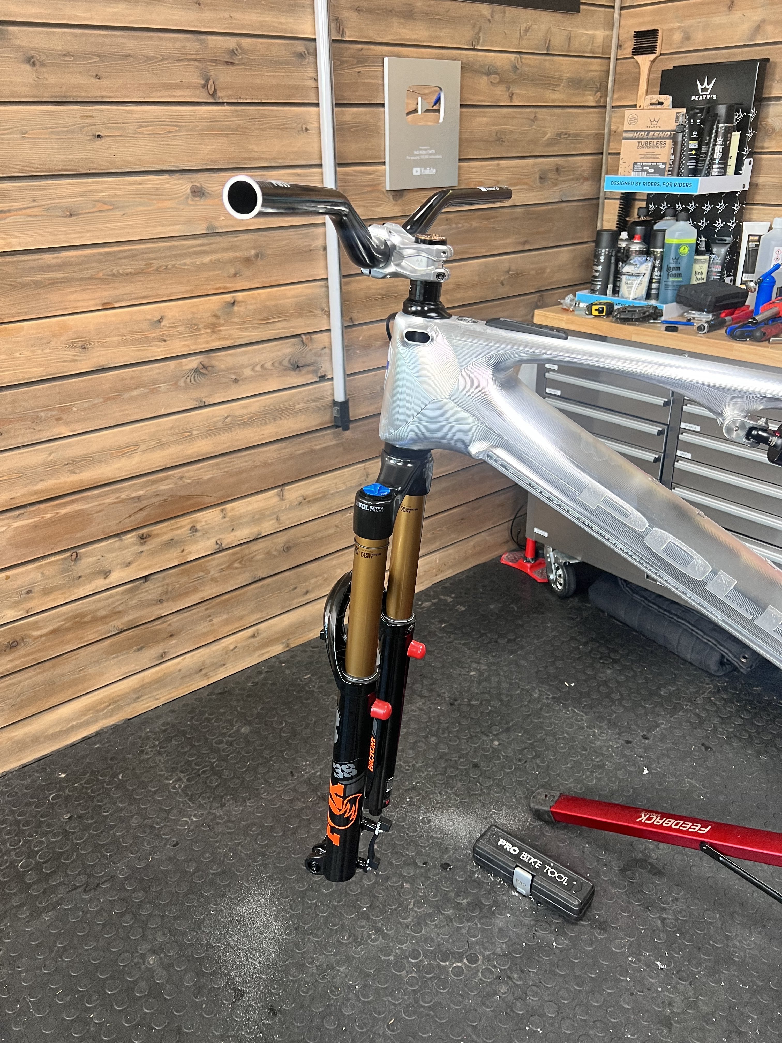

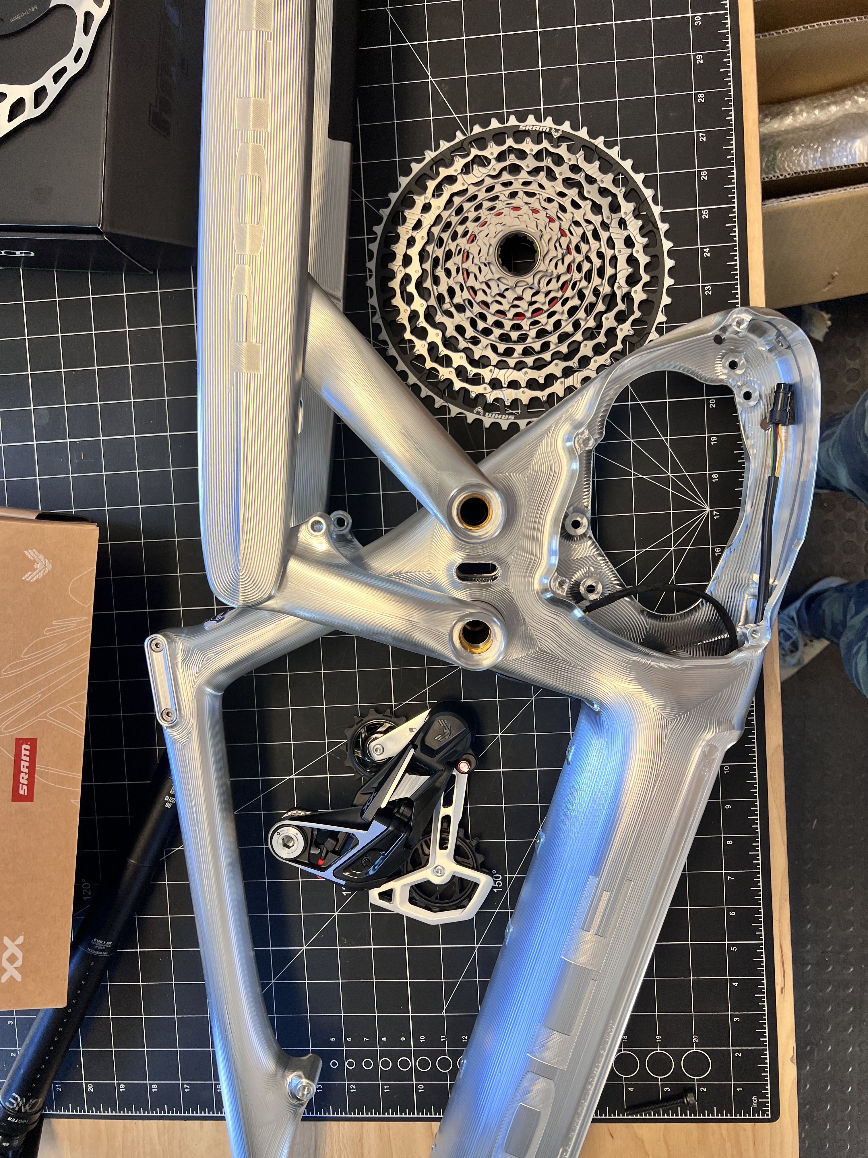

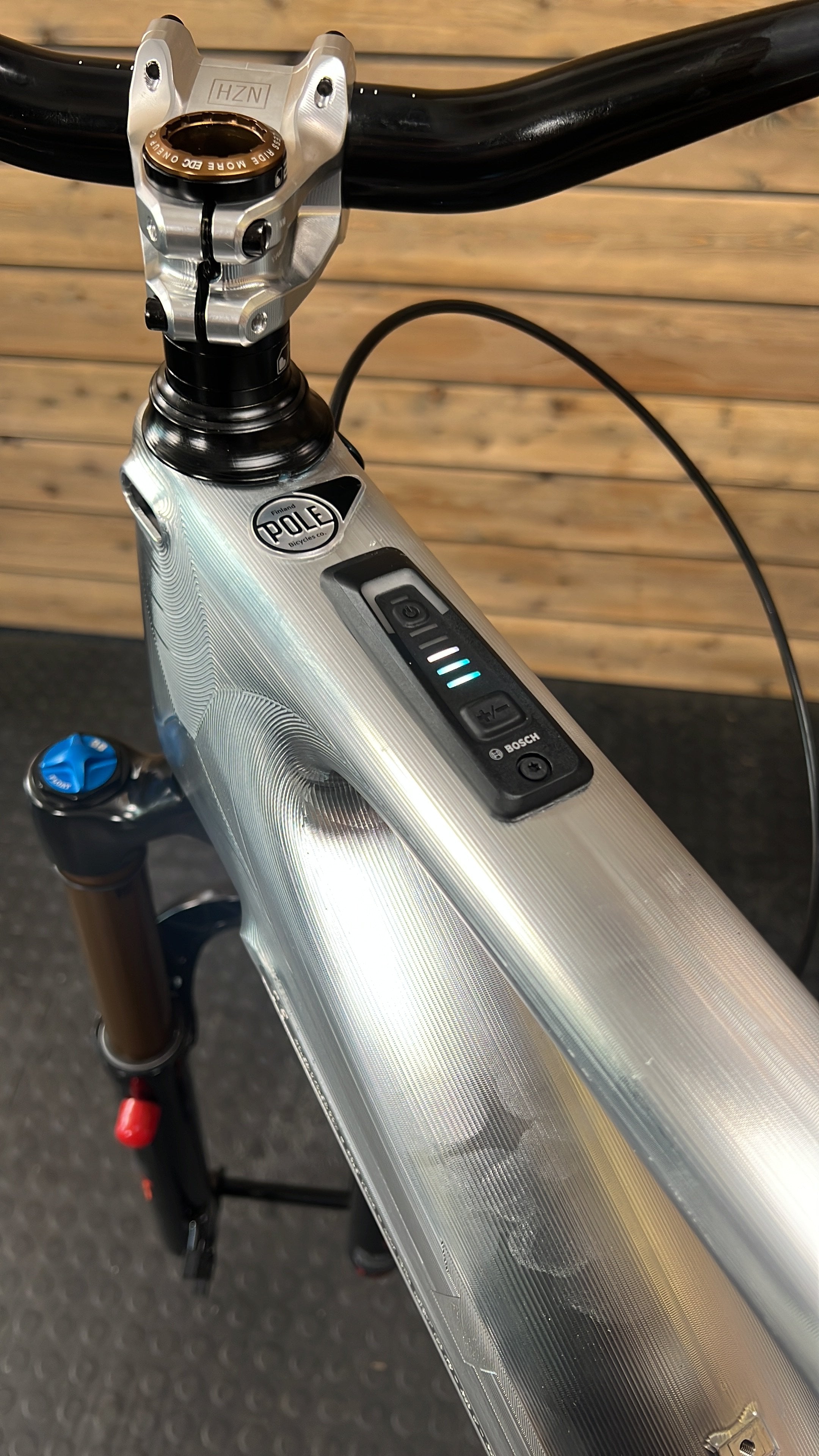

Getting there. With 180mm for 38 and X2. Also +5mm reach adjust, with external cup at the lower bearing brings +14mm to the front stack, so with 180 fork and reach adjust cup it’s almost bang on geo that the 190 Zeb would have (Zeb axle to crown is a bit more than Fox).
This bike is very easy to work on. Everything slots in super smooth. Tolerances on the frame are within 0.01mm so there’s nothing to adjust - no battery plates to adjust for size, battery just fits in perfect on the first attempt.
