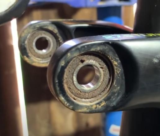

In most instances during disassembly and inspection, you will find the pivot bearings on your Rise will be fine. You will only need to clean and re-lubricate the exterior contact points where the bearing touches bolts, linkage arm and or the axle.
Occasionally, you will come across a pivot bearing that is frozen or stiff to spin. This may be because the bearing has flat spots, dirt has contaminated the bearing grease and or, water has worked past the bearing seal and rusted the steel bearing components. Stiff bearings will cause your Rise suspension to perform like an overinflated rear shock and your bike will track poorly on rough terrain.
If you encounter a frozen or hard to spin pivot bearing, you will need to determine why the bearing isn't functioning. To do this, remove the bearing's outer seal, fully clean the bearing, and inspect it for function. If after cleaning, the bearing spins freely without any bumpy or rough feeling, then all you will need to do is re-lubricate the bearing. If after cleaning the bearing does not spin easily, or exhibits a rough feeling, then the bearing will need to be replaced.

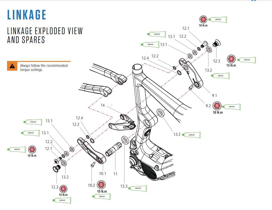

You have the option of removing the upper and lower linkage and allow the rear triangle to hang off the bike of the bike. Or, as I personally like to do, remove and replace the upper and lower pivot sections one at a time as separate procedures. Either way will work.

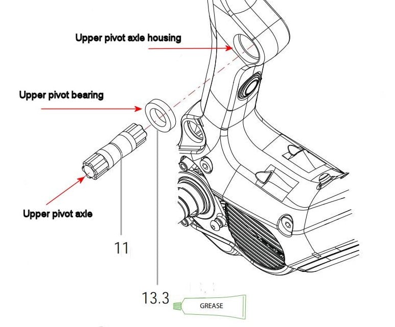

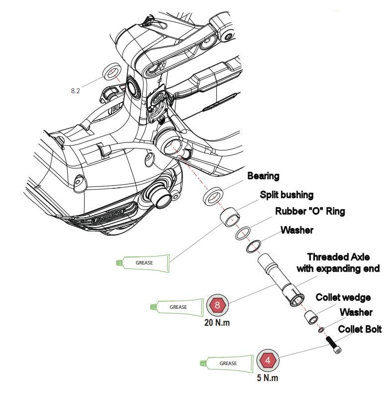

How the lower main pivot axle functions:

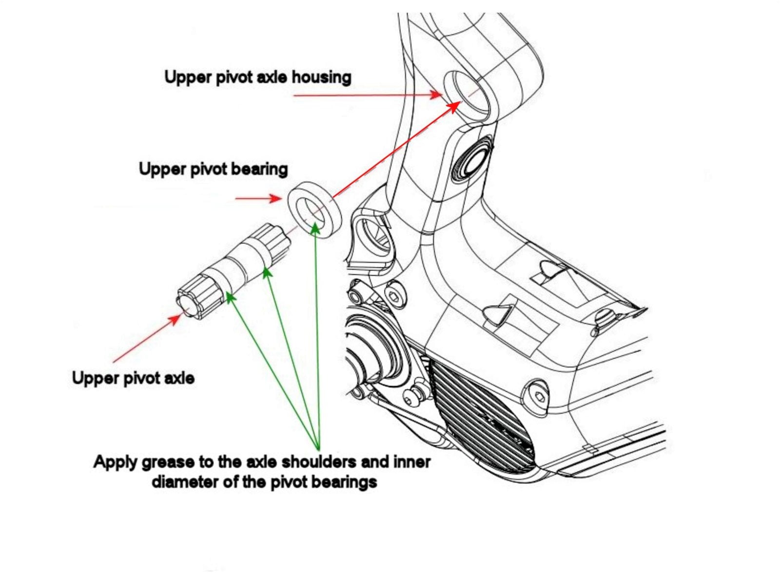

The Orbea Rise, Blue Paper diagram below details the lower pivot axle assembly and grease points. Also listed are the proper torque settings.
How it all works:

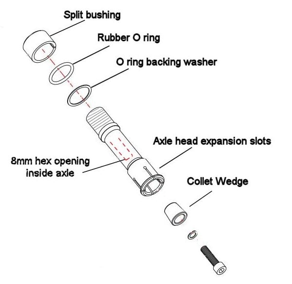

A split bronze bushing is inserted into the opening located on the left, "non-drive" chain stay. The lower pivot axle is threaded on one end and machined on the inside to accept an 8mm hex wrench. The axle is inserted through the bushing, the left chain stay, through the two frame pivot bearings and threaded into the right, drive side chain stay. A 8mm hex driver is used to tighten the axle to the correct torque setting.
The axle is prevented from backing out due to the split bushing and collet wedge. After the axle has been threaded into the chain stay, the collet wedge and collet wedge bolt are threaded into the end of the axle. As the collet wedge is tightened, it expands the head of the axle outward, which in turn expands the split bushing and locks the axle in place. Some mad engineering going on here.....

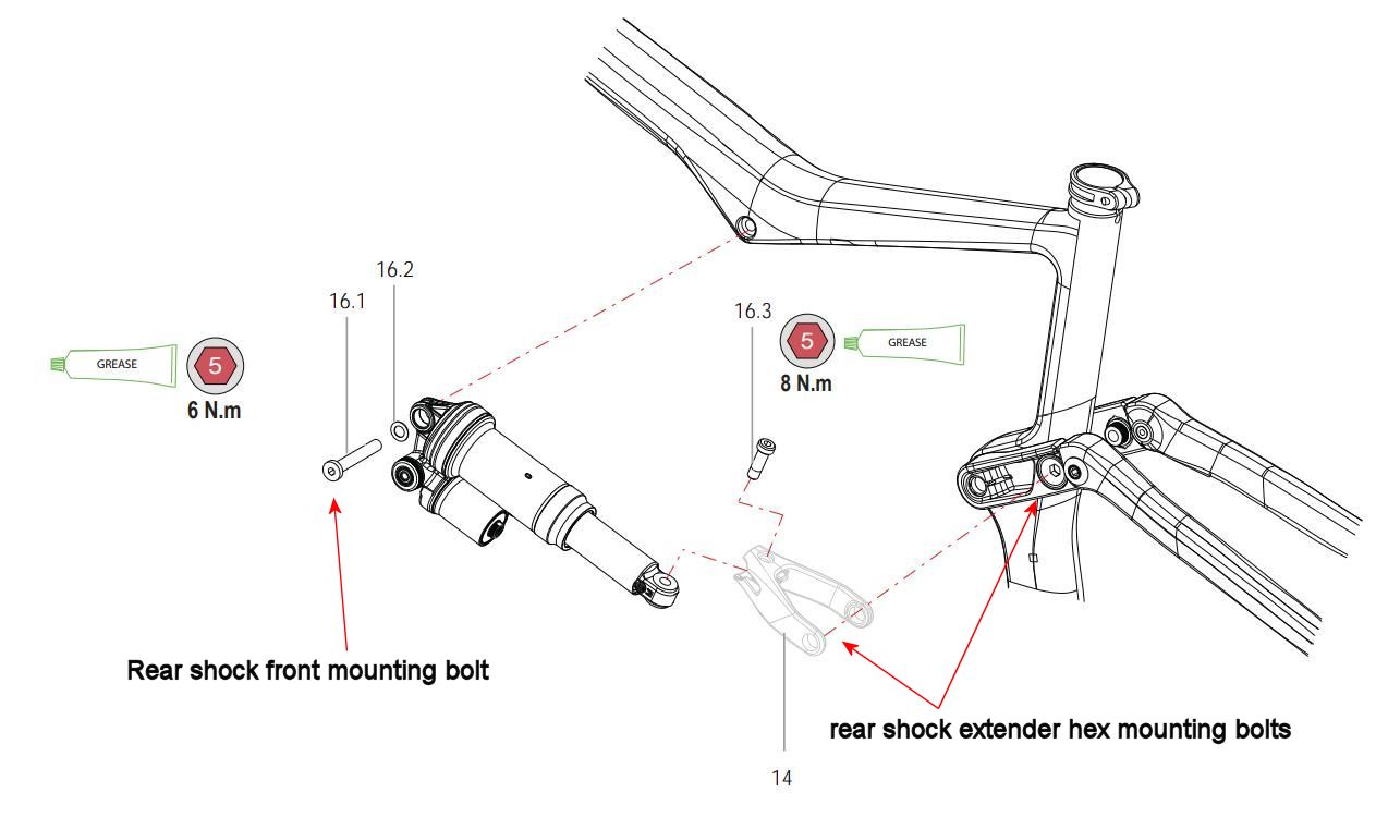

2. Wrap a rag around the front of the rear shock to cushion it. Remove the from shock mounting bolt. Lower the front of the shock until it rests on the downtube.

5. After removing the axle, you will see a split bushing located on the left (Non-Drive) side of the swing arm where the axle is inserted into the triangle. Remove the bushing.
6. With the axle removed, you can now lower or raise the rear triangle out of the way enough to inspect the lower pivot bearings. If the bearings spin easily and smoothly, you need only wipe the surface of the bearings to remove dirt and grime and place a small dab of grease on the inner part of the bearing where the axle will contact it.

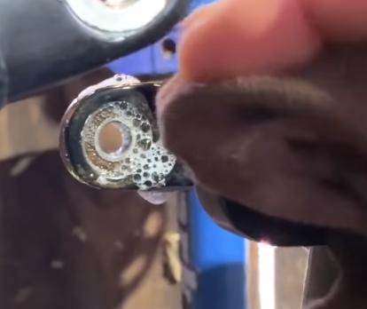

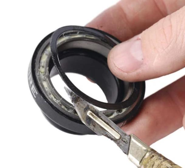

If the bearings are rough or hard to spin, remove the rubber seal and clean the bearings. If after cleaning the bearings they still spin roughly or are hard to spin, you should replace the bearing(s). If the bearings spin freely after cleaning, repack the bearings with grease and reinstall the rubber seal with the correct side facing the ball bearings. Wipe excess grease from the bearing and bike frame using a towel.
5. Clean the lower pivot axle, all hardware, the triangle where the axle is threaded and where the bushing is inserted.
Lower pivot assembly installation
1. Apply a small dab of grease to the inside of the lower pivot bearings races mounted in the frame.
2. Apply a light film grease to the inside of the split bushing. Insert the bushing into it's housing on the left side of the rear triangle.
3. Apply a small amount of grease to the the threaded end of the axle and the shoulders of the axle where the axle will ride on the frame pivot bearings.
4. Lift or lower the rear triangle into position so it lines up with the bearings. Fold the brake hose guide tube out of the way and Insert the lower pivot axle into the bushing and through the bearings. Thread the axle into the right, drive side rear triangle insert using an 8mm hex driver, torque the axle to 20 N.m.
5. Insert the black rubber routing hose back into the holes in the frame and reattach the speed sensor wire to the guide tube clamps. Pull the brake hose back out of the rear triangle and to it's original position at the rear caliper.

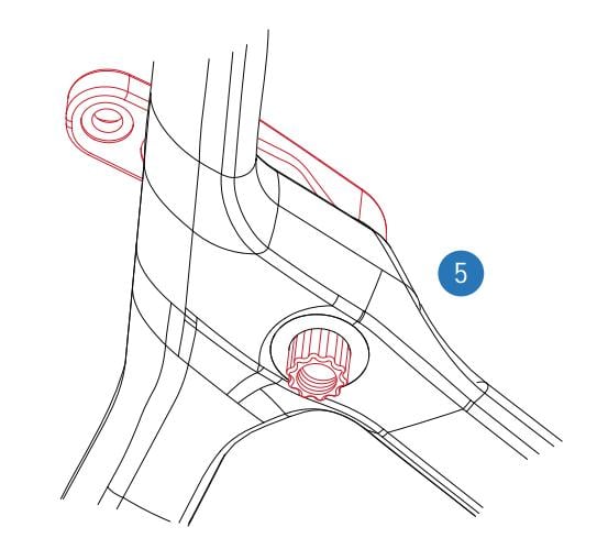

6. Insert the collet wedge into the axle. Apply a film of grease on the collet wedge bolt and thread into place. Tighten the collet bolt to 5 N.m. Orbea does not specify thread locker for the axle or collect wedge bolt.
7. Rotate the rear triangle up and down and insure it moves freely and smoothly and without any side to side play.
8. Cheers.....you've completed the lower pivot axle linkage.

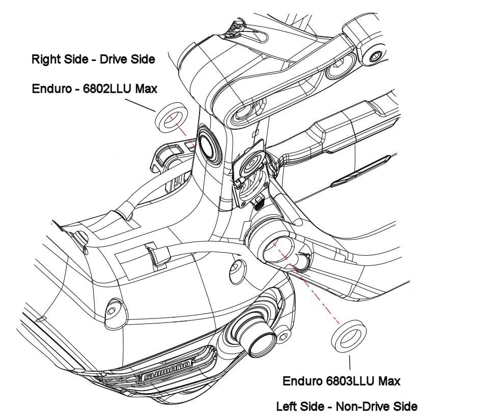

Rear Seat Stay Bearings:

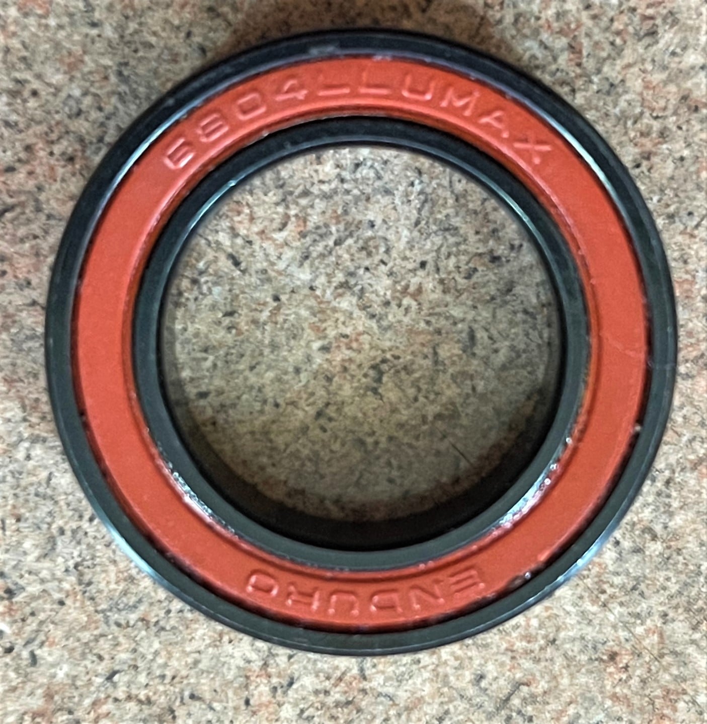

Two Enduro 6803LLU Max, black oxide pivot bearings are located at the end of the chain and seat stay triangle. The pivot bearings facilitate a slight pivot movement between the chain and seat stays at the rear triangle. They do not see a lot of movement, but are important in maintaining rear triangle stability.
They will occasionally need to be examined for play or lack of function, and lubricated.

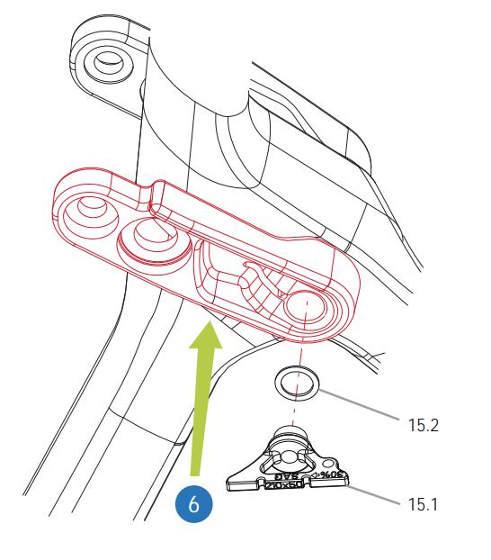

On that diagram above, the one that pictures the rear wheel dropout, does anyone have any tips for how to remove the retaining ring (number 3.3)that holds the non drive side bearing in place?
I've tried a fine screwdriver, pliers (too fat) etc, but I can't get it out.

The left, (non-drive side) drop out is held in place with a rubber "O"ring. It's a tight tolerance fit. The retaining clip you see in the parts diagram is used to hold the bearing in place on the swing arm.
To remove the left side drop out, remove your rear wheel. Partially thread your rear axle back into the threaded drop out. With a soft rubber mallet, smack the axle inwards. Hold the swingarm to keep it steady as you whack the axle. This will drive the drop out of it's mount on the swing arm.
The right, drive side derailleur drop out, is held in place by the plastic castellated knob which the rear axle tightens against. To remove the right side derailleur drop out, twist the castellated plastic knob counter clockwise to remove it and gain access to the bearing.

Squirt the retaining clip and the groove with some WD-40. Take a round punch and tap the bearing inwards several times to insure the bearing is fully seated and not hard up against the C clip. Use two really thin flat tip screwdrivers or a screw driver and a dental pick. Those small eyeglass screw drivers that come in a kit work well. Work the tip of a thin screwdriver under the tip/end of the C clip and begin to work it out of the groove enough to get the other screw driver behind the clip. Work your way around the clip like using tire levers to work a tire off a rim.
It took me a bit of fiddling to get the clip out of the groove. As a side note, my bearing was completely frozen and I had to replace it.

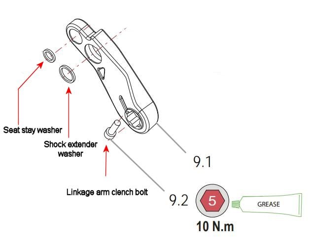

Another issue that will cause creaking is if the upper pivot linkage arms slip on the upper pivot axle and the pre-load opens up. A single pinch bolt is used hold each linkage arm onto the splined axle. You may experience a situation in which the upper linkage arms loosen or slip slightly on the upper axle and cause the pre-load, i.e. gap between the two linkage arms to grow wider. When this occurs, the axle can now shift side to side and will also cause a creaking noise. You can typically tell if this is occurring when you throw the bike into a corner and you feel the rear end sway or flex like you have a loose rear wheel. When you check the upper axle, there should be no axle visible between the frame and inside edge of the linkage arm. There should also be no side to side play.
If you are experiencing an issue with the linkage arms loosing their grip on the axle splines, then it's best to buy a bottle of Loctite 638 cylindrical retaining compound. Apply it to the upper axle splines and splined opening on the linkage arm. Set the correct preload using the purple Orbea pre-load tool. Make sure the pinch bolt has a dab of blue Loctite and tighten the pinch bolt to the correct torque setting. Refer to Part # 1: Upper Pivot Linkage Service for details.

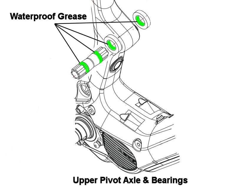

If you've ridden your Rise for awhile, you may notice it has started to make an irritating creaking noise while riding. The creaking noise will sound very similar to a creaking seat post or saddle. The sound will start out small, but over time will become progressively worse. You may also notice the smooth and plush suspension feeling the bike had when new is gone.
In most circumstances, there is nothing wrong with your rear shock, or the seat post or saddle rail clamps. The creaking noise you hear is typically caused by a pivot axle requiring lubrication. The stiff suspension may possibly be attributed to dirty pivot linkage and bearings requiring a cleaning and service. Note, I cover servicing the lower pivot axle assemble in a Part # 2 separate article.
Before you begin taking you bike linkage apart, consider buying a pivot bearing kit from Orbea. If during the inspection process you do encounter a bad bearing, you don't want to be caught short trying to source a new bearing and possibly lose ride time sourcing a bearing.
The Upper Pivot Axle on the Rise is made out of aluminum and rides upon two steel bearings mounted in the frame. The fit between the bearings and the axel is a close tolerance fit. The axle does not have a seal to keep dirt or water from working between the bearing and axle. Dry powdery conditions or exposure to water will wash lubrication from the axle area. If the axle runs dry of lubrication, creaking and wear on the axle's aluminum shoulders will occur. This ultimately leads to sloppy rear linkage and replacement of the splined axle.

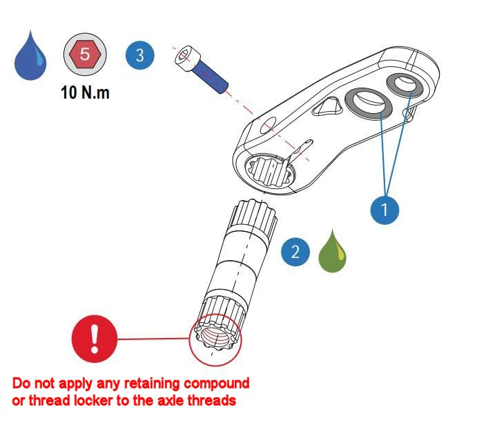

Play in the linkage arms can also cause creaking. Each linkage arm is held in place with a single pinch bolt. The arms may slip on the splined axle. When this occurs, the linkage arms will open up and play will develop. The axle can now slide side to side and may cause a creaking noise as it shifts across the bearings. If you will feel the rear end sway or flex sideways like you have a loose rear wheel during cornering, a loose linkage arm may be the culprit. You can tell if this has happened with a visual inspection. When you check the upper axle, there should be no axle visible between the frame and inside of the linkage arm. There should also be no side to side lateral play in the axle assembly. If you are experiencing an issue with the linkage arms slipping on the axle splines, then it's best to buy a bottle of Loctite 638 cylindrical retaining compound. Loctite 638 works similar to Loctite thread locker. It helps the splined axle mate securely to the linkage arms and creates a firm attachment. It's made so that components can be disassembled at a later date.

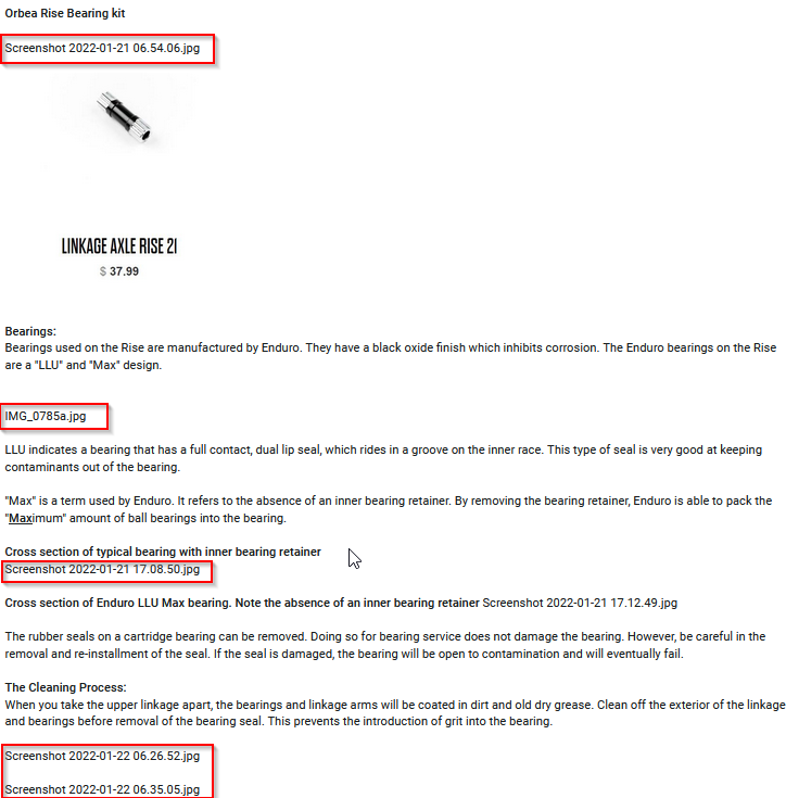

Bearings:

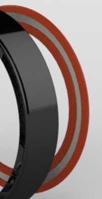

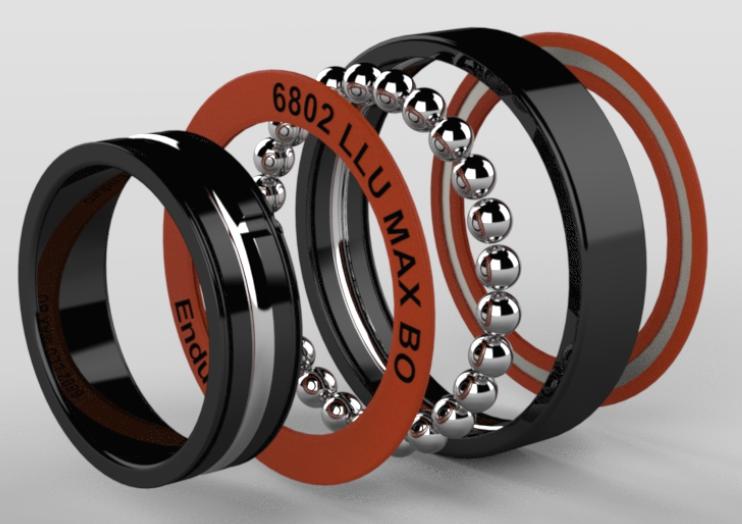

Bearings used on the Rise are manufactured by Enduro. They have a black oxide finish which inhibits corrosion. The Enduro bearings on the Rise are a "LLU" and "Max" design.
LLU indicates a bearing that has a full contact, dual lip seal, which rides in a groove on the inner race. This type of seal is very good at keeping contaminants out of the bearing.
"Max" is a term used by Enduro. It refers to the absence of an inner bearing retainer. By removing the bearing retainer, Enduro is able to pack the "Maximum" amount of ball bearings into the bearing.

Cross section of Enduro LLU Max bearing. Note there isn't a retainer
The Cleaning Process:
Because the pivot bearings are mounted in the frame and linkage arm, you will only have access to one side of the bearing. I like to use a spray cleaning product such as a chain cleaner to forcibly help clean and dissolve the old grease from the bearing. I've found Maxima chain cleaner works well when cleaning bearings. The product works quickly at dissolving old bearing grease. It's safe to use on rubber, metal and carbon fiber components. If you don't have access to a spray detergent cleaner, WD40 also works well at dissolving grease.
Seal Removal:
After you have cleaned the exterior of the bearing, linkage arm and frame. You will need to remove the bearing's outer rubber seal. I use a hobby knife like what's pictured below. Any razor or thin blade will work, just remember you want to be careful and not cut or bend the seal during the removal process. To remove the seal, insert the tip of the razor slightly between the outer bearing race and the edge of the seal. Gently pry up. You may have to free up the seal in several places to get it to pop up.
The rubber seal on cartridge bearings has an inner and outer side. The inner side of the seal which faces the ball bearings will have an exposed metal grove to accommodate the bearings. The picture below depicts the inner side of a bearing seal with the groove.
Bearing Inspection:
Pivot bearings typically only rotates a few degrees. Because of this lack of rotation, only a few of the ball bearings will consistently take the brunt of force. Those few ball bearings will eventually develop flat spots which hinders smooth rotating suspension.
After you have fully cleaned the bearing, rotate it with your fingers. Feel for a bumpy rough feeling. If after cleaning the bearing is hard to rotate or exhibits a rough feeling, the bearing will need replacement.
Note: You may get a rough or bumpy feeling if the grease is dry or grit has gotten into the bearing and contaminated the grease. Therefore, it's very important to fully clean the bearing before checking for bearing flat spots or ease of movement. You want the bearing to rotate smoothly and easily.

Orbea Rise diagram showing the upper axle pivot linkage, areas requiring grease, and hardware torque settings

Upper Axle and Linkage Removal & Installation:
Personally, when I do a full service cleaning and lubrication of the pivot linkage, I like to do the upper pivot linkage separately from the lower main pivot axle. You can remove the upper and lower pivot assembly all at once, however you'll have to contend with a loose chain stay flopping about. Lastly, if I am just greasing the upper axle, I do a shortcut disassembly by leaving the shock in place and I just remove the upper linkage arms and axle for greasing. Below, I am providing below a full blown and in depth disassembly of the linkage. I leave it up to you to decide which method or shortcut in the procedure you wish to do.
1) Place your Rise in a bike stand. Remove the rear axle and wheel to unweight the rear triangle.
2) Wrap a rag around the front portion of the rear shock. Using a hex wrench/driver, remove the front shock mounting bolt. The rag will prevent the shock from dropping down and damaging the paint on the downtube.

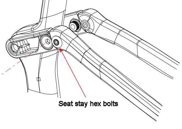

3) Remove the right/left seat stay hex bolts where they attach to the linkage arms.

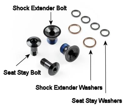

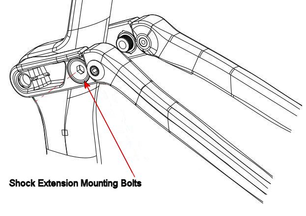

4) Remove the right/left rear shock extender hex bolts where they attach to the linkage arms.
5) Remove the right and left pinch (Clench) bolts located on the bottom side of the linkage arms.
6) Six spacer washers are used in the upper suspension linkage. Two large spacer washers are used for the shock extender. They mount on the inner side of the linkage arm. Four smaller spacer washers are used for the seat stay. They mount on the inner and outer sides of the linkage arms. They may fall out, don't lose them.
6) After both pinch bolts have been removed, pull the seat stay arms away from the linkage and remove each linkage arm from the upper axle. The arms easily come off. Sometimes rocking the arms or a gentle tapping with a soft rubber mallet helps.
7) With the linkage arms removed, the upper axle will be exposed in the frame. Rotate the axle to see if it is binding or hard to remove. This will give you a general idea of what condition your upper pivot frame bearings are in.
8) The upper axle is threaded on one side to accept an Orbea pre-load tool. The Orbea Rise "Blue Paper" states the threaded side of the axle faces the right "Drive side" of the bike. Your bike may come with the axle threads facing to the left side. During re-assembly install the threaded axle facing to the right, drive side.
9) With a rubber mallet, softly tap the upper axle out of the frame bearing assembly. The axle has a tight fit and will not easily slide out of the bearings. Some tapping with a soft rubber mallet and a wood dowel may be required to fully release the axle. Be very careful not to deform the aluminum axle.

1) With the upper linkage hardware and bearings cleaned and lubricated, you can begin the upper re-assembly.
2) Apply a liberal amount of grease around the inside race of the two axle bearings mounted in the frame. Apply Loctite 638 or similar to the splines on the left non-threaded side of the axle and also inside the splined interface on the left linkage arm. I use my finger to spread the retaining compound around to insure full coverage.
NOTE: The Orbea Rise Blue Paper requests that a cylindrical retaining compound be used on the axle splines. The blue paper does not specify which retainer compound to use. The Orbea Rallon shares a similar linkage design. The Orbea Rallon Blue Paper recommends Loctite 638 as the "cylindrical retaining compound" to be placed upon the upper pivot axle splines.
3) Hold the left (Non-drive side) linkage arm in your hand and insert the axle into the left linkage arm. Apply blue thread locker onto a linkage arm pinch bolt and thread it into the arm. Insure the axle is fully seated into the linkage arm interface and torque the pinch bolt to 10 N.m. Wipe off any excess Loctite 638 that may drip out.
4) Apply a film of grease to the shoulders of the axel. While holding onto the left linkage arm, insert the axle into the two frame mounted pivot bearings. The axle will slide in easily through the first bearing. You will meet resistance when the axle meets the bearing on the opposite side. Move the axle about to align it squarely with the bearing race on the opposite side. Using a soft rubber mallet, lightly tap the linkage arm and axle into place. No pounding or forcing. Check that the left linkage arm is fully seated against the pivot bearing.
5) Your Rise should have come with a purple colored Orbea pre-load tool. The tool is used to set upper linkage arm pre-load and also to measure rear shock sag. Insure that the rubber pre-load spacer is threaded onto the pre-load tool.
7) Apply Loctite 638 to the axle splines on the right side of the axle. Do not apply any thread locker or retaining compound to the axle threads. Insure the threads are clean. Install the right side linkage arm onto the axel. Insure that the linkage arm is fully seated on the splined axle.
8) Thread the purple pre-load tool into the axle. As you thread, insure the rubber spacer is seated correctly and not cocked to where it can become pinched. If it is not centered correctly, it will become damaged during the tightening of the pre-load tool and a false pre-load will occur. Turn the pre-load tool until it stops. Do not overly tighten the purple pre-load tool as it will damage the rubber preload spacer. Check that no axle is visible between the inside of the linkage arm and the frame. Insure that the axle assembly rotates freely. If everything checks okay, apply a small dab of blue thread lock to a linkage arm pinch bolt. Insert it into the arm and torque the pinch bolt to 10 N.m. Remove the purple pre-load tool.
9) Apply a film of grease onto the seat stay mounting bolt shoulders. Avoid getting grease on the threads. Take two of the small seat stay washers and apply a dab of grease to them. Place the washers on the inner and outer sides of the linkage arm, centered over the seat stay bearings. The grease will keep the washers in place. Line up the seat stay with the bearing opening. Insert the seat stay bolt and torque to 10 N.m. Orbea does not specify thread locker for the seat stay bolt however I place a dab of blue thread locker on the threads.
10) Apply a film of grease to the shock extender mounting bolt shoulders. Avoid getting grease on the threaded portion of the bolt. Apply a small dab of blue thread locker to the threaded portion of each bolt. Take the two large shock extension washers and apply a small dab of grease to each one. This will hold them in place as you work. Position the washers on the inner side of each linkage arm and centered over the shock extender bearings.
Take the shock and slide the extension fork into position between the two linkage arms. Make sure the shock extension washers are sandwiched between the extension fork and the linkage arms. Maneuver the shock extension, washers and linkage arm into alignment so that the mounting bolts can be inserted and threaded into place. Torque both bolts to 15 N.m.
11) Apply a film of grease to the front shock mounting bolt. Apply a film of grease to the inside of the shock bushing and bushing face. Slide the shock up into position and thread the shock bolt into place. Orbea does not specify thread lock on the bolt. Torque the bolt to 6 N.m.
