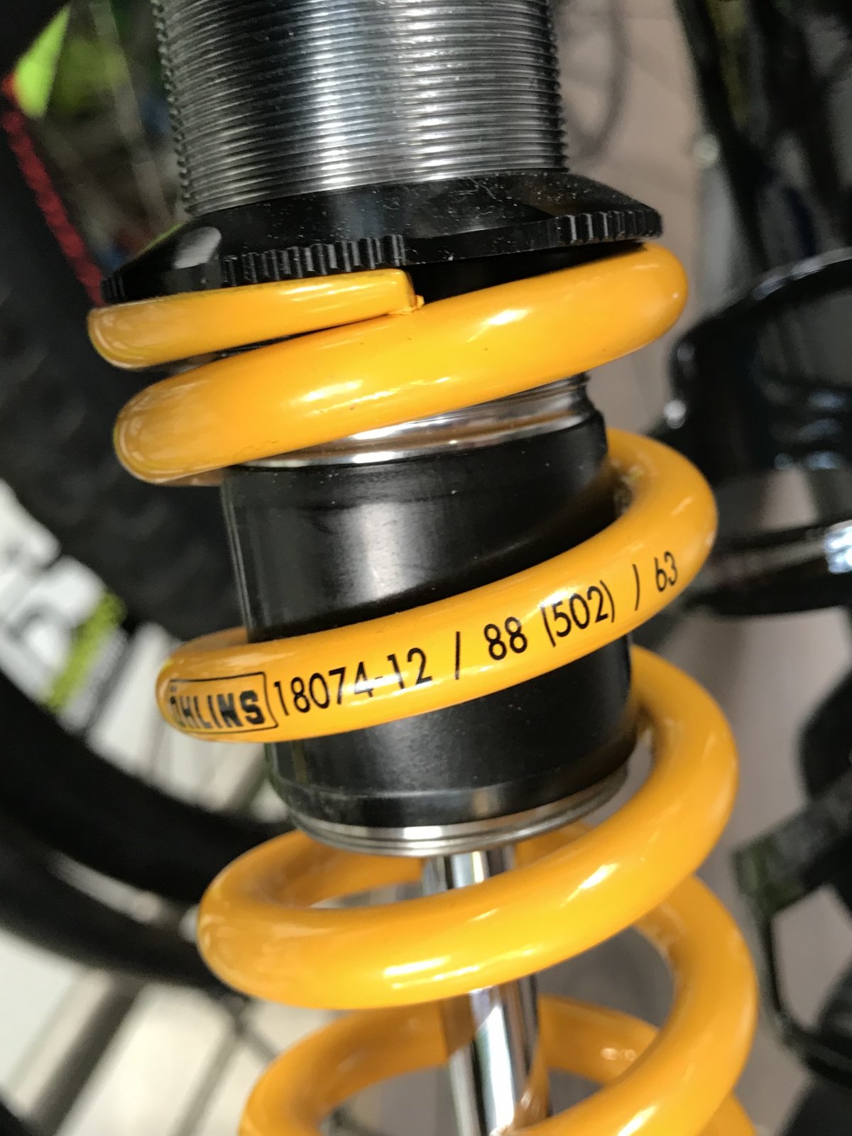

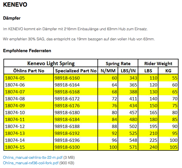

Regarding the coil-spring - I'm 100kg so I want/need a stronger one. I took a photo of the spring in the Kenevo size L which has 502 lbs:
Interesting was, that the Kenevo in size M has a coil spring of 457 and the size XL has a spring with 548 lbs (hope I remember correctly).
Here's the table with recommended rider-weight and part numbers.
Rider-weight is rider + gear + backpack, so "ride-ready" weight.
In that case, the 571 lbs spring is the choice for me:

In the german specialized question & answer section they say that these numbers are just recommendations to start with. If someone wants to have it softer or harder or is going for big jumps or more comfort, don't hesitate to go up or down with the spring rate so it fits your needs.
It's the same as with the recommended 30% sag - you will be absolutely fine with 20% as well if you want to ride it a bit harder.

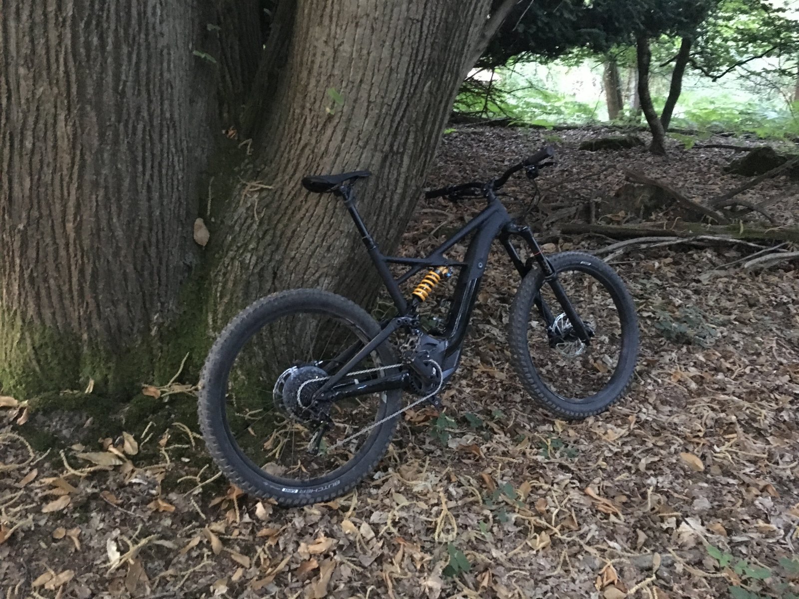

Picked up my Kenevo yesterday, haven’t stopped grinning since.
All ‘concerns’ about 180mm being too much for the majority of my general goofing around riding, it not going uphill as ‘fast’ as the Levo, the additional 2kg weight, have been completely smashed away by the bike.
It does as little assistance (want a workout) or as much as you want, it’s completely and seamlessly flexible.
Forum posts about the seat post nearly put me off, the reality is the bike is so comfortable and adjustable effort wise you can ride it with the seat post anywhere and at any stage of it’s tilt travel.
Never ridden a coil on an MTB before, hopefully never have to go back to an air shock!!
Only issue (should be an easy fix) fork appears to have blown all its oil out of the mission control cap?
Luv it, its the way forward!!
