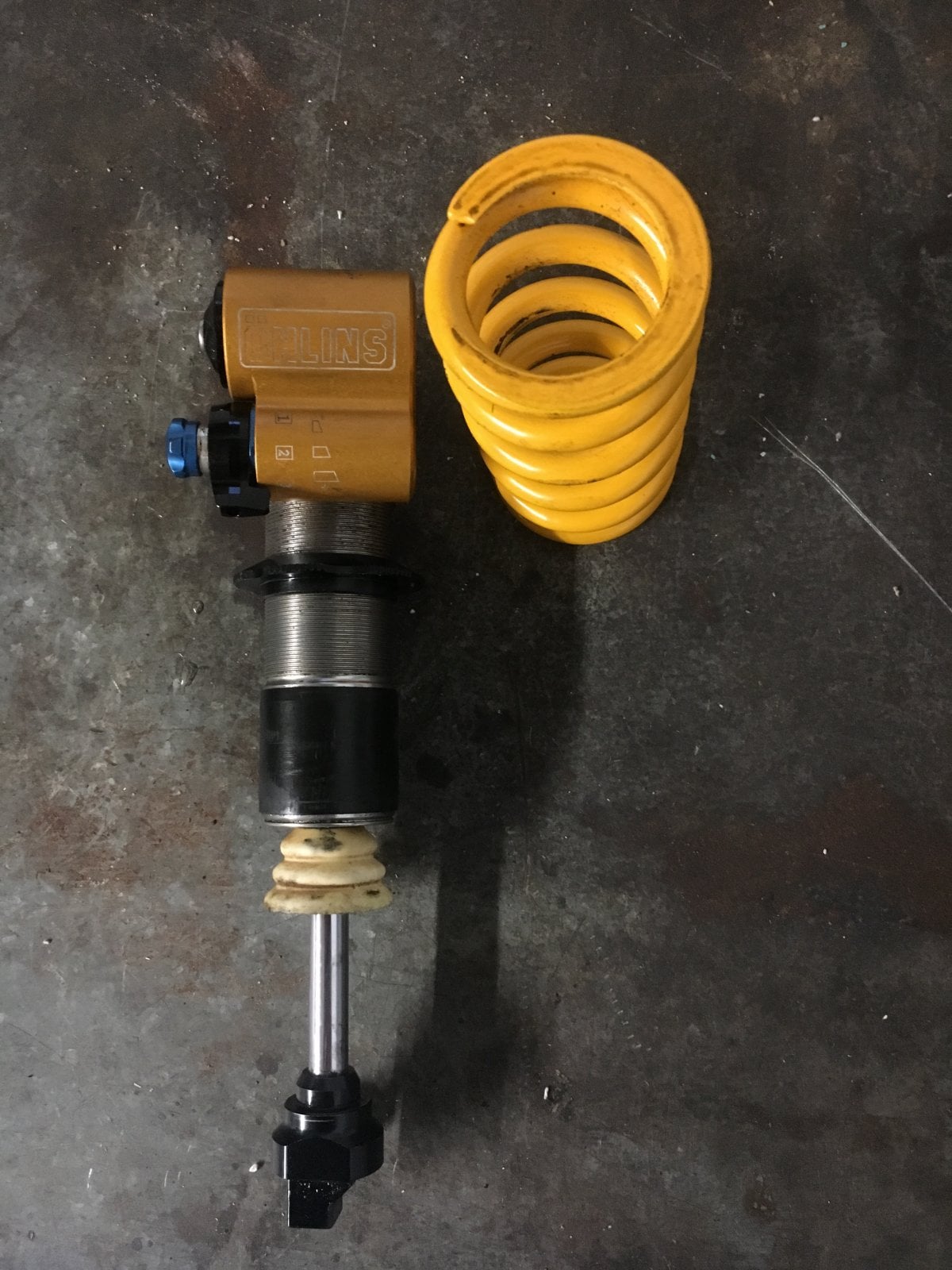

All stripped down. Ready for new shock

Evening all, just a quick update after fitting the new uprated coil spring.
I can safely say it’s transformed the handling in every sense but seeming I was nearly 3 stone over recommended weight ? I can see why.
First off, my 457lbs coil would achieve 28% sag when spring wound right up.
Can now achieve 28% sag within 2 turns ?
Feels way more responsive.
Bike feels even more planted when hitting jumps and dh sections.
Never thought it would make this much difference to the way it rode and handled.
Well worth the £20 I told the wife i paid for it ?

Hi Villho, on the 457 lbs spring, it was wound pretty much to the end of adjustment to achieve that sag.
On the 525 lbs spring, I wound the the adjuster down so I had slight tension on spring and then two complete turns achieving 28% sag.
That 457 lbs spring is designed for 11stone 2 rider.
Pretty much 3 stone over recommended weight.
525 lbs spring is made for bang on my weight.
Now I’ve changed the spring for my weight, I’d definitely recommend getting correct spring for weight of rider.

Did not realise you had the preload wound in past the 1 to 2 turns I suggested in post 71. I thought when you said you fully wound it in you meant 1 to 2 turns. No wonder the new spring has transformed the way your bike feels and rides.

No wonder the bike felt horrible earlier, if the preload adjuster was wound all the way. Ideal situation is to have it so that there’s basically no preload (in practice there needs to be 0,5-1 turns to lock the spring).
- If there is not enough sag with ”zero” preload -> a lighter spring is needed.
- And then again, if 1-2 turns of preload still gives too much sag -> a heavier spring is needed.

I spoke to a specialist who supplied the ohlins springs.
I had the 457 lbs spring on my medium Kenevo and the sag was well off.
They suggested the 525 lbs spring which stated on the chart.
Fitted 525 lbs spring and could get correct sag within 2 complete turns of adjuster on coil which it’s stated on ohlins sit.
Yes this chart is for a enduro but the spring rate will be the same for the rider as long as the ohlins has the 2.5 “ stroke.
Double checked with supplier before ordering.
My Kenevo now sits perfectly. ?
