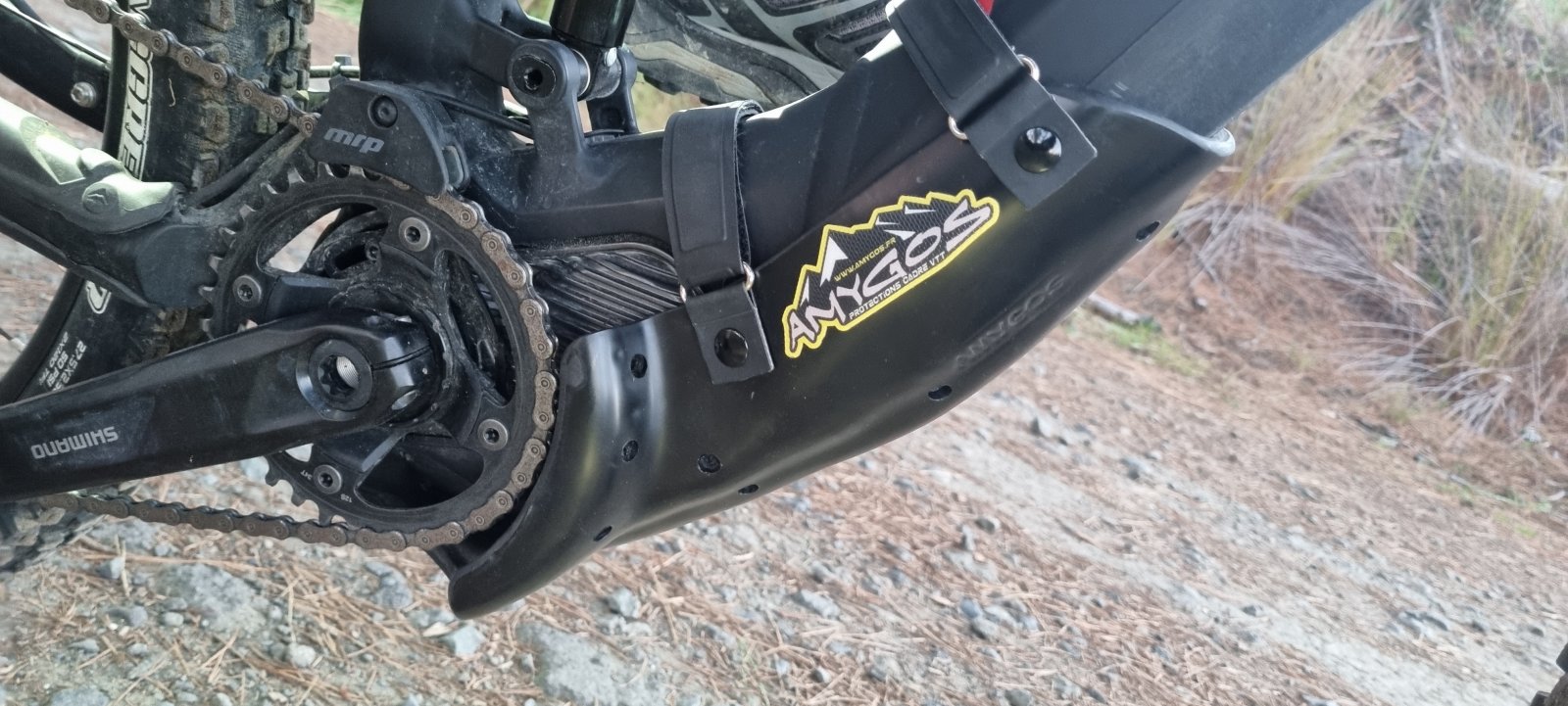

I added an amygos bash guard the other day. It fits really well and should do the job nicely. Clearance between the crank arm however is minimal, so may need some slight adjustment in future.
I'll add some frame tape to prevent the straps marking the frame over time too. Unfortunately the lower strap runs directly over the charge port, so it needs to be undone each time to charge ?
