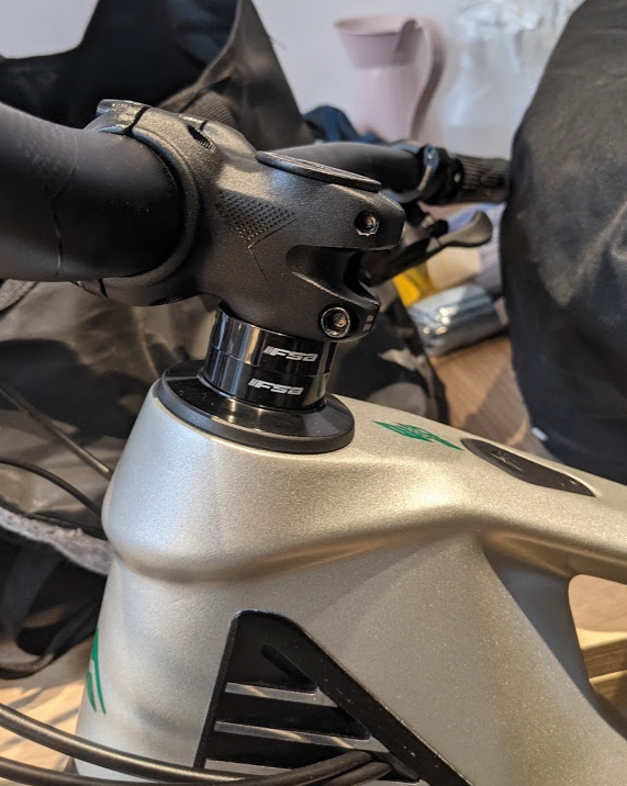

Hey guys, i have just purchased a e160 5000, its the carbon frame but with low spec components, one of the cost saving measures was the motor display/switch/power button.
I'm going to upgrade these back to the SC-EM800 and accompanying switch and power buttons but was hoping to be able to do the internal cable management to. Does anyone know what the parts are for trying to do this?
The bar is not a problem, just how they have gotten the motor display cable around the headset, Would it be as simple as trying to find the headset cover in the picture below, or is more going on here?

Quick question to 2021 carbon eOne-Sixty owners:
How many spacers on the head tube did your bike came with?
I'm looking at random images. Some seem to have 3x5mm, and some just one 1x2mm ). Most of my own bikes ( including road Merida ) came with at least 30mm of spacers.
It's critical for me as I'm going to use it with MacRide Child seat, that requires 10mm of space under the stem. And my dealer can't check that before I pay because of the ordering process ( Pay first, open the box after )

Here is my e160 5000 i got last week

Completely different to my 9000, which has cable integration in the headset for the light etc. If the bike has the same headset (ie: the Lazeene light as standard) as mine then a completely new headset would be required to fit a child seat mount.
Gordon
Thank you! Is that because of not enough spacers or different spacer shape? The 8000 I'm shooting for comes with the light and shaped spacers, but the cables still seem to go into the frame Under the spacers, and the head tube is still round, so I guess I can replace a shaped spacer with the round one for the MacRide.
Or to the cables go thru the spacers too? I would really appreciate a close up picture of the 9000's headset spacers and cables.
