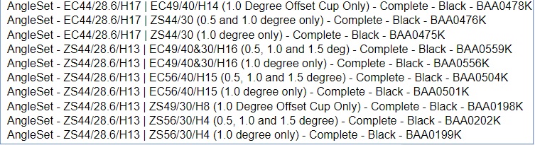

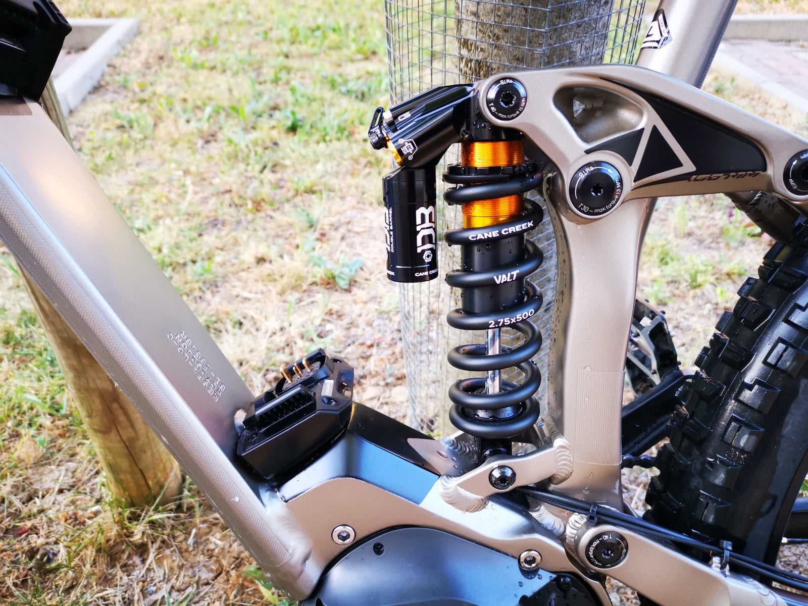

Hi! a question, i want to add a cane creek angle set to open a bit the steer angleset, can someone suggest me the right one? see attached file

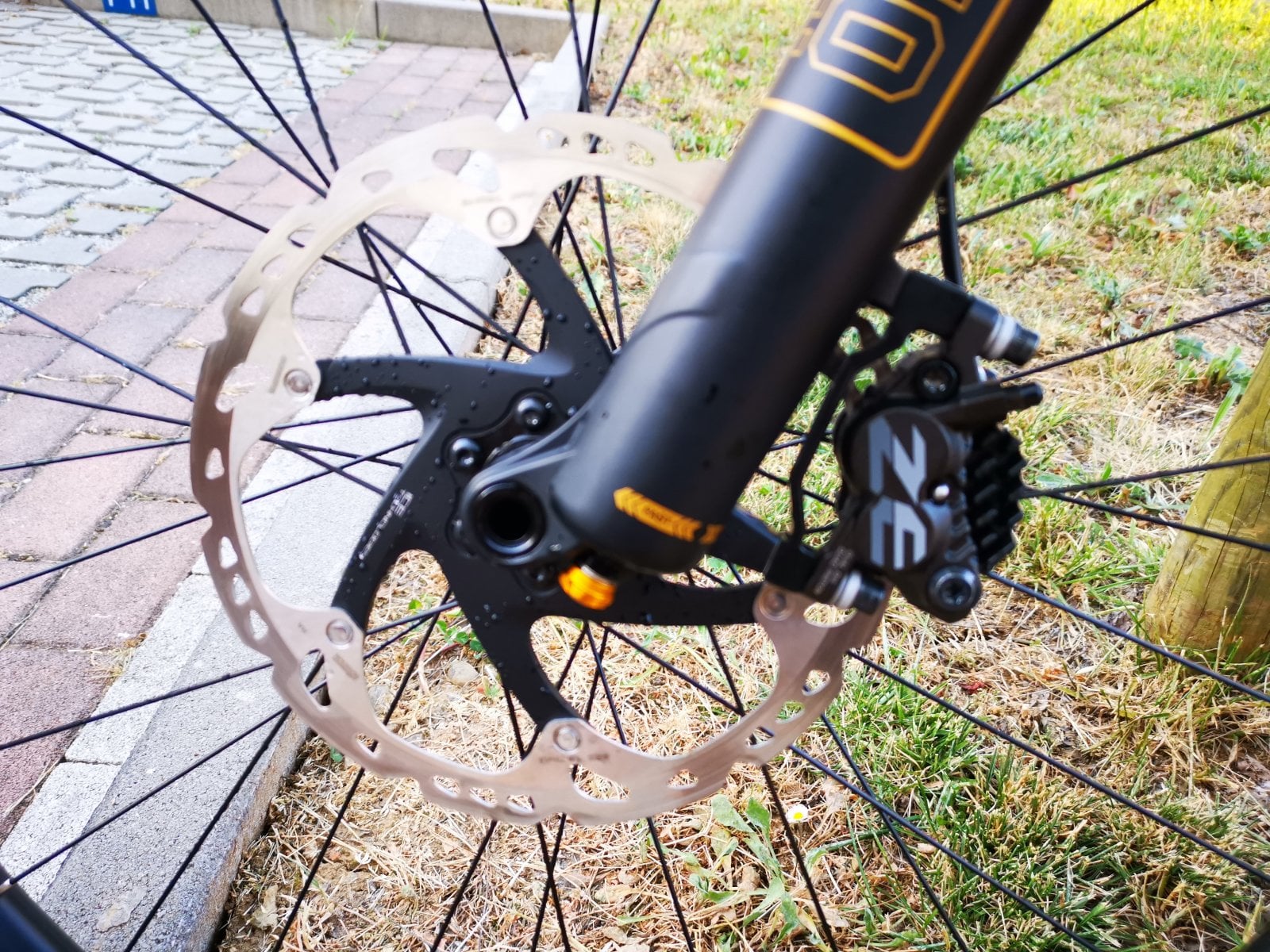

Hi guys.
Recently got myself a E-ONESIXTY.
Loving it so far, you really don’t notice the extra weight on the trails. Only thing I’ve touched is a tyre change to something a bit tougher, I’ve just upgraded my to a set of zee brakes to slow me down as well.

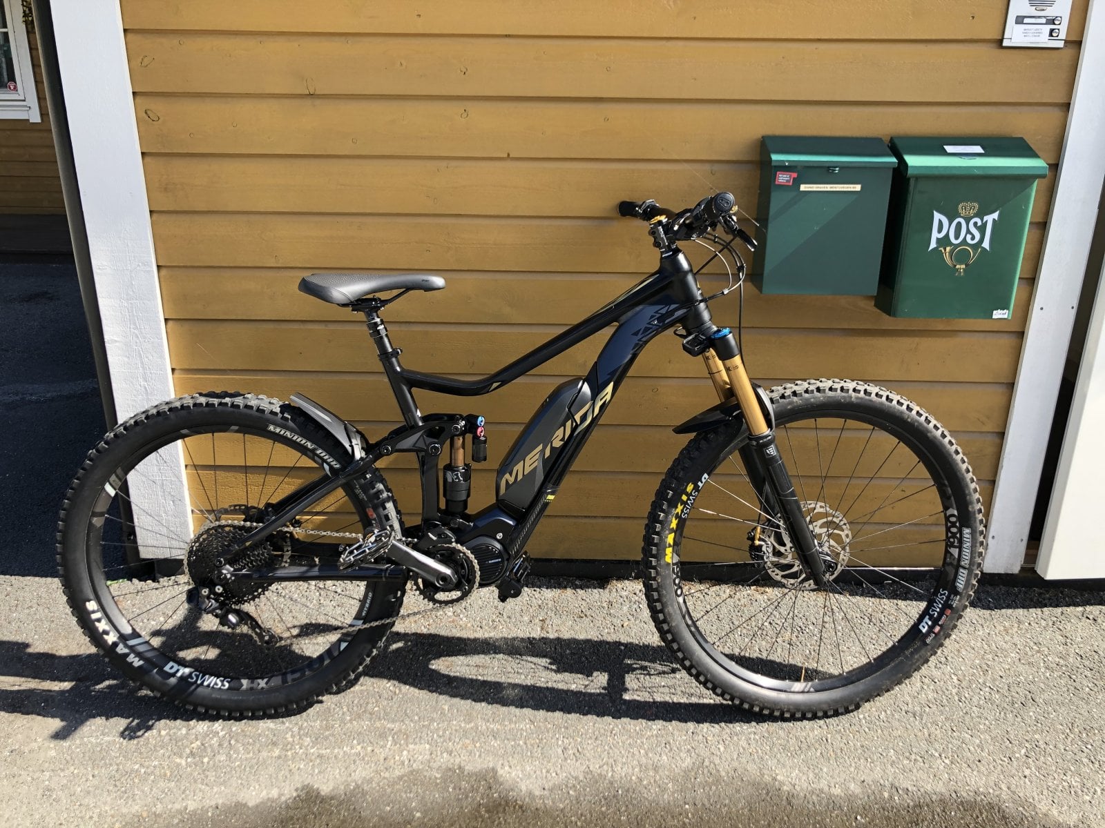

the Suomi Fat Freddie 3.0 barely fits on the rear, had to remove the mini fender. Works well though, no issues last winter.

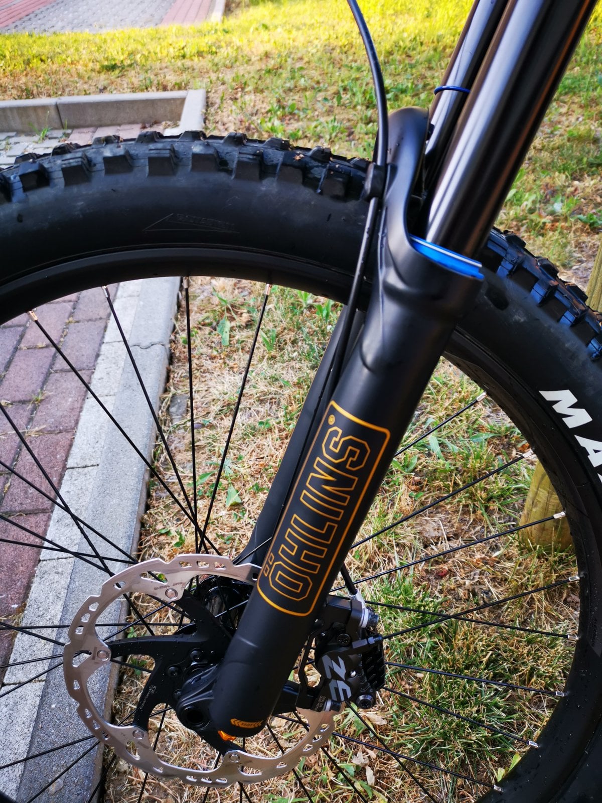

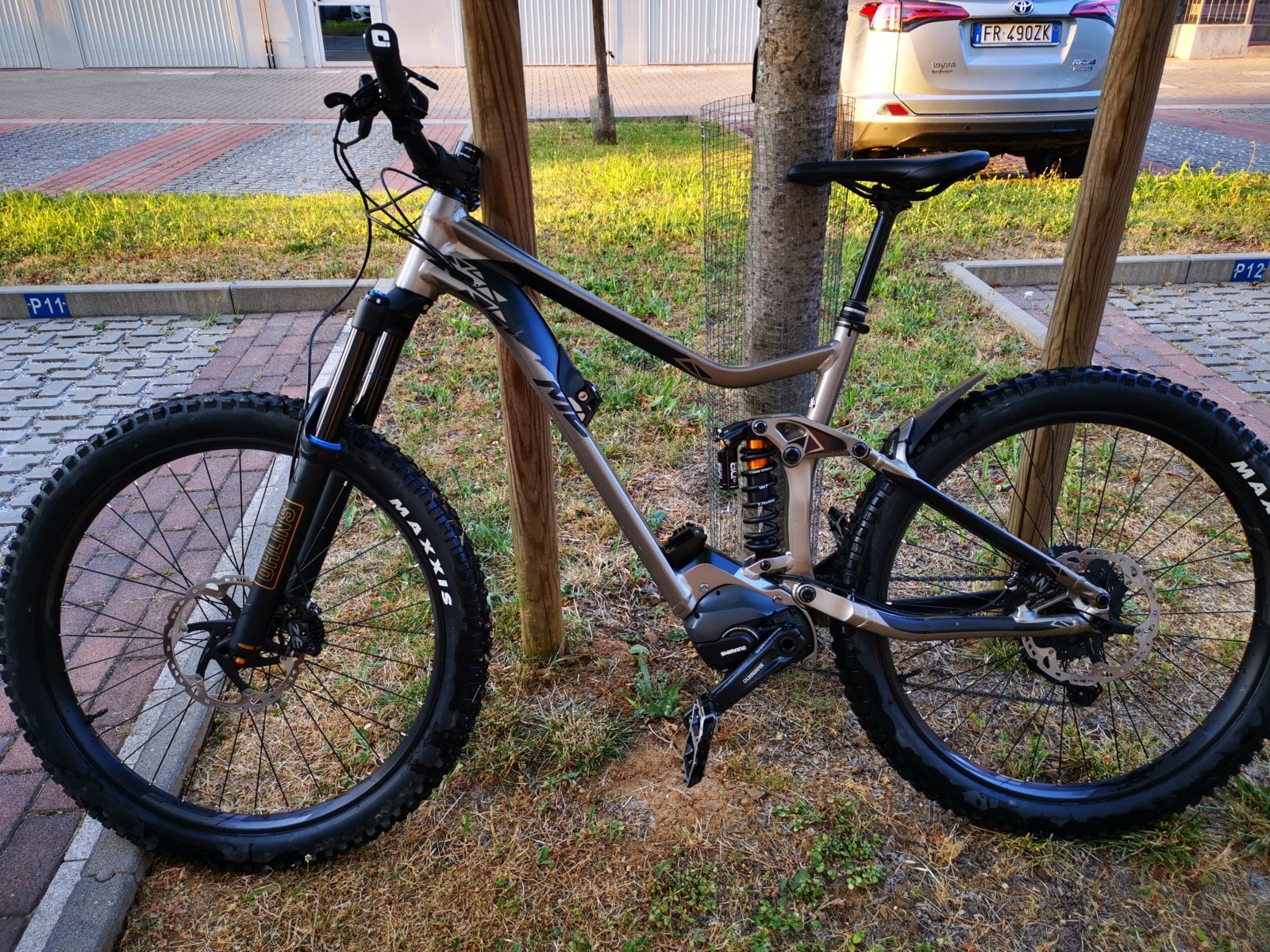

Ciao Teo (saluti da Imola ;-)),
How do you feel the ohlins Rxf 36 coil (Evo?) on your Merida?
I bought the same fork but I cannot appreciate it very much so far...
What is you ready to ride weight? Coil rate/colour? Fork settings?
Please inspire me....:)
Thanks you!
Andrea
Teo78
May 9, 2019
7
ITALY
Thanks you!
Andrea
Ciao Andrea,
the feeling is really good! i'm ready to ride 90-92 kg, but i have buyed directly from andreani already set for 100 kg .
I don't know the coil rate/colour, i increased the return regisrty of 2 click , low speed compression 3 click from full open, and spring reload 1,5 turn from open.for now is ok but i use all the 160 mm of travel,this for the coil "linear" feeling.
