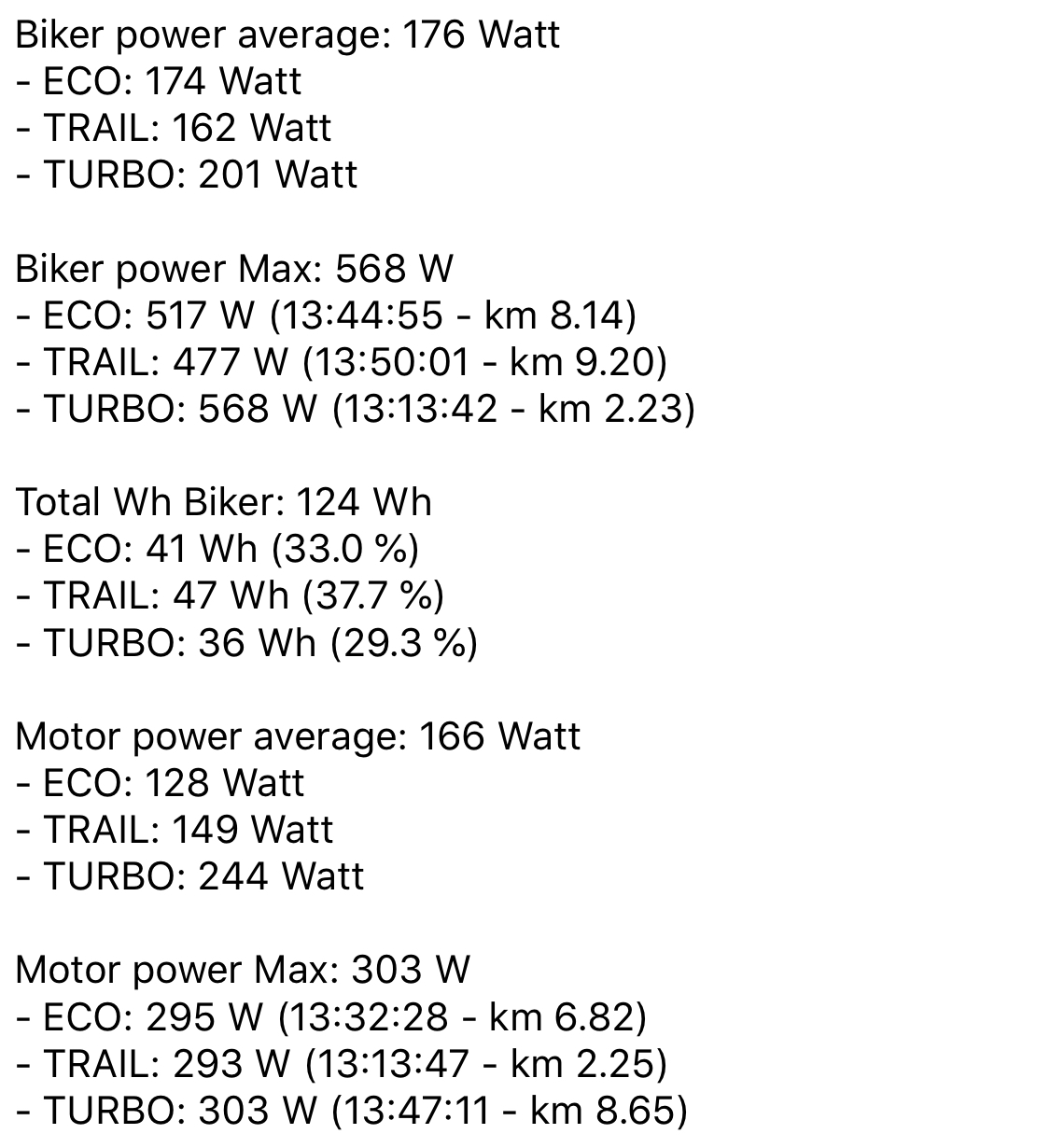

Hey Rob,
Really good info to digest.
Out of interest, what settings were you on for Eco, Trail and Turbo?
Also, is it possible to download the CSV file and look at column J which should be called ‘Battery Current (A)’ as this will tell you what Amps the motor was drawing for each second during your ride ;)
Stock mode other than I changed ECO to 30 / 100 as its a nice fluid mode that enables upto 100% assistance.
I checked the CSV. I get up to 6.4 Amps / 48.2 Volts / 300w motor power.

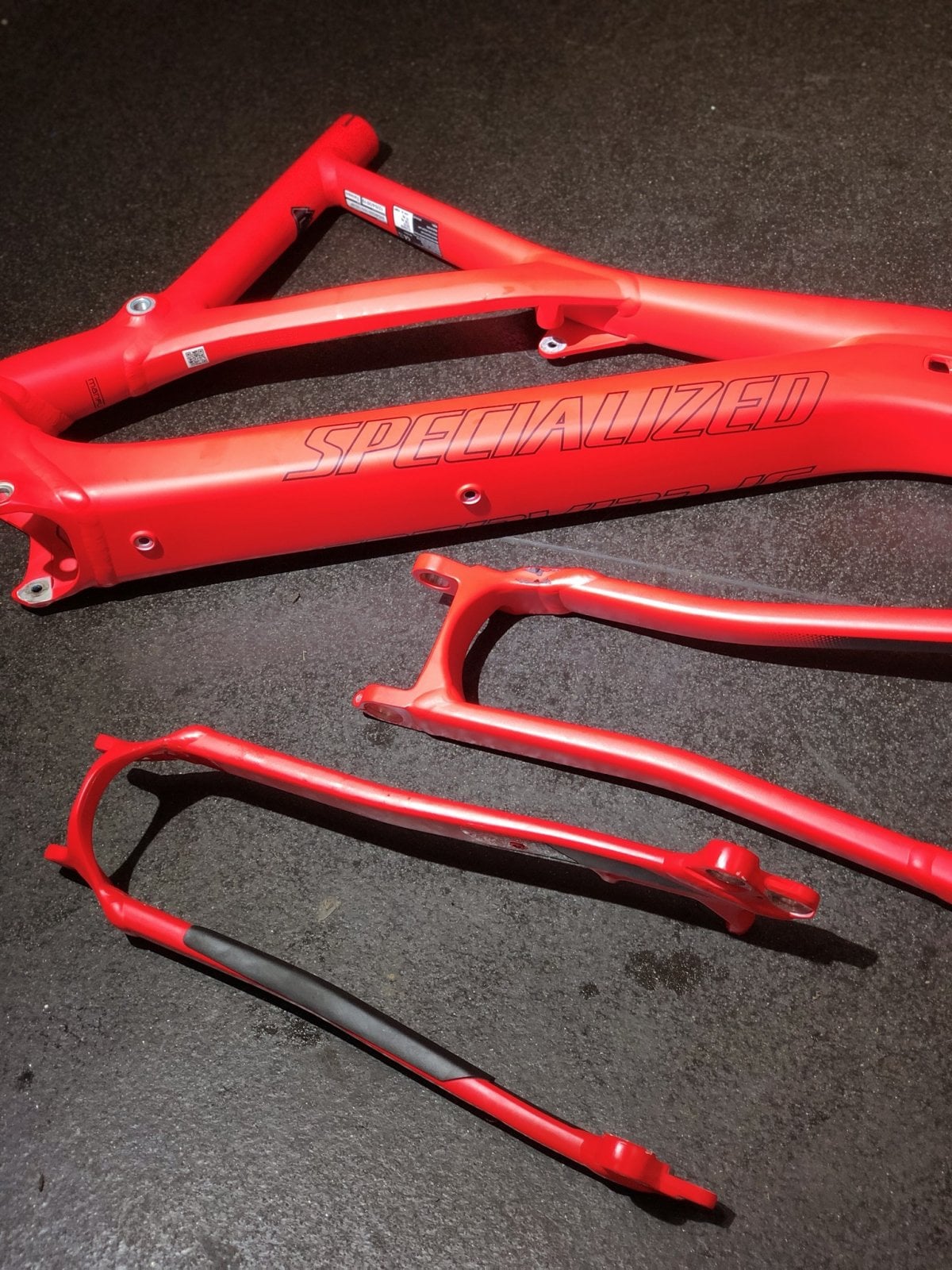

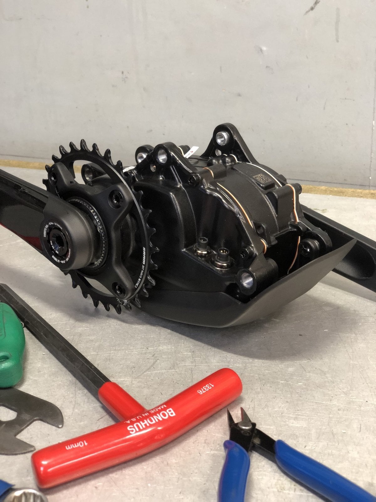

So stripped mine down to frame and now off for dipping?‍♂️
Motor is diddy, so small & light in comparison to Levo. Nice cable routing, much better connections, all looks extremely well thought out.
