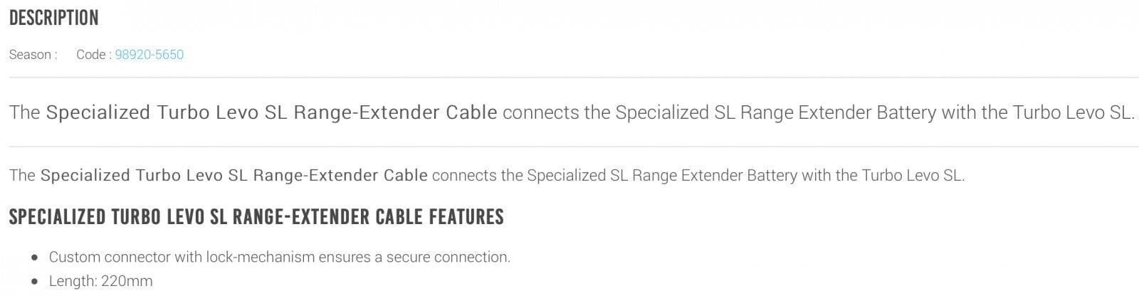

Is the lead identical, just longer? If so seems a pretty neat solution and a bit more flexibility. If the end housing is different and a looser connection to the bike then not so much.
AFAIK it is otherwise identical. The locking is tight, I see this could be beneficial if the battery moves up&down in the cage there is no pull on the connector. The potential negative side is that the cord could put some pressure on the cover if the battery moves.

Neither is here. And the local resellers don’t have it, nor my regular German sites. In the UK they seem to have some.
Haha, I was too fast. Checked the item description...

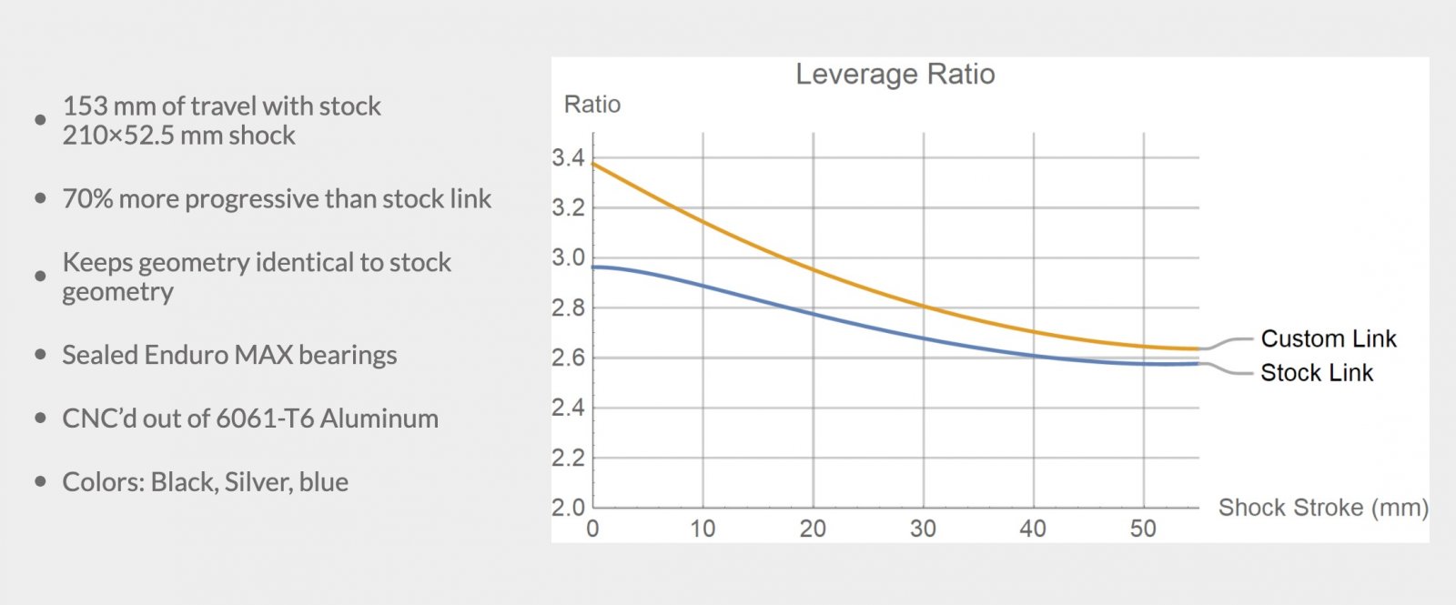

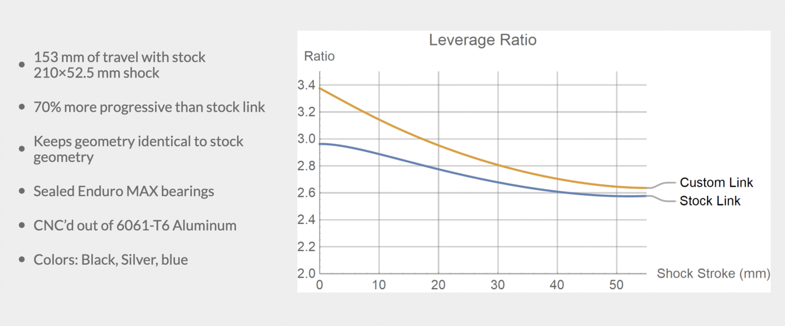

I run my tyres at 19psi front and 23 rear. Is this going to make a big improvement?
I assume I’d be looking at a 210 x 52.5 - which is always classed as a Stumpjumper 27.5 fitting?
You should be able to drop a few more PSI without it being too low. The good inserts (cushcore probably being the most well known) have almost a dampening effect within the tire. It feels more than just dropping air pressure IMO. Plus you get better sidewall support, and if you pinch flat - this helps. It's just something to try if you are having small bump woes. Definitely have bought into the "wheel suspension" marketing claim after trying the CC XC.
210x52.5mm is stock. You can run a 210x55m with the stock link, but i would check fitment on the chainstay if there is any touching from the link.
Another shock that I have been eyeing with good reviews is the Manitou Mara Pro. I think it will fit with an XL with a range extender. Less well known, but it's had pretty good review, and I am wowed with the Mezzer up front.
I run a Super deluxe ultimate coil 210x55 .. but changing it for now to a air cane creak DB IL .

I am going to sound like I work for them after talking about it so much, but really it's just a good product :)
Look at the leverage ratio change. For same sag, you are a bit more small bump compliance (less force to initiate movement). If you want, you can even run a bit more sag given the bottom out is more supported. For my setup, I tend to run 15-20 PSI more in the stock DPS than I did stock. It's immediately noticeable how the small bump and traction improved. "Coil-like" is apt, but like others have said, it's not as supple exactly. Midstroke "pop" is much greater in my apples to orange comparison (SL vs. 2019 Kenevo with coil), but that is more due to bike leverage ratio, weight, etc than shock type.
The only downside that I have found is that there is a bit of bob on the open setting on smooth roads. However, that translates to a bit more traction on rough stuff. In trail setting, I can't discern bob at all. Plus, on an ebike - it's really not that big of a downside.
