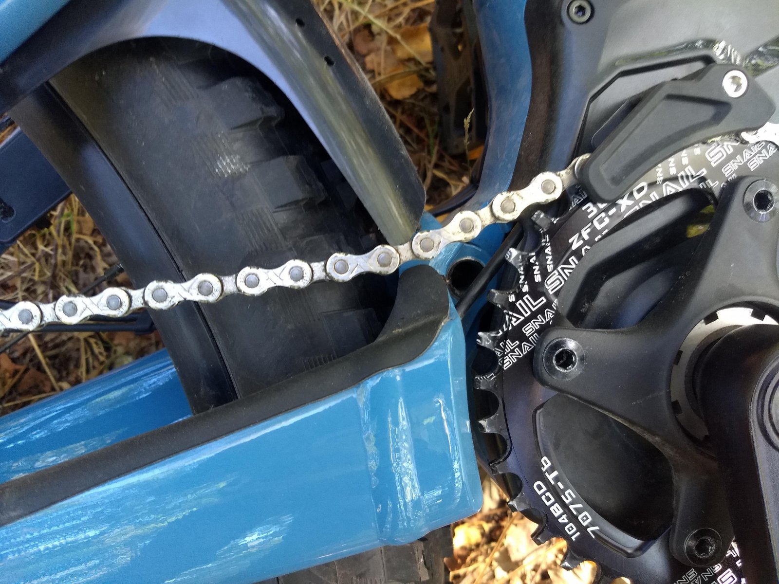

This is the one I just picked up. All steel!
14,192
21,121
Quick test for stones and crap getting caught and to make sure the bolts are tight (check after ride). Guards seem to work well, no flapping, no stone jams - did have one leaf get caught.. but otherwise, wouldn't know they were there.
36t was nice. I thought it had fixed my power "CLUNK" , but still had that once. Didn't notice the motor "Zzzzziiiipppppppppp" sound when pedaling above assistance, so as @Christian suspected, that could have been something to do with the chain guide. Much better spread through the gears, for me anyway... was still pedalling at over 50kph and it didn't feel like hamster wheeling.

Managed to squeeze in a longer ride yesterday afternoon. The 36t sort of helps with the clunky shifts. I think the worst shifts are on the higher (smaller tooth cogs) gears, so you end up using them less with the 36.
Only problem was where I'd cut the rear mudhugger too curved to follow the rear triangle and the chain rubs it in 1st gear ..

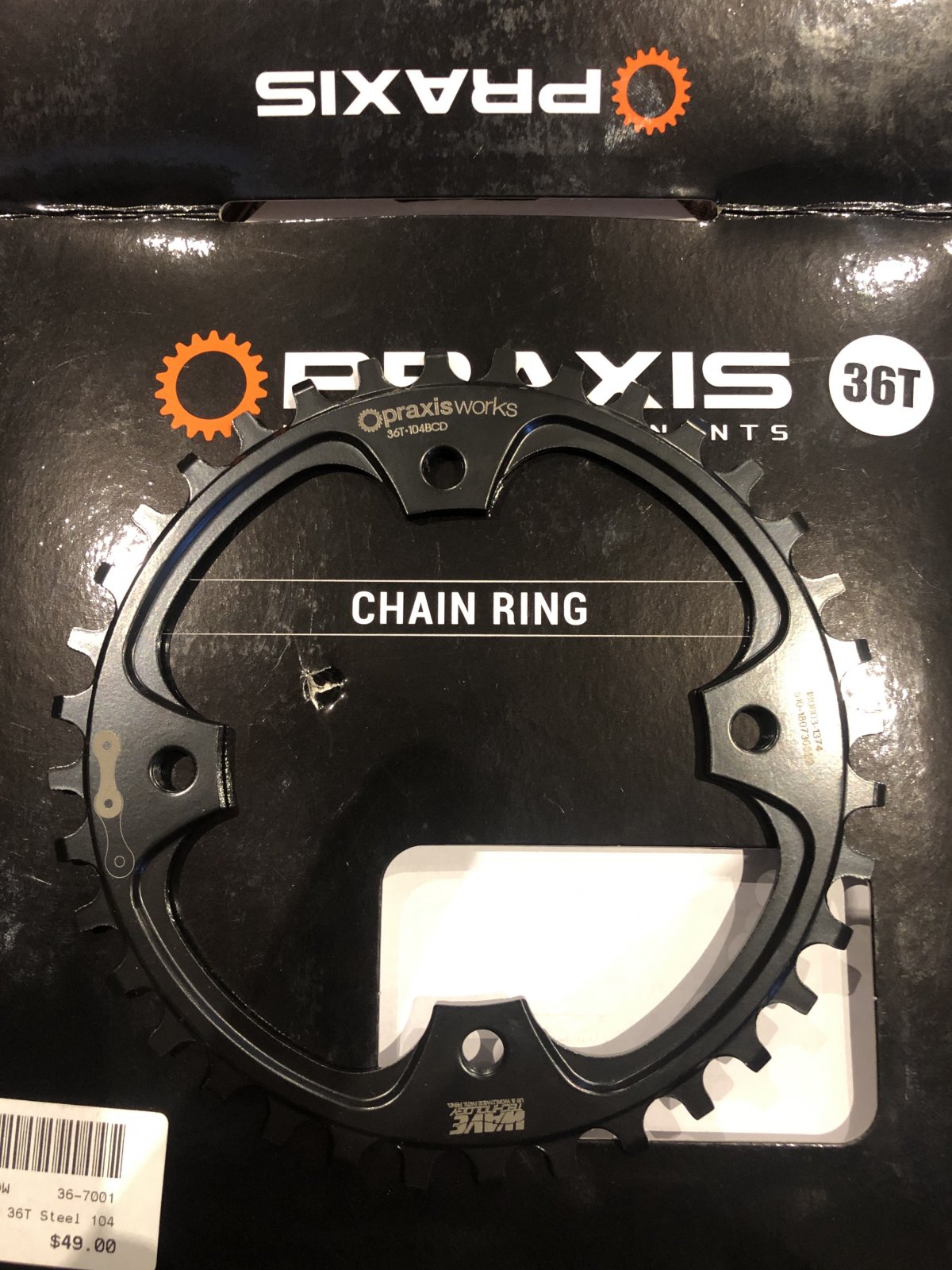

Hahaha I was trying to keep it a secret as it’s not yet finished.
The 36T doesn’t fit as my bottom bracket is slightly higher than stock. I’m getting some bushes made up for the rear shock to drop that back down and then install the sprocket.
I have a few more mods to go then I can take some pretty photos.
I almost bought the Nicolai but I love the Kenevo so much I decided to spend the money on it instead.
14,192
21,121
OK .. well I won't tell anyone here if you don't ...
I think someone else had that problem and ground the teeth down slightly ... guess it was a size S or a different brand ring with pointy teeth ?! That's the advantage of the aluminium one, it's easier to grind down with a nail file ... :)
I can't believe you'd fudge it with some bushes ? Can't you pop down to your local "Carbon Custom Kenevo Parts Shop" and get them to throw together a one off rear triangle in an hour or so (whilst you drink free beer) If you were in a hurry or they were low on beer, they'd only need to make the bottom part.....
Funny you say that I actually got a price for a complete rear end as I was going to make a longer one a while back. My work’s sister company are metal fabricators so that’s not a problem.
It’s all good though, the bushes will give me what I need and then I can run the 36T.
Just gotta redo the cables to make them a little more symmetrical and few other bits and then I’m good to go.
Just in time for all the alpine parks that are opening soon.

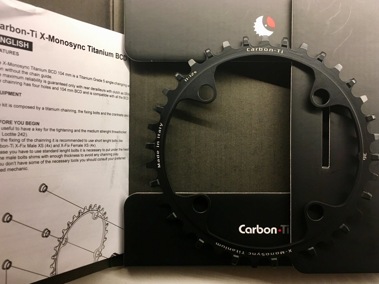

Just had another quick battery test as haven't heard anything from ridercare or lordgun for a few days (I'm being impatient because in my head I know it's not right, but keep questioning it and don't want to discover it is right and I'm a knob).
10km's 318m 20% battery in eco 20/20 trail 45/45 .. So a theoretical range of 50k 1500m. But then the other day it dropped 10% for 7wh used.
anyway, enough of my pointless battery blabber .. the import bit was that I've now done about 50k with the aly 36t and changes are considerably smoother. Every one today was nice.
So a mix of maybe using the larger cogs more, more spring tension on the derailleur (you'd think this would make it more clunky ? - same length chain as the 32t) Aly chainring as opposed to Steel ? Or overnight I've become that much better at changing gears !
Obviously for all you posh fancy Rohloff users with all your free beer .. it won't make any difference to you.
