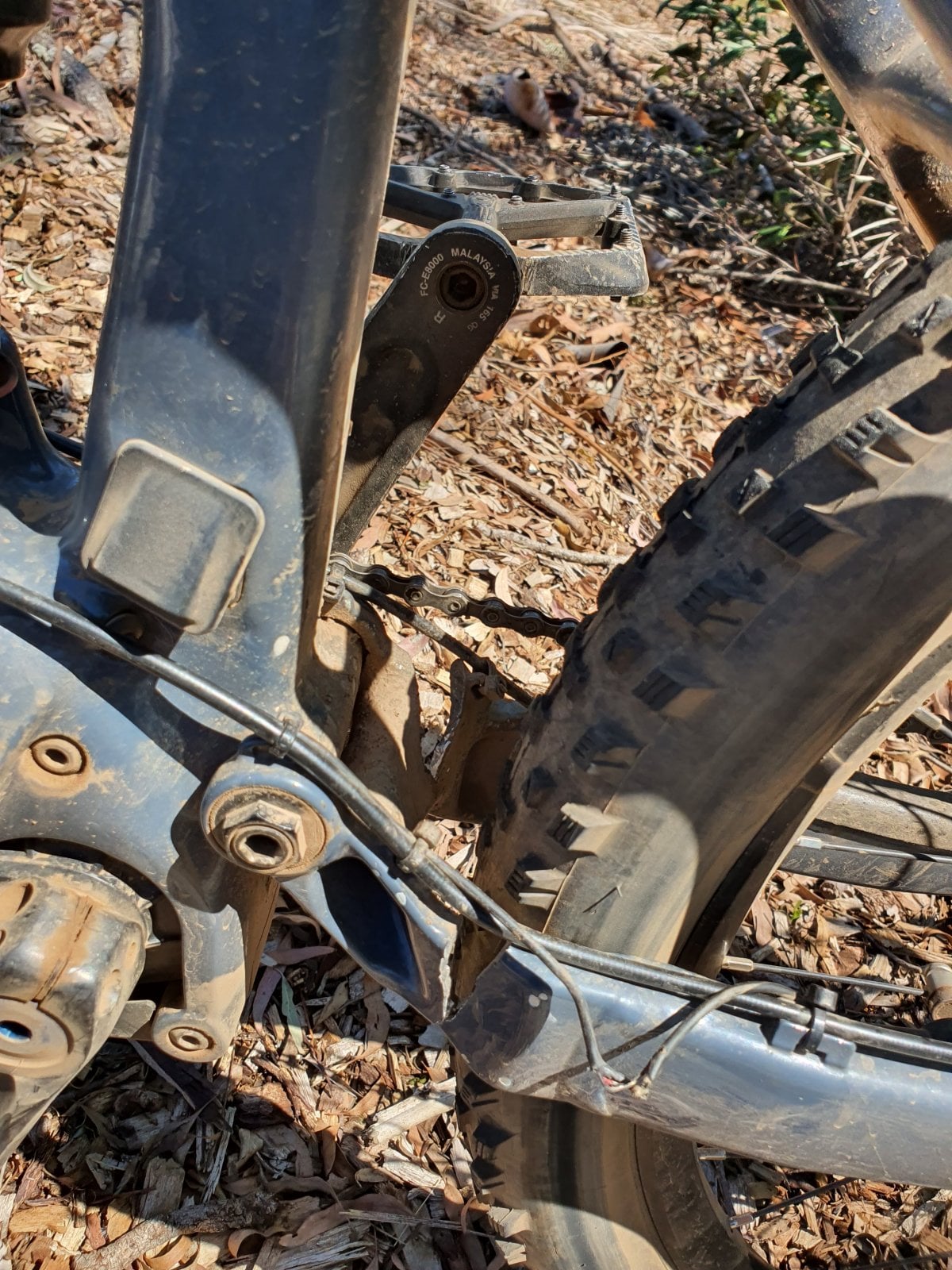

So my bikes hit roughly 11000ks and today boom. Hoping it's covered by frame warranty
Oh yeah that's intense.... yeah to hear news you have been granted warranty would give me a sigh of relief to ay.... my sights pretty much just the frame - motor all parts upgraded.....it's seems hanging onto it as long as possible not a lot of stock available....
Good luck on the warranty mate!

Last week the e8000 motor casing cracked - breaking off small pieces of alloy casing that has entered inside the motor wedging around the internal magnet- this occured from the crank drive-side and causing the seizing up function to rotate the bb spline and cranks.
The cause of damaging in this region- I can only put this down to over time the many chain dropping incidents!.....
So as momentum goes- unknowingly chain has dropped - still relying on some quick crank turning hard peddling..... To that horrid crunch jam seize not moving.... pulled up to see again chain totally wedged around the motor bb chain pressed firmly pinched in the carbon frame.
Not sure wether this will evaluate to claim warranty.... it was more to find out availability on motors here and then if possible replace- upgrading to a ep8.
Keen to hear back with some thoughts!
Cheers....

There is a video on YouTube by epic ebikes and they swap the E8000 out for the ep8. I should mention it's on a meroda e160. The cables aren't interchangeable so you have to run new cables etc. How they got one off Shimano I do not know.
Thank you iXi..... l have noticed this clip floating about on YouTube, probably a good idea to watch gain a little extra knowledge.... Yeah right if cables are sourced then battery removal, ok no worries.....

I had a look in the comments and someone asked about the VLT 2020 and the creator replied there was issues with fitment.

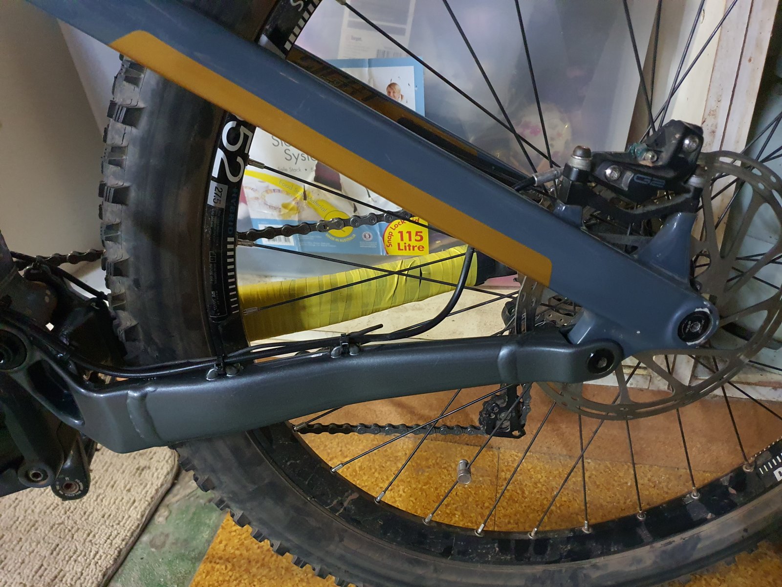

Yeah norco came to the party no issues. Even replaced the speed sensor which got chewed when the chain stay broke. Couple of things but, the chian stay is stamped with 29, no idea if that means it was meant for a 29er but works just fine and also its a silver colour not the same as the original paint but doesn't matter as my bikes pretty smashed up with tons of scratches and chunks of paint missing. I also chewed a chunk out of the frame behind the front chain ring when it derailed and got wedged in there. Since I've moved to a 10 speed Shimano chain ring I've only had the chain skip once whereas it was all the time with the original sram 12 speed ring. Seems an oversight they never provisioned a chain guard or one to retro fit.
Thanks, yeah probably keep to the e8000.... gotta be at least one dust covered e8000 species hanging on a shelf somewhere 😳
Nice shiny clean stays mate!..... Way to go!.... Norco discarded the previous touch up paint colour charts.... but hey all looking good and mighty for years ashred!!!!
