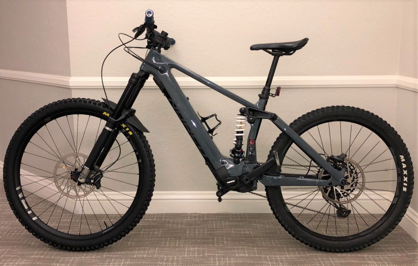

I owned a vlt sight in the past and made it a mullet. easy as putting a lyrik 170 29er fork on. I think it was 44mm offset. really made the bike roll over obstacles better. I also put a fox dhx2 coil on the rear. I found the suspension very linear and blew thru travel. I fixed it by buying a mrp progressive coil. great b8ke but sold it for a specialized levo sl

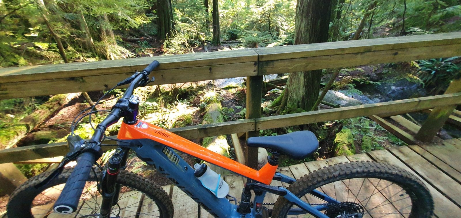

Great info here, thanks everyone for posting. Back in Oct I picked up a sight VLT 27.5 with a pro build (literally)- XTR drivetrain, Saint Brakes, Fox factory 36 and Float x2.
Pretty quick I made some changes. Using some VHB tape and a stainless steel electrical switch cover, I was able to get a water bottle cage on to the down tube. I added a bell. Next, a 180mm dropper post. The head angle (66) was steeper than I was used to, so I put a -1 degree angle set on and then found a deal on a 180mm Fox 38.
I’ve had some really fun adventures on the bike and I love it so much! I feel really lucky to have come across a deal on a dream bike.

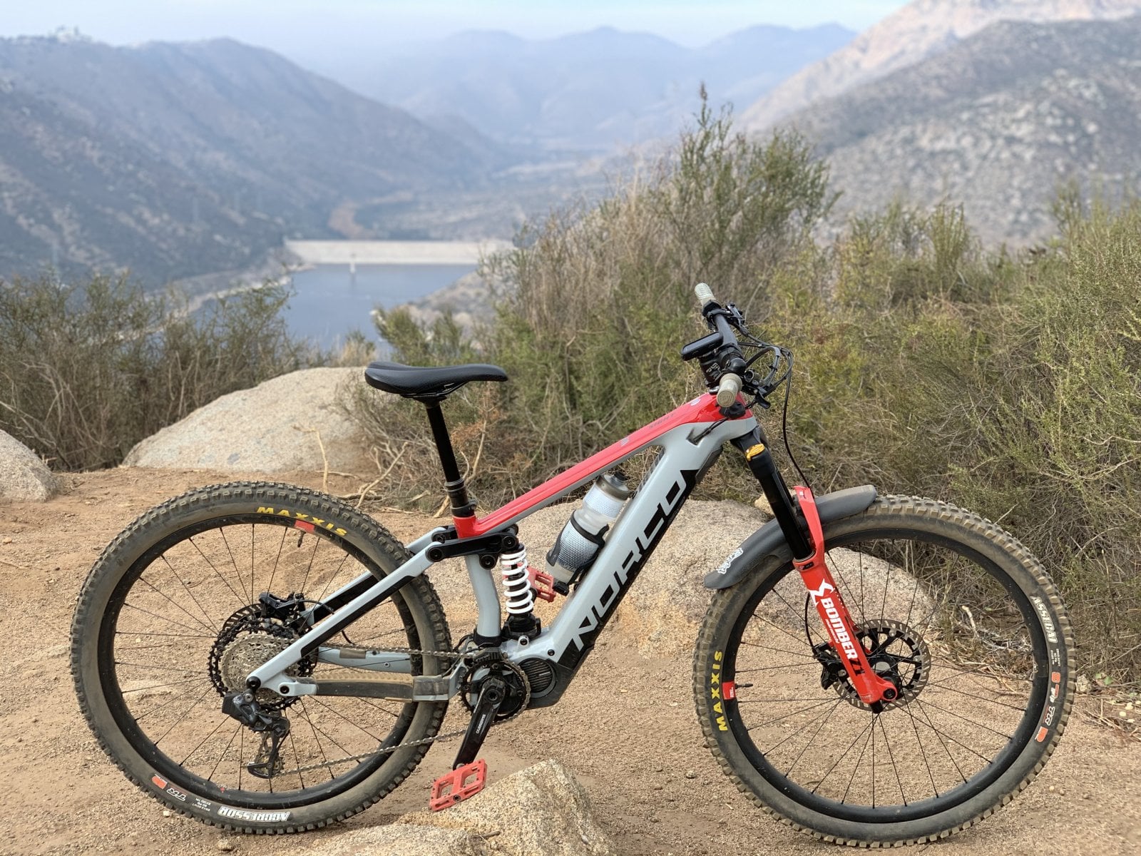

I’ve got just under 1,100 miles on my Sight VLT 29er C3 with no issues. So far I’ve been pretty happy with this E7000 motor. Was worried it wouldn’t have enough grunt for the climbs but I’ve had no problems keeping up with my friends on their 2020 Levo’s, Orbea Wild FS (Bosch CX) and Giant ETrance (Yamaha).

Sweet bike, love the color scheme! Hey do I see you’ve chucked the shimano display and are using a Garmin instead?
Sharp eye on spotting that and thanks I am happy with how this build came out! I was trying to get the C2 build but unfortunately couldn’t find any in stock for my size so I went with the C3 build. I was pleasantly surprised by how well the E7000 motor has been running and I haven’t had an issue keeping up with my buddies on their Bosch, Brose and Yamaha powered bikes.
I removed the Shimano display because it didn’t really give me any real useful info like actual battery percentage and could only display 1 dataset at a time like speed or cadence but not both. I purchased a Shimano EW-EN100 which allowed me to receive all the Shimano info on my garmin like actual battery percentages instead of just showing me 5 bars, power modes along with power assistance level in each mode, cadence and all my other info like speed, elevation, distance, heart rate and a bunch more.
I also replaced my stock speed sensor that uses the spoke magnet with the Shimano SM-DUE11 which can be placed close to the axle and runs off of a brake disc rotor magnet. Much cleaner and I don’t have to worry about my magnet falling off.

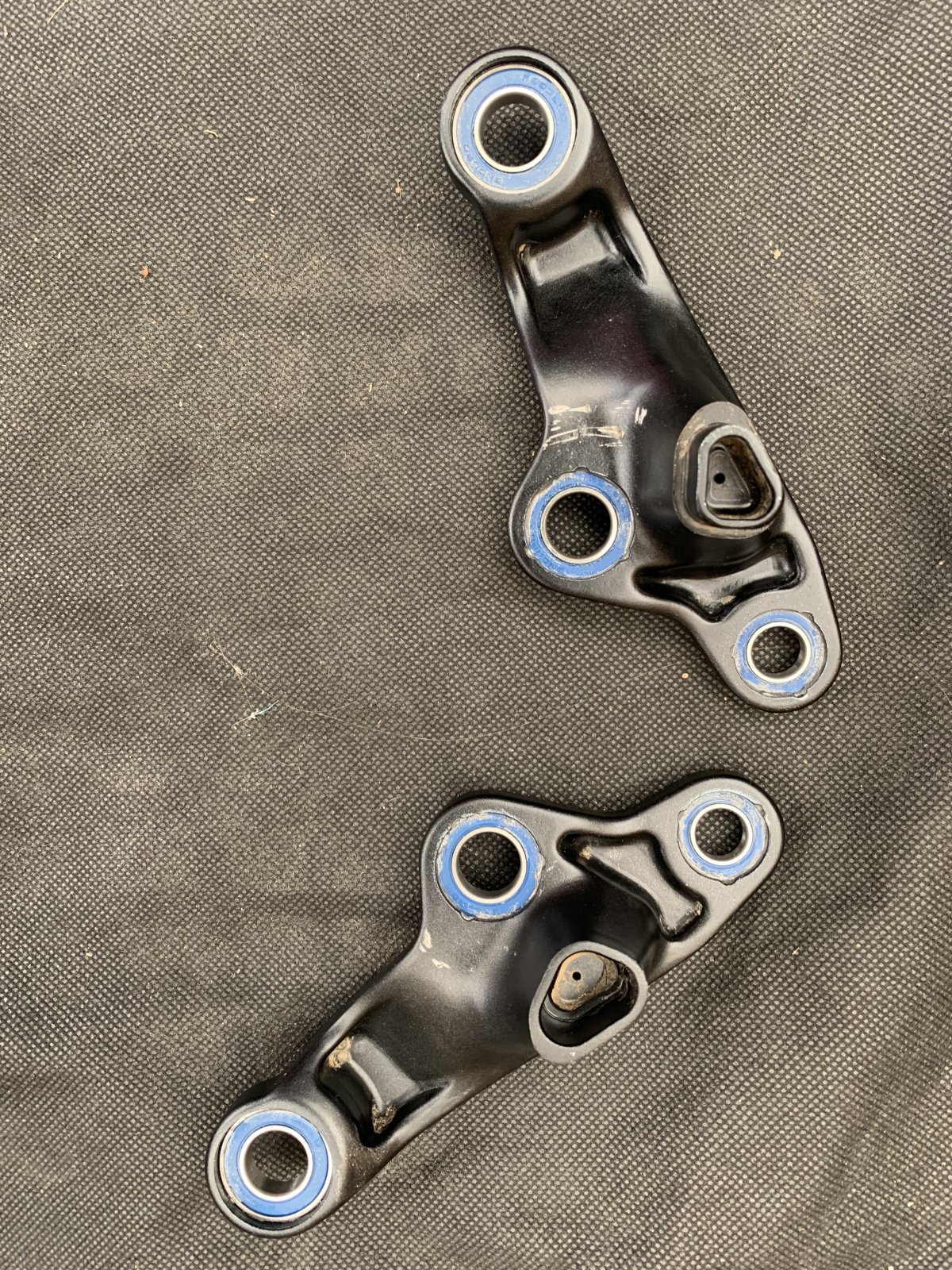

Hey Guys
In the process of replacing all the bearings on my VLT 2. When I removed the upper rocker link to do the 6 bearings the link came away in 2 parts. As anyone else had this happen ? Looking at the both parts it seems they were glued together with a thin plastic gasket between the 2 parts, which has appeared to be worn out. Any comments/advice much appropriated.
Cheers in Advance

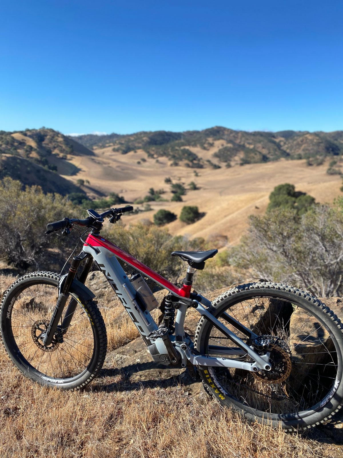

Hi everyone,
My wife's 2020 Norco Sight VLT 29 A1 just got 2000 miles over 13 months.
The Motor/battery has been flawless, way more reliable than my Trek Rail 7
We swapped the SX drivetrain for Shimano SLX after 6 months, no problems after that.
The Shimano "unbranded" Deore brake levers failed, but they replace for XT under warranty.
Just replaced the Air Spring on the Yari and the bike feels way better already
Thinking in a Coil shock now, so I came to the forum to see what you have done and make my report
Cheers from California
