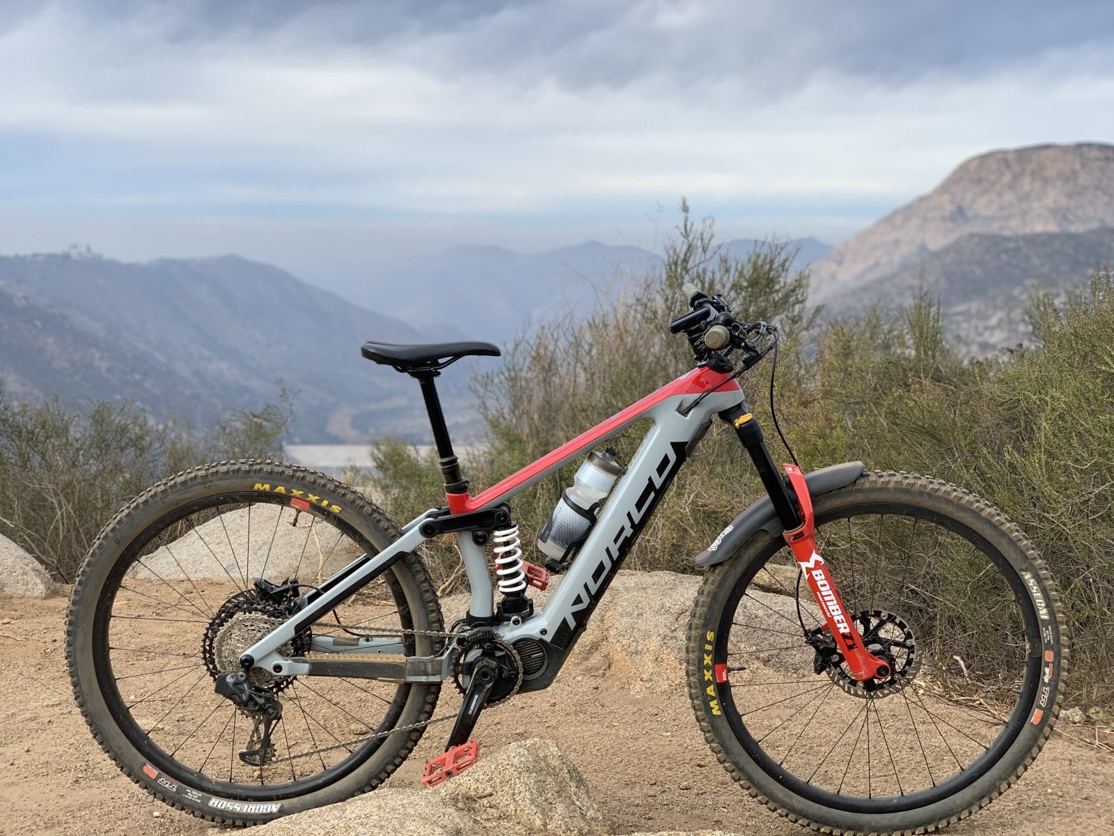

It has been a game changer for me! I went with the Marzocchi Bomber CR and a Cane Creek progressive coil 550lb-670lb. I’m at 165lbs with gear on and it has been perfect for me. I did go up in spring weight by 25lbs over what is recommended because I prefer a stiffer riding bike but still want the off the top suppleness of the coil feel if that makes sense.
The disadvantage of coil for the Sight VLT 29er will be the the max rider weight due to the leverage ratio of the shock and the added weight of the ebike. I don’t think there’s a heavier progressive spring available so you will be limited on option if you weight more than 170lbs. With an air shock you can add more air. Although I was pretty close to max air pressure on the stock shock with a megneg can at 285psi. Again I do prefer a firmer rear shock for those big hits.
Thank you for the answer. Then I’ll need to check the coil weight before going for a shock. But I want a plush feel on my shocks so I hope that’s will not be a problem.
Great looking bike! I just picked up a C1 29. It's such monster! I'm thinking about bumping up the fork to 180mm, maybe a coil too as you have done so well here. Have you kept the rear at 150mm? Wondering if I can get a bit more travel.

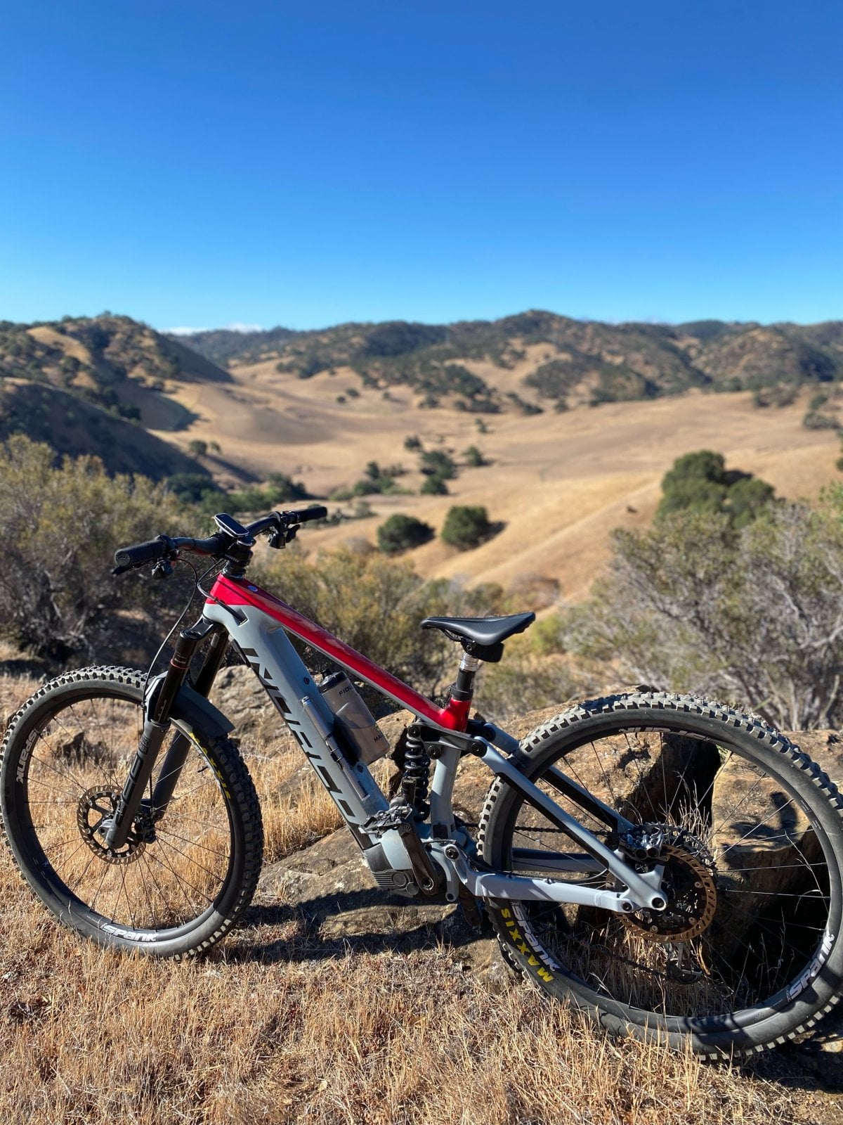

Congratulations on the bike! I’ve kept rear travel at 150mm but I did bump up the fork to 170mm. I think 180mm front travel would be pushing it too far but only you can make that decision.
