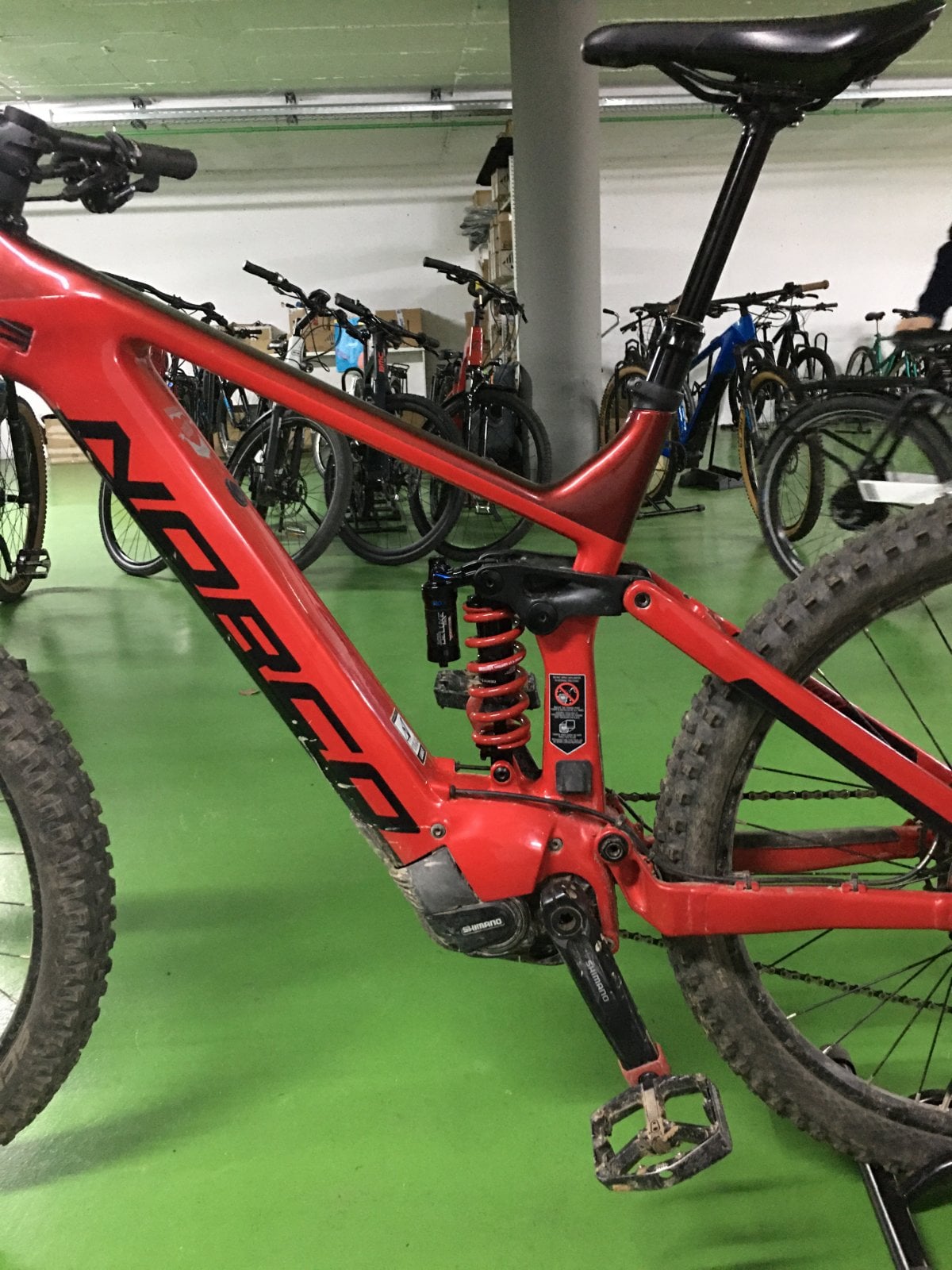

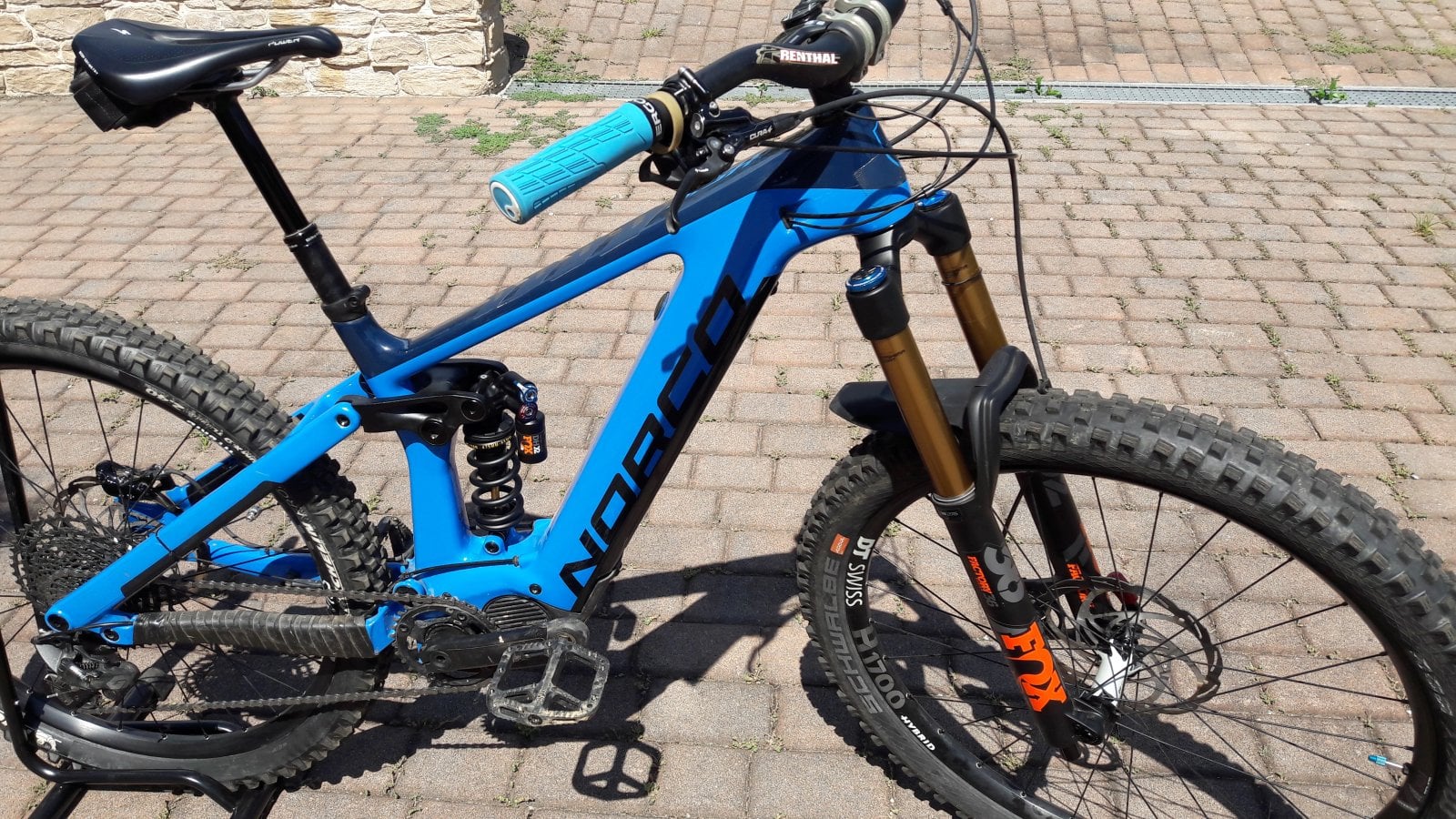

bike looks great. Had my VLT for 9 months and just fitted the Factory Grip 2, just wondering how the Fox dhx2 is going? and what size did you put on?
Hi Hadz, the measurement of the dhx2 is 185x55 trunnion, rear-end on the vlt sight is linear, the system is designed for air shock and therefore I had to make a tuning from a specialist who made the dhx2 more progressive, otherwise, also with harder springs, I used all the suspension, even on small jumps.
Now it is very good, but it has cost so much money
thanks for the response, yep it's easy for the $$ to add up, doh this so addictive. I was thinking the MRP Progressive Spring would work well - MRP Progressive Springs more $$ :( and as I am still a newbie not sure if I would notice the difference. Starting to ride and enjoy the jump style trails in Oz more and notice I've bottomed out the shock on a few I've tried adding more pressure. ThoughI've still got the original 0.4 spacer in though, logic says try a bigger spacer.

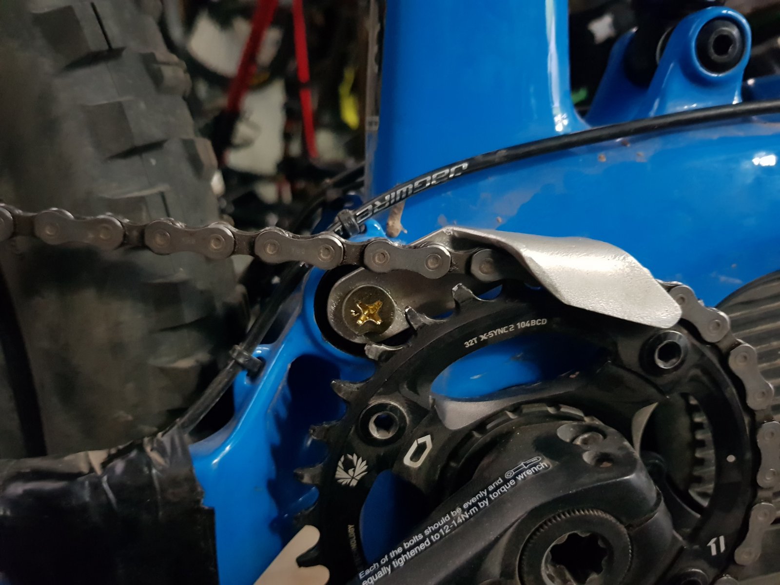

How much do you want to make me one for? lol I have the VLT2 and I get nothing but chain drops and it’s annoying let me know what chainring size your using and I can purchase one as well
It's pretty easy to make, just folded flat alloy, drilled countersunk hole. Used concrete anchor to fit into pivot bolt with countersunk style head.
Still haven't got around to making another one yet.
