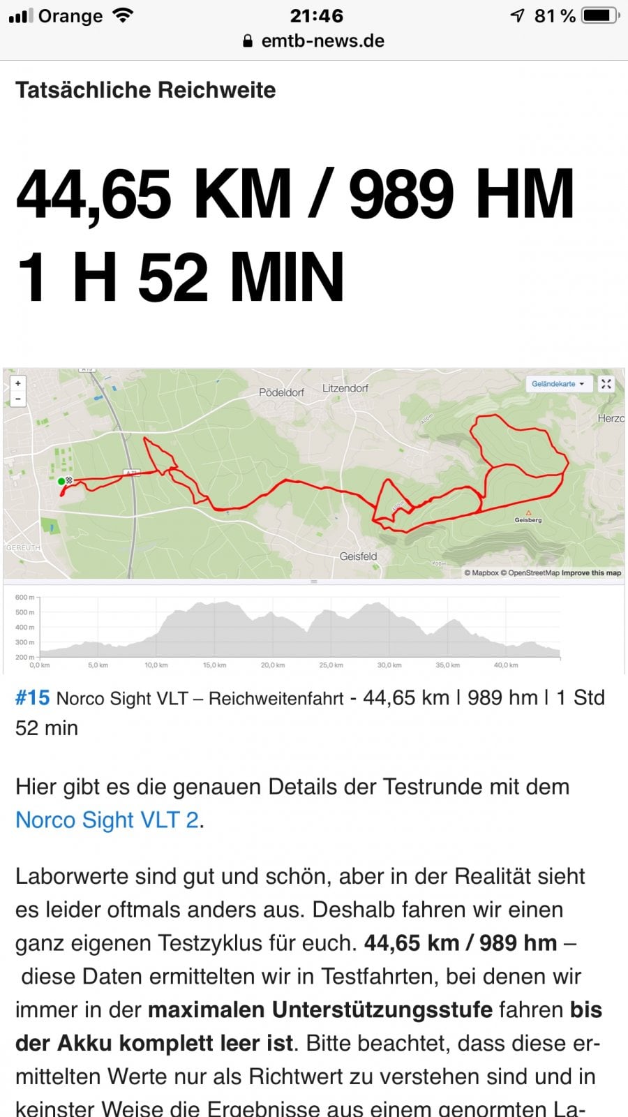

First ride Norco VLT2. Really impressive autonomy. Same as Brose and Shimano with 750Wh battery
The whole run are using turbo mod until drain the battery
Norco Sight VLT 2 im Test: Süßer als Ahornsirup? – eMTB-News.de

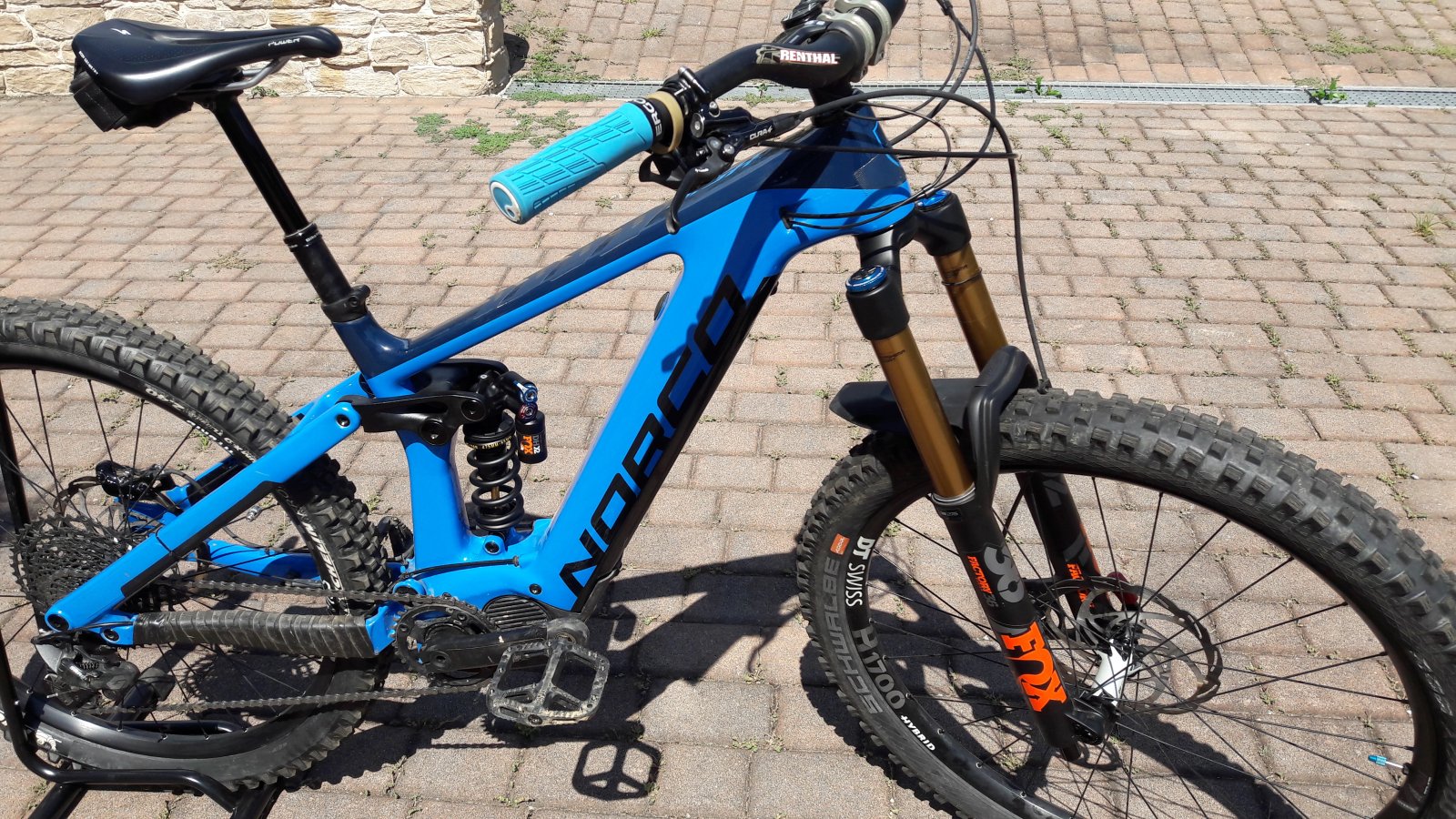

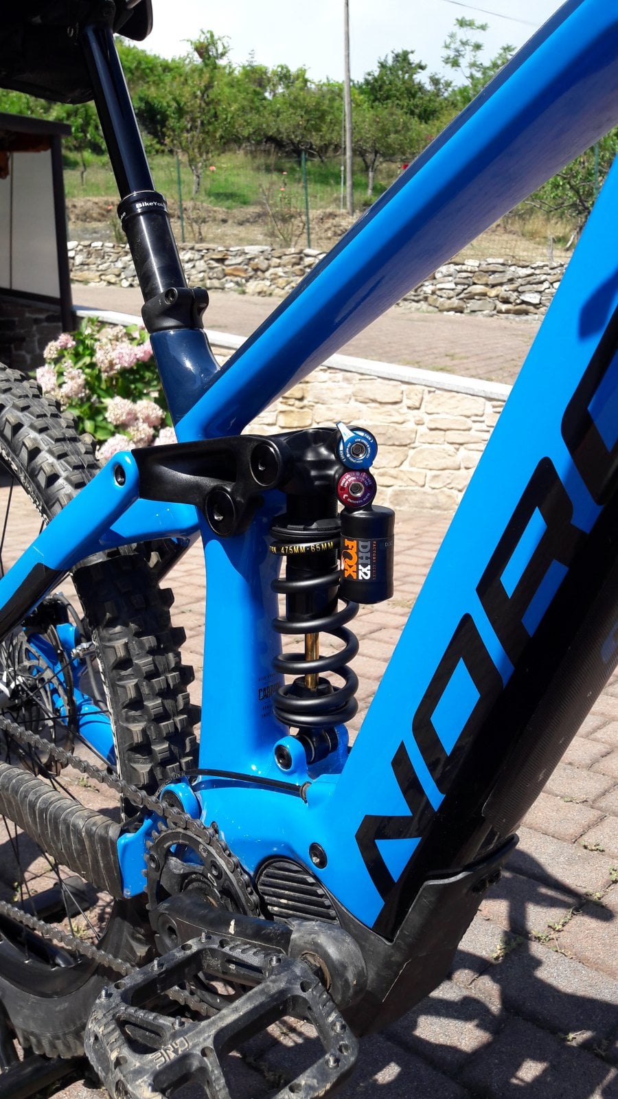

suspension upgrade:
fork Fox 36 float grip2 170 factory 2020
shock Fox dhx2 2 position, used, disassembled from knolly fugitive lt with nukeproof light spring 450lb

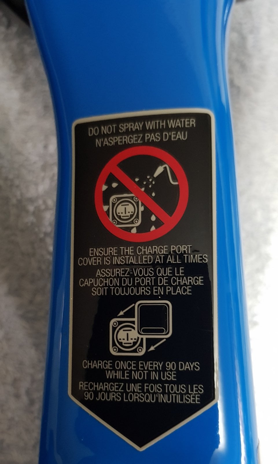

Hey all my VLT developed a problem today wondering if anyone else has experienced it. I was riding along and the system switched off completely. Pulled over went to restart, went along for a short distance, stopped again. Did this again and then it wouldn't restart, after multiple attempts eventually go going then stopped again 15 minutes later. Started again...stopped and wouldn't restart, steps screen came on and then switches straight off, occasionally the main screen would come on then it would switch off, some times would just go steps screen blank.
Took to a local bike shop (I had to buy in a different state as there were none to demo here) and it started up straight away. Guy there said it could be dirty contacts, said to give them a clean. I wasn't sure what was under the plastic covers as I hadn't taken off before, so anyway did that and cleaned everything I could with alocohol. Reassemble and looked all good for 5 minutes then same problem.
Anyone else with the same/similar experience ?
Dewi
Jan 9, 2019
58
89
Melbourne
Had almost identical problem.
Turned out to be moisture in charging port according to the shop and Shimano Australia. Not much and apparently it doesn't take much to cause it. I have since filled it with dielectric grease. Charger still works fine but hopefully it repels any moisture. Didn't have it happen again and I have done some muddy rides, deep puddles, garden hose washing etc.
Be careful washing or in deeper water, even the plug for the port has a small hole in it so if not careful some moisture may get it.

Thanks that does make sense, I noticed a bit of moisture there. Ok I'll follow that up as I left it at the shop!

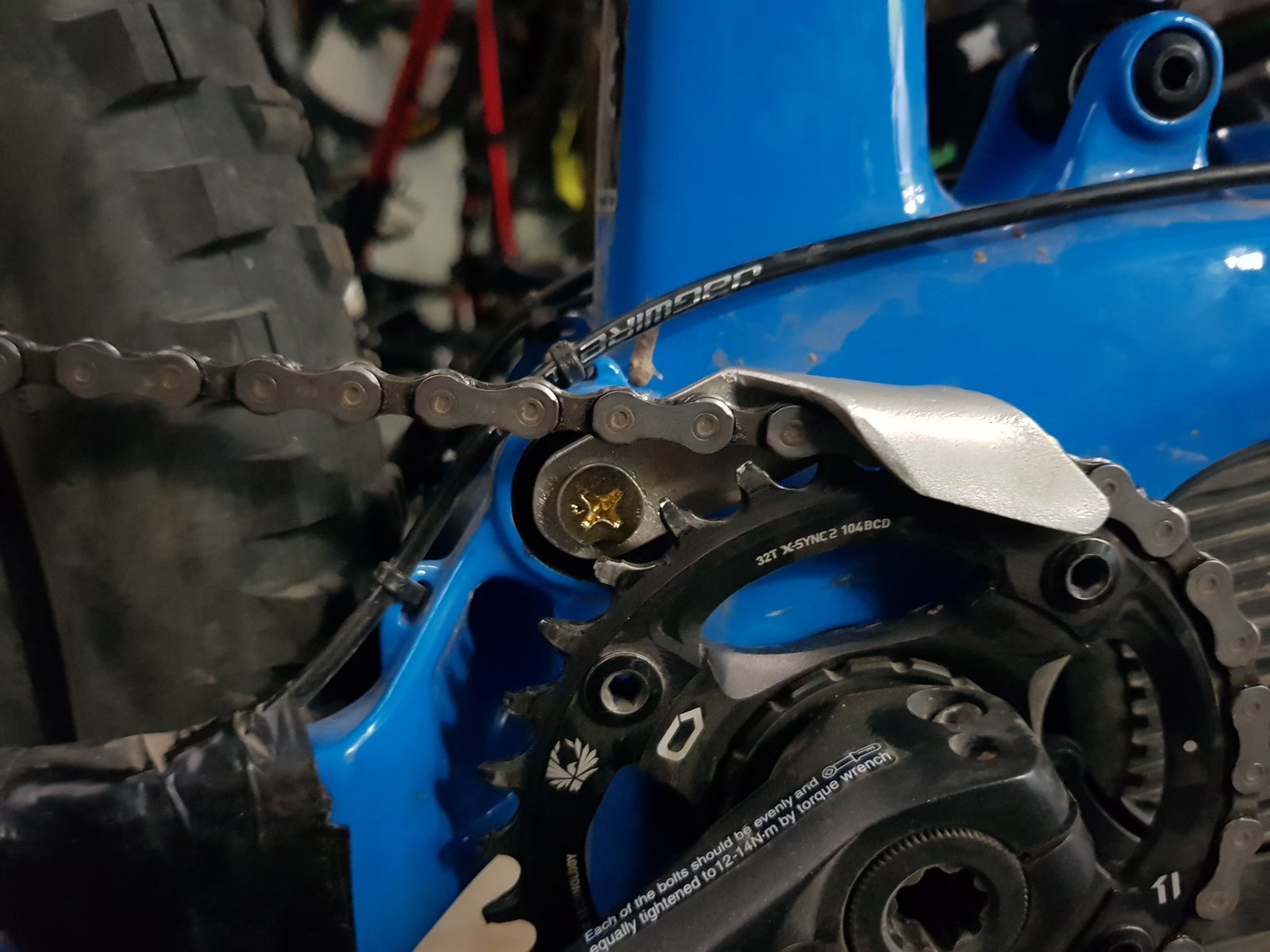

On another note has anyone installed a chain guard on the front chain ring or can it be done? I've had the chain come off a few times across heavy rock gardens at speed.
My bodge. Works really well, need to make a prettier version.
Thanks Dewi!
Got it back from the shop and gave it a blow wave, took it for a spin, bummer still problem. Go back checked again a tiny bit of moisture still there so extra long blow dry (using relatively low temp as I figure too hot is not good for it) and seems to be all good now!
