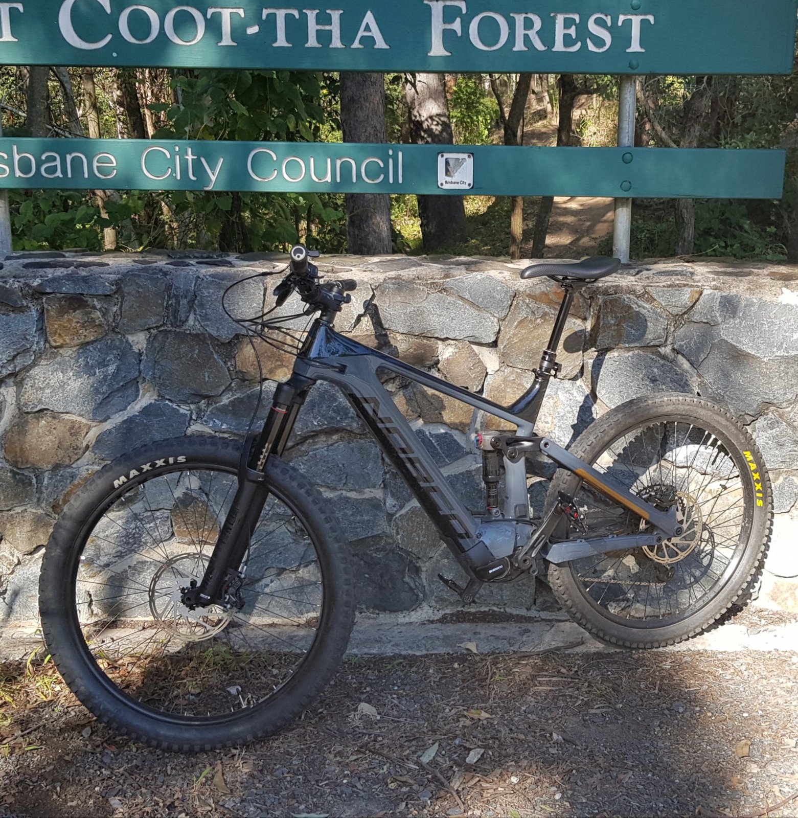

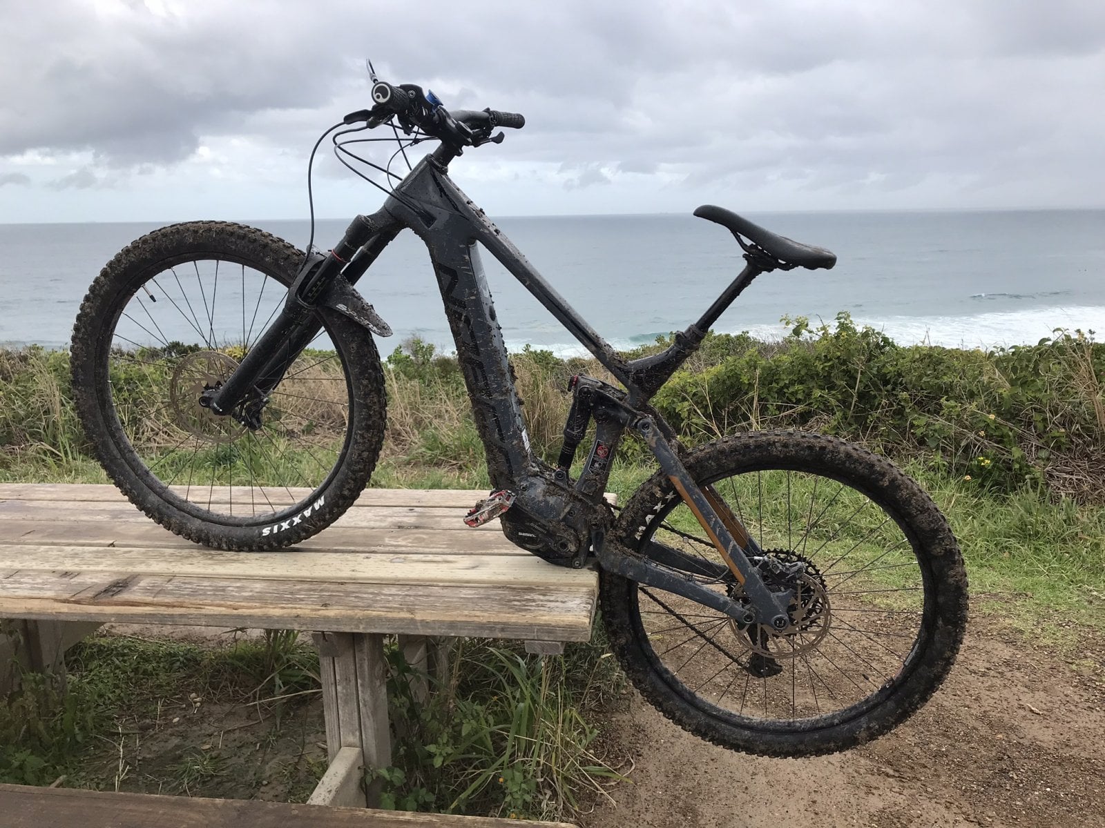

Top image is Brand spanking new , the lower image is out in the mud and slush having a ball . Bike is a VLT 2 , great fun ! Sadly I went to ride this morning and the bike would not switch on , charger says the battery is fully charged but the screen does not show even a flicker when the on / off button is pressed . The bike is at the bike shop waiting for them to check it out . I hope it is something simple and easy to fix , so I am not without the bike for too long , it would be so disappointing to have to ride my non assist bikes for more than a ride or 2 .
Got it back about a week ago , just a cable disconnected inside the frame , both the mechanic and myself were not able to work out why this happened but all good now . The more I ride this bike and push it towards it's limits the more my smile widens , today I rode some trail that are rather unfamiliar to me and pushed rather hard on wet muddy trails , this bike has the right handling traits to just take that all in it's stride , it surprised me on several occasions when I thought I may have gone a bit too hard into sloppy , muddy corners , when it just hooked up after a small slide and drove through the corner , just missing the trees and other trail jank that made my eyes bulge at the thought of hitting them . This bike is a gem !

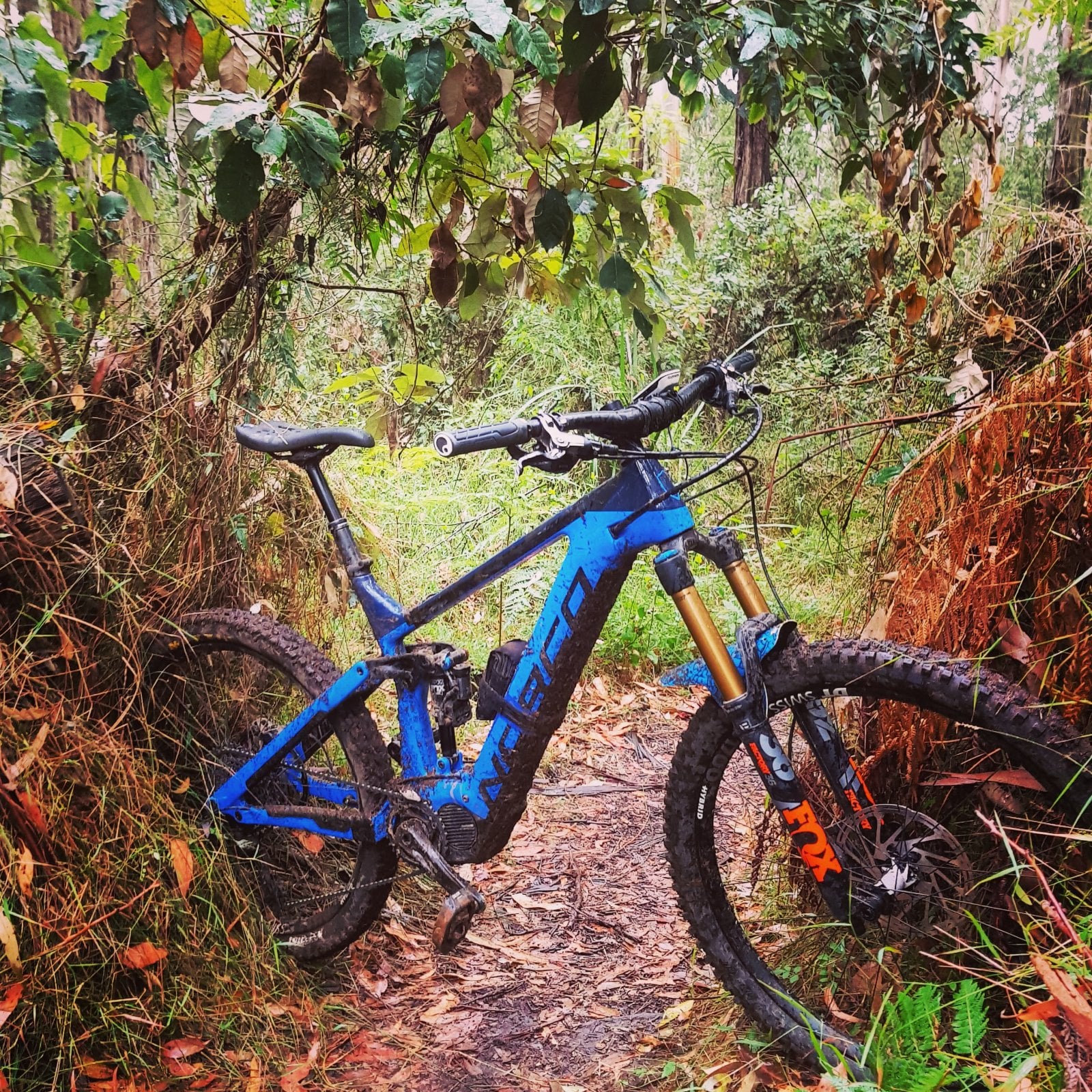

VLT1
Fox 36 grip2 (29er for 18mm more AtoC and approx 1 degree extra rake over stock 27.5 fork)
Code brakes
Assegai DH tires (not in photo)
Love it.
Biggest ride so far 50km 1700mtr climb ride, exhausted battery and lots of eco setting used. Avg is 1000mtr/30km on trail

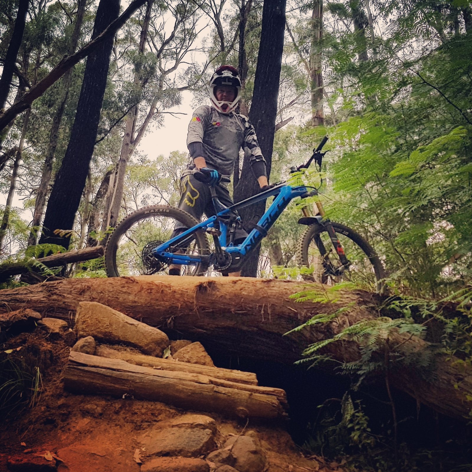

Mainly used for self shuttling local enduro/gravity trails.

VLT1
Code brakes
Love it.
Mainly used for self shuttling local enduro/gravity trails. View attachment 15667 View attachment 15666
Have you tried 29er wheel in front? What about stock shock? Nice rig!
Thought about it, but it's just a play bike, stock shock gets the job done, although some finer tuning on the comp would be nice, maybe the factory version?? Keen to try a 29er front wheel but I've run out of justifiable spending on this rig.
Have a season of DH and Enduro coming up for me and my son so other bikes are getting priority. Going to try a coil in my Range and setting up my Aurum for my son to try.
