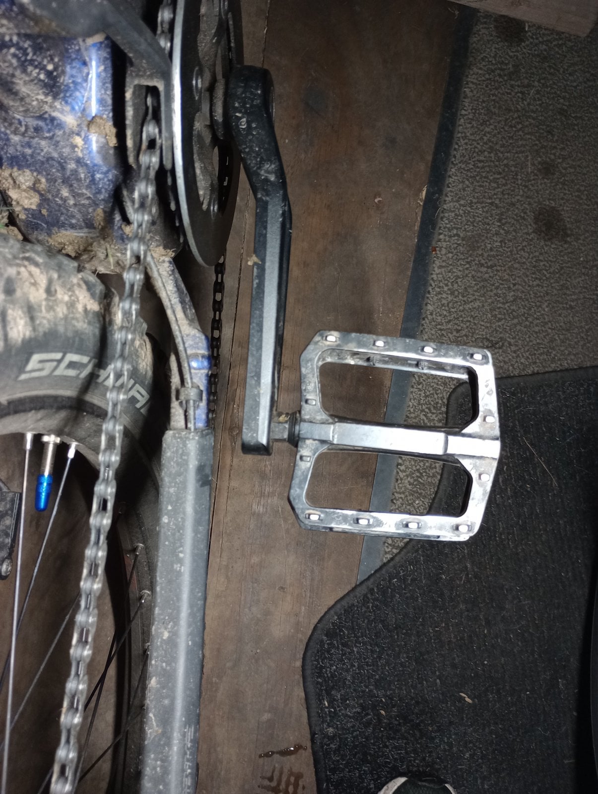

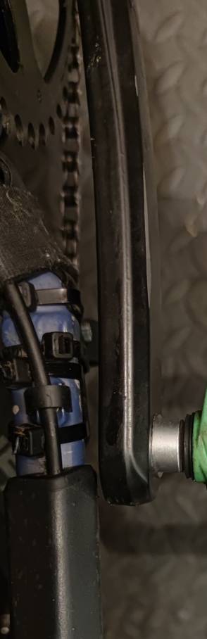

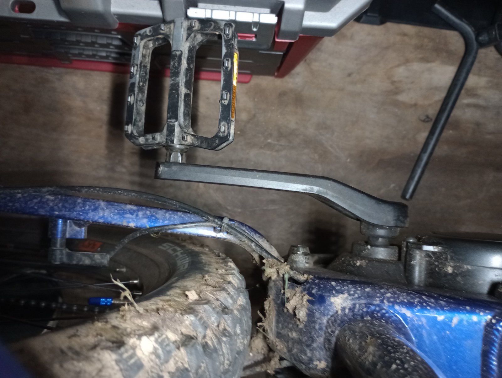

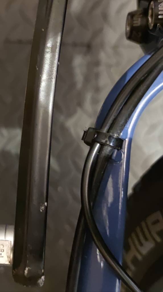

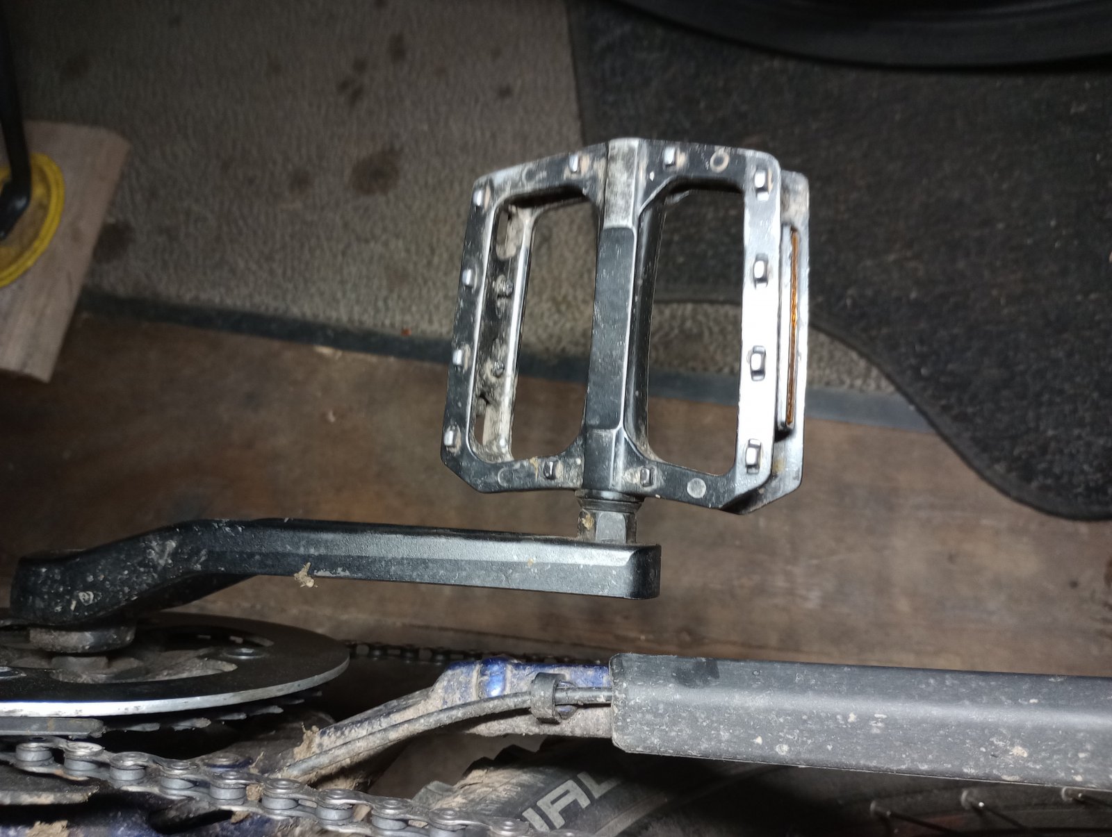

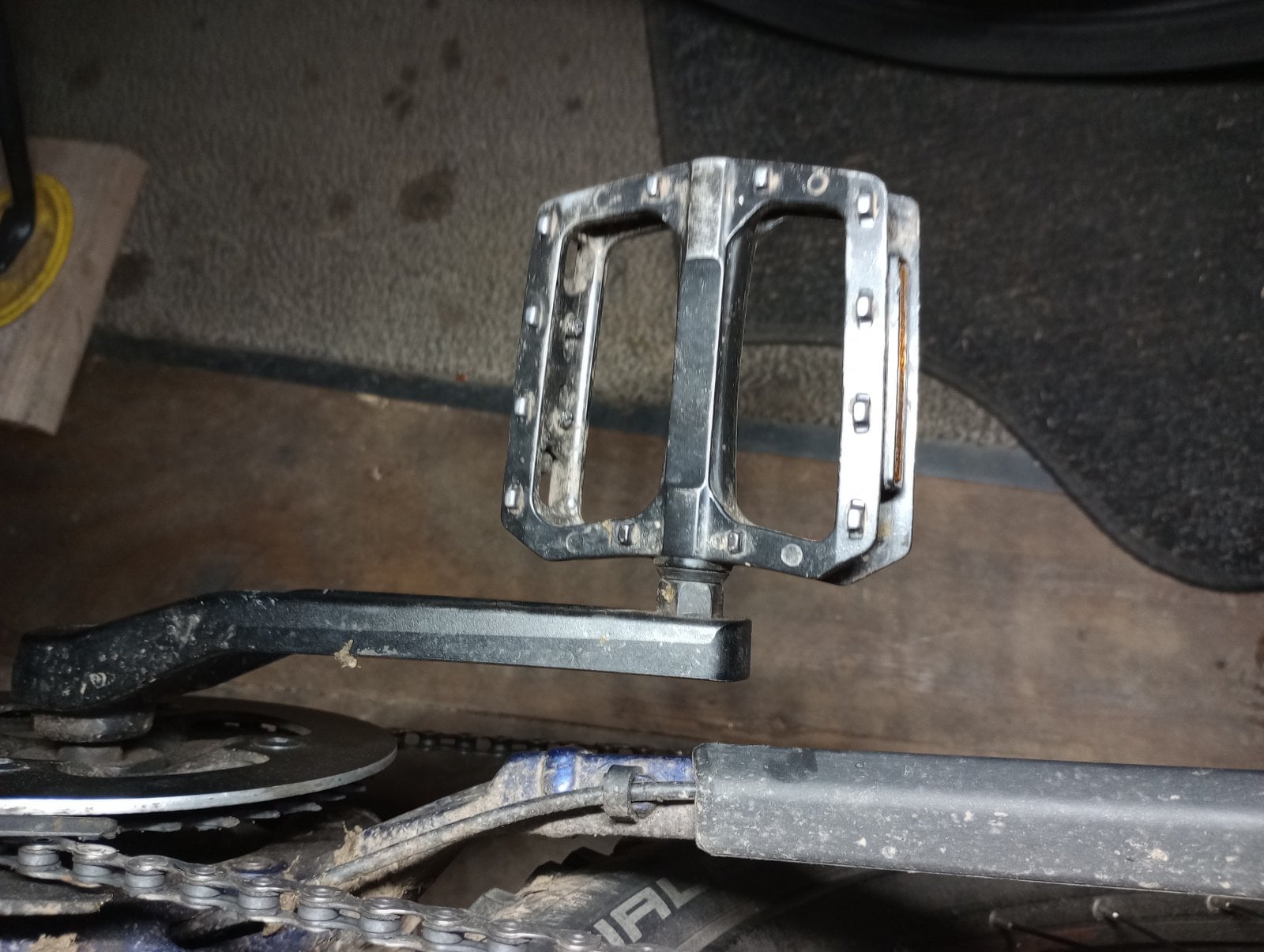

Can anyone confirm / compare crank arm clearance on their haibikes ?
left side seems to have way more clearance than the right side in regards to frame.
not sure if i have damaged the crank arms somehow ( cant recall any strikes that would do this ) or if this is normal.
ignore the ( right side ) zip ties, velcro and rubber etc as thats just precautions for chain suck and a diy lower chain guide.
regards

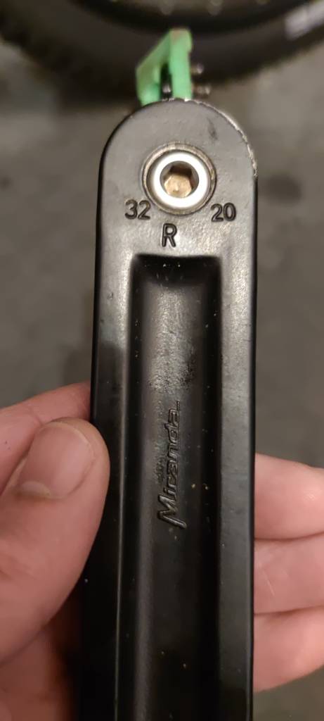

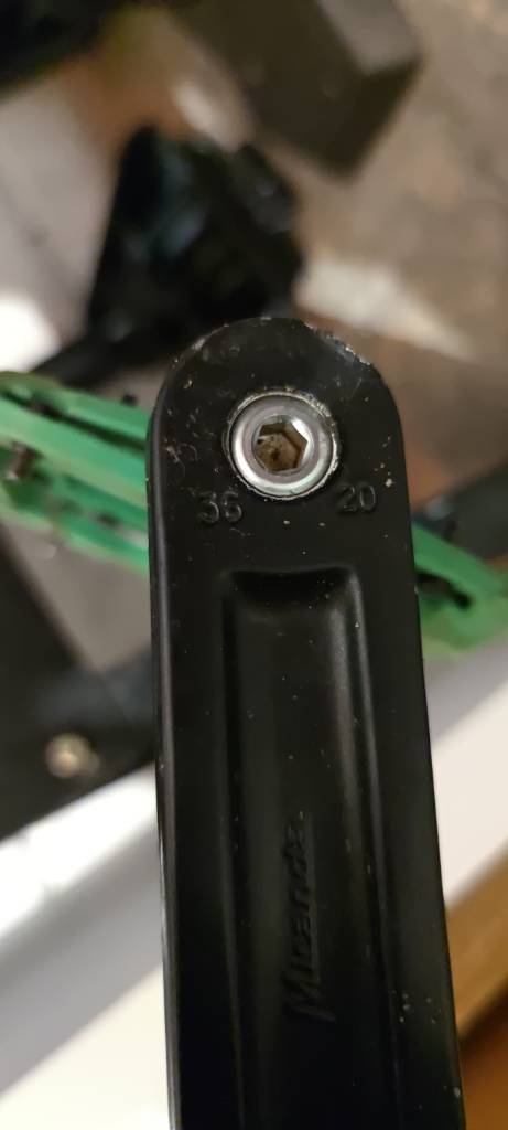

So after convincing myself that the multitude of strikes i HAVE had would not be in the force levels to do such damage i decided to investigate the arms a little !
Like 99% of the parts on my Haibike its like finding a needle in 1000 haystacks for information, so took them off hoping to find some kind of part number etc but Nope, all i can find is the brand ( Miranda ) and some numbers ( i can only assume some kind of sizing ) which are different on left and right !!
right shows 32 20
left shows 36 20
now if the 32 / 36 is some kind of offset / Q factor sizings then that explains why left gap ( 36 ) is more than right gap ( 32 ).
So at the moment im a bit lost again as what to buy as my head is confuddled again with isis,jsi,square,diamond etc etc
i have determined they are 170mm and thats about it.

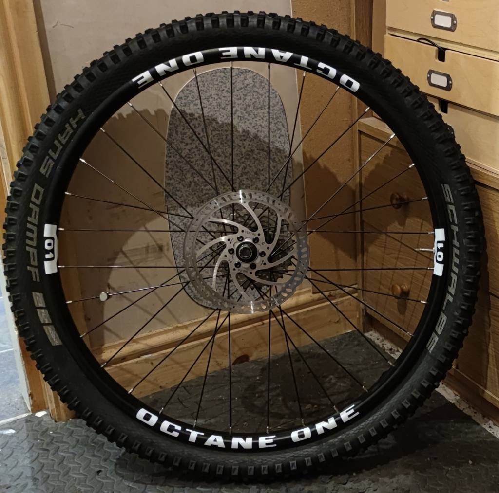

So..... i reckon i can do this !!
as my rear rim is dented / damaged ( ive ridden it and its fine atm ) ive been looking at the cost of rear wheels WTF !!
i then noticed just a few rims popping up at a considerable fraction of the price, looking at some videos etc it looks pretty straight forward to just swap my current hub and spokes over to a new ( improved ) rim.
So my current is a 32 hole 27.5 25mm rim and was thinking this might just be the opportunity to go 30mm rim and just switch the hub and spokes over to a brand new rim, so as long as i get a 27.5 32 hole rim it should be straight forward yes ?
i will tru the wheel the best i can and if unable i can just get LBS to correct it.
This will be so much cheaper and rewarding i think but worried im missing something here as it seems way too cheaper than buying a full new wheel ! is it the prices of hubs and spokes that make up all that difference?
any advice / opinions welcomed on this
Regards
Update: Ordered 2 Mavic 30mm E-XM 430's to rebuild my wheels using the existing hubs and spokes will be a good experience to try and build my own wheels i think.

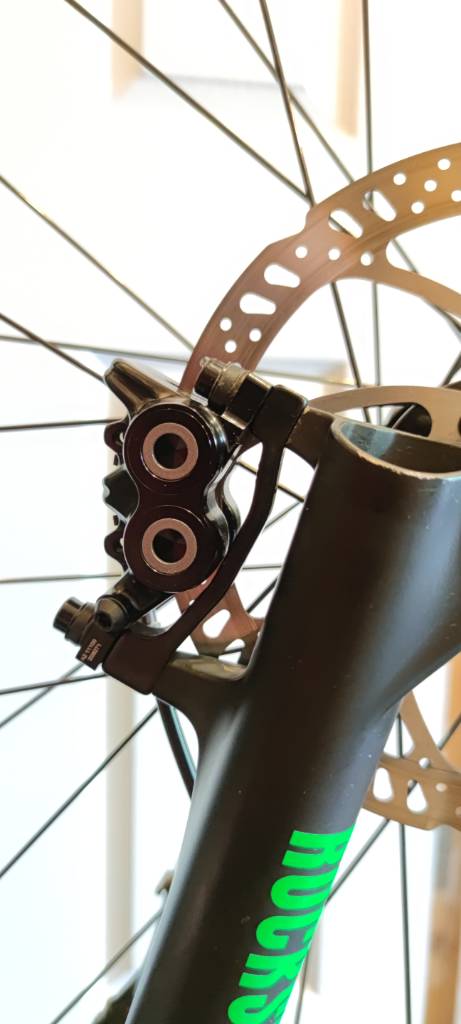

Upgrading my brake set to Magura MT5's.
My Tektro 2 pots are feeling very piss poor on the downhills and never actually provided me much confidence in stopping from day 1.
Hopefully the MT5 are an improvement !!
The MT7 pads are a useful upgrade, (Magura recommend the 8S pads for Ebikes), as the genuine ones come with 2 fixing bolts that mean you can change the pads in seconds without moving the calipers. Also someone's usually selling them cheap on eBay.

FML rims came so started setting up the transfer.... i must have been screen tired as i knew i needed 32H but somehow ive ordered mavic 28H.
After hours of trying to get the original rim back into a rideable state ive failed lol,
Now my back wheel ( the damaged one ) is 90% worse than it was and im unable to get it remotely trued.
Retailer has accepted a no cost return of the incompatible Mavics so at least there is one positive to take.
Im a muppet ffs.

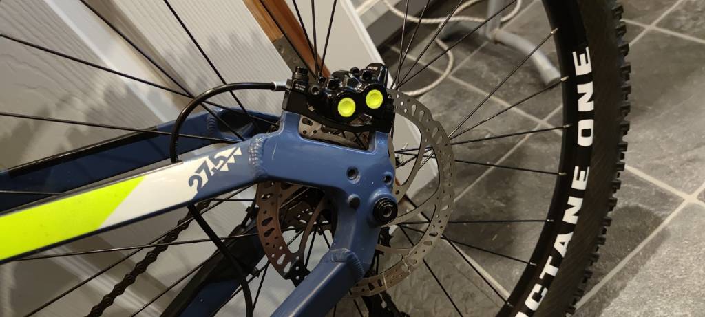

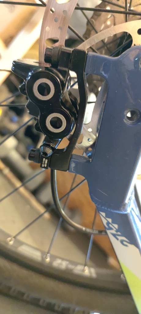

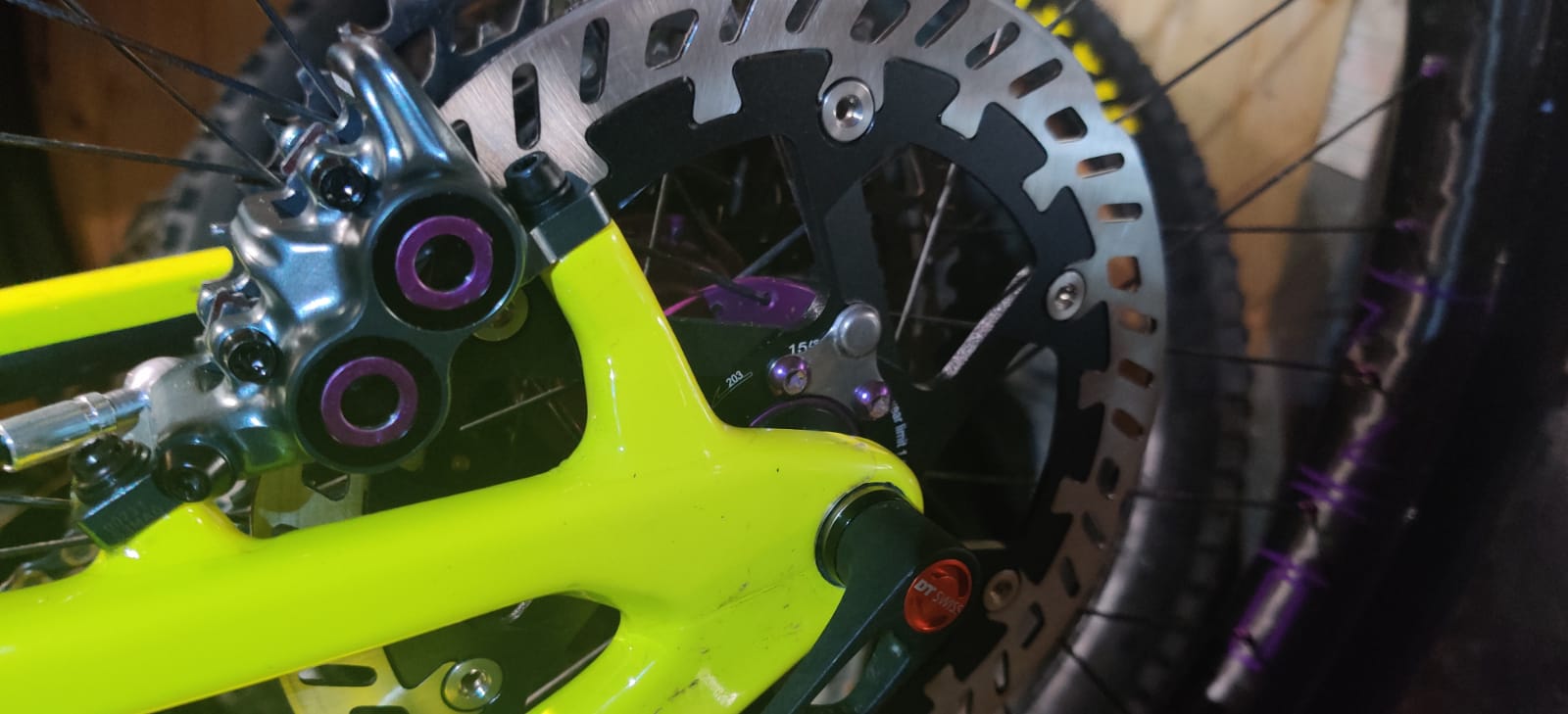

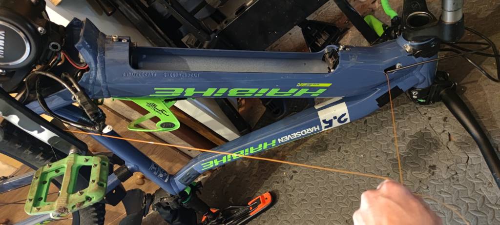

So prepping for the Magura has gone well, rear internal tektro brakes removed without cutting and fully functional still with the help of some electrical tape to seal the end whilst removing lol ( it worked ) and attaching some trimmer line to aid pulling the new magura hose through.
To be continued....
Slymobi
Mar 13, 2021
1,029
2,642
UK, Derbyshire

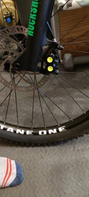

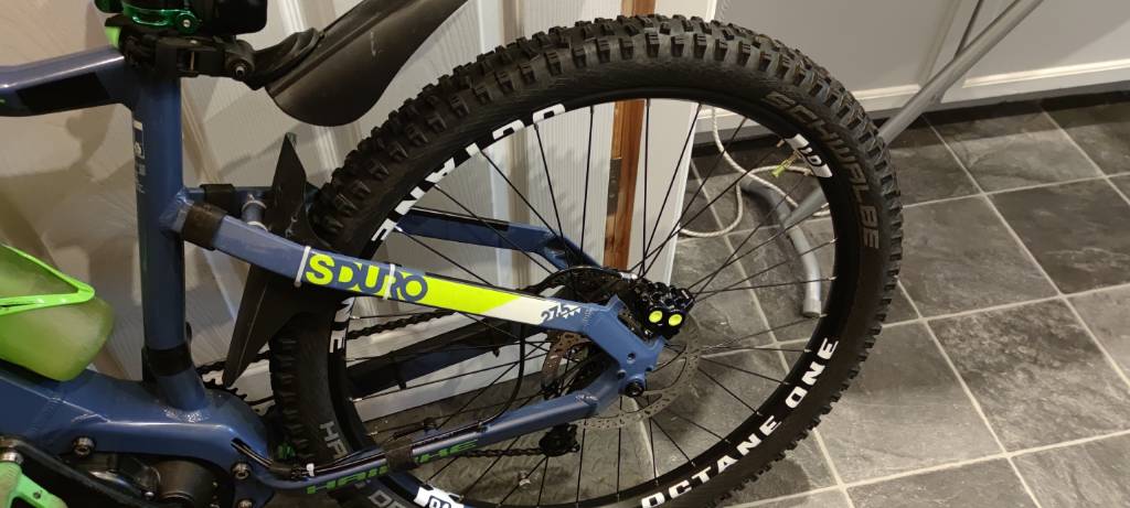

Arrived...
Fitted
I didnt even need the line to pull through frame, went through really easy

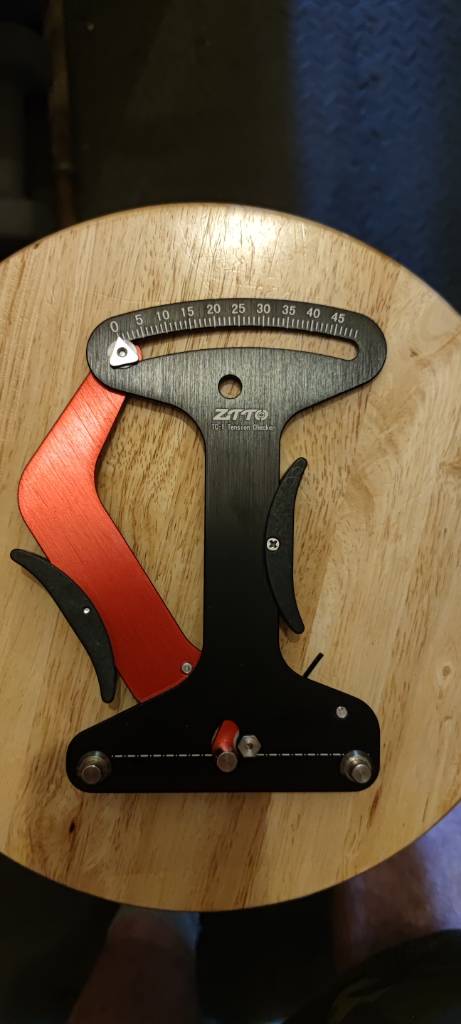

Got a spoke tension tool too
Good job too as my truing obviously needs work on as the tensions were so far out and miss matched.
used the tool and much better cross spoke even tensions now, left the wheel slightly more wobbly but that will be the buckle/dent and hopefully be able to swap over to new rims next week.

it looked almost perfect and i then banged the tyre, tannus and tube back on, inflated tyre and..... WOW i think i buckled my tyre lol !!
the wheel now looks terrible on rotation as though its so out of tru it never was
i know the actual wheel is damn near perfect so gonna just leave it at that and hope after a ride it balances out.
is it normal for this to occur ?
( Will do the front as and when time permits ).
Regards
Slymobi
Mar 13, 2021
1,029
2,642
UK, Derbyshire
Nearly ready, just having a few issues with bead not popping into rim sidewalls. Going to try the soapy water and extra tyre pressure trick.
Update: Supplied with rim ( tape ) is quite wide and noticed some parts had scrunched under the beading so corrected the tape and then used some good old fairy liquid ( watered down into soapy water ) and spread it in the rim against both innerwall of rim, rim tape and actual tyre beading. inflated to +5 psi above MAX recommend and heard that most satisfactory popping of seating. Checked the tyre guide line ( not sure this is an official thing but there is a line around the circumference just outside of rim where the bead sits below !! ) all around and its pretty much equal. deflated to desired psi and its looking 95% better on spinning.
im happy its as correct as i can get it now along with pretty near perfect tru.
slymobi's law its just started pissing it down but will get out for a tender test ride in the morning
