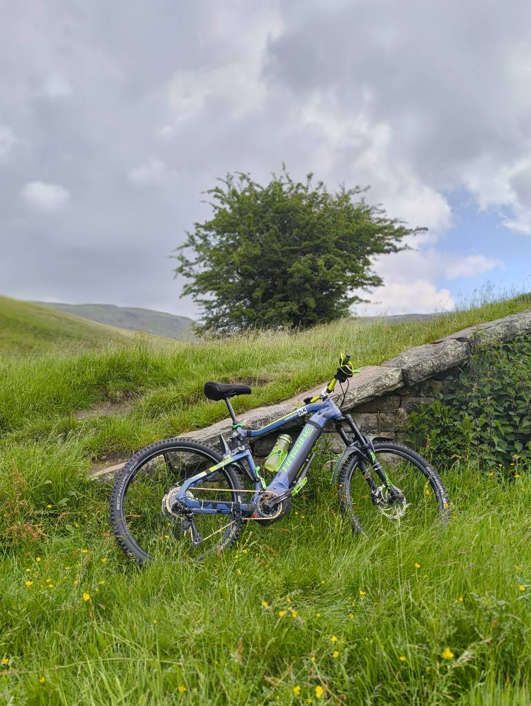

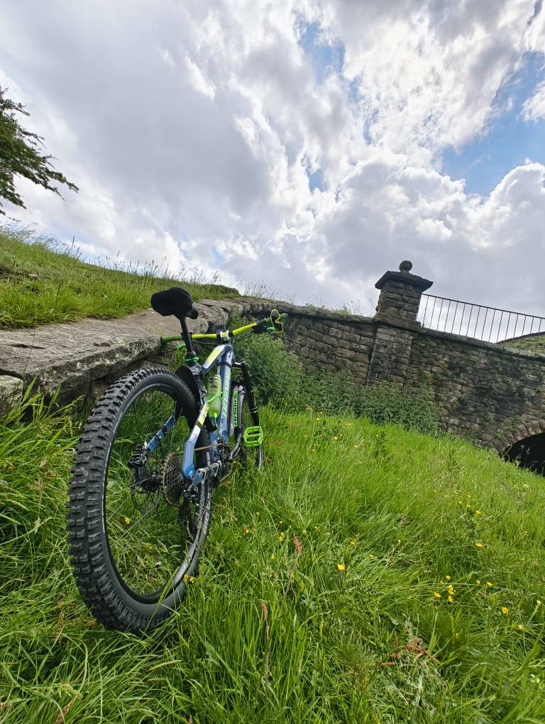

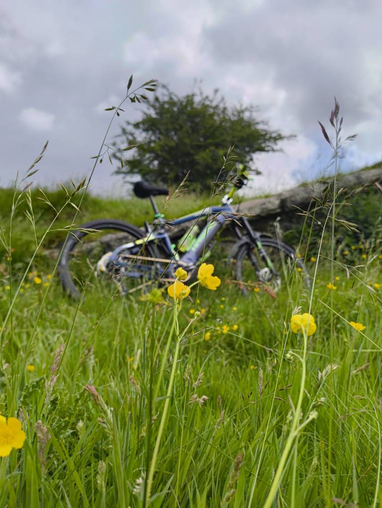

Longest ride out in a long time for both the beast and myself Solid 15 miles putting us both through some heavy climbs and stress tests glad to report the motor survived without issues so can probably tick the cut outs off the issue list now. Here's some of the fun bits from today's ride.

Had a few good solid rides out now and the beast is back. Massive respect and thanks to @Bearing Man
The motor had a full overhaul and PCB replacement and is running like new wasn't expecting the odo to be reset but makes sense after a full service and replacements
I am in the process of getting a new bike but will most likely be keeping the beast as a spare, winter, future hand me down bike.
Been a blast lots of ups and downs and plenty of learning experience ready for my first full suspension.....

Paying homage to a Hardtail beast that gave me so much fun, I think out of of all my footage this does it justice nearly I need to get back out on the beast soon even if it's just for nostalgia but wow.. I had so much fun on the beast which I will never forget
