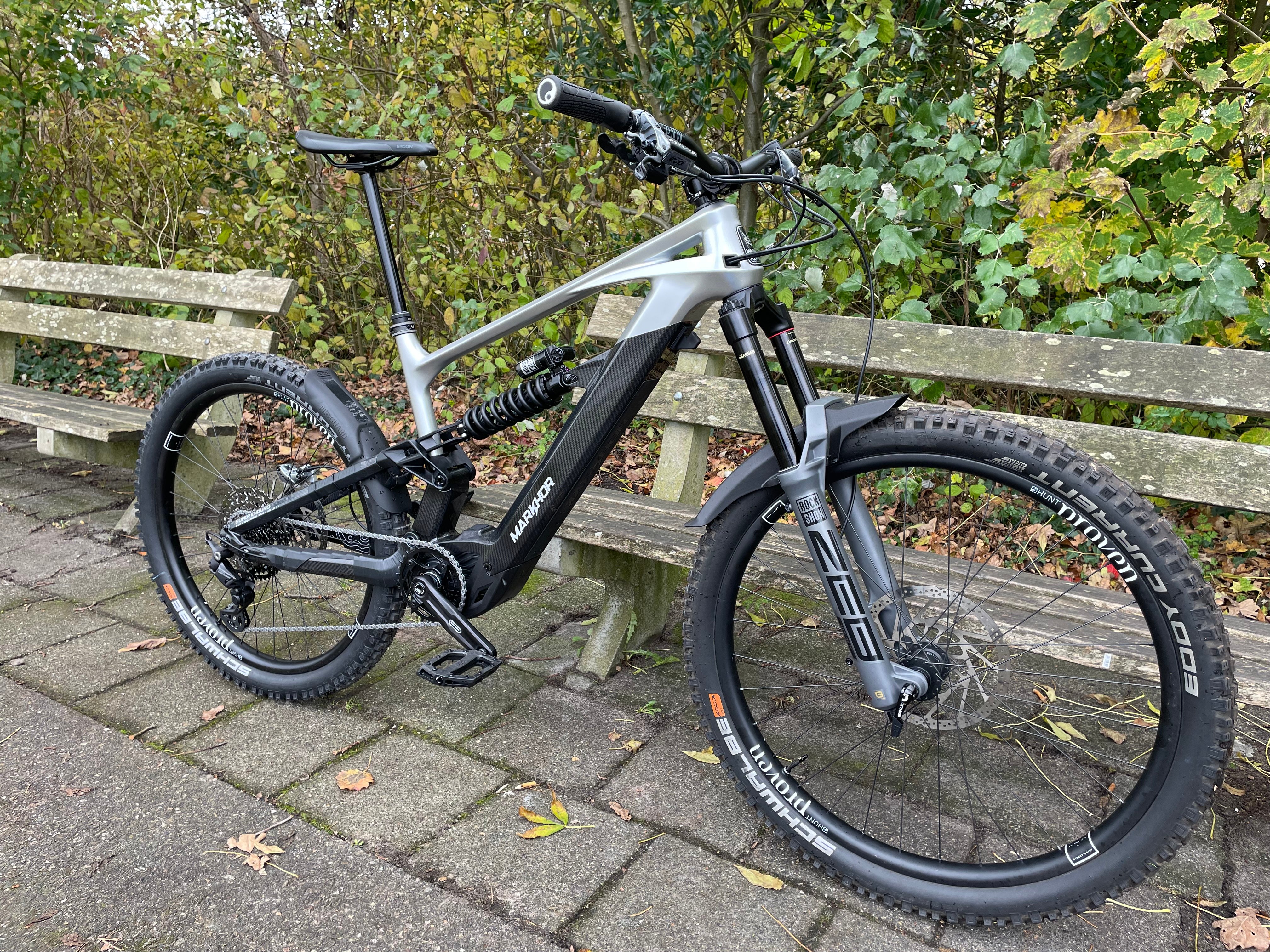

it has been finished!
more pics on page 2

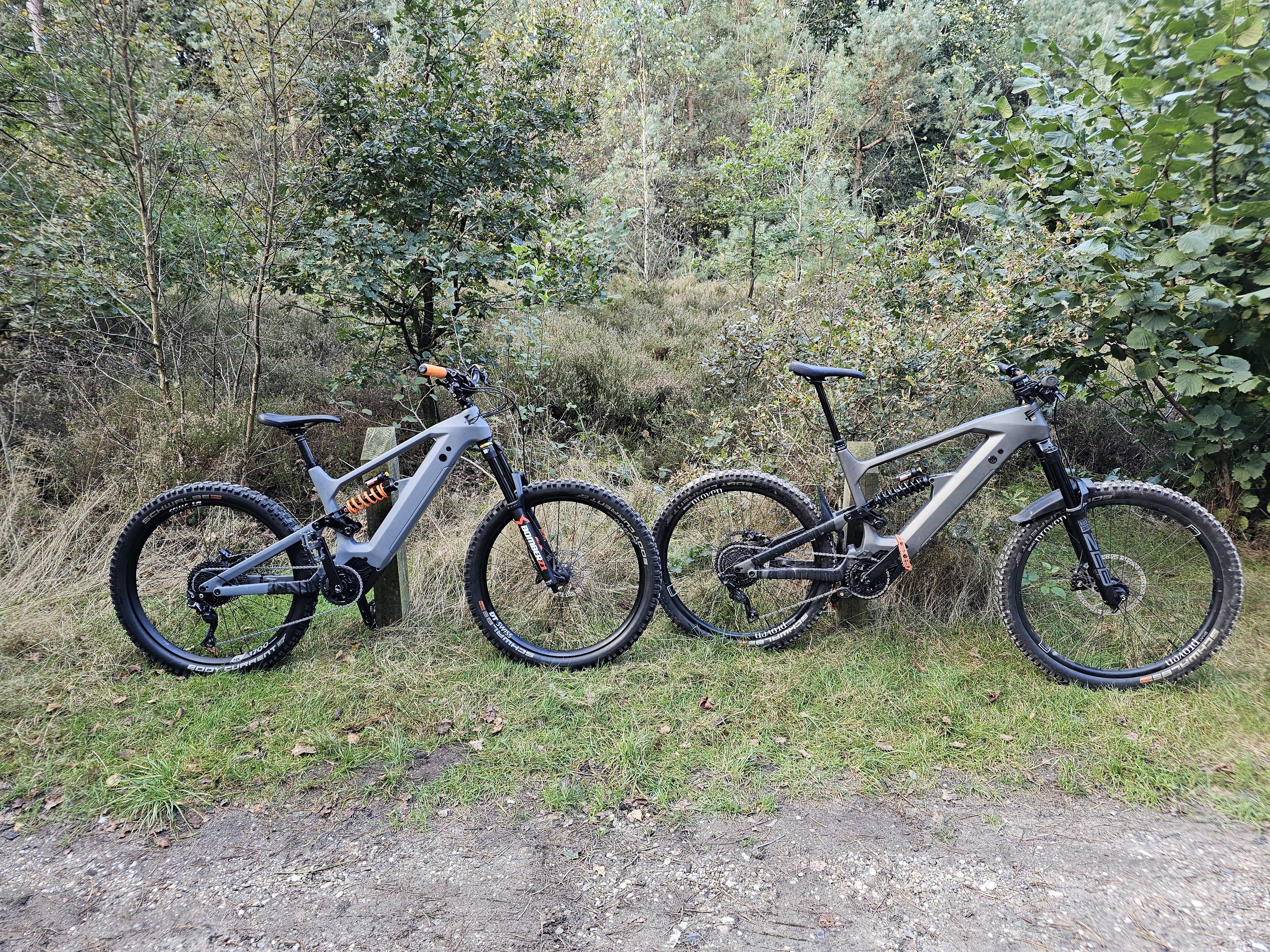

my previous bikes as i'm no stranger to diy builds💪
first one tsd2 converted hardtail
second one was a Lightcarbon lces004
150mm rear and 170mm front
27.5x2.8 bafang m600 600wh
my third one
Dengfu E14 hardtail with m510 and 840wh weighing only 20.6kg.
very fun as a gravel bike and light trail bike.

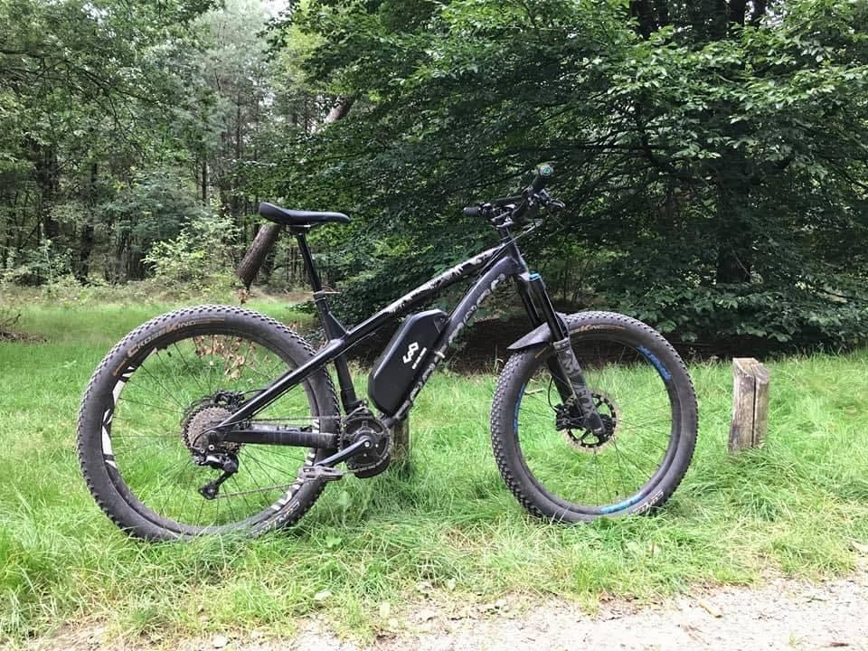

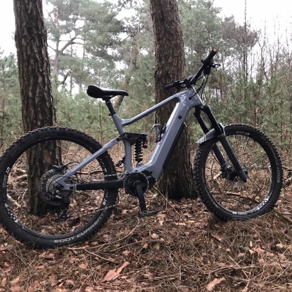

my current bike
E10 with 170 rear (yoke modded and offset bush) and 160mm front
m510 840wh
this will get a rebuild to a more trail oriented spec with a full 29" setup and slightly less agressive tires.
left one full marzocchi spec, with bomber cr 170 rear and 170 front Z1 27x2.8 , Right one is mine as a mullet and 160front.
so all nice bikes, some changed over the years.

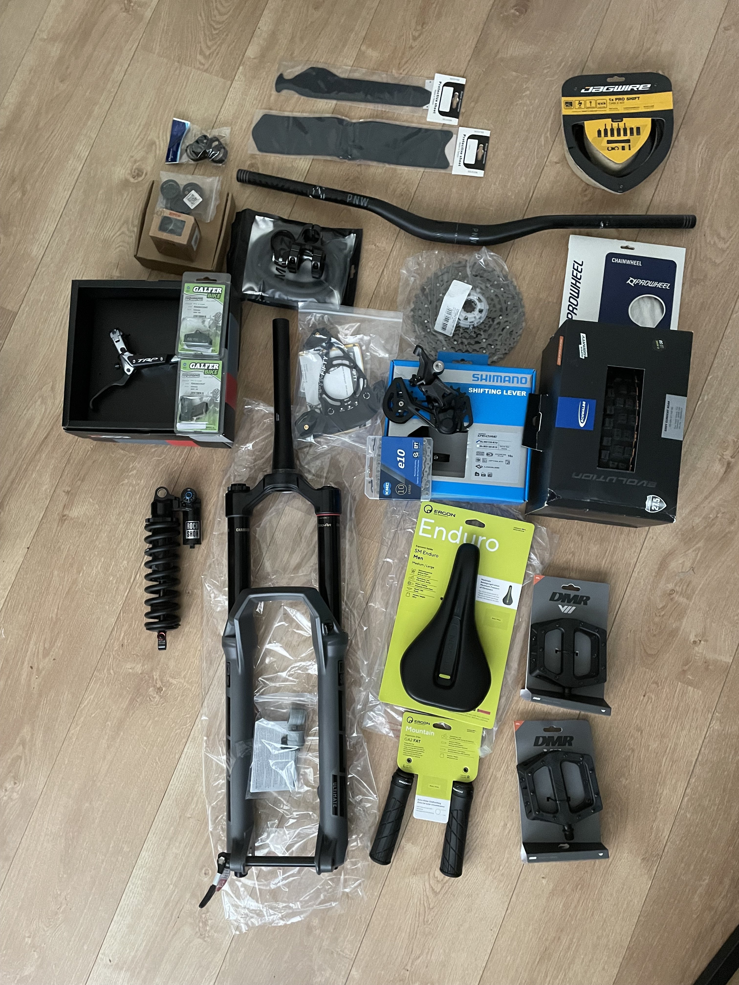

planned parts for this build;
Mullet, 190f/195r
Big burly Enduro bike
Markhor Kunlun frame S3
+ Bafang M510 - 720wh 48V Bafang battery 21700 cells, 36T steel Narrow wide chainring, 1T1 canbus cable, 165mm cranks and brakedisc speed magnet
Suspension
+ Rockshox ZEB 190 29" ultimate 44mm offset charger 3.1
+ Rockshox ultimate DH 250x75 with steel shaft and 500lbs coil
+ Oneup dropper V2 240mm with Ergon Enduro saddle and Markhor seatclamp
Cockpit
+ PNW Range Alu bars 780mm
+ Title 35mm stem and Ergon grips
+ ZTTo dropper lever
+ ZTTo headset and spacers
Drivetrain
+ Shimano M5130 linkglide ebike drivetrain with KMC e10 ept chain
+ ISCG05 DH tensioner
Brakes
+ TRP DH-R evo brakes
+ Galfer pro green pads
+ TRP +20mm brake adapters F/R
+ TRP 2.3 220mm rotors
Wheels
+ Hunt Proven carbon EMTB mullet 31mm 36spokes HG
+ Schwalbe eddy current gravity 2.6 rear, eddy current supertrail 29x2.6 front and Rockshox torque caps
+ CushCore Pro tire inserts Mullet
Sound proofing
+ Rubber chainstay protector Ali
+ Rubber downtube protector
+ foam damper around all hoses and wires
i like my bikes - Silent

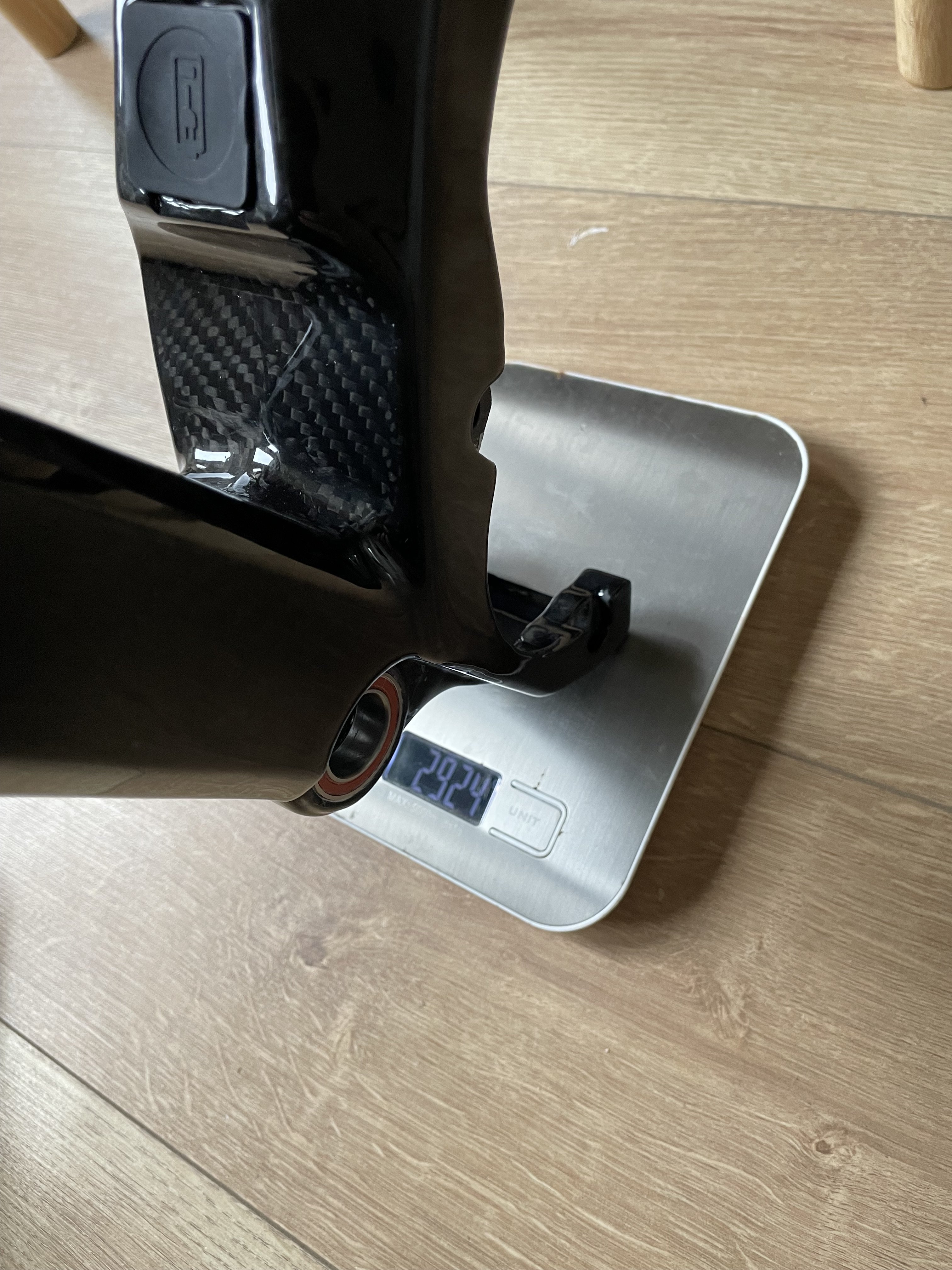

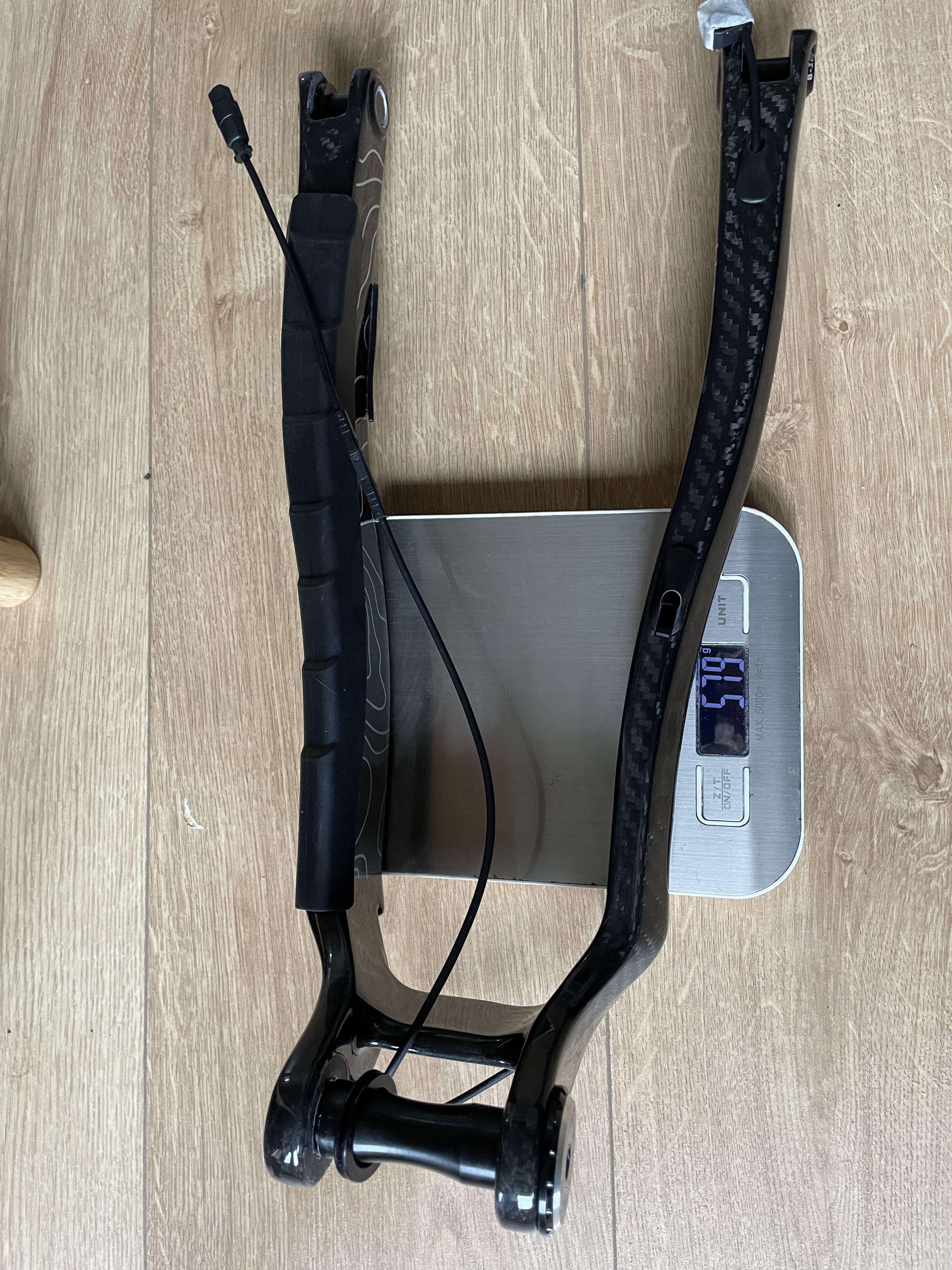

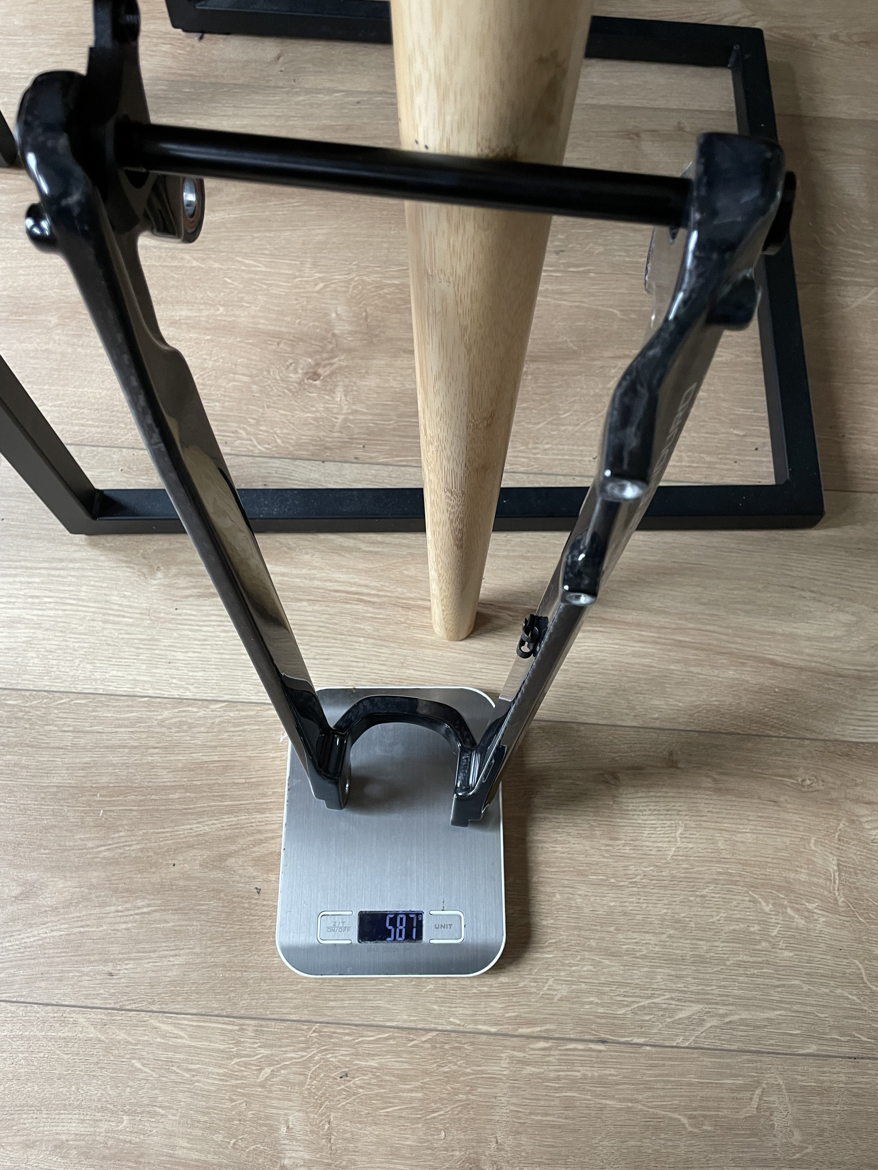

Please send a link to the supplier's frame. Have you weighed the frame, how much does it weigh?
kaaskopf
Oct 11, 2024
95
98
Berlin

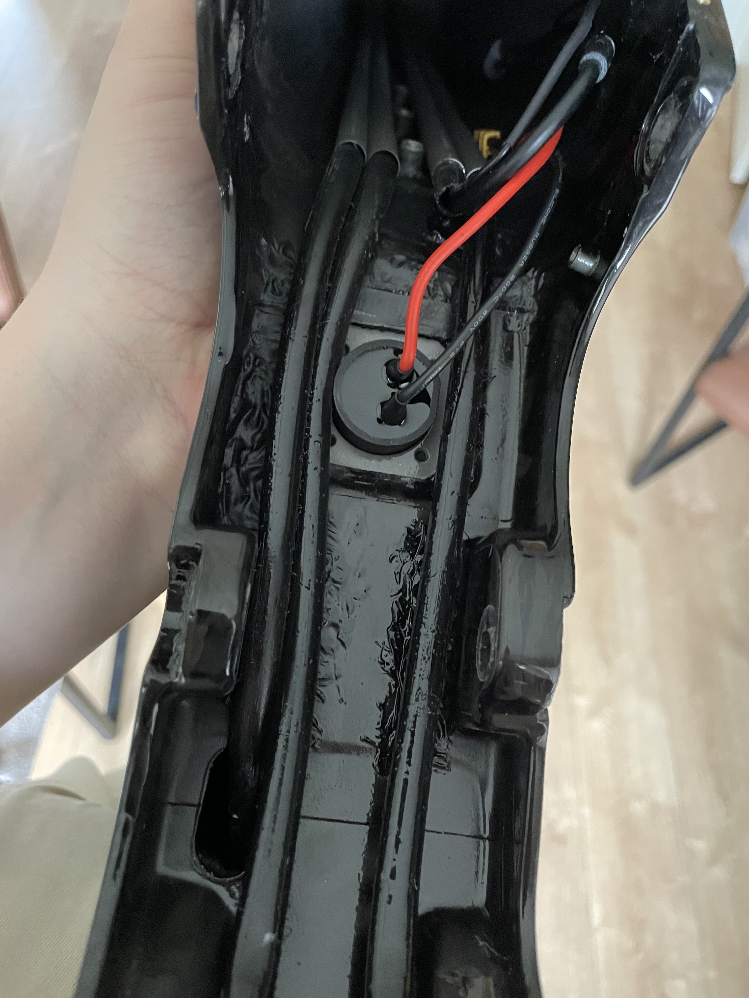

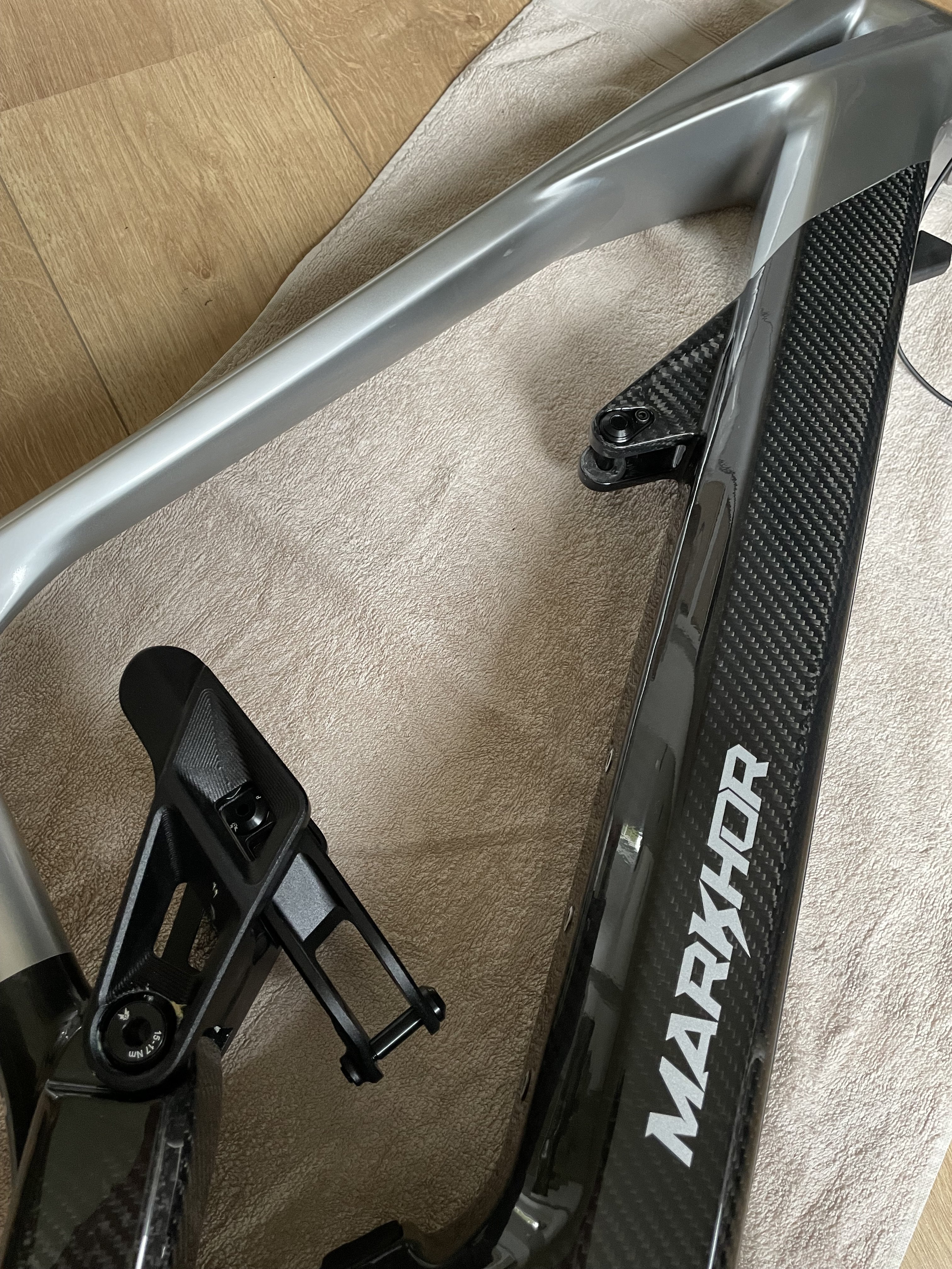

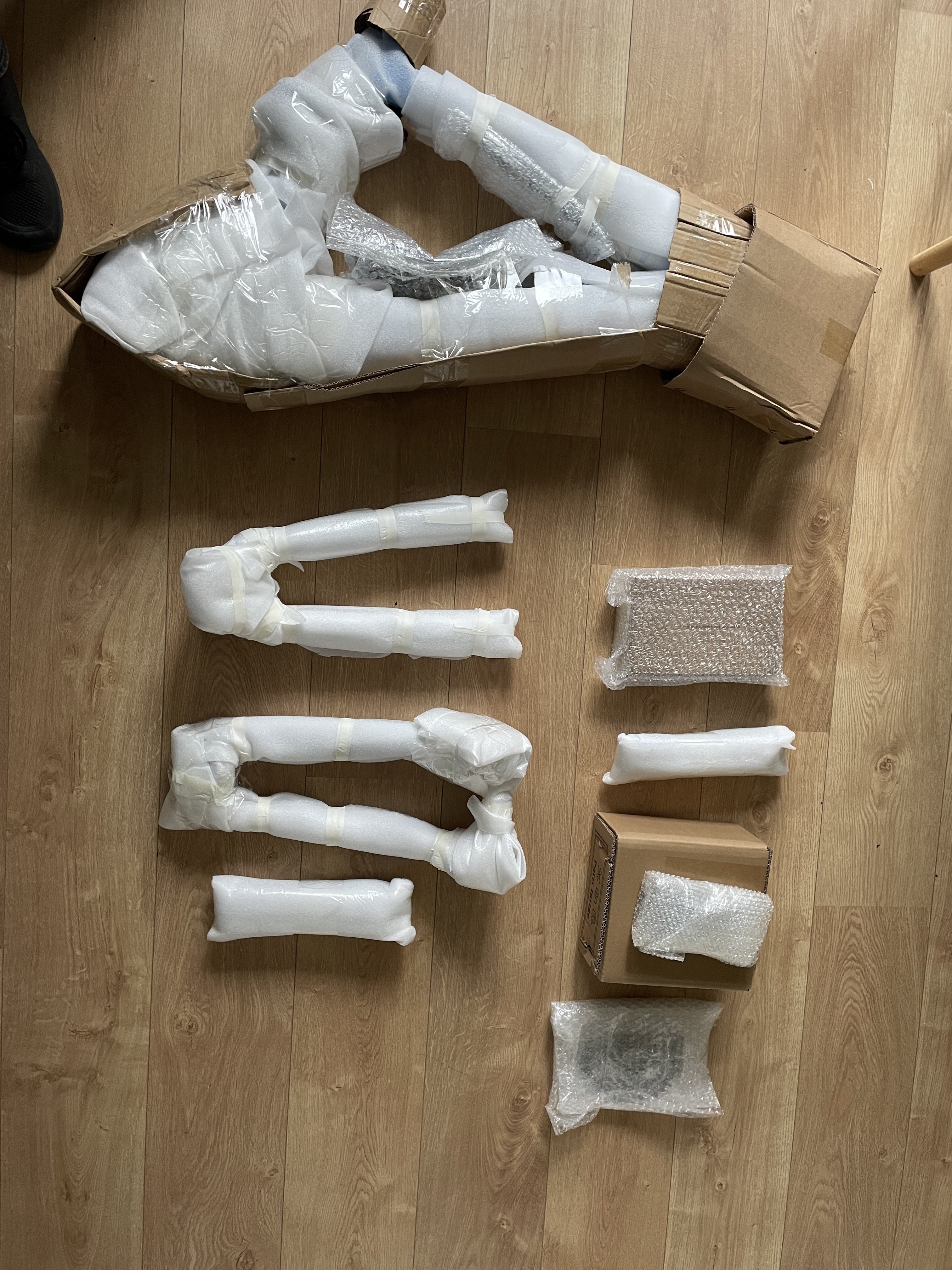

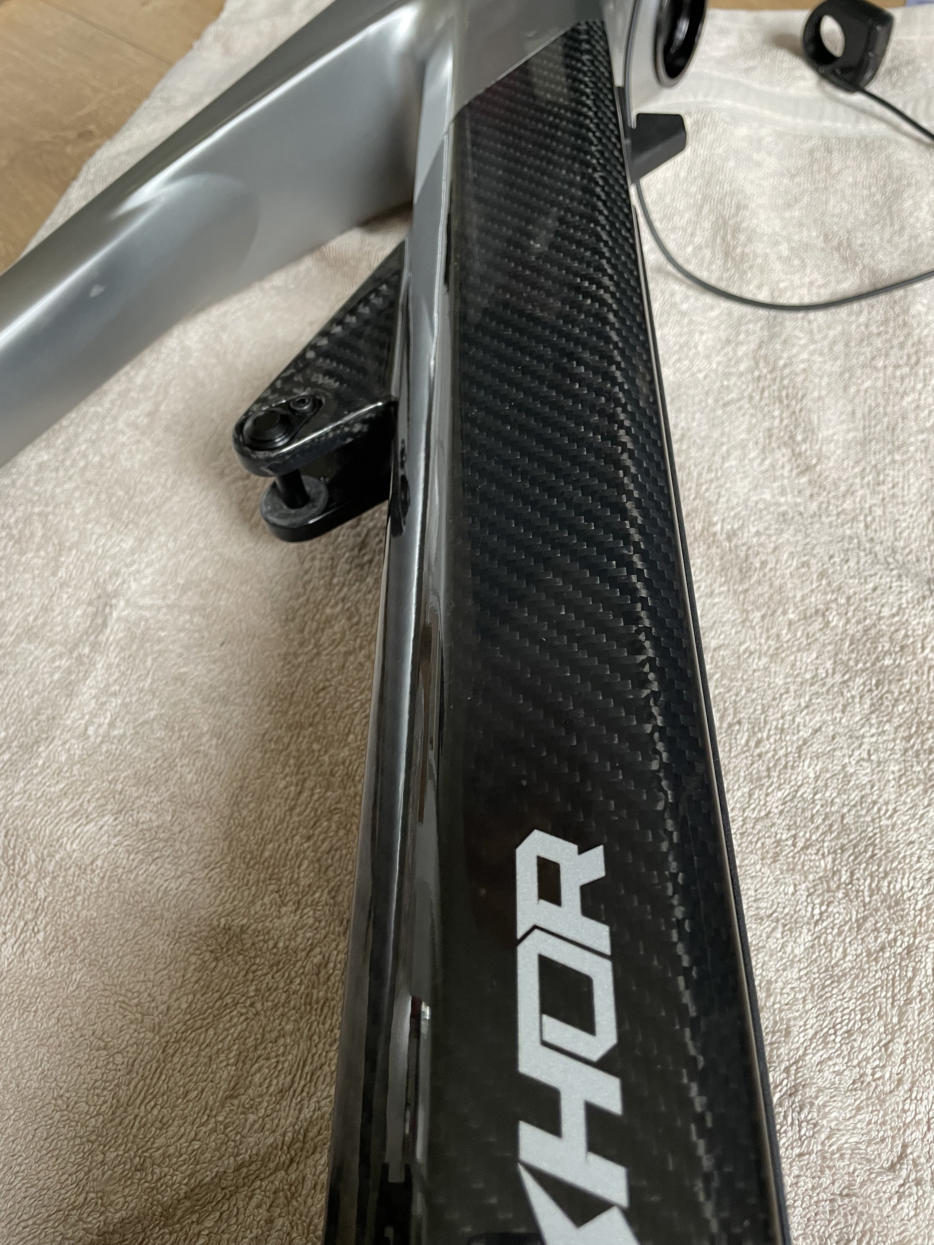

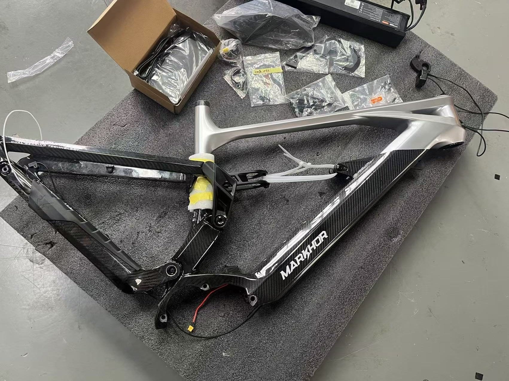

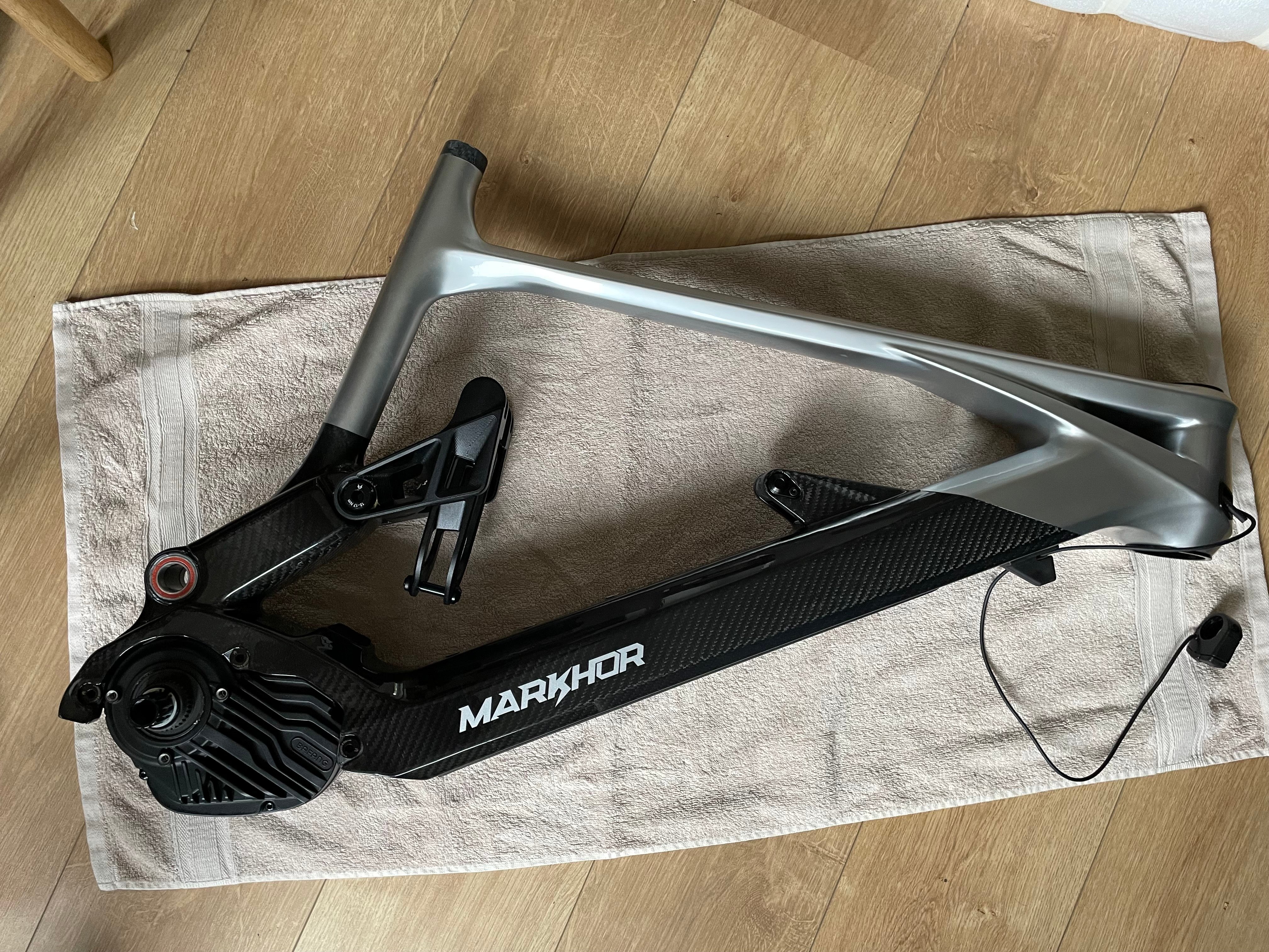

frame ready for shipping :)

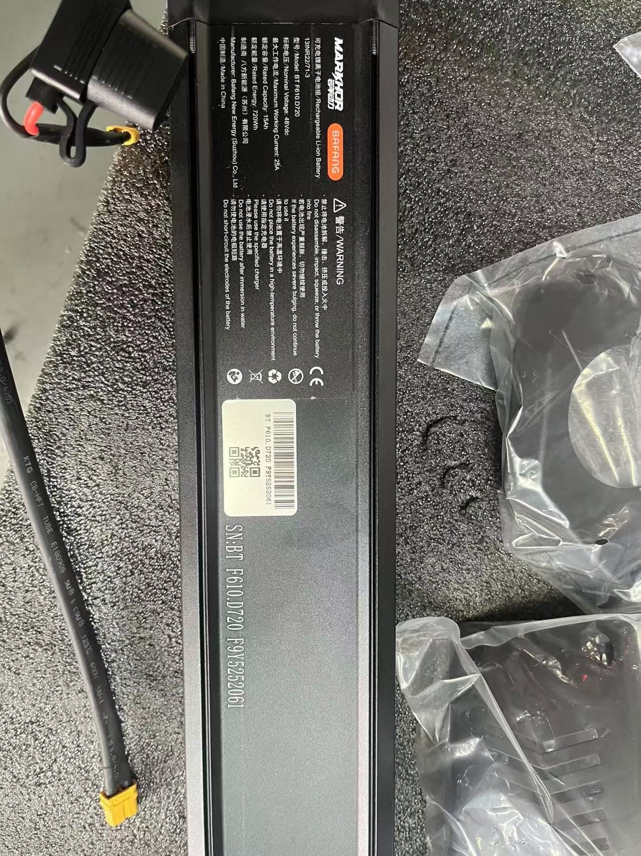

no motor as i already have a m510
battery looks like a bafang made

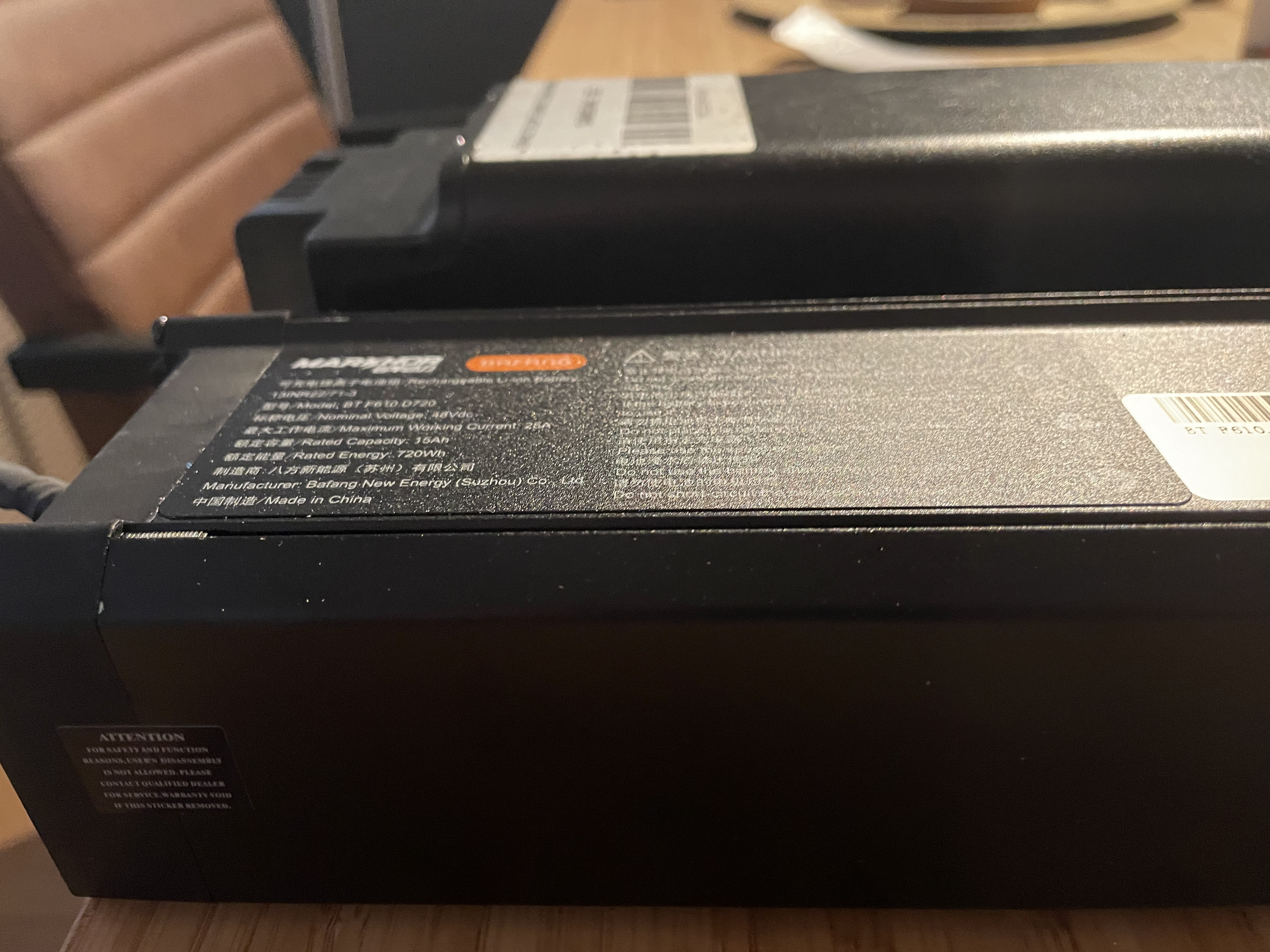

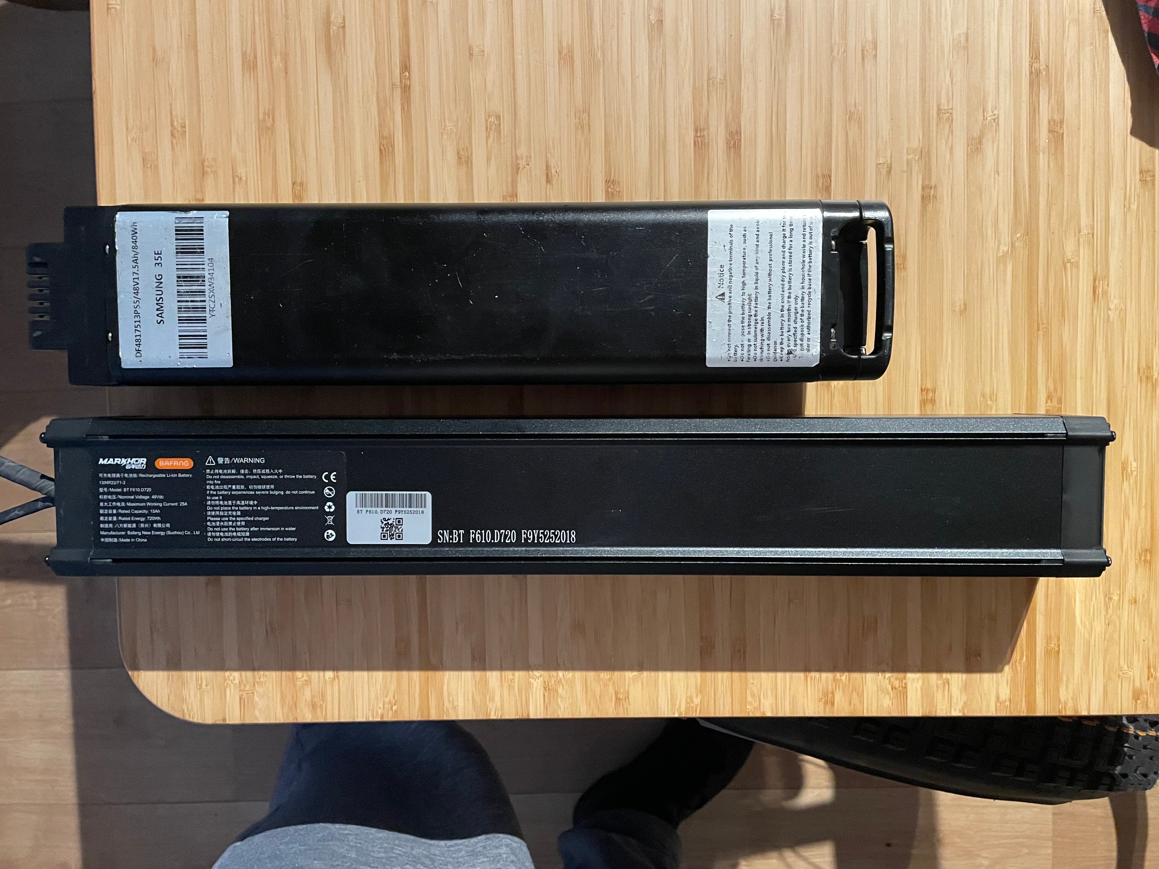

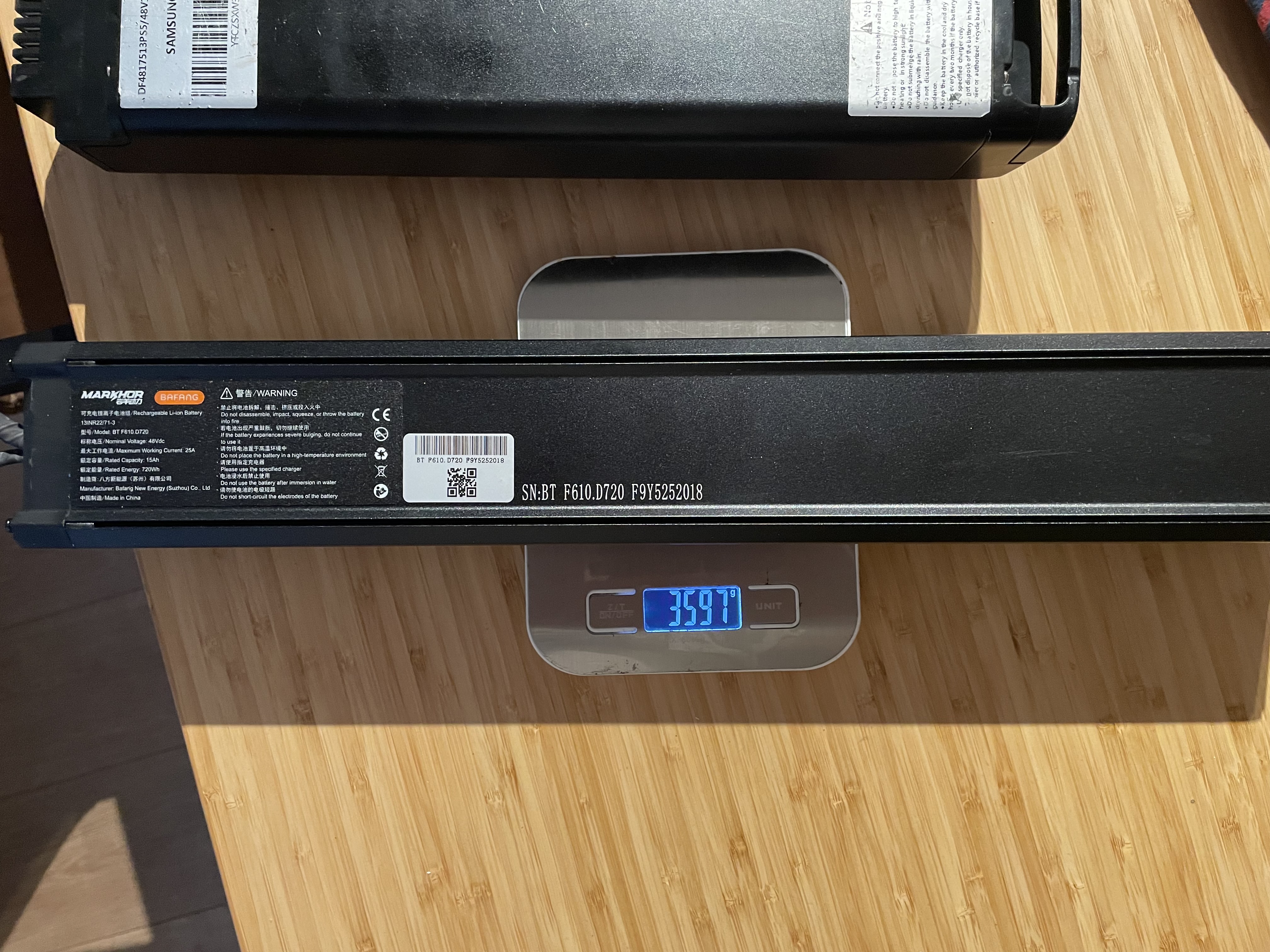

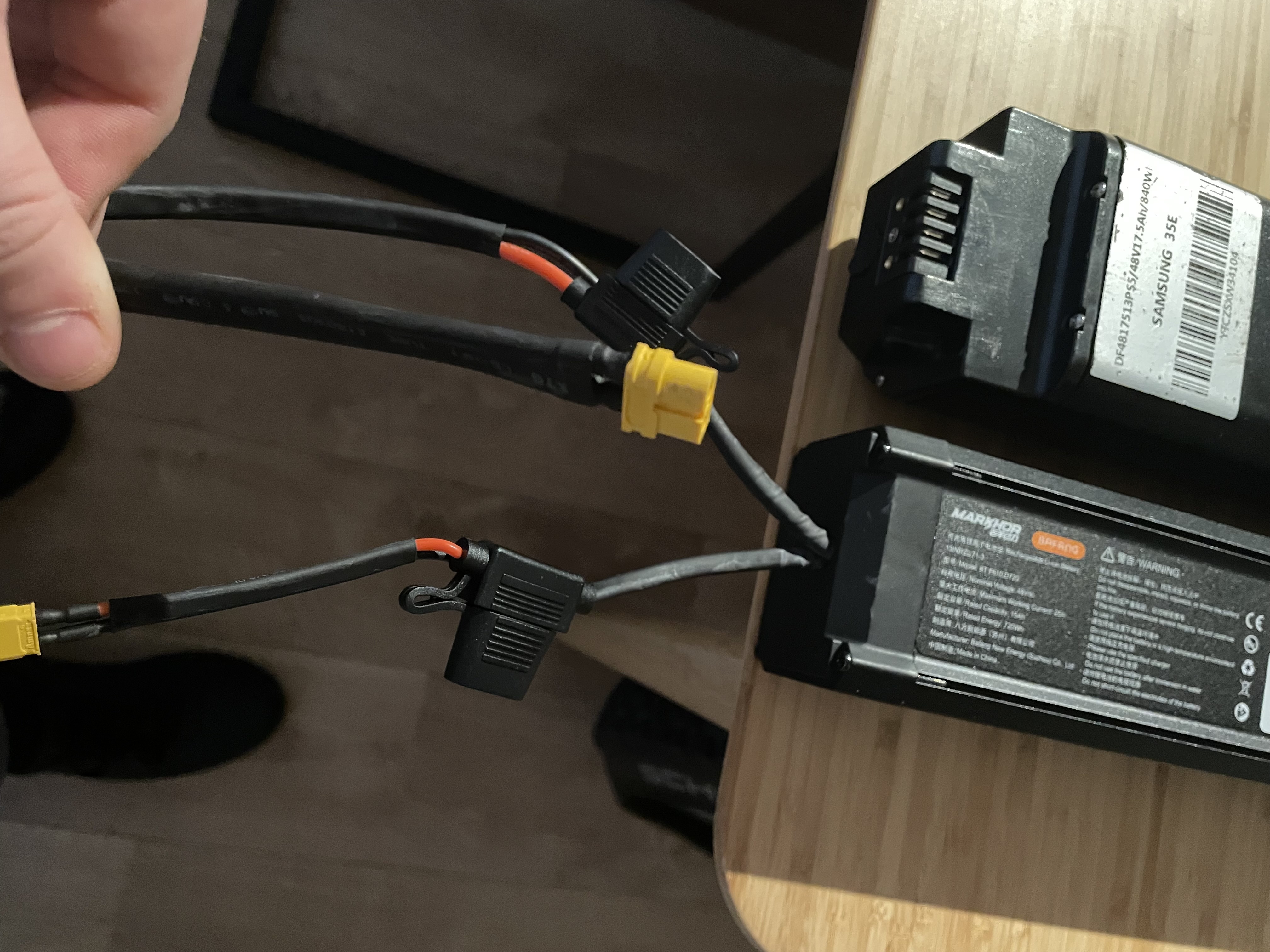

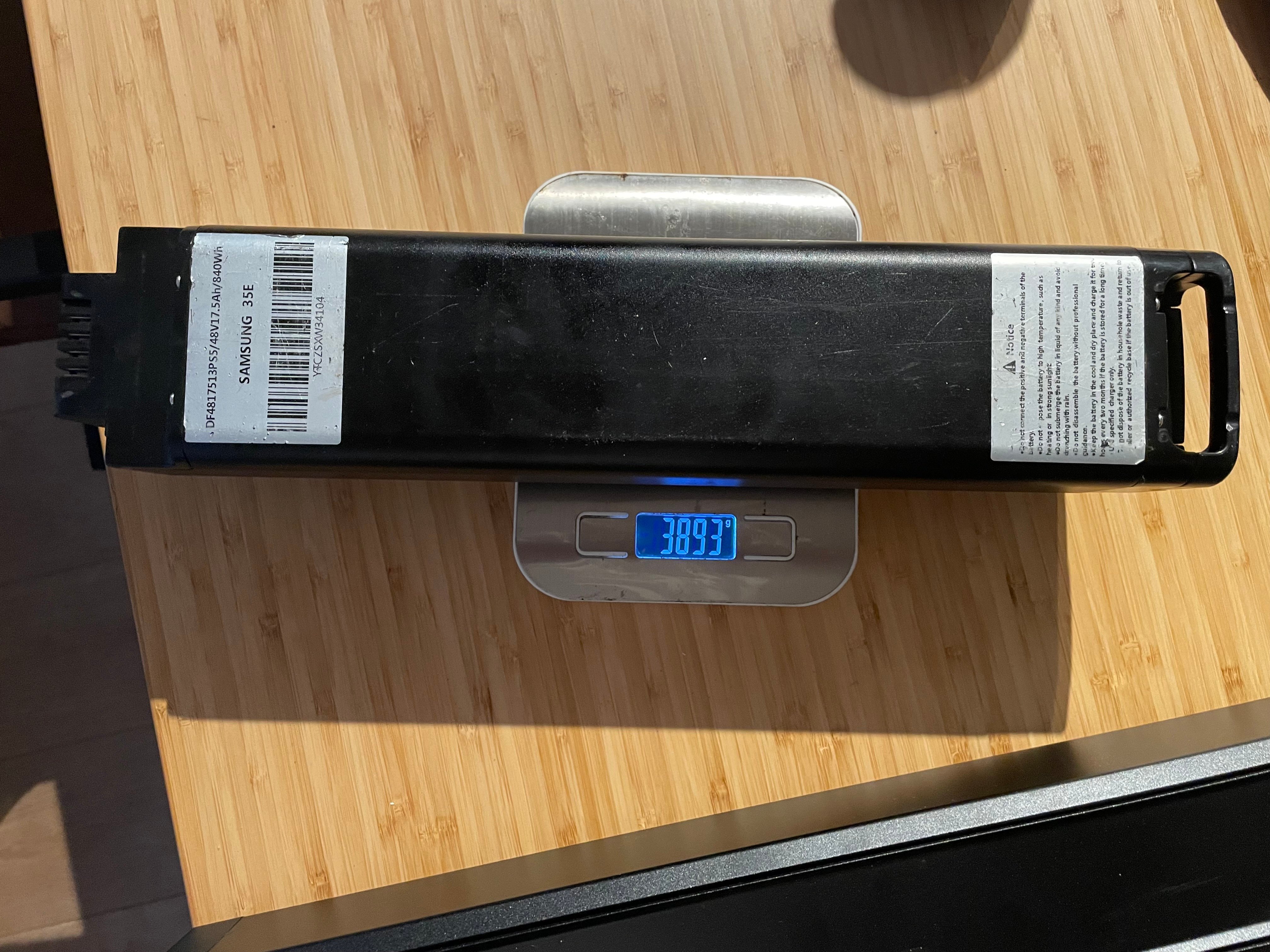

so 4 weeks after payment battery did arrive
compared to e10 840wh
build quality looks decent. build by bafang so should be fine
maybe it comes with overprotecting bms like other bafang batteries i used.
it has 2 external 'car' fuse holders . xt30 on the charger side and xt60 on the power side

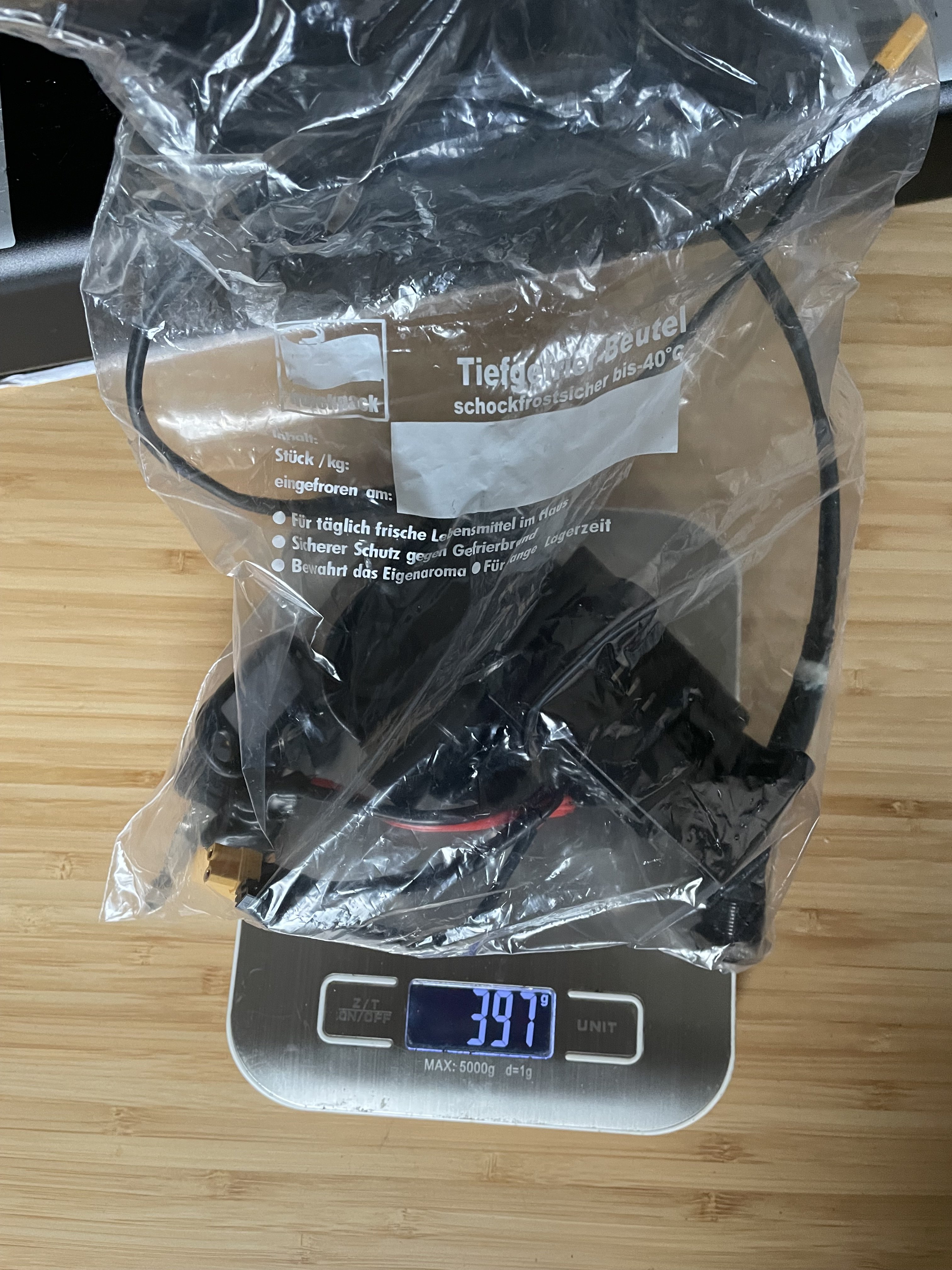

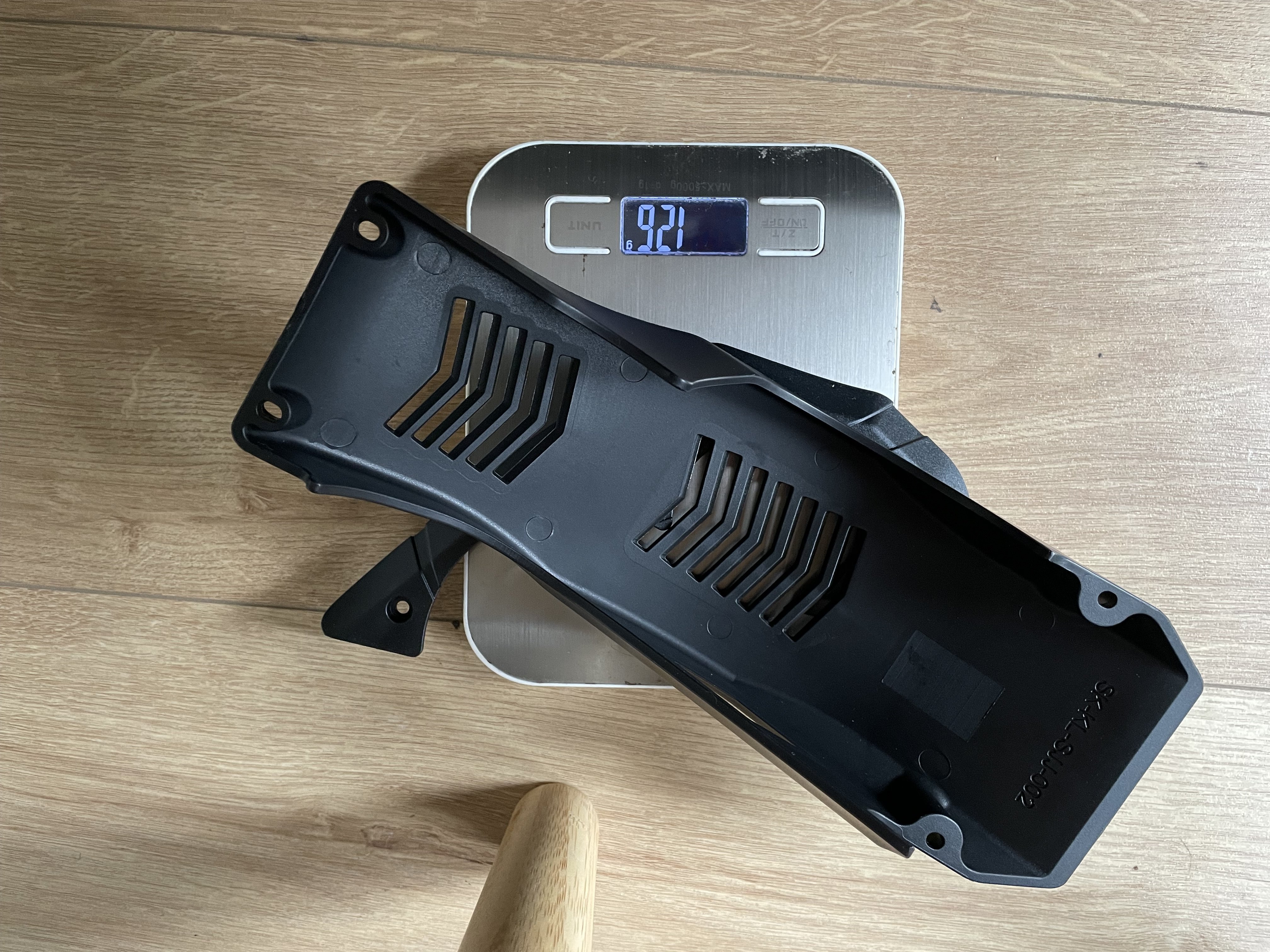

so the dengfu is 296 grams heavier.
but to be able to use it in the frame it needs these battery lock spacers + wiring
which i had an extra so i weigh them up at 397gr so the total difference between the 2 packs will be 693grams. (and 120wh).
I think that is a good weight savings so far... as the dengfu e10 battery was always to big for most rides.

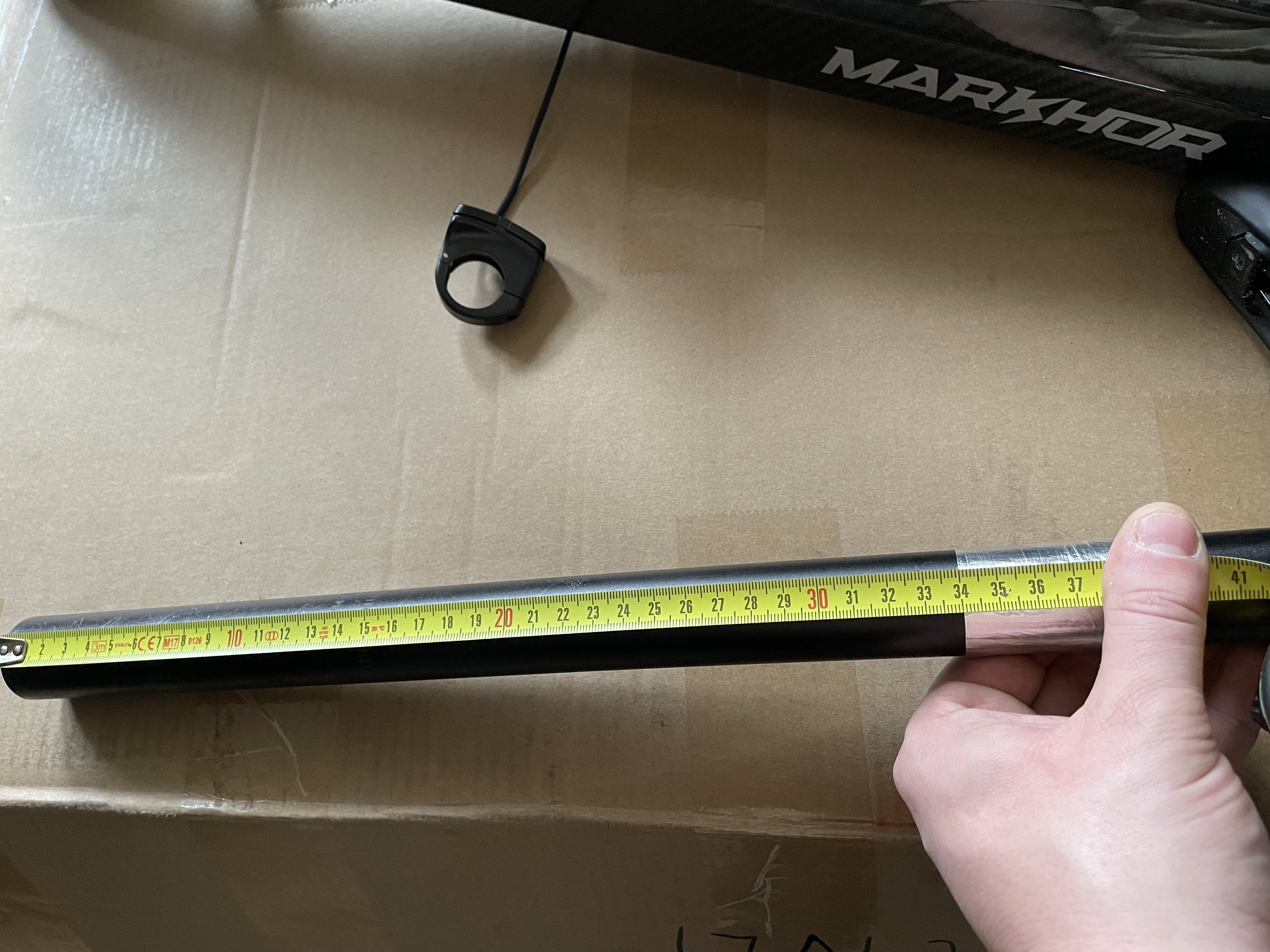

Markhor 720wh kunlun battery comes in at 3597grams and requires 4 m6 bolts

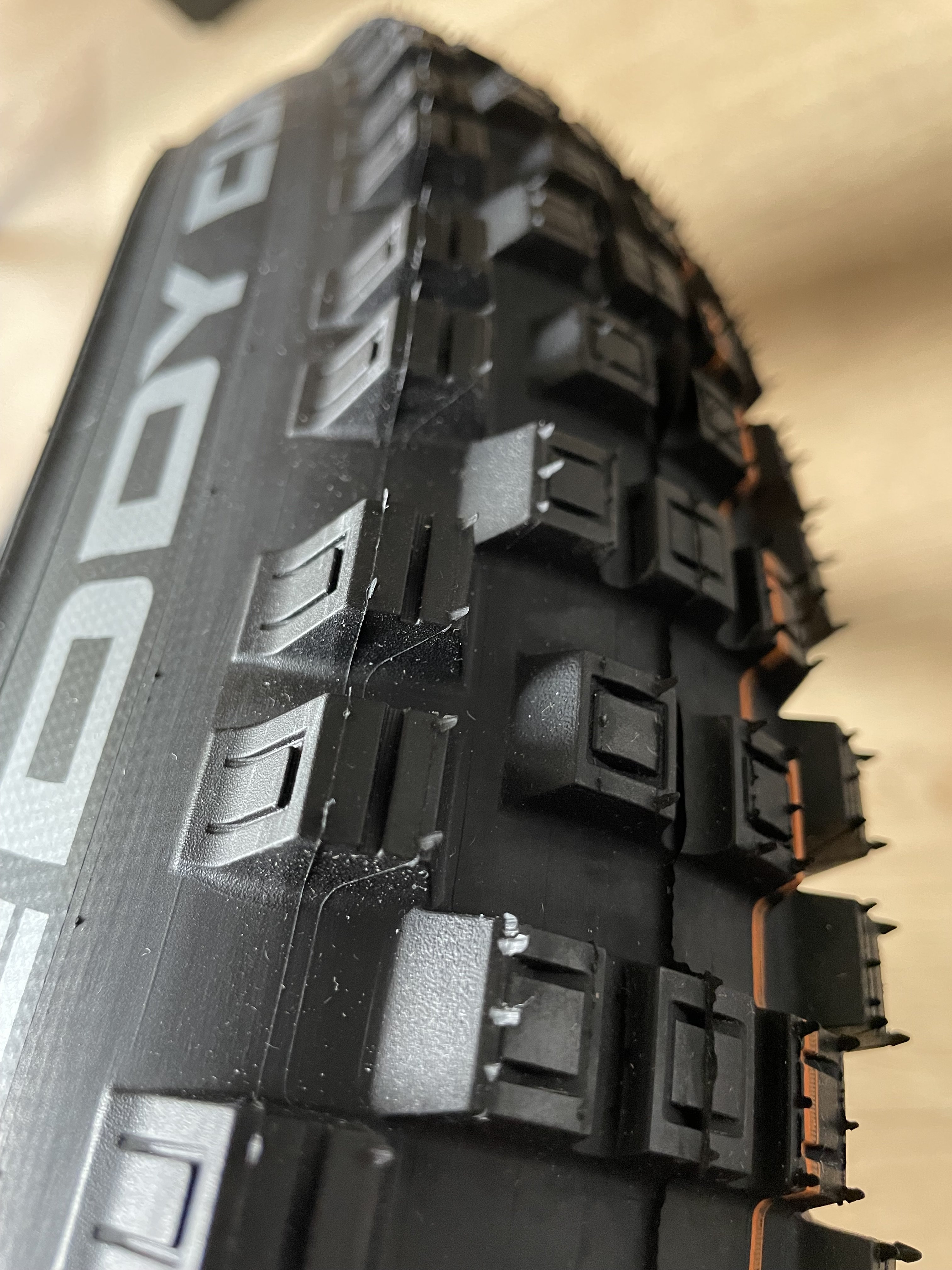

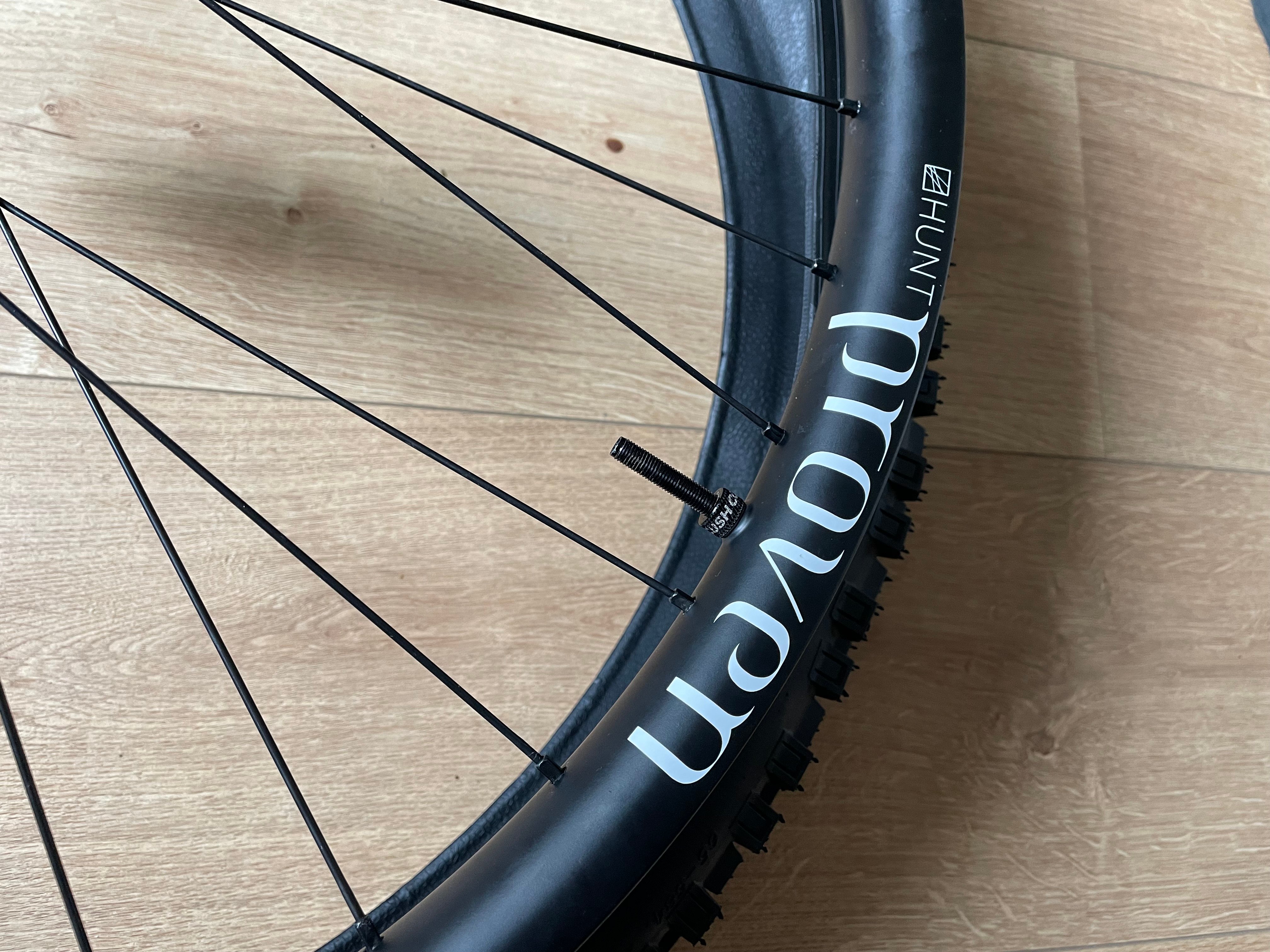

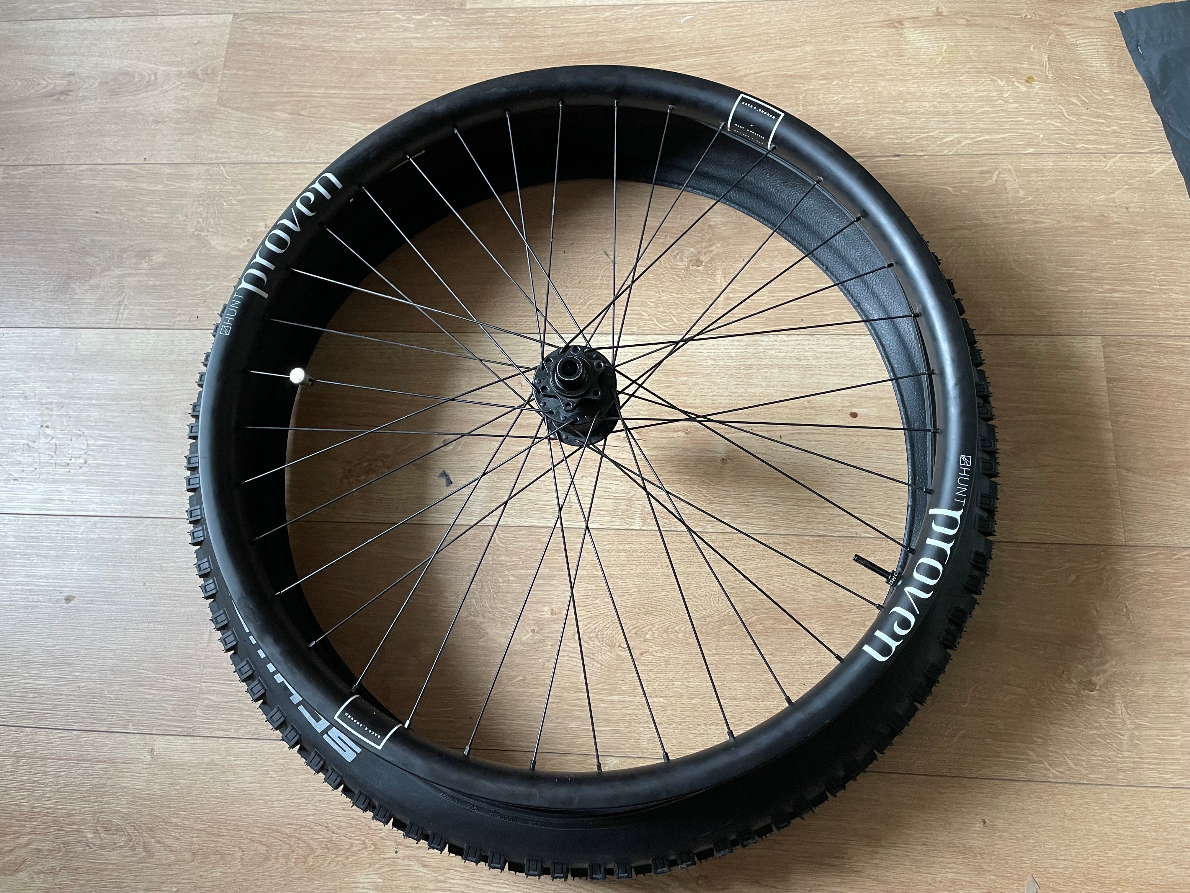

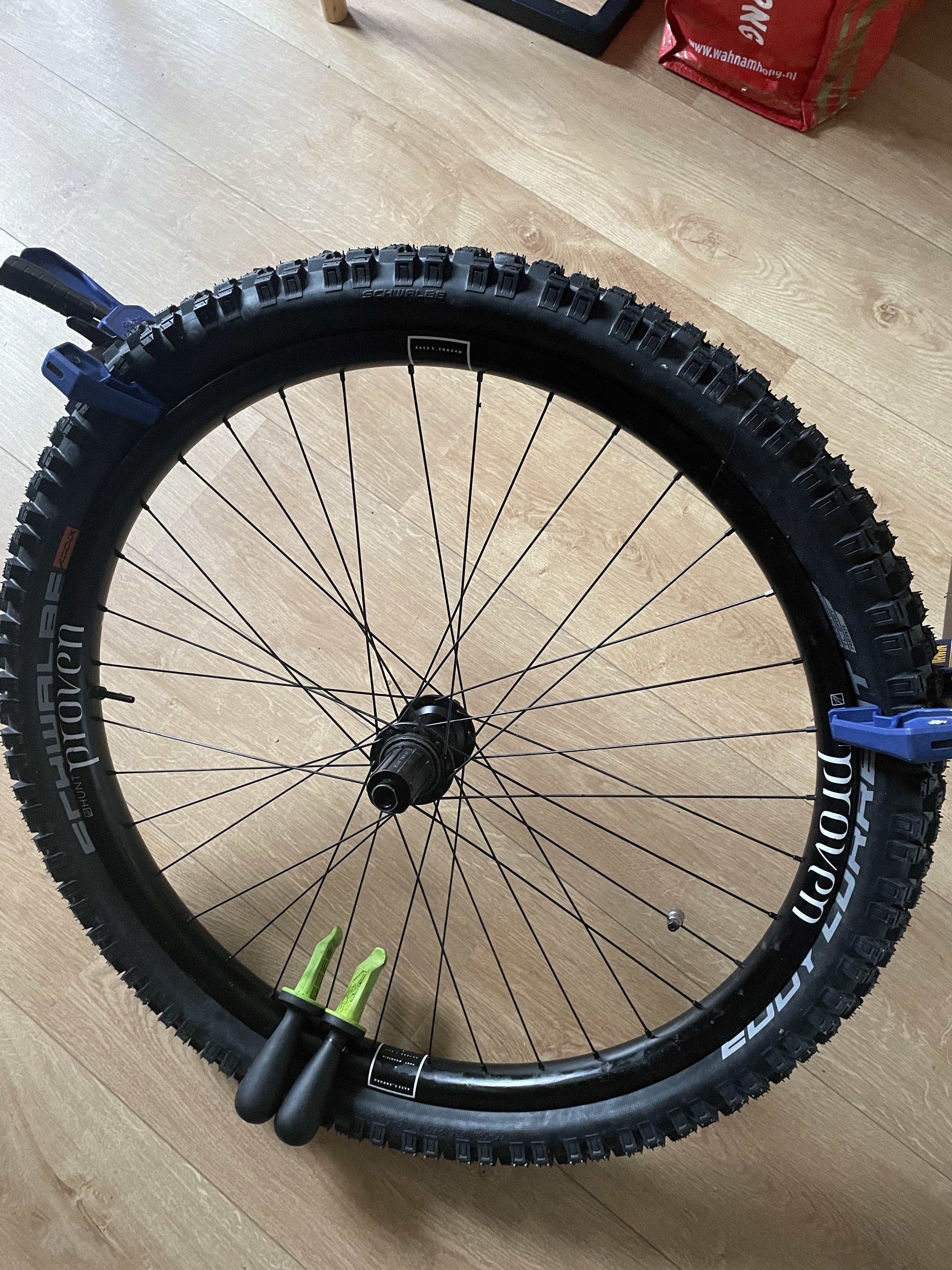

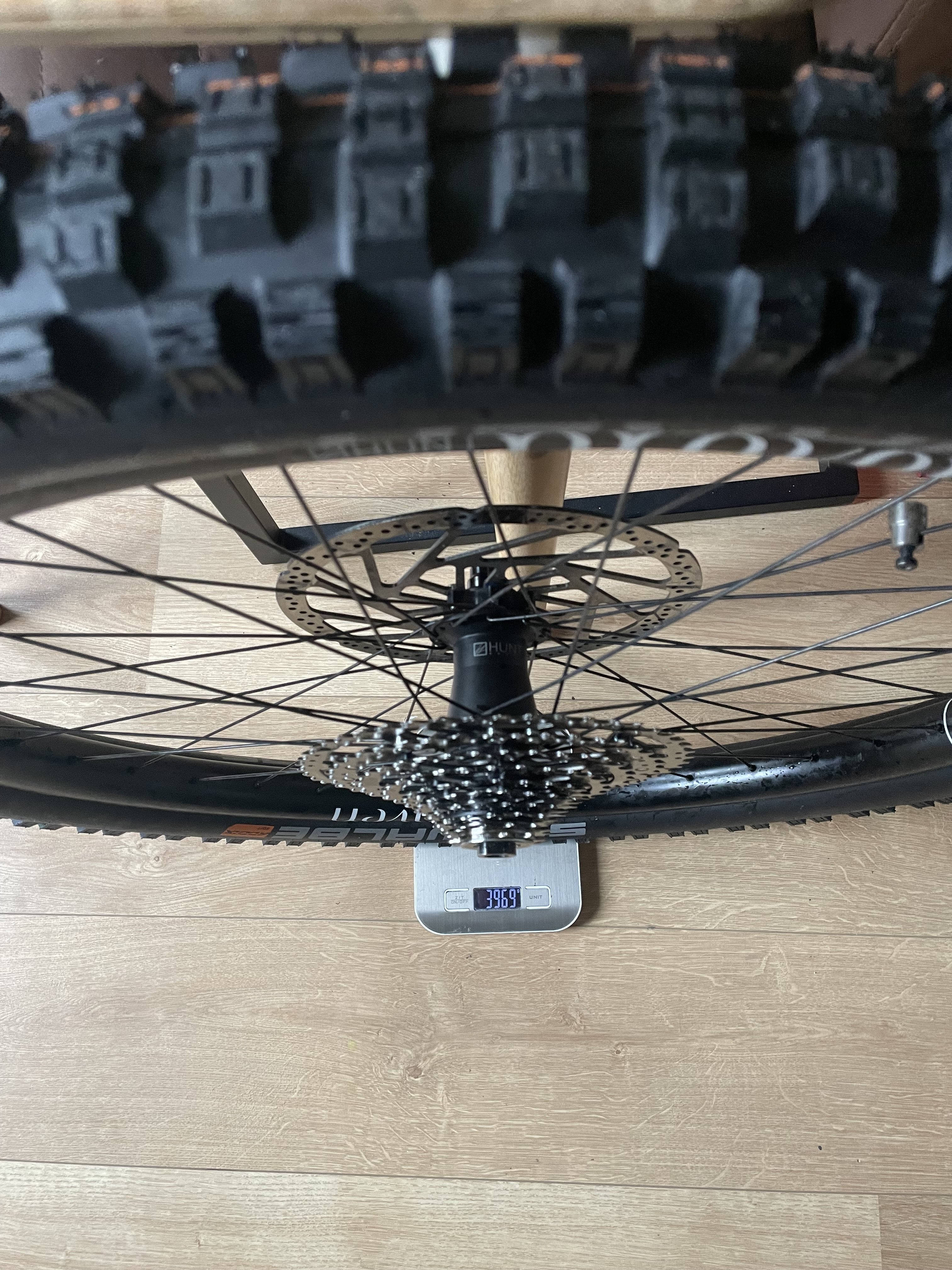

Building up my slightly used wheels,
Hunt Proven Carbon Emtb mullet wheelset. 31mm internal 36spokes and steel HG driver.
These are build like a tank and for me (104kg) these rock! very stiff and allow me ride super fast without worrying.
they came with lifetime warranty as wel.

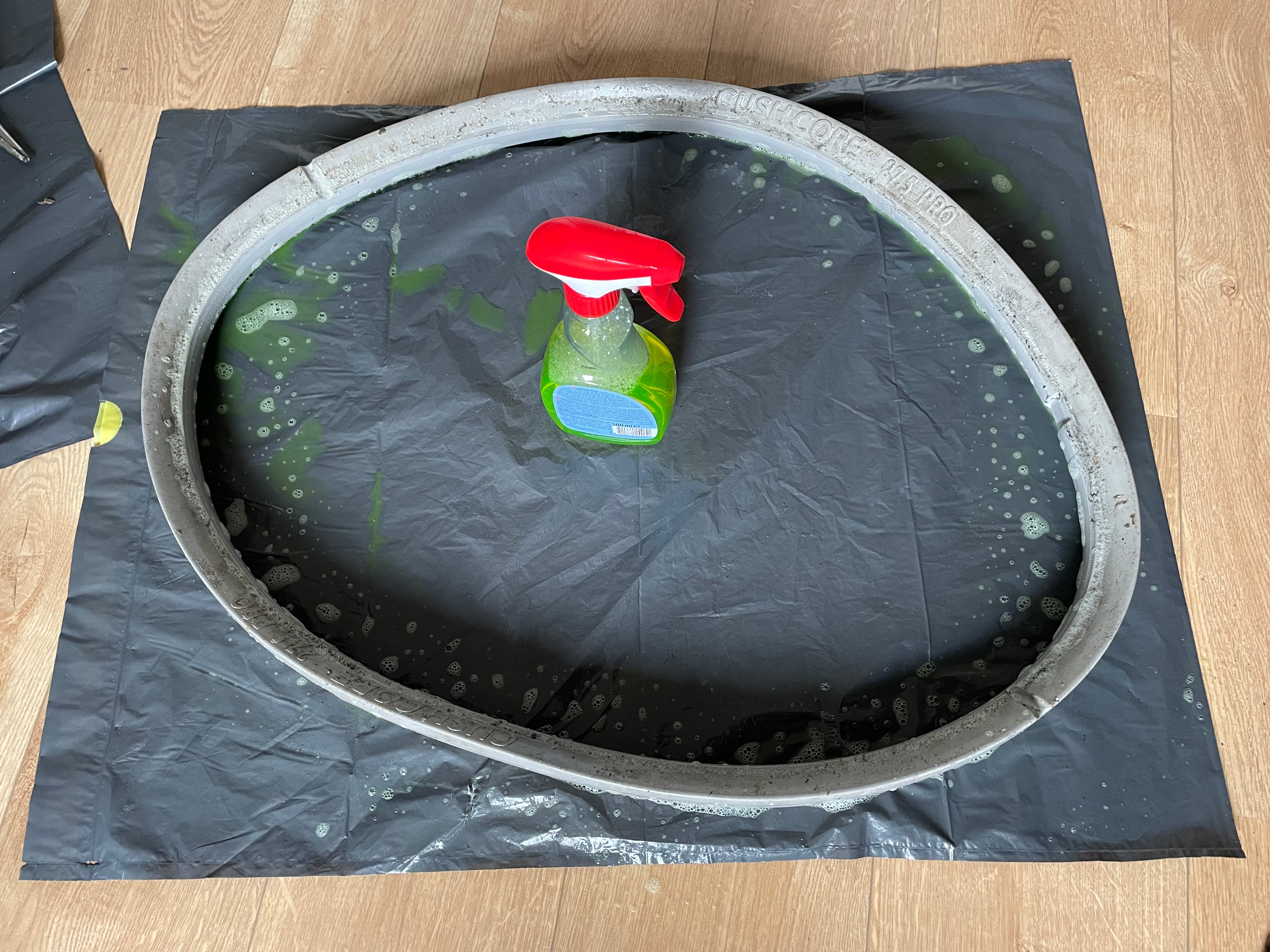

removing and cleaning the used cushcore turned out to be a hell 😅
installing them on a new super gravity casing tire turned to be almost impossible. lets have hand pain for the coming week 😬
nice burly eddy current tires in the Soft
compound. These rock both hardpack bikepark trails and softer loamy conditions and doesn't have a lot of drag either.

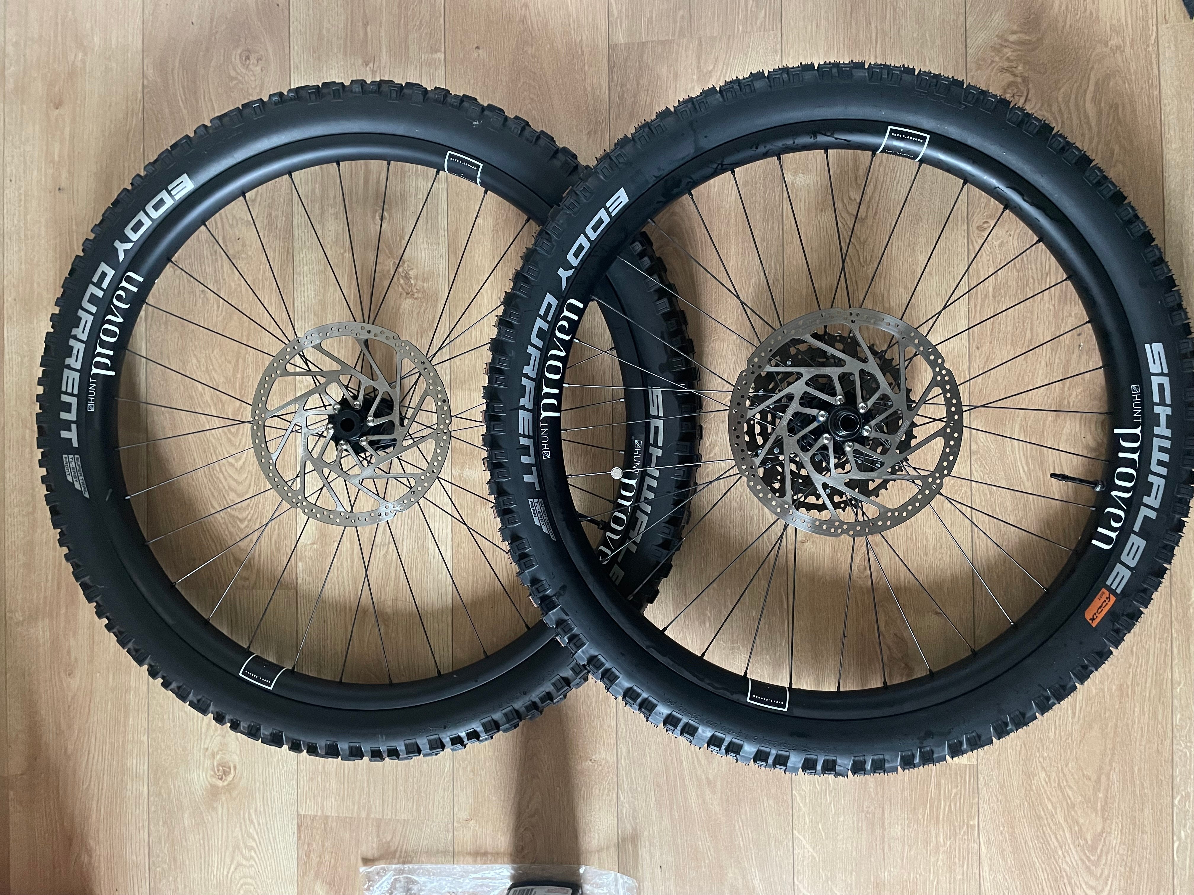

kaaskopf
Oct 11, 2024
95
98
Berlin

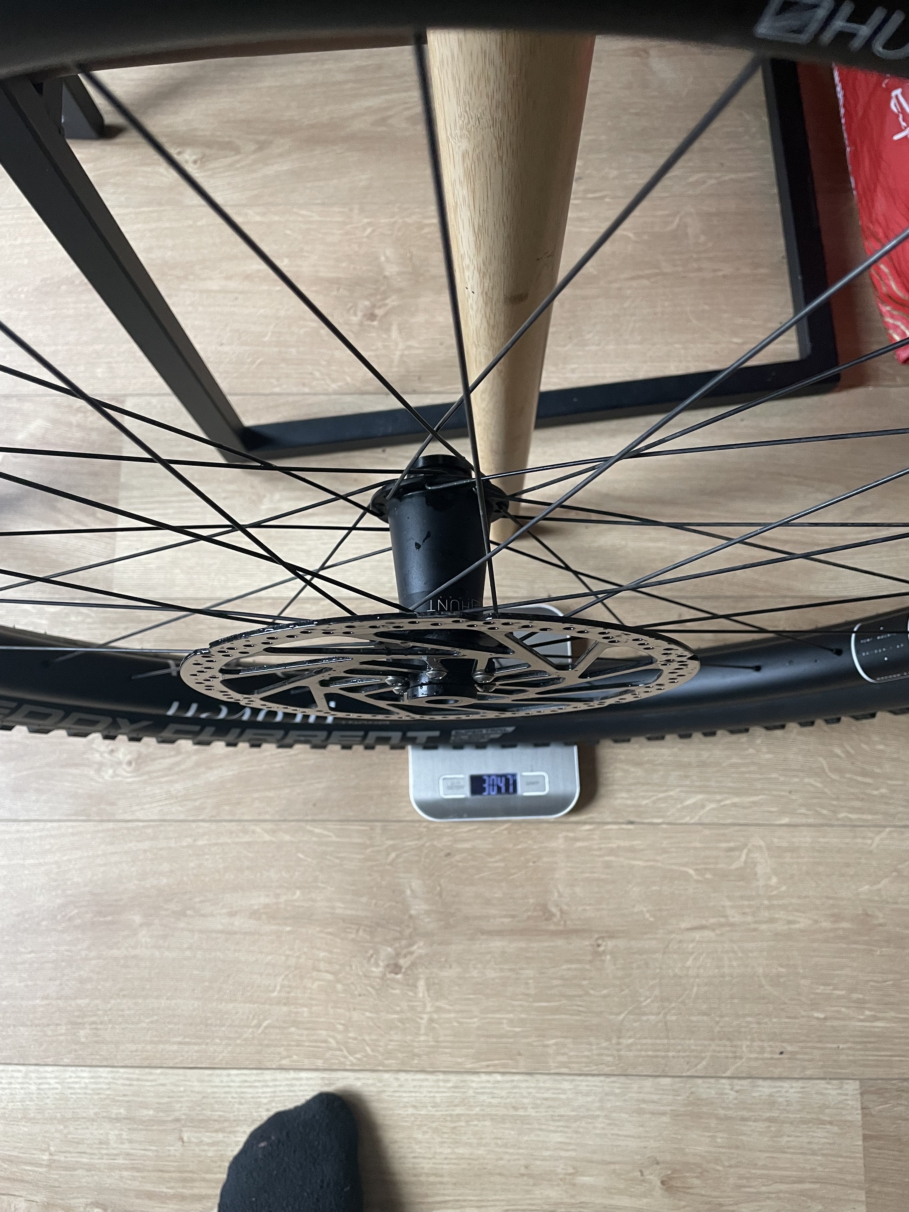

this is not my first rodeo 🤟🏻
2 oversized wood gluing clamps and 2 oversized cushcore tirelevers
finished set
2.6 eddy current 29" front soft supertrail
2.6 27.5" rear soft super gravity
both with cushcore inserts (just love the way they ride)
TRP 220mm 2.3mm rotors
Deore 10speed linkglide 11-48 casette
weight showed for information purposes.
This is no weight weenie build tho 🤟🏻

still waiting for the frame be like 😬

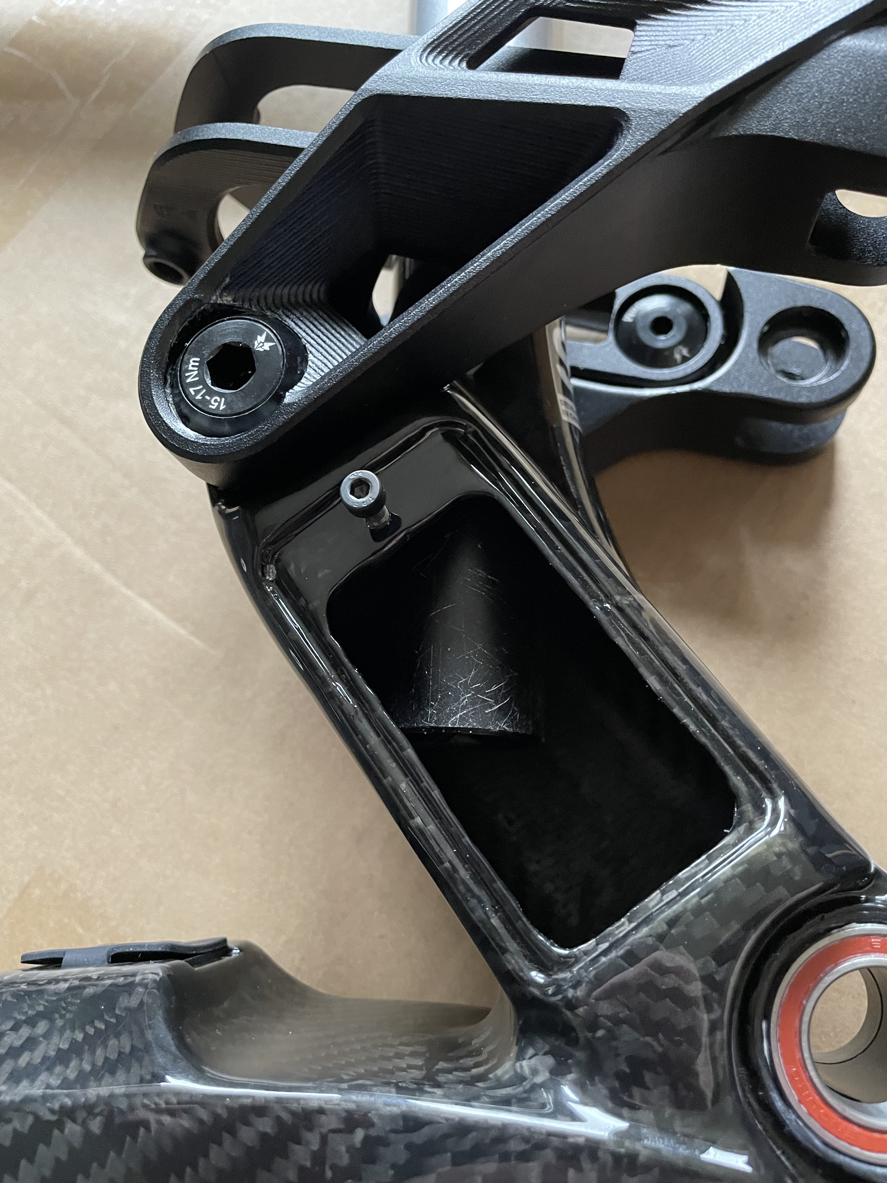

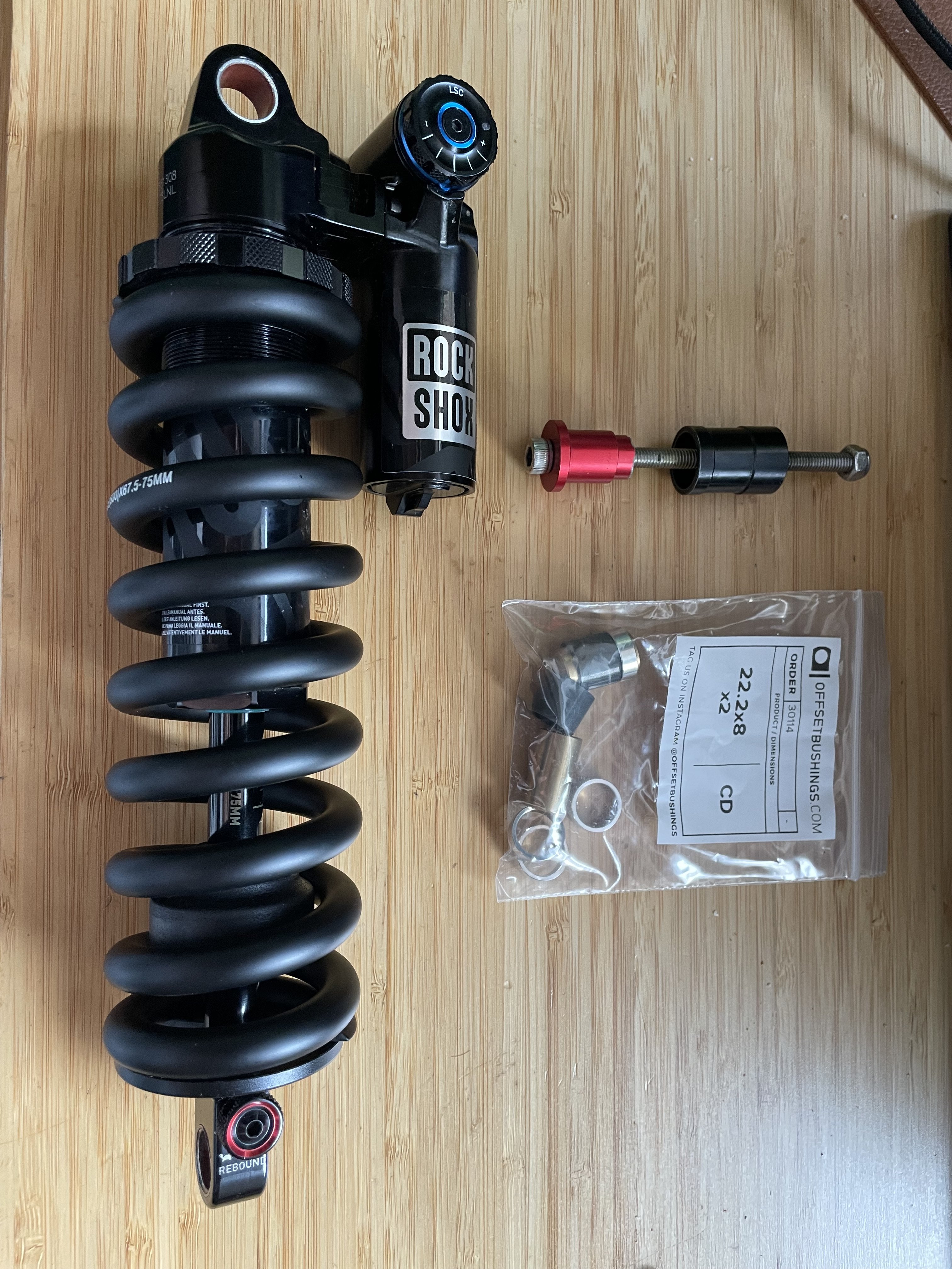

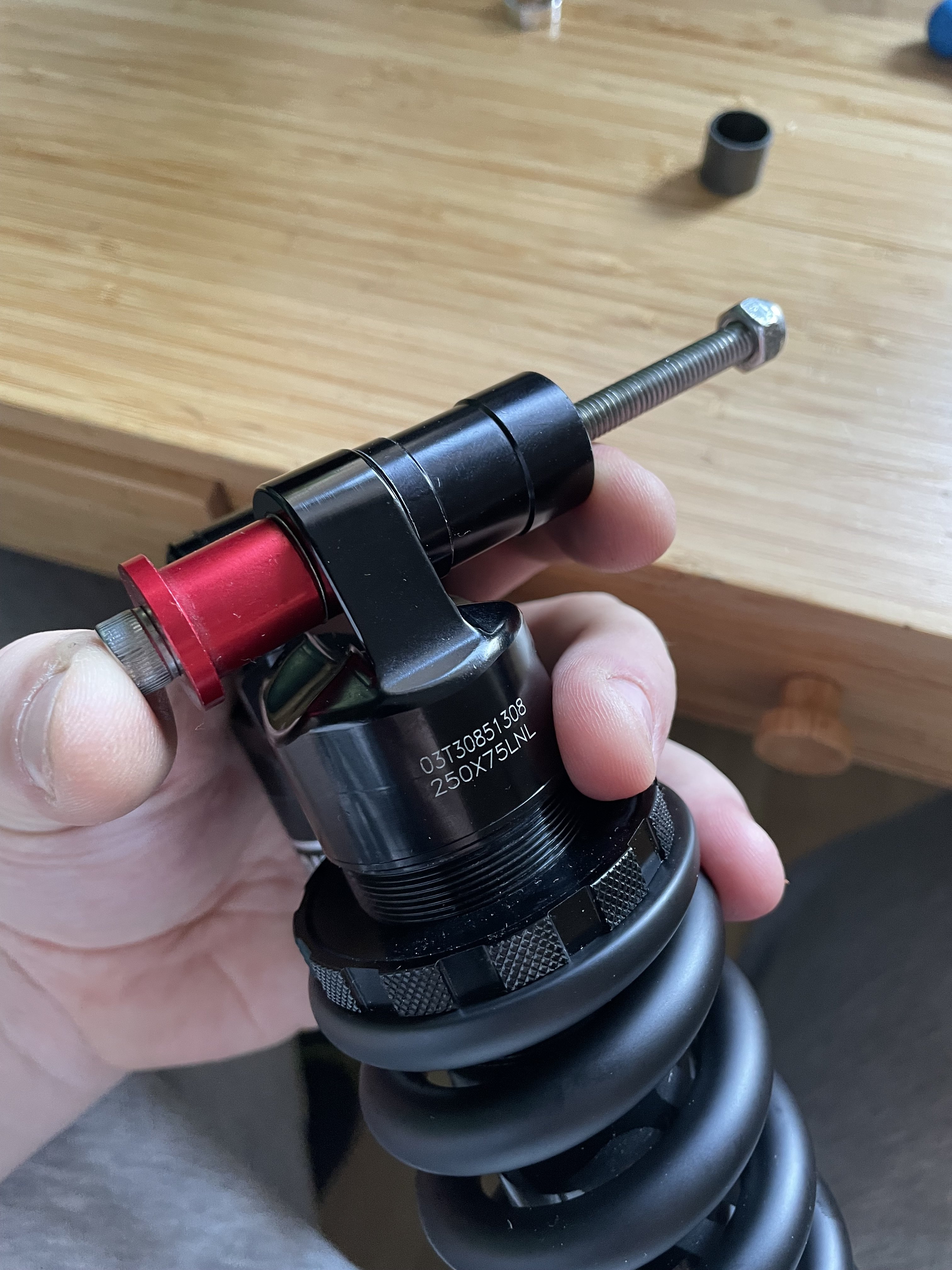

today i wanted to continu the build so i pressed out the orginal bushings and pressed in the new stuff from offset bushings.
kaaskopf
Oct 11, 2024
95
98
Berlin
build up the rear linkage and put medium loctite on all the bolts and put the correct torque on each bolt.
I dont want to loose anything during a ride...
also test fitted the fork to see how low i can go with the stem.
i want it to be as low as possible because the 190mm fork is already quite long
rear shock i chose the Rockshox Super deluxe ultimate DH 250x75 with steel shaft, as this bike has a slightly longer yoke. Bushings from offset bushing
the rear shock has HBO, LSC,HSC,Rebound and preload settings
up front i chose for a Zeb Ultimate 29 190" 44mm offset.
how far i got in limited time
