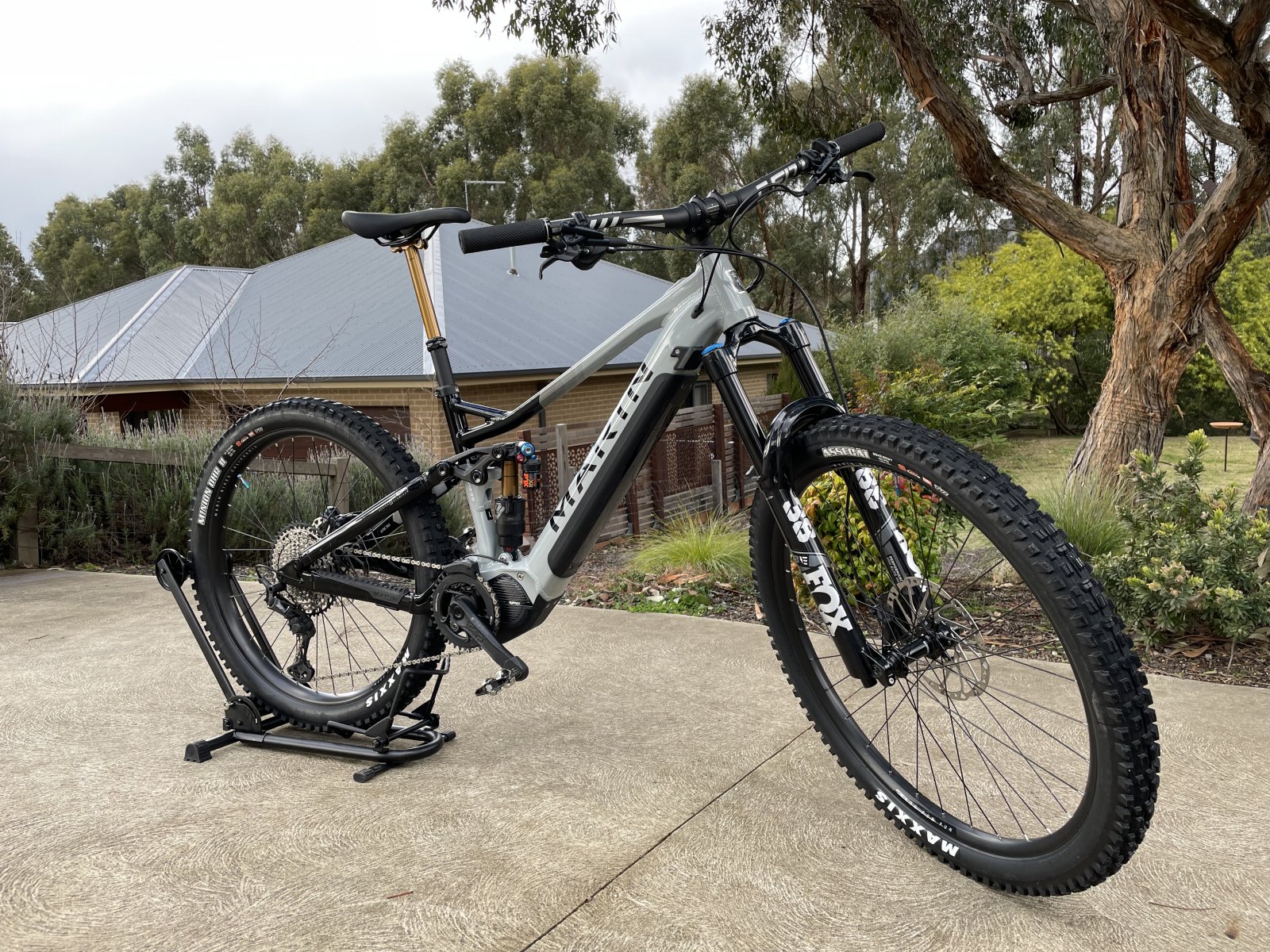

I've had my E1 now for two months. Made some unsurprising changes pretty much from day one.
  • Maxxis Assegai/DHR 2
  • 400 lb spring
  • Marzocchi Z1 forks
  • XT brake levers
  • 170mm Brand X dropper
And I'm really happy. Came from a Transition Sentinel and this feels similar but the mullet makes a bit more nimble in the corners and the coil works well with the back end.
In terms of water bottles - I've found a company called Cyclesolvers who make 3d printed adaptors for water bottles. I've got one of those with a specialized zee cage and it means I can fit a 640ml camelbak bottle into a medium frame. Before that, I was limited to the smallest of the fidlock bottles and I wanted more. The adaptor was a bit on the steep side, but it does work.

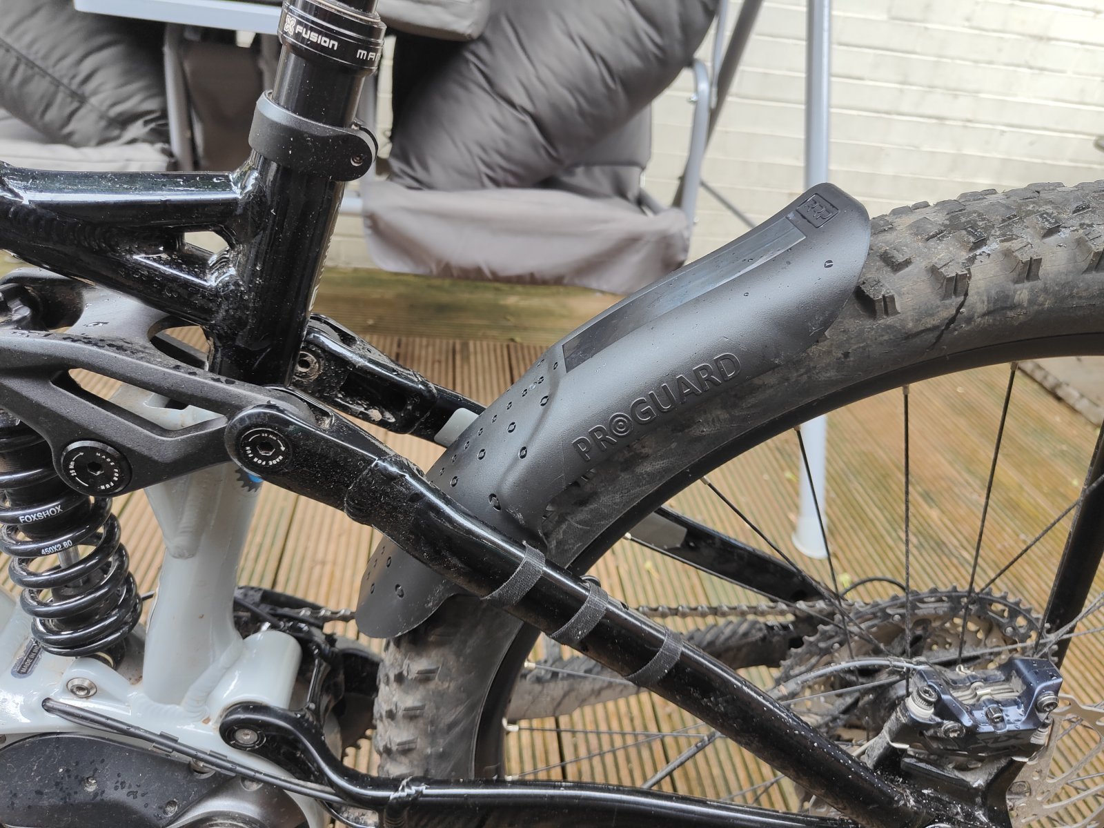

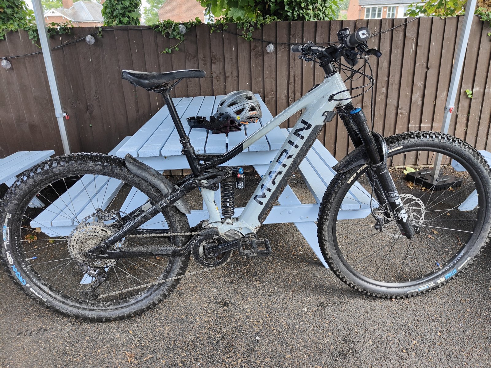

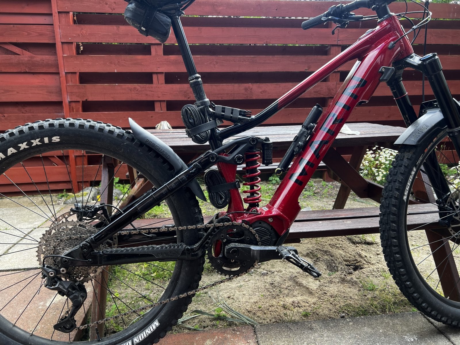

Right all, let's talk mudgers 😁.
My E2 came with a nice Fox front mudguard but has nothing on the back (where it's much more important, imo) on a couple of wet rides the linkages and general rear end were a mess, even in the recent dry it's caked in dust .
Anyone found anything that fits the rear and works well?
Found something that looks ok and on a horrible, wet and cruddy ride protected the upper linkages fairly well, quite happy. May look at extending it down somehow if I can do it without it looking like a 12 year olds science class project 😁
Baron Rouge
Jul 5, 2022
15
11
Yeah I’ve gone for the Proguard too, just fitted, doesn’t look too bad, we’ll see if it makes a difference next time it’s wet. Don’t imagine it will keep my back dry but might keep the worst off the bike’s sensitive underparts

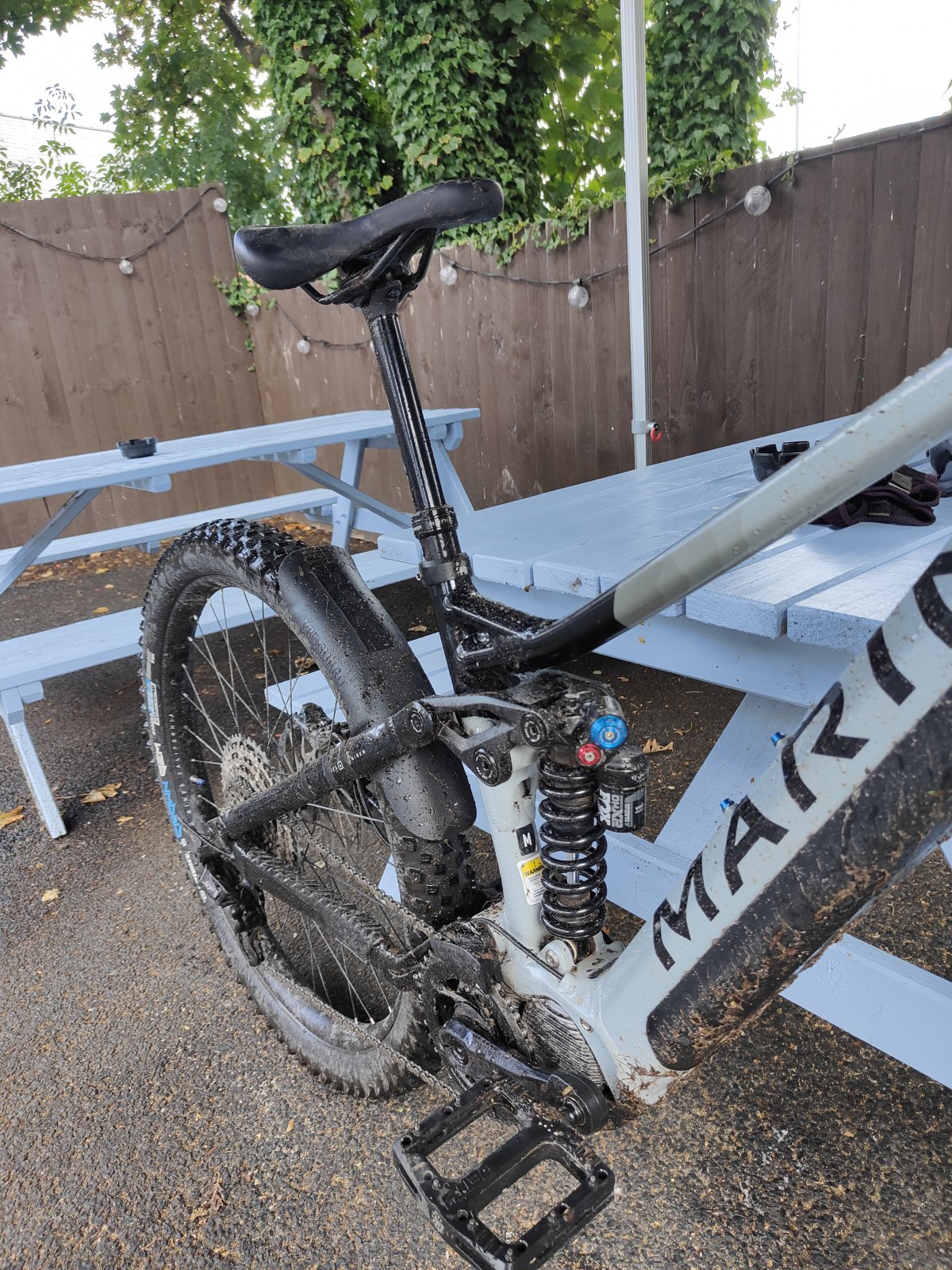

I would have liked to try Zee but couldn’t find any. Remember when you could just buy stuff that you wanted?
Rayburn13
Sep 19, 2021
10
9
VANCOUVER, B
Yeah I’ve gone for the Proguard too, just fitted, doesn’t look too bad, we’ll see if it makes a difference next time it’s wet. Don’t imagine it will keep my back dry but might keep the worst off the bike’s sensitive underparts View attachment 93504
I had to take the shock off for service on my e 2 and tested full travel to see what I can place in which position and that upper tube placment is gonna rub the fender into the wheel and will prevent the bike from using full rear wheel travel, losing probably 1-2 inches of 6.. also I found anything connected to the rear of the seat when the seat is in the lowest position will touch the tire on full compression even when the seat is all the way forward on the rails... lower tube shouldnt touch but will be super close and if it ever did shift enough and touch the tire it would probably get sucked inbetween the wheel and frame then lock up the rear tire which would suck through roots or in rock garden or compressing into a jump...

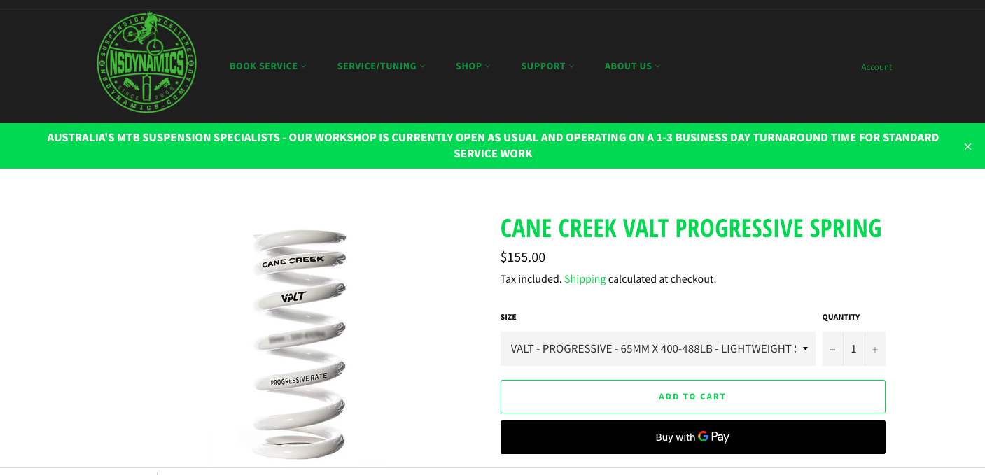

Hey @pete-E1 how’s it going?
Can you tell me where to buy a progressive spring 450lbs?
I'm in Australia and when I went looking for one, I tried NSDynamics.
This is my email;
Hi,
I've got a Rockshox Super Deluxe Coil R shock (205x65) that came with a 300lb spring as standard which is too light for me. I've put in a spare 450lb spring but it is a bit stiff for me. I'm looking to get a 400lb progressive spring to fit but unsure what adapters I would need for it to fit the shock.
I've looked at this one on your site Cane Creek VALT Progressive Spring
and believe it should fit, but unsure what adapters I would need. Any advice for my purchase would be appreciated.
Thanks,
Pete.
And their response was this;
Thanks for the email.
Unfortunately in this case the VALT Progressive spring will be a no-go. The Rockshox dampers have a larger diameter than pretty much all of the other main brand manufacturers (Ohlins, DVO, Fox, Cane Creek etc.) so springs from those manufacturers won’t comfortably fit the shock body. In this case you’re limited to springs will larger diameters, either from Rockshox themselves, or we also have the Sprindex lightweight adjustable rate coil springs available which will suit, and they also come with adapters to suit the other brands if you ever change shock in the future.
In this case I might recommend the 390-430lb option which you can find here - Sprindex Adjustable Rate Lightweight Coil Spring
The only other option would be a standard Rockshox steel spring in either a 400lb or 450lb rating, but they don’t do any progressive springs that we’re aware of. We don’t stock these in the shop here but we can special order them if needed.
Let me know if you have any other questions.
