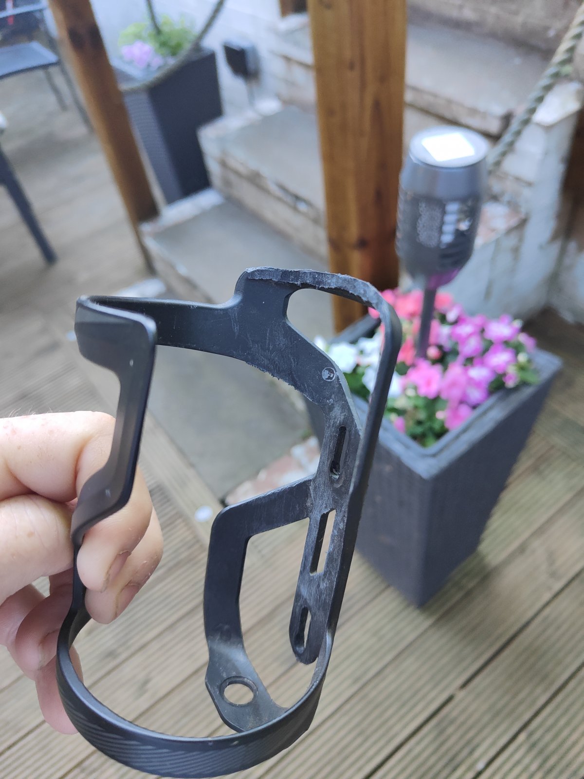

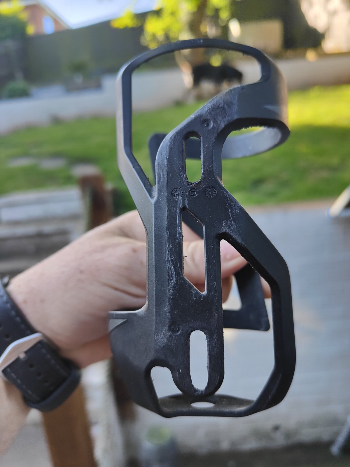

Can you confirm if the 620ml bottle actually fit? every bottle I’ve tried rubs the bottom of top tube. I’ve been looking for a tapered top bottle like this - I’ll be stoked if this works
thanks
I've had to heavily adapt my bottle holder, it's a specialised plastic side loader.
I've had to file down the plastic at the top inside lip to let the bottle lie nearer the downtube and widen the bolt slots so the bottom of the bottle misses the shock piggyback reservoir. It probably does still touch the underside of the downtube but only slightly and there is no movement so shouldn't rub the paint.
I'll take a photo for you in a bit.

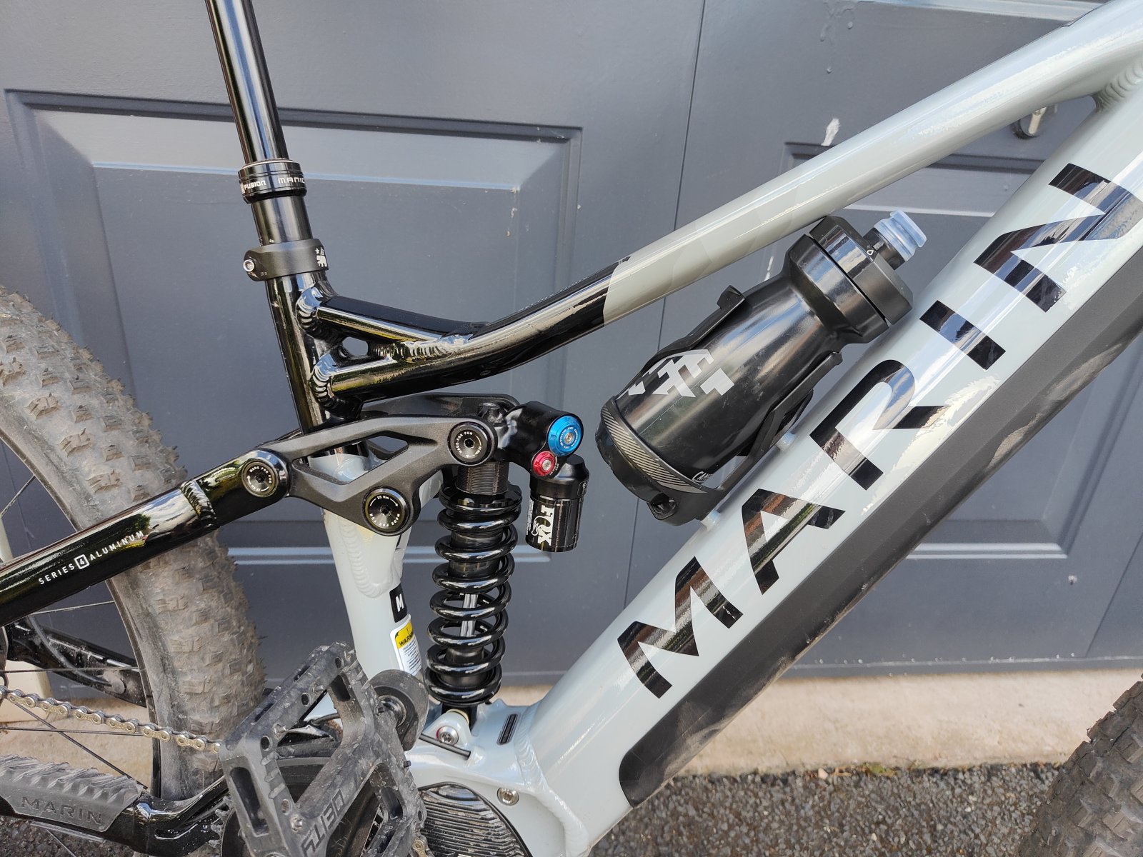

thanks - that bottle is too jammed in for my taste , I’ve got the same cage and other bottles I’ve tried with same results. To make it work we are going to need a bottle with a missile tip, or a short nearly useless bottle. Trek has a small kids bottle (500ml) I wanted to try, but it was sold out, I’ll see if I can find it on line now. I have a specialized big top stainless that fits, but that is only good for smuggling tubes, tools or edibles that don’t melt, and again a beer in a coozie fits just perfectly.
