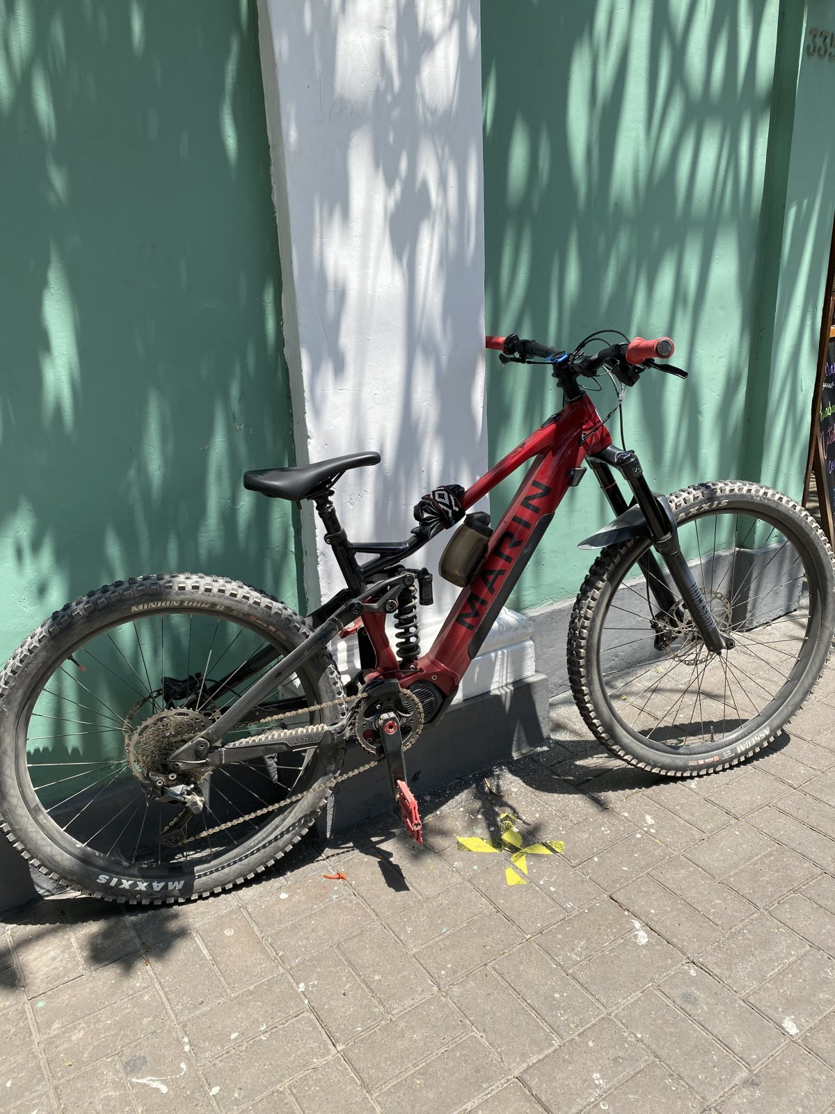

Hi everyone, I got the E1 a few months ago in Peru. Just put around 600km on it and already feeling the coil and suspension bottoming out in my local trail jumps.
Any recommendations without breaking the bank?
On the other hand, my rear derailleur is jumping gears like crazy and the main bolt keeps getting loose. Can I fit an XT derailleur and cassette? Any other options for upgrade? View attachment 80584

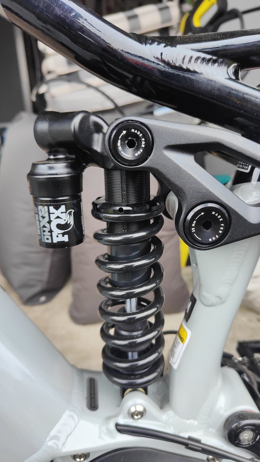

Is it stil lthe stock 300lb spring? It's way too soft. I have tried a 400lb, 450lb and 500lb spring on mine. Settled with the 400lb for a while but still getting some bottom outs so just put a 450lb back on to see how that feels again.
Lose the 2.8 rear tyre too. It floats over everything with poor grip once it wears down a bit. I went for a Schwalbe Big Betty Super Gravity 2.4. Still yet to ride it but looks way better shape for traction and feel.
Gears skipping is probably a bent derailleur hanger. Mine was super bent and I have a derailluer hanger tool and straightened it out and it was fine again. The "B tensions" screw may need adjusting as well. Any bike shop can fix the gears in 10 minutes so no need to spend money on new derailleur until the current one dies.
I swapped the Forks out to Fox 36's Performance 170mm from my Scott Ransom and it made a HUGE difference to the bike. The Gold 35's are rubbish. My plan is to get some 170mm Zeb forks for the E1 and put the Fox back on the Scott Ransom.
I've got about 530km on mine.
Thanks Pete.
I got the L size with 400lb coil, which I bottom a few time jumps; you can check my TT account were I post videos in my local trails: TikTok de Samir Rifai (@samirrifaia) | Mira los últimos videos de Samir Rifai en TikTok
Excellent tip on the rear tire, actually both of them float... I'll change them soon; but was wondering if 2.4 or 2.5 (I'll keep the mullet setup).
About the derailleur you might be on spot, I had a couple of crashes and have not checked if it's bent.
My springweight calculator says I need about a 375lb spring. Even with the 400lb (I'm about 80-82kg fully kitted up) I still bottomed out on big hits. It was stable for jumping too, not too poppy. I do have my rebound quite slow to keep the rear end predictable in the air so I don't get bucked. I'm back to a 450lb spring now, reduced rebound speed by 1 click to counteract the extra spring weight. You will always bottom out on any coil.
Try a bigger spring on the rear or get a progressive spring so its more progressive towards the end of the travel.
The front tyres are actually Ok. I've had Assegais for a while and they are super grippy.
The Rockshox Gold 35's are the problem with front grip. Once you push hard and fast they can't handle it. They bounce you down rough stuff. I did put the maximum 2 tokens in and dropped pressure which helped a bit. Once I swapped to the Fox 36's the whole bike improved.
I've got Cushcore in the rear, haven't been bothered to put it in the front yet but I run about 21 or 22psi in the front and about 23-24psi in the read.
I've got Cushcore in the rear, haven't been bothered to put it in the front yet but I run m.
Thanks for all the feedback.
Good to know about all coils bottoming out, maybe I'll go to 450 also and give it a try.
About the suspension, I'll start with the 2 tokens and work my way up to change it in the mid future. You are right in stating that when pushing hard on the Rockshox Gold 35 it starts rattling everywhere.

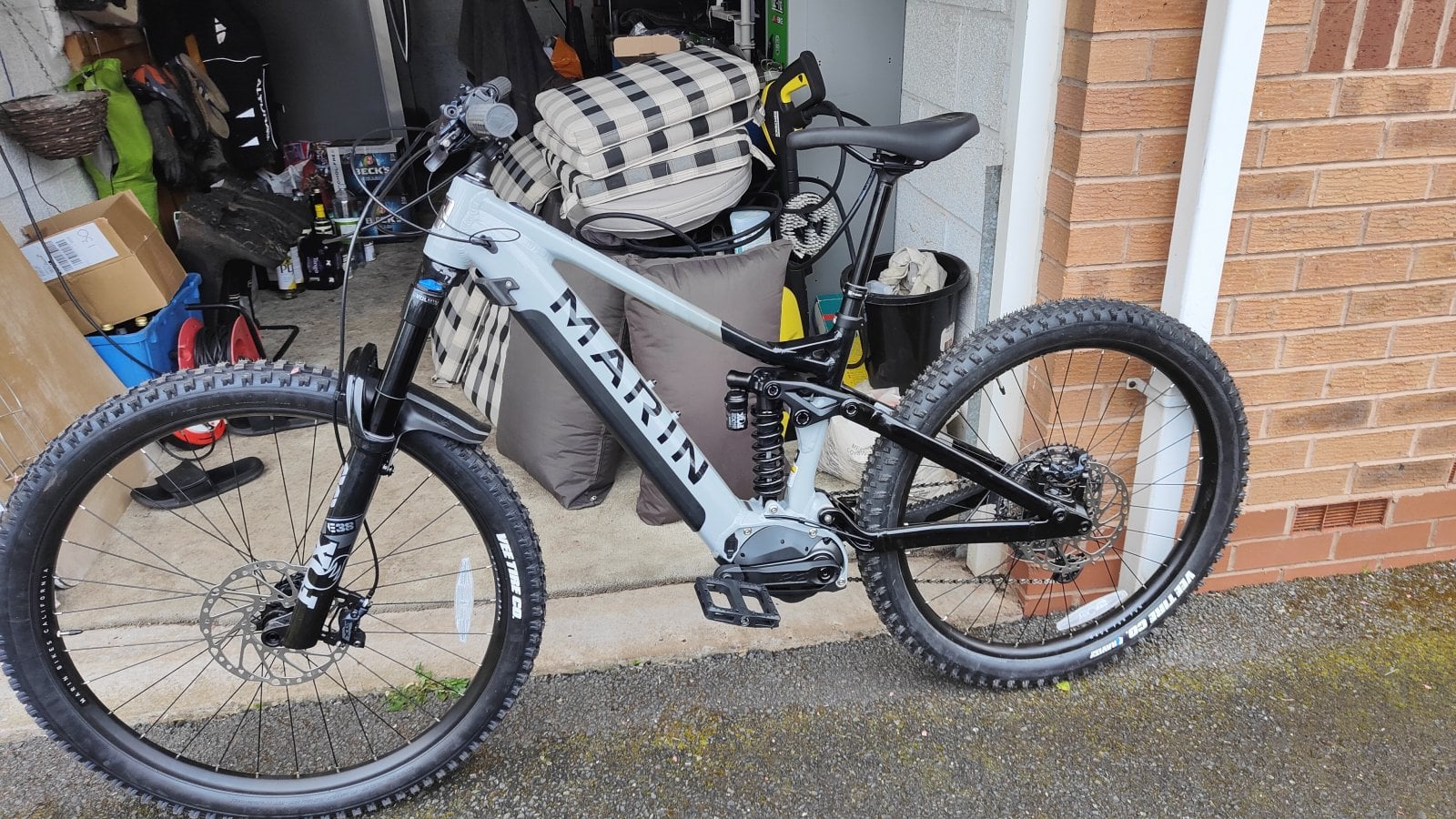

And here it is. Vee tyres rather than specced though.
