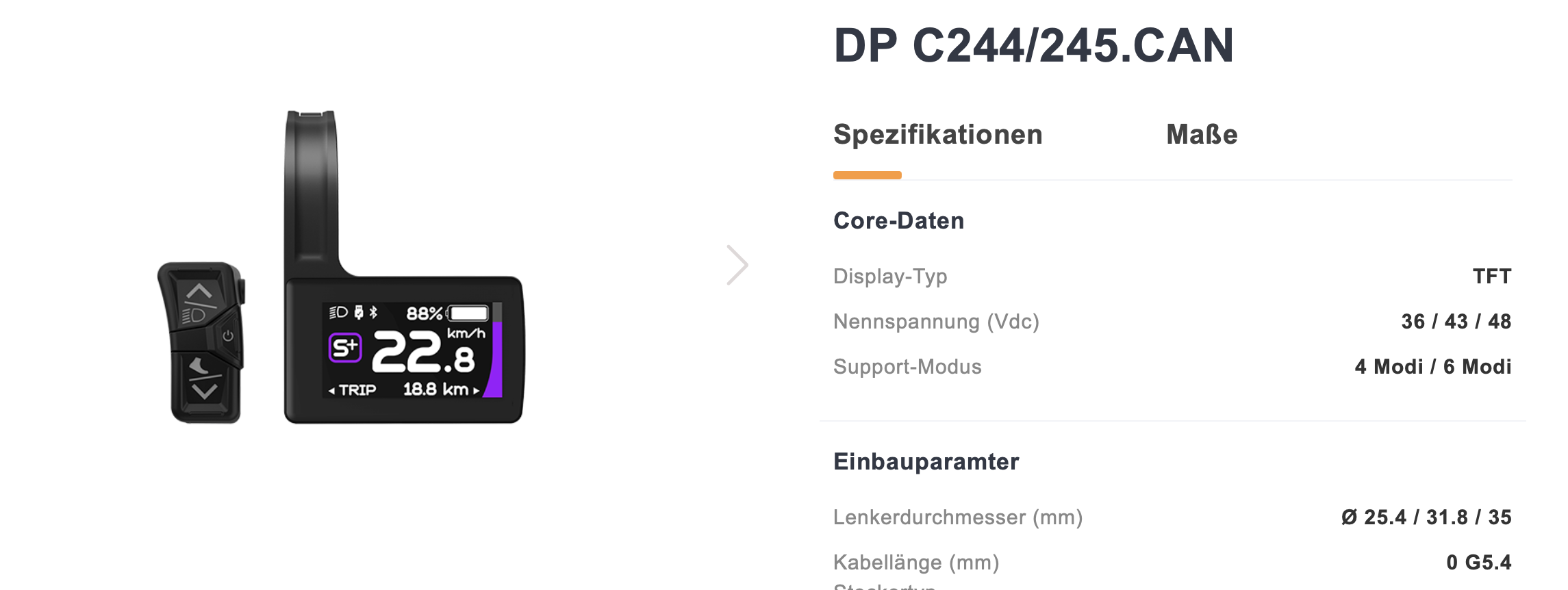

This Remote/ Display would be nice:

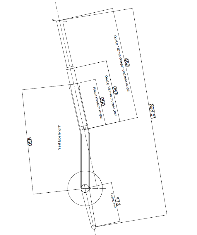

Hi Jim
Yes insertion length is 200mm but the longest dropper post to fit the frame is 180mm (stroke). The shortest insertion length droppers are made by OneUp. If 240mm (stroke) dropper post is fitted in LCE930 frame than 184cm tall person will have too short legs to reach the pedals.

Thanks for sharing the knowledge, so the drooper seat post can only 180mm (stroke).

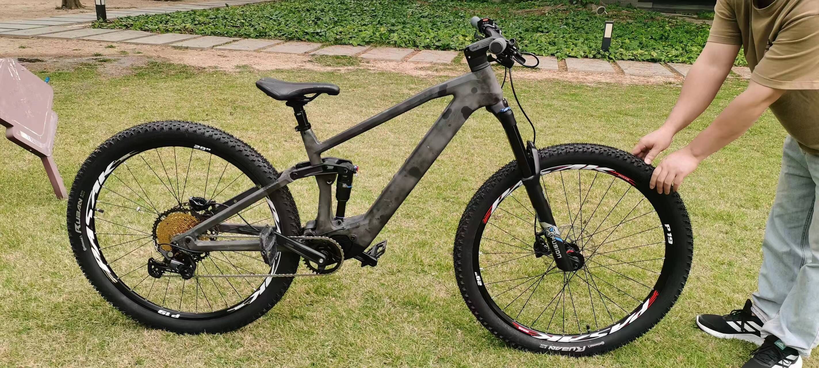

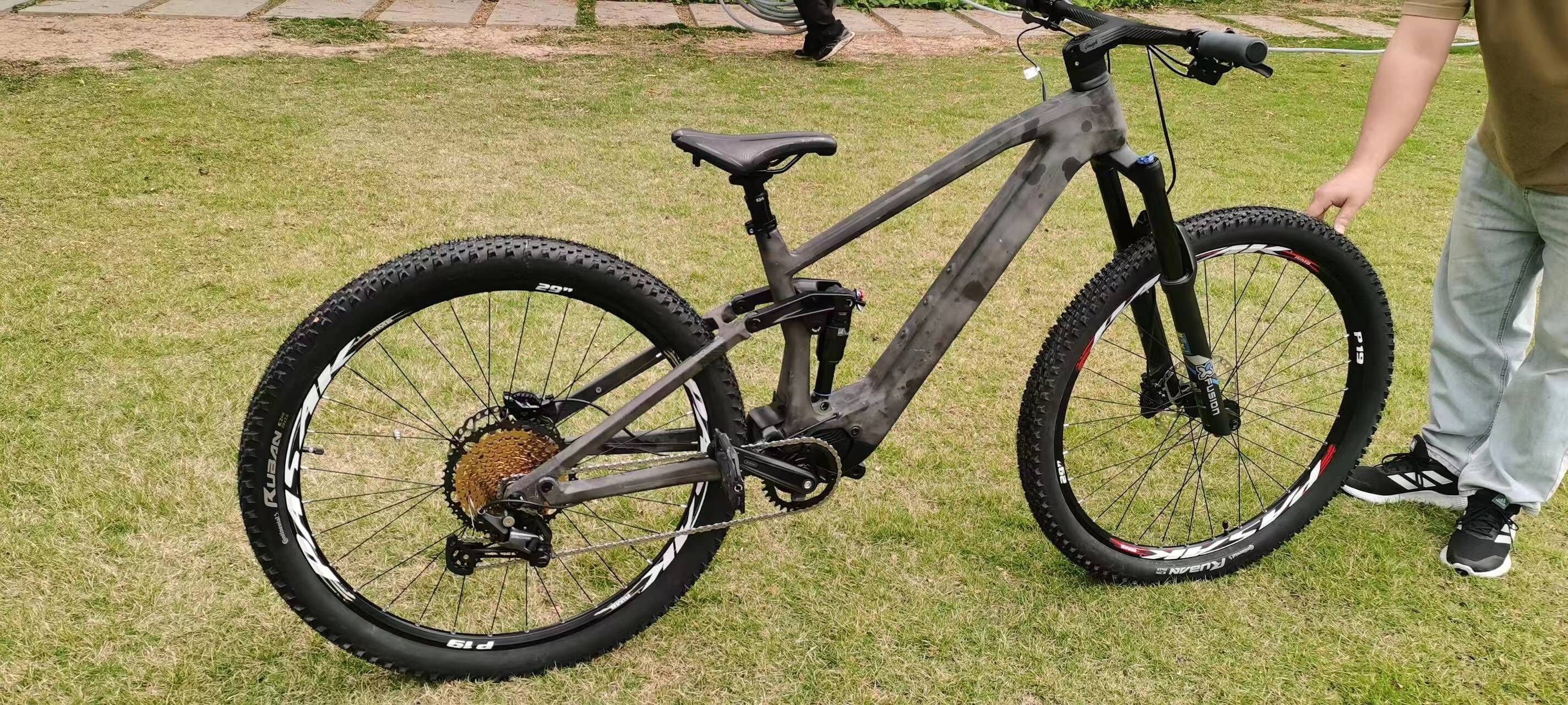

BTW, is it the default finish we have if we choose it unpainted ? because I love it 😍
This is the original color of carbon fiber. If you need this color, you can directly spray the varnish on the outside, but you need to explain in advance, and you will see the seams and scars of the carbon cloth through the transparent paint.

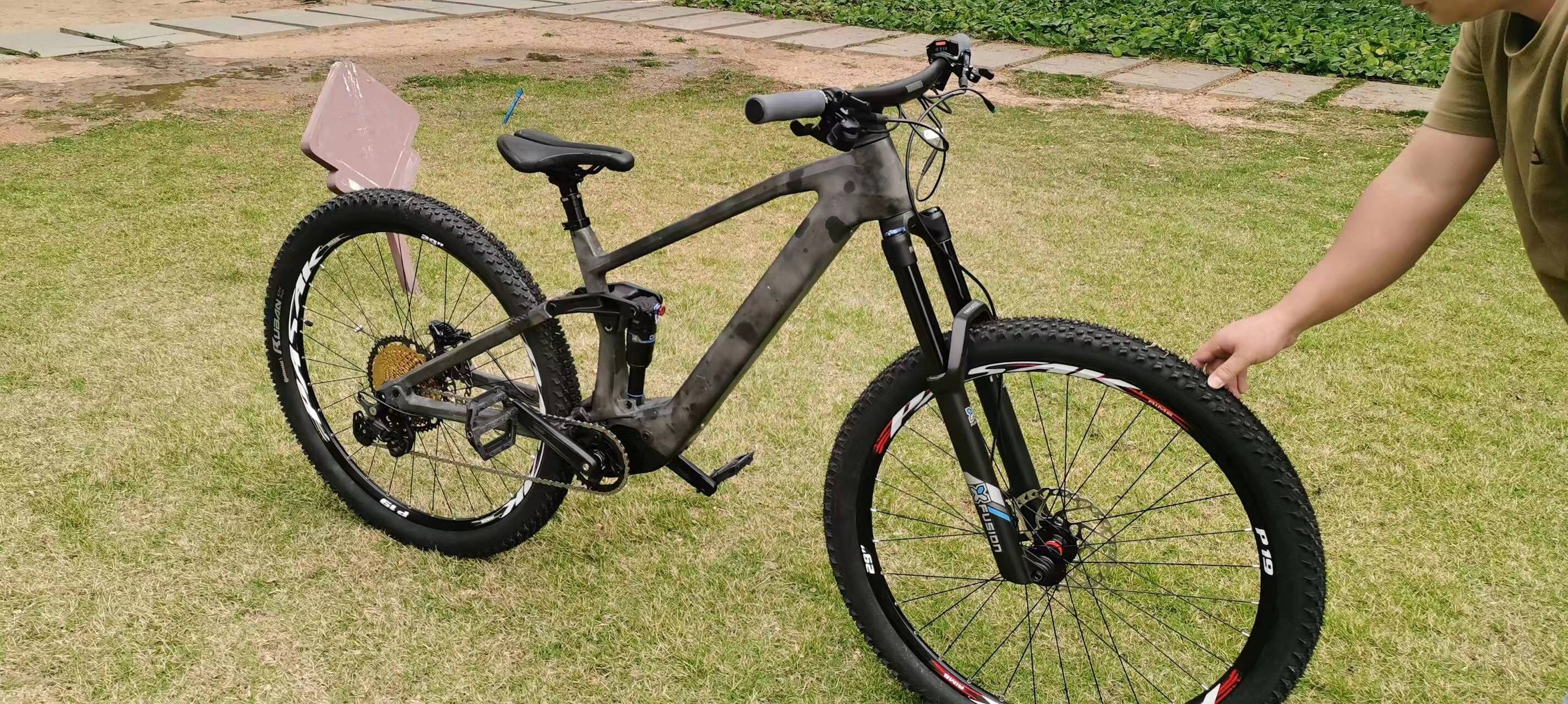

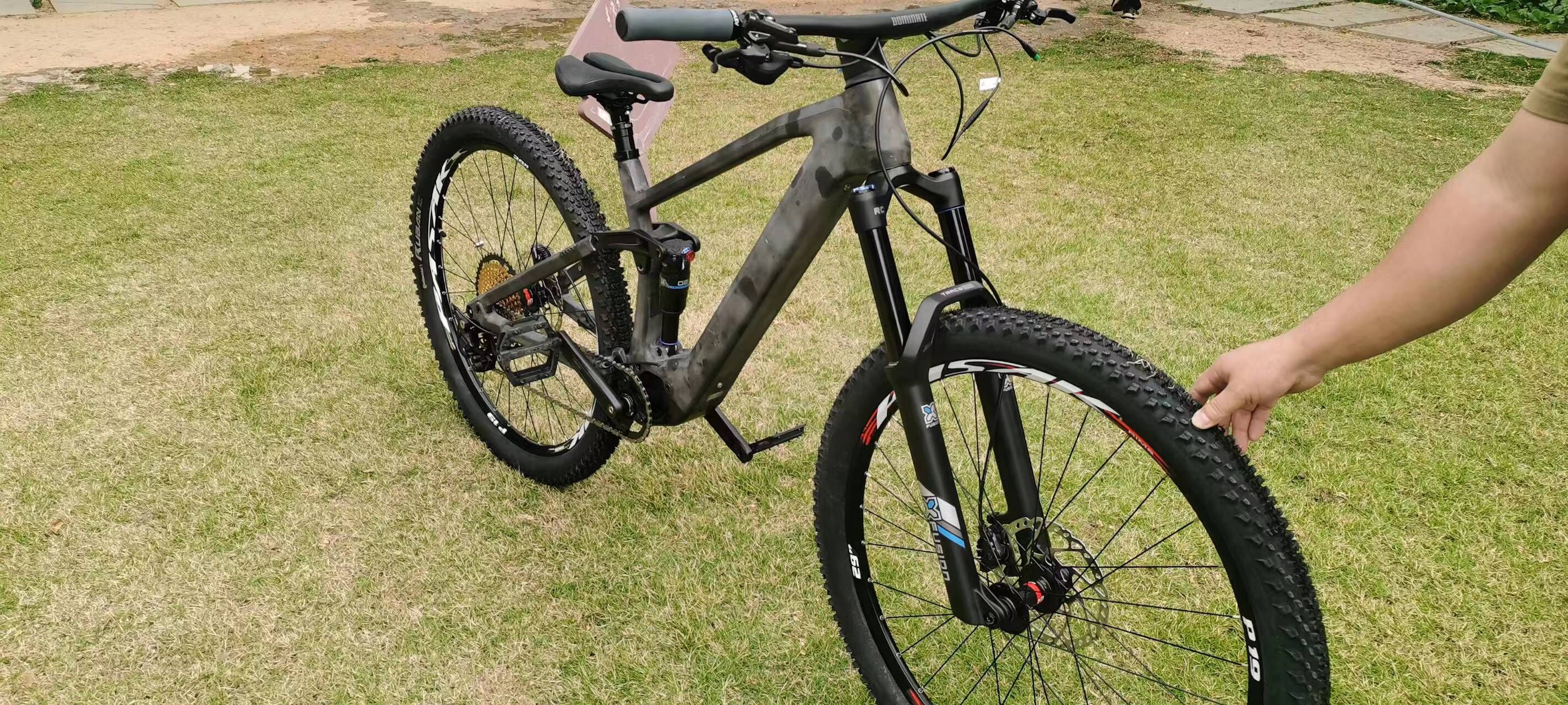

I
Very successful frame design with current geometry. By the way, what kind of handlebar is this in the photo? Does it have an internal cable routing?
it's AM03 handlebar, handlebar for AM and DH and enduro have no full inner cable bars, only XC have full inner cable bar,
the cable though the head tube innner, but on the bar, it's out,

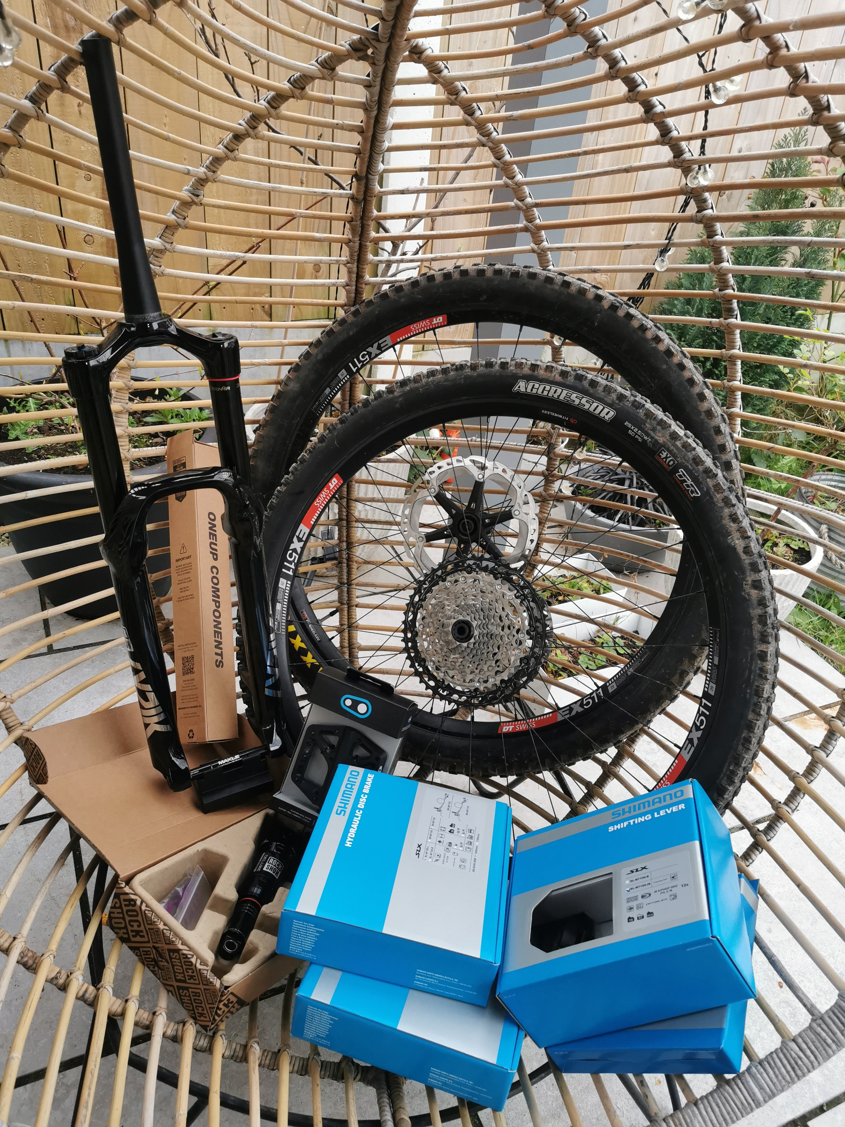

Frame - ordered.
Motor - ordered.
Suspension + bits and pieces - ordered.
Now just wait wait wait wait.... :D
I have made a small calculation for my build, should be about 19kG, happy enough.

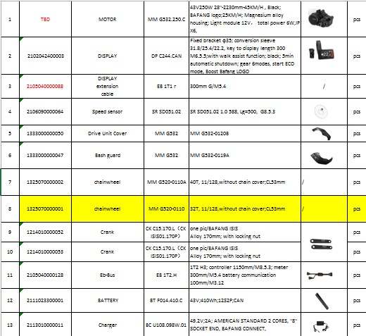

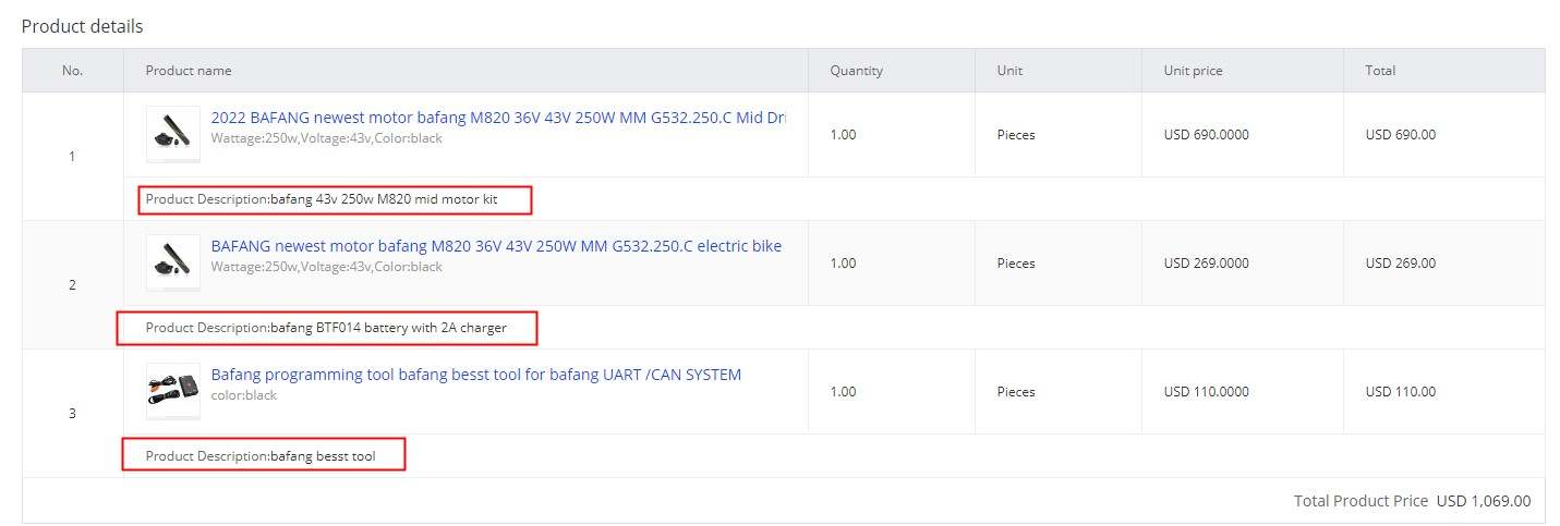

Following is the quotation of bafang M820 mid motor kits and battery .
-----bafang 43v 250w M820 mid motor kits ----690USD
-----bafang BTF014 battery with 2A charger--- 269usd
-----the shipping cost of the motor by air---- 90usd
-----the shipping cost of the battery by air----125 usd
-----paypal fee----25usd
Total price is 1199usd
