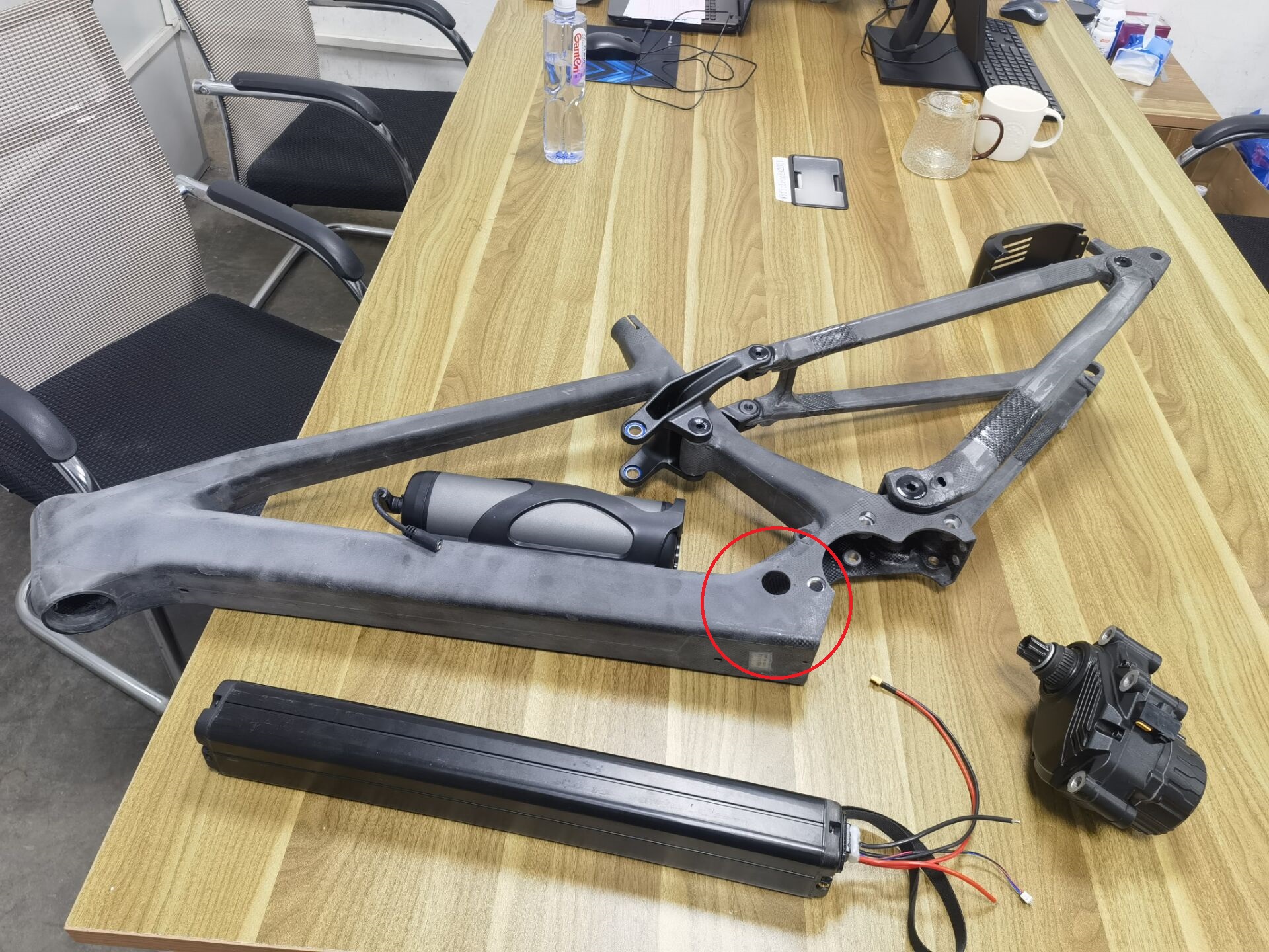

the motor M820 have two vesions, 36V/ 43V, so the main battery also have two vesion: BT F100 36V 360wh and BT F014 410wh, and extended battery we find one is 36V 360wh, can not find any one with 43V,

How will the extender connect to main battery or motor?
Now we choose the extended battery connect the main battery, not motor, if connect it direct to motor, It request a one-to-two plug and a power select controller. We haven't solved this problem yet. The current solution is to connect the extended battery directly to the charging port of the Bafang battery. The advantage is that it is convenient and does not require additional operations. The disadvantage is that such batteries in series will have a certain impact on the service life of the main battery.

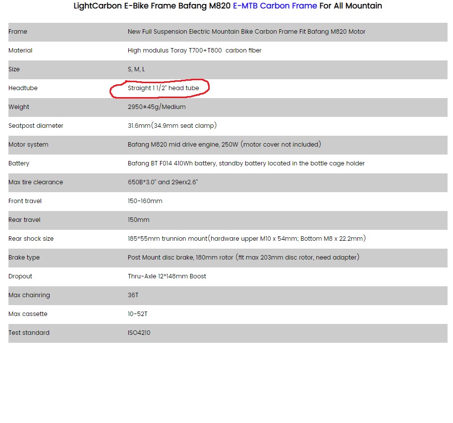

DJ_Eagle
Mar 2, 2023
Hi Guys,
First at all: Nice looking Frame!
BUT?
I am a bit Confused, Straight Tube? Can you Show me a Fork for 27.5" or 29" wheels with more than 120mm of Travel with a Straight Tube?
you can see the Head Tube also on this Video very well, it really Looks Like 44mm upper and lower part. Or i am wrong?

Hi Guys,
BUT?
That's a good remark, I did not even notice it, I was quite sure it was OK for a tapered fork.
I guess you can use this kind of adapter ? 44MM INTERNAL X EXTERNAL 1.5 INCH HEADSET CUP
But will it impact the cable routing ?
[/QUOTE]
Ask Jim at LC of course. But, I think it's likely a typo...the head tube is conical and probably for a tapered steerer tube. (Although even a lesser conical head tube could still use a straight one...but it's rare in my personal experience.)
But I think a reducer on straight steerer MIGHT present internal cable routing issues from the IRC headset.
(The reducer should sit flush with the bottom of the top bearing well.)
Just FYI: Plus, those reducers are usually heavier aluminum block disc inserts. I'd guess adds another 200+ g?
Bottomline clarify with Jim?
[/QUOTE]
Yep, you’re totally right, we’ll see tomorrow his answer

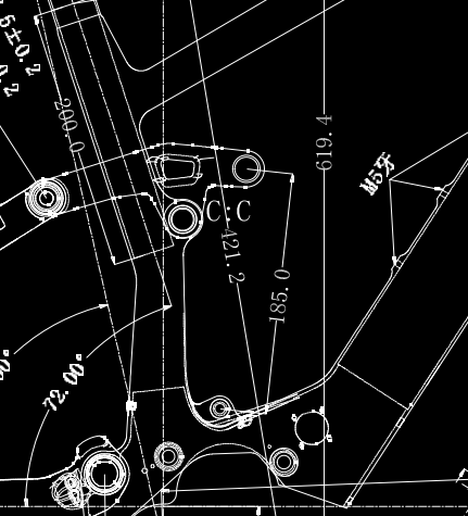

Also, Jim, can you confirm the rear shock sizing? Can we fit only 185x55?
For the fork, can you confirm you recommend 150/160mm in travel ?
mike_kelly
Aug 11, 2022
984
831
US
I got this from Jim with a similar question.
"2. I just confirmed with the technicians that the eye-to-eye distance of 205mm is too long for the frame design itself. If the standard mount is installed, the longest can only be 190mm."

Hi Guys,
BUT?
The data "Straight 1 1/2"" is the for head tube,the fork request tapered forks, the rest space of head tube is use for inner cables,
the eye to eye length is only 185mm, so the recommend shock is 185*55mm, and if use standard mount, the eye to eye can be 190mm, But the small top of the standard mount shock can easily bend the bolt,
